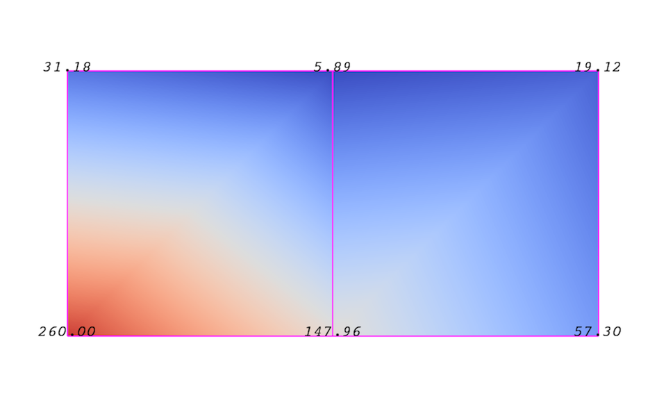

Fig. 3.3 demonstrates the use of a cell-centered attribute. Note that cell-centered attributes are assumed to be constant over each cell. Due to this property, many filters in VTK cannot be directly applied to cell-centered attributes. It is normally required to apply a Cell Data to Point Data filter. In ParaView, this filter is applied automatically, when necessary.
../_images/ParaView_UG_Cells_with_cvalues.png
Fig. 3.3 Cell-centered attribute.

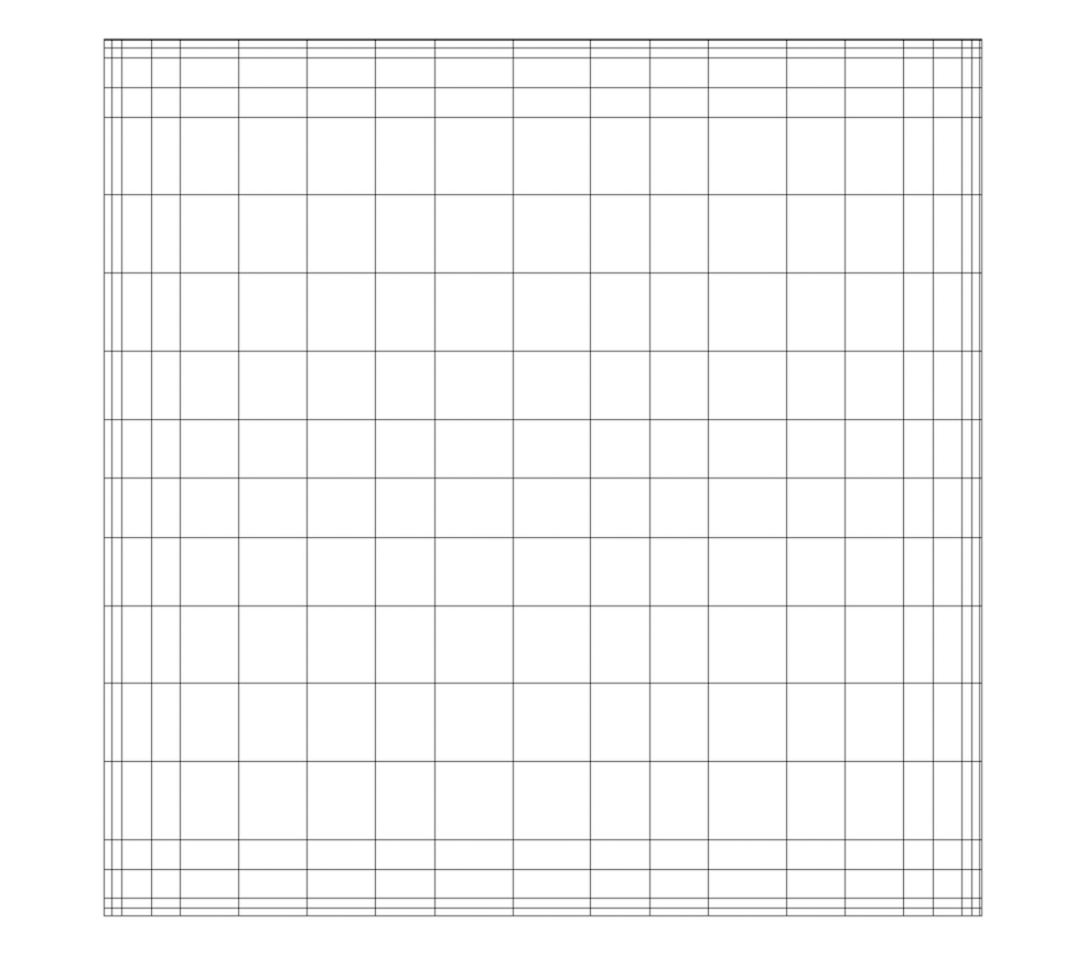

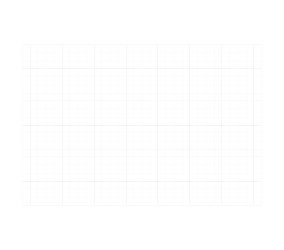

3.1.4. Rectilinear grid
../_images/ParaView_UG_Rectilinear.png
Fig. 3.5 Rectilinear grid.
A rectilinear grid, such as Fig. 3.5, defines its topology implicitly and point coordinates semi-implicitly. To fully define the mesh for a rectilinear grid, VTK uses the following:
  • Extents - These define the minimum and maximum indices in each direction. For example, a rectilinear grid of extents \((0, 9)\), \((0, 19)\), \((0, 29)\) has 10 points in the x-direction, 20 points in the y-direction, and 30 points in the z-direction. The total number of points is \(10 \times 20 \times 30\).
  • Three arrays defining coordinates in the x-, y- and z-directions - These arrays are of length \(npts_x\), \(npts_y\), and \(npts_z\). This is a significant savings in memory, as the total memory used by these arrays is \(npts_x+npts_y+npts_z\) rather than \(npts_x \times npts_y \times npts_z\).
The coordinate of each point is defined as follows:
\(coordinate = (coordinate\_array_x(i), coordinate\_array_y(j), coordinate\_array_z(k))\).
Note that the generic VTK interface for all datasets uses a flat index. The \((i,j,k)\) index can be converted to this flat index as follows: \(idx\_flat = k \times (npts_x \times npts_y) + j \times nptr_x + i\).
A rectilinear grid consists of cells of the same type. This type is determined by the dimensionality of the dataset (based on the extents) and can either be vertex (0D), line (1D), pixel (2D), or voxel (3D).

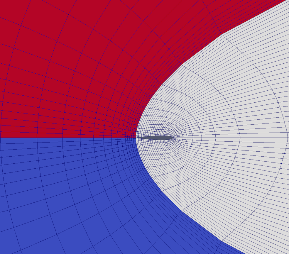

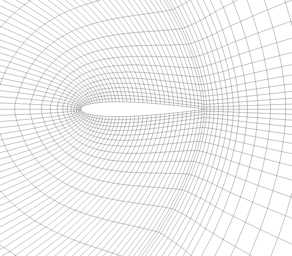

3.1.5. Curvilinear grid (structured grid)
../_images/ParaView_UG_Curvilinear.png
Fig. 3.6 Curvilinear or structured grid.
A curvilinear grid, such as Fig. 3.6, defines its topology implicitly and point coordinates explicitly. To fully define the mesh for a curvilinear grid, VTK uses the following:
  • Extents - These define the minimum and maximum indices in each direction. For example, a curvilinear grid of extents \((0, 9)\), \((0, 19)\), \((0, 29)\) has \(10 \times 20 \times 30\) points regularly defined over a curvilinear mesh.
  • An array of point coordinates - This array stores the position of each vertex explicitly.
The coordinate of each point is defined as follows: \(coordinate = coordinate\_array(idx\_flat)\). The \((i,j,k)\) index can be converted to this flat index as follows: \(idx\_flat = k \times (npts_x \times npts_y) + j \times npts_x + i\).
A curvilinear grid consists of cells of the same type. This type is determined by the dimensionality of the dataset (based on the extents) and can either be vertex (0D), line (1D), quad (2D), or hexahedron (3D).

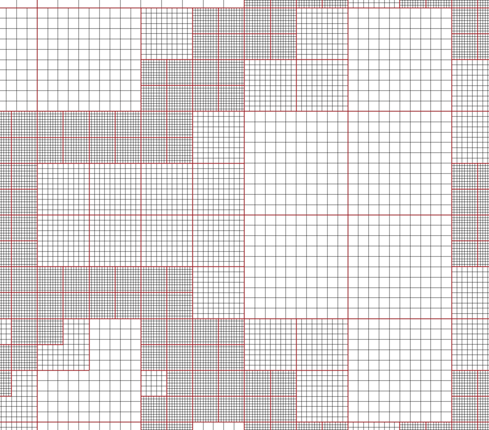

3.1.6. AMR dataset
../_images/ParaView_UG_AMR.png
Fig. 3.7 AMR dataset.
VTK natively supports Berger-Oliger type AMR datasets, as shown in Fig. 3.7. An AMR dataset is essentially a collection of uniform rectilinear grids grouped under increasing refinement ratios (decreasing spacing). VTK’s AMR dataset does not force any constraint on whether and how these grids should overlap. However, it provides support for masking (blanking) sub-regions of the rectilinear grids using an array of bytes. This allows VTK to process overlapping grids with minimal artifacts. VTK can automatically generate the masking arrays for Berger-Oliger compliant meshes.

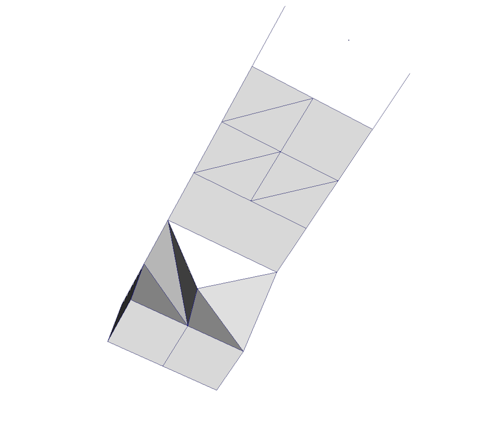

3.1.7. Unstructured grid
../_images/ParaView_UG_Unstructured.png
Fig. 3.8 Unstructured grid.
An unstructured grid, such as Fig. 3.8, is the most general primitive dataset type. It stores topology and point coordinates explicitly. Even though VTK uses a memory-efficient data structure to store the topology, an unstructured grid uses significantly more memory to represent its mesh. Therefore, use an unstructured grid only when you cannot represent your dataset as one of the above datasets. VTK supports a large number of cell types, all of which can exist within one heterogeneous unstructured grid. The full list of all cell types supported by VTK can be found in the file vtkCellType.h in the VTK source code. Here is the list of cell types as of when this document was written:

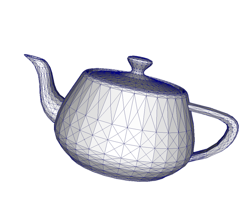

3.1.8. Polygonal grid (polydata)
../_images/ParaView_UG_Polydata.png
Fig. 3.9 Polygonal grid.
A polydata, such as Fig. 3.9, is a specialized version of an unstructured grid designed for efficient rendering. It consists of 0D cells (vertices and polyvertices), 1D cells (lines and polylines), and 2D cells (polygons and triangle strips). Certain filters that generate only these cell types will generate a polydata. Examples include the Contour and Slice filters. An unstructured grid, as long as it has only 2D cells supported by polydata, can be converted to a polydata using the Extract Surface Filter . A polydata can be converted to an unstructured grid using Clean to Grid .

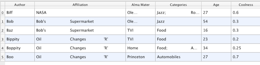

3.1.9. Table
../_images/ParaView_UG_Table.png
Fig. 3.10 Table
A table, such as Fig. 3.10, is a tabular dataset that consists of rows and columns. All chart views have been designed to work with tables. Therefore, all filters that can be shown within the chart views generate tables. Also, tables can be directly loaded using various file formats such as the comma-separated values format. Tables can be converted to other datasets as long as they are of the right format. Filters that convert tables include Table to Points and Table to Structured Grid .

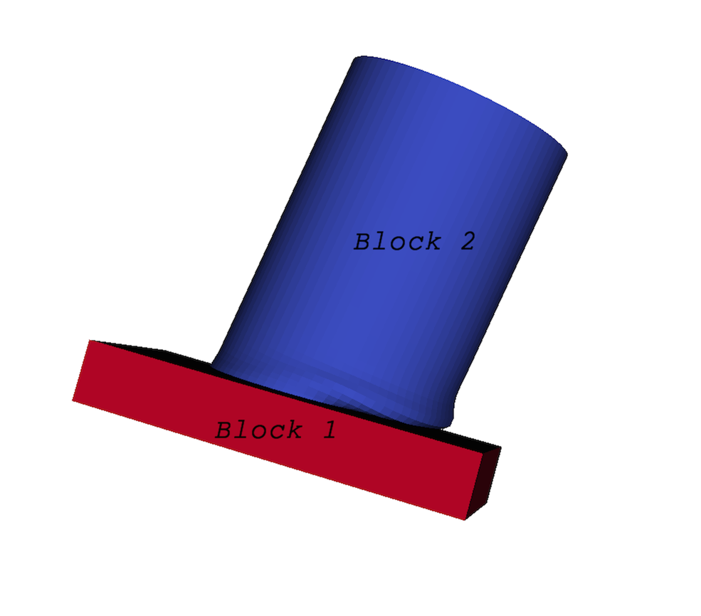

3.1.10. Multiblock dataset
../_images/ParaView_UG_Multiblock.png
Fig. 3.11 Multiblock dataset.
You can think of a multiblock dataset (Fig. 3.11) as a tree of datasets where the leaf nodes are simple datasets. All of the data types described above, except AMR, are simple datasets. Multiblock datasets are used to group together datasets that are related. The relation between these datasets is not necessarily defined by ParaView. A multiblock dataset can represent an assembly of parts or a collection of meshes of different types from a coupled simulation. Multiblock datasets can be loaded or created within ParaView using the Group filter. Note that the leaf nodes of a multiblock dataset do not all have to have the same attributes. We call attributes that are not present on all blocks of a multiblock dataset partial attributes or partial arrays If you apply a filter that requires an attribute, it will be applied only to blocks that have that attribute.

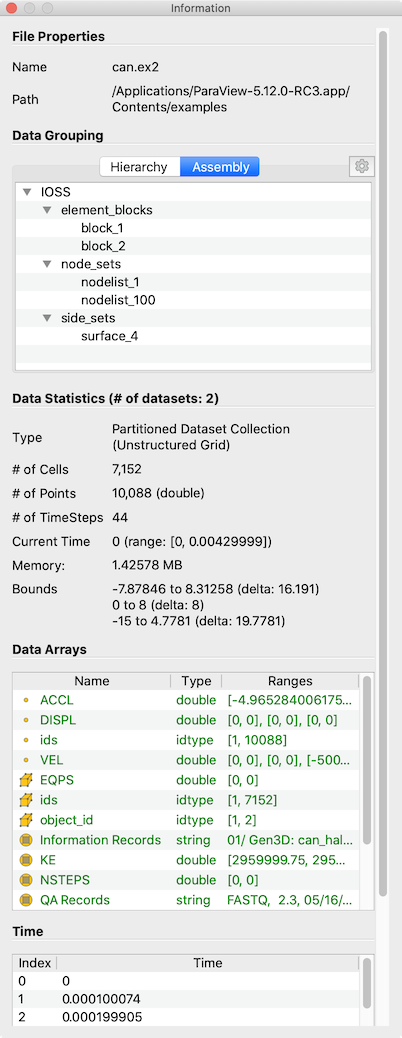

3.2.1. The Information panel
The Information panel provides summary information about the data produced by the active source. By default, this panel is tucked under a tab below the Properties panel. You can toggle its visibility using View > Information.
../_images/InformationPanel.png
Fig. 3.13 The Information panel in paraview showing data summaries for the active source.
The Information panel shows the data information for the active source. Thus, similar to the Properties panel, it changes when the active source is changed (e.g., by changing the selection in the Pipeline Browser ). One way to think of this panel is as a panel showing a summary for the data currently produced by the active source. Remember that a newly-created pipeline module does not produce any data until you hit Apply . Thus, valid information for a newly-created source will be shown on this panel only after that Apply . Similarly, if you change properties on the source and hit Apply , this panel will reflect any changes in data characteristics. Additionally, for temporal pipelines, this panel shows information for the current timestep alone (except as noted). Thus, as you step through timesteps in a temporal dataset, the information displayed will potentially change, and the panel will reflect those changes.
Did you know?
Any text on this panel is copy-able. For example, if want to copy the number of points value to use it as a property value on the Properties panel, simply double-click on the number or click-and-drag to select the number and use the common keyboard shortcut CTRL + C (or ⌘ + C) to copy that value to the clipboard. Now, you can paste it in an input widget in paraview or any other application, such as an editor, by using CTRL + V (or ⌘ + V) or the application-specific shortcut for pasting text from the clipboard. The same is true for numbers shown in lists, such as the Data Ranges .
The several groups of information comprise the panel itself. Groups may be hidden based on the type of pipeline module or the type of data being produced.
The file File Properties group is shown for readers with information about the file that is opened. For a temporal file series, as you step through each time step, the file name is updated to point to the name of the file in the series that corresponds to the current time step.
The Data Grouping section shows information about composite datasets consisting of more than one datasets in some kind of hierarchical arrangement. Two different hierarchies are available. The Hierarchy shows the relationships of datasets inherent in the composite dataset structure, while the Assembly shows relationships among datasets that are explicity defined by the data source.
The Data Statistics group provides a summary of the dataset produced including its type, its number of cells and points (or rows and columns in cases of Tabular datasets), the number of timesteps, the current time, and an estimate of the memory used by the dataset. This number only includes the memory space needed to save the data arrays for the dataset. It does not include the memory space used by the data structures themselves and, hence, must only be treated as an estimate. Lastly, the group shows the spatial bounds of the datasets in 3D Cartesian space. This will be unavailable for non-geometric datasets such as tables.

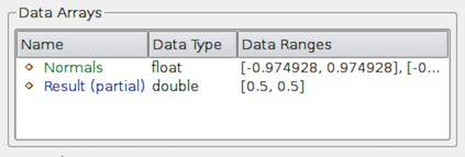

The Data Arrays group lists all of the available point, cells, and field arrays, as well as their types and ranges for the current time step. The Current Time field shows the time value for the current timestep as a reference. As with other places in paraview, the icons pqCellData, pqNodalData, and pqGlobalData are used to indicate cell, point, and field data arrays. Since data arrays can have multiple components, the range for each component of the data array is shown.
For reader modules, the Time group shows the available time steps and corresponding time values provided by the file.
For structured datasets such as uniform rectilinear grids or curvilinear grids, the Extents group is shown that displays the structured extents and dimensions of the datasets.
All of the summary information discussed so far provides a synopsis of the entire dataset produced by the pipeline module, including across all ranks (which will become clearer once we look at using ParaView for parallel data processing). In cases of composite datasets, such as mutliblock datasets or AMR datasets, recall that these are datasets that are made up of other datasets. In such cases, these are summaries over all the blocks in the composite dataset. Every so often, you will notice that the Data Arrays table lists an array with the suffix (partial) (Figure Fig. 3.14). Such arrays are referred to as partial arrays. Partial arrays is a term used to refer to arrays that are present on some non-composite blocks or leaf nodes in a composite dataset, but not all. The (partial) suffix to indicate partial arrays is also used by paraview in other places in the UI.
../_images/InformationPanelPartialArrays.png
Fig. 3.14 The Data Arrays section on Information panel showing partial arrays. Partial arrays are arrays that present on certain blocks in a composite dataset, but not all.

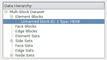

While summaries over all of the datasets in the composite dataset are useful, you may also want to look at the data information for individual blocks. To do so, you can use the Data Hierarchy group, which appears when summarizing composite datasets. The Data Hierarchy widget shows the structure or hierarchy of the composite dataset (Figure Fig. 3.15). The Information panel switches to showing the summaries for the selected sub-tree. By default, the root element will be selected. You can now select any block in the hierarchy to view the summary limited to just that sub-tree.
../_images/InformationPanelDataHierarchy.png
Fig. 3.15 The Data Hierarchy section on the Information panel showing the composite data hierarchy. Selecting a particular block or subtree in this widget will result in the reset of the Information panel showing summaries for that block or subtree alone.

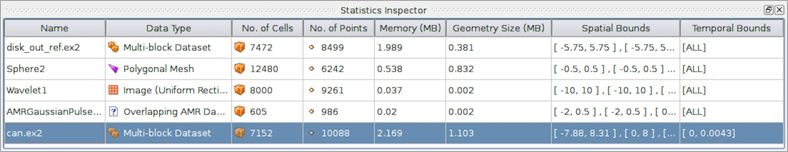

3.2.2. The Statistics Inspector panel
The Information panel shows data information for the active source. If you need a quick summary of the data produced by all the pipeline modules, you can use the Statistics  Inspector panel. It’s accessible from Views > Statistics Inspector.
../_images/StatisticsInspector.png
Fig. 3.16 The Statistics Inspector panel in paraview showing summaries for all pipeline modules.
All of the information on this panel is also presented on the Information panel, except Geometry Size . This corresponds to how much memory is needed for the transformed dataset used for rendering in the active view. For example, to render a 3D dataset as a surface in the 3D view, ParaView must extract the surface mesh as a polydata. Geometry Size represents the memory needed for this polydata with the same memory-size-related caveats as with the Information panel.

>>> reader.PointData["ACCL"].GetRange(0)
(-4.965284006175352e-07, 3.212448973499704e-07)
# To get the range for the magnitude in cases of multi-component arrays
# use -1 as the component number.
>>> reader.PointData["ACCL"].GetRange(-1)
(0.0, 1.3329898584157294e-05)
# To determine the data data type for this array:
>>> from paraview import vtk
>>> reader.PointData["ACCL"].GetDataType() == vtk.VTK_DOUBLE
True
# The paraview.vtk module provides access to these constants such as
# VTK_DOUBLE, VTK_FLOAT, VTK_INT, etc.
# Likewise, to test the dataset type, itself:
>>> reader.GetDataInformation().GetDataSetType() == \
                               vtk.VTK_MULTIBLOCK_DATA_SET
True
Here’s a sample script to iterate over all point data arrays and print their magnitude ranges:
>>> def print_point_data_ranges(source):
...    """Prints array ranges for all point arrays"""
...    for arrayInfo in source.PointData:
...        # get the array's name
...        name = arrayInfo.GetName()
...        # get magnitude range
...        range = arrayInfo.GetRange(-1)
...        print "%s = [%.3f, %.3f]" % (name, range[0], range[1])
# Let's call this function on our reader.
>>> print_point_data_ranges(reader)
ACCL = [0.000, 0.000]
DISPL = [0.000, 0.000]
GlobalNodeId = [1.000, 10088.000]
PedigreeNodeId = [1.000, 10088.000]
VEL = [0.000, 5000.000]
