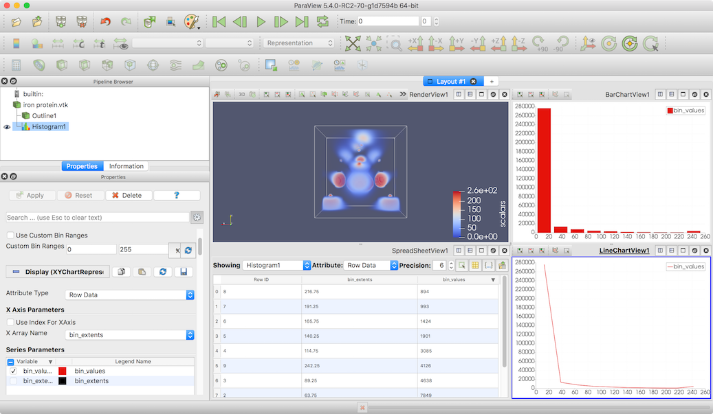

4.1. Multiple views
../_images/MultipleViewsInParaView.png
Fig. 4.1 Using multiple views in paraview to generate different types of visualizations from a dataset.
With multiple types of views comes the need for creating and viewing multiple views at the same time. In this section, we look at how you can create multiple views and lay them out.

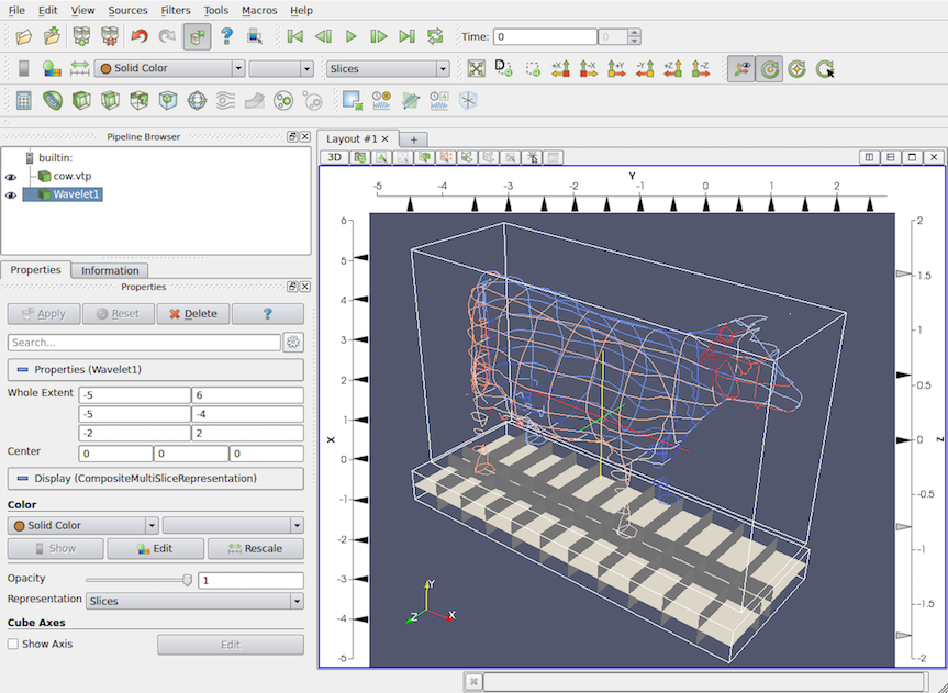

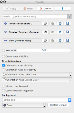

4.4.2.3. View properties

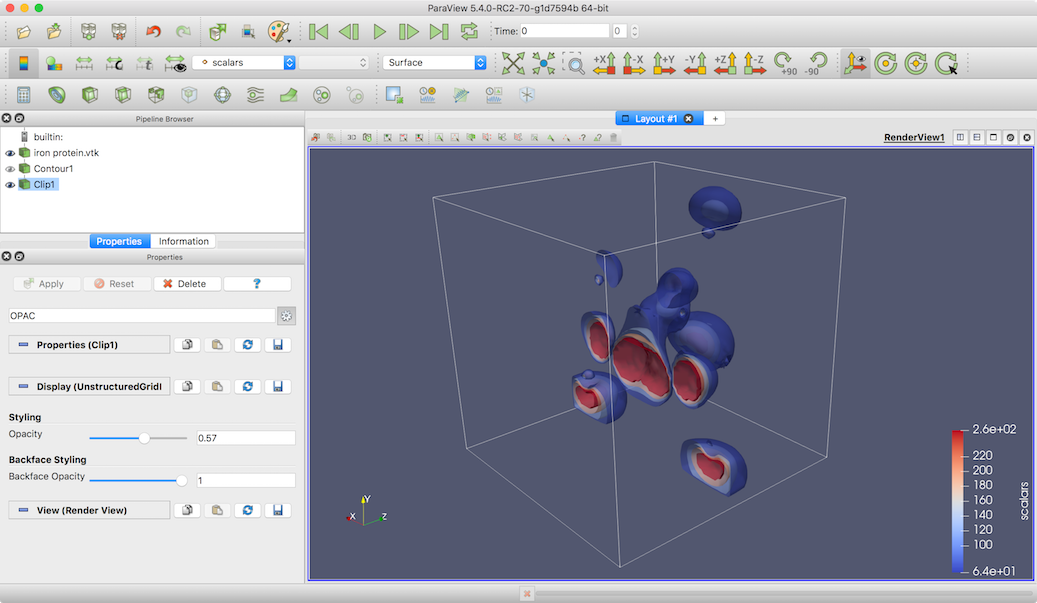

Several of the view properties in Render View control the annotations shown in the view (Fig. 4.3).
../_images/RenderViewPropertiesPanel.png
Fig. 4.3 The Properties panel showing view properties for Render View .

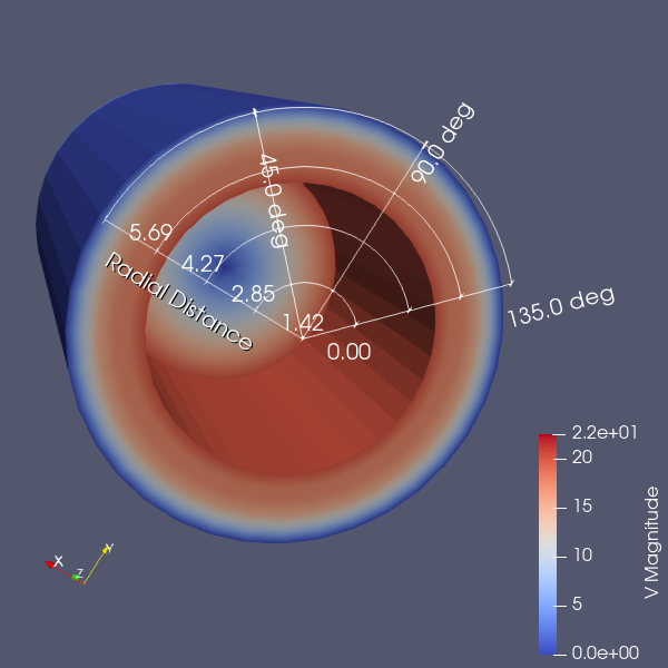

Axes Grid refers to an annotation axis rendered around all datasets in the view (Fig. 4.4). You use the checkbox next to the Edit Axis Grid button to show or hide this annotation. To control the annotation formatting, labels, etc., click on the Edit Axes Grid... button. The Axes Grid is described in Chapter Section 12.
../_images/RenderViewAxesGrid.png
Fig. 4.4 Axes Grid is used to annotate data bounds in Render View .

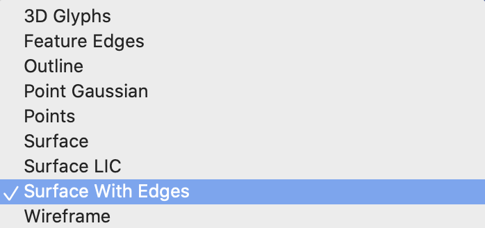

4.4.2.4. Display properties

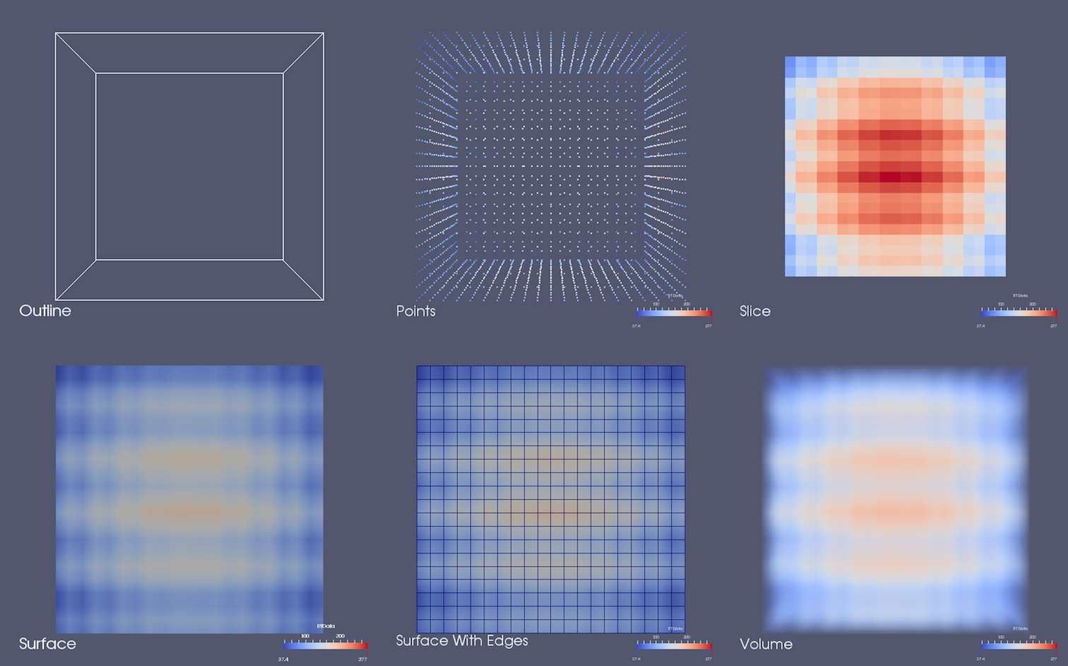

../_images/RenderViewDisplayPropertiesRepresentation.png

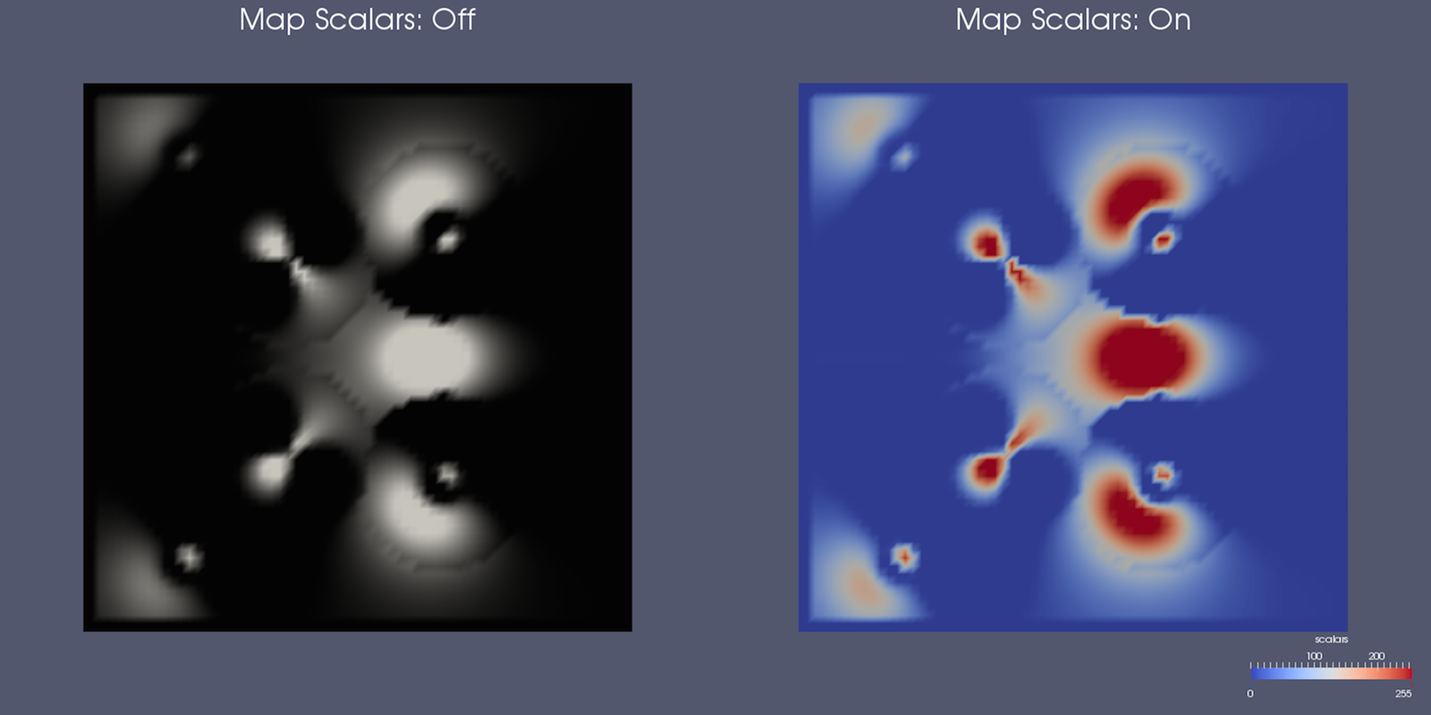

One of the first (and probably the most often used) display properties is Representation . Representation allows you to pick one of the mapping modes. The options available depend on the data type, as well as the plugins loaded. While all display properties are accessible from the advanced view for the Properties panel, certain properties may be shown/hidden from the default view based on the chosen representation type.
../_images/WaveletRepresentations.png
Fig. 4.5 Different renderings generated by rendering data produced by the Wavelet source as outline, points, slice, surface, surface with edges, and volume.
The Outline representation can be used to render an outline for the dataset. This is arguably the fastest way of rendering the dataset since only the bounding box is rendered. Scalar coloring options, i.e., selecting an array with which to color, has no effect on this representation type. You can still, however, change the Solid Color to use as well as the Opacity . To change the color, select Solid Color in the combo-box under Coloring , and then click Edit to pick the color to use. To change the opacity, simply change the Opacity slider. 0 implies total transparency and, hence, invisiblity, while 1 implies totally opacity.

Points , Surface , Surface With Edges , and Wireframe rely on extracting the surface mesh from the dataset and then rendering that either as a collection of points, as solid surface, as solid surface with cell boundaries highlighted, or as a wireframe of cell boundaries only. Feature Edges is a subset of Wireframe consisting of prominent edges on the surface such as edges between cells that form a sharp angle or edges with only one adjacent cell. For these representations, you can either set a single solid color to use, as with Outline , or select a data array to use for scalar coloring (also known as pseudocoloring).
Two other representations are available for most datasets. 3D Glyphs draws a copy of a 3D geometry (e.g., arrow, cone, or sphere, etc.), or glyph, at a subset of points in the dataset. These glyphs can be set to a single color or pseudocolored by a data array. The Point Gaussian representation is similar, but instead of drawing 3D geometry at every point, it draws a 2D image sprite that may have transparency. The image drawn can be one of several predefined image sprites such as Gaussian Blur , Sphere , Black-edged circle , Plain cirlce , Triangle , or Square outline , or a custom sprite can be defined with custom GLSL shader code.

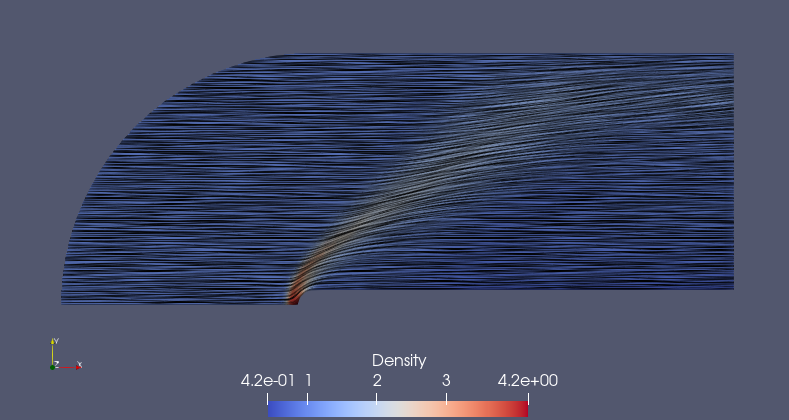

Lastly, the SurfaceLIC representation is available for surface datasets with vector point data arrays. LIC stands for line integral convolution, which is a visualization technique that shows the direction of flow as a noise pattern smeared in the direction of flow.
../_images/SurfaceLICRepresentation.png
Fig. 4.6 An example of the SurfaceLIC representation showing the direction of a vector data array and colored by a different scalar array showing (Density).

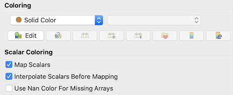

Display properties under Coloring allow you to set how the dataset is colored. To select a single solid color to use to fill the surface or color the wireframe or points, select Solid Color in the combo-box, and then click Edit . That will pop up the standard color chooser dialog from which you can pick a color to use.
If instead you want to pseudocolor using an attribute array available on the dataset, select that array name from the combo-box. For multi-component arrays, you can pick a particular component or Magnitude to use for scalar coloring. ParaView will automatically set up a color transfer function it will use to map the data array to colors. The default range for the transfer function is set up based on the Transfer Function Reset Mode general setting in the Settings dialog when the transfer function is first created. If another dataset is later colored by a data array with the same name, the range of the transfer function will be updated according to the Automatic Rescale Range Mode property in the Color Map Editor . To reset the transfer function range to the range of the data array in the selected dataset, you can use the Rescale button. Remember that, despite the fact that you can set the scalar array with which to color when rendering as Outline , the outline itself continues to use the specified solid color.
Scalar Coloring properties are only relevant when you have selected a data array with which to pseudocolor. The Map Scalars checkbox affects whether a color transfer function should be used (Fig. 4.7). If unchecked, and the data array can directly be interpreted as colors, then those colors are used directly. If not, the color transfer function will be used. A data array can be interpreted as colors if, and only if, it is an unsigned char, float, or double array with two, three, or four components. If the data array is unsigned char, the color values are defined between 0 and 255 while if the data array is float or double, the color values are expected to be between 0 and 1. Interpolate Scalars Before Mapping controls how color interpolation happens across rendered polygons. If on, scalars will be interpolated within polygons, and color mapping will occur on a per-pixel basis. If off, color mapping occurs at polygon points, and colors are interpolated, which is generally less accurate. Refer to the Kitware blog [PatMarion] for a detailed explanation of this option. Use Nan Color For Missing Arrays is a property that, if enabled, will use the special color designated for NaN values in a dataset to also be used as the color for parts of a composite dataset that are missing the scalars array used for color mapping.
../_images/UnderstandingMapScalars.png
Fig. 4.7 The Map Scalars property can be used to avoid using a transfer function and directly interpreting the array values as colors, if possible.
../_images/PolarAxesCheckbox.png
The Polar Axes checkbox toggles polar axes shown around the data. Many parameters can be accessed via an Edit button alongside it. The parameters include angles, tick range, labels, logarithmic mode, ellipse ratio and more.
../_images/PolarAxes.png
Fig. 4.8 A Polar Axes usage example.

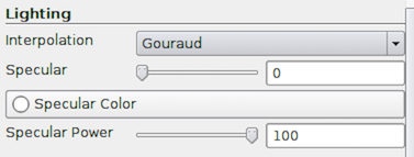

../_images/RenderViewDisplayPropertiesLightingGroup.png
Lighting properties affect the shading for rendered surfaces. Interpolation allows you to pick between Flat and Gouraud shading. Specular , together with Specular Color and Specular Power , affects the shininess of the surface. Set this to a non-zero value to render shiny, metallic surfaces.

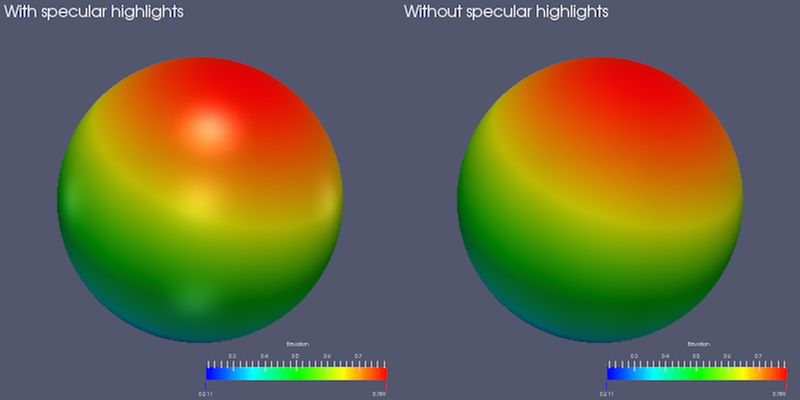

Common Errors
Specular highlights can lead to misinterpretation of scalar values when using scalar coloring, since the color shown on the shiny part of the surface will not correspond to any color on the color transfer function. Hence, it is generally advisable to use specular highlights on surfaces colored with a single solid color and not on those using scalar coloring (or pseudocoloring).
../_images/ScalarColoringAndSpecularHighlights.png

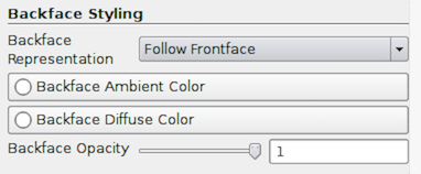

../_images/RenderViewDisplayPropertiesBackfaceStylingGroup.png
Backface Styling provides advanced controls to fine-tune the rendering by controlling front and back faces. A front face is any mesh face facing the camera, while a back face is the one facing away from the camera. By choosing to Cull Frontface or Cull Backface , or by selecting a specific representation type to use for the backface, you can customize your visualizations.

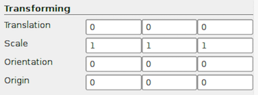

../_images/RenderViewDisplayPropertiesTransformingGroup.png
Transforming properties can be used to transform the rendered data in the scene without affecting the raw data itself. Thus, if you apply filters on the data source, it will indeed be working with the untransformed data. To transform the data itself, you should use the Transform filter.

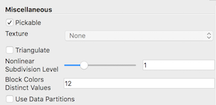

../_images/RenderViewDisplayPropertiesMiscellaneousGroup.png
Several properties are available under the Miscellaneous group. Uncheck the Pickable option if you want the dataset to be ignored when making selections. If the dataset has a texture coordinates array, you can apply a texture to the dataset surface using the Texture combo-box. Choose Load to load a texture or apply a previously loaded texture listed in the combo-box. If your dataset doesn’t have texture coordinates, you can create them by applying one of Texture Map to Cylinder , Texture Map to Sphere , or Texture Map To Plane filters, or using the filters Calculator or Programmable Filter .
The Triangulate option is useful for rendering objects with non-convex polygons. It comes with some additional processing cost for converting polygons to triangles, so it should be used only when necessary.
../_images/NonLinearSubdivision.png
Fig. 4.9 A dataset made of quadratic tetra hedra displayed with 1, 2, and 3 levels of nonlinear subdivision.
The property Use Shader Replacements enables you to customize the shader code VTK uses for rendering by specifying shader replacements with a JSON string. The JSON string can be a single node or an array of nodes with the following properties:

The Nonlinear Subdivision Level property is used when rendering datasets with higher- order elements. Use this to set the subdivision level for triangulating higher order elements. The higher the value, the smoother the edges. This comes at the cost of more triangles and, hence, potentially, increased rendering time.
The Block Colors Distinct Values property sets the number of unique colors to use when coloring multiblock datasets by block ID. Finally, Use Data Partitions controls whether data is redistributed when it is rendered translucently. When off (default value), data is repartitioned by the compositing algorithm prior to rendering. This is typically an expensive operation that slows down rendering. When this option is on, the existing data partitions are used, and the cost of data restribution is avoided. However, if the partitions are not sortable in back-to-front order, rendering artifacts may occur.

../_images/RenderViewDisplayPropertiesSlicingGroup.png
Slicing properties are available when the Slice representation type is present. These allow you to pick the orthogonal slice plane orientation and slice offset using Slice Direction and the Slice slider.

In pvpython, view properties are directly accessible on the view object returned by CreateRenderView or GetActiveView .
Once you get access to the view properties objects, you can then set properties on it similar to properties on pipeline modules such as sources, filters, and readers.
>>> view = GetActiveView()
# Set center axis visibility
>>> view.CenterAxesVisibility = 0
# Or you can use this variant to set the property on the active view.
>>> SetViewProperties(CenterAxesVisibility=0)
# Another way of doing the same
>>> SetViewProperties(view, CenterAxesVisibility=0)
# Similarly, you can change orientation axes related properties
>>> view.OrientationAxesVisibility = 0
>>> view.OrientationAxesLabelColor = (1, 1, 1)

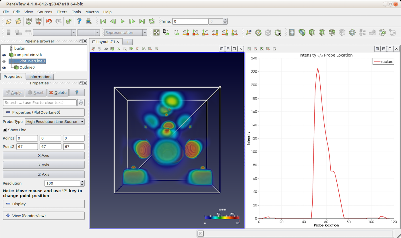

4.5. Line Chart View
../_images/LineChartViewInParaView.png
Fig. 4.10 paraview using Line Chart View to plot data values probed along a line through the dataset using Plot Over Line filter.
Line Chart View can be used to plot data as a line plot representing changes in dependent variables against an independent variable. Using display properties, you can also show scatter plots in this view. This view and other charting views in ParaView follow a similar design, where you pick attribute arrays to plot using display properties, and they are plotted in the view. How those values get plotted depends on the type of the view: Line Chart View draws a line connecting sample points, Bar Chart View renders bars at each sample point, etc.
One of the most common ways of showing a line plot is to apply the Plot Over Line filter to any dataset. This will probe the dataset along the probe line specified. You then plot the sampled values in the Line Chart View . Alternatively, if you have a tabular dataset (i.e. vtkTable ), then you can directly show the data in this view.

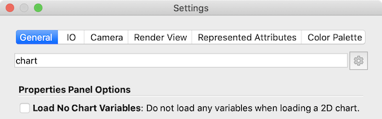

If you generate lengthy data for the Line Chart View , the default variables that are selected may be slow to adjust. You can change paraview’s default behavior to initially load no variables at all by selecting the Load No Chart Variables checkbox under Settings/General/Properties Panel Options .
../_images/ChartNoVarSetting.png

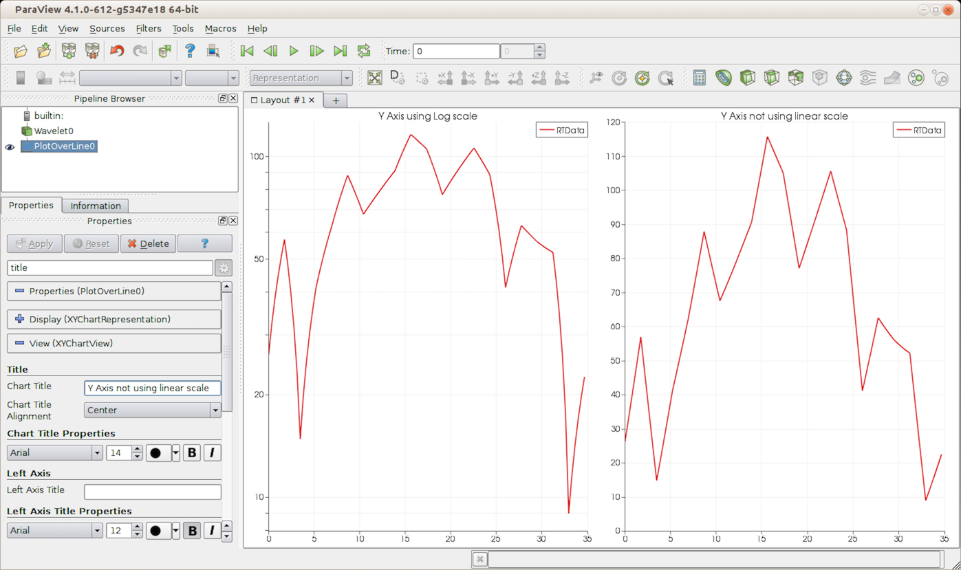

Next, you can customize the axes ranges. You can always simply interact with the mouse to set the axes ranges. To precisely set the range, check the Axis Use Custom Range for the appropriate axis, e.g., Bottom Axis Use Custom Range for fixing the bottom axis range, and then specify the data values to use for the min and the max.
The labels on the axes are, by default, automatically determined to avoid visual clutter. By default, the axis labels are arranged on a linear scale, but by enabling the Axis Log Scale option you can use log scaling instead. In addition, you can override the default labelling strategy for any of the axes separately and, instead, specify the locations to label explicitly. This can be done by checking Axis Use Custom Labels for a particular axis, e.g., Bottom Axis Use Custom Labels . When checked, a list widget will be shown where you can manually add values at which labels will be placed.
For generating log plots, simply check the corresponding Axis Use Log Scale , e.g., Left Axis Use Log Scale to use log scale for Y-axis (Fig. 4.11). Note that log scale should only be used for an axis with a non-zero positive range, since the log of a number less than or equal to 0 is undefined.
../_images/LineChartViewUsingLogScale.png
Fig. 4.11 Differences between line charts when using log scale for the Y-axis.

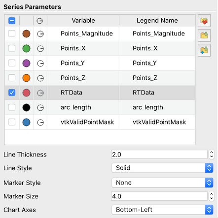

../_images/LineChartViewDisplayPropertiesSeriesParametersGroup.png
Series Parameters control series or data arrays plotted on the Y-axis. All available data arrays are lists in the table widget that allows you to check/uncheck a series to plot in the first column. The second column in the table shows the associated color used to plot that series. You can double-click the color swatch to change the color to use. By default, ParaView will try to pick a palette of discrete colors. The third column lets you set the opacity of the series plot elements. The fourth column (Variable) shows the name of the variable to plot. The fifth column (Legend Name) shows the label to use for that series in the legend. By default, it is set to be the same as the array name. You can double-click to change the name to your choice, e.g., to add units.
Other series parameters include Line Thickness, Line Style, Marker Style, and Marker Size. To change any of these, highlight a row in The Series Parameters widget, and then change the associated parameter to affect the highlighted series. You can change properties for multiple series and can select multiple of them by using the CTRL (or ) and keys.
Using Chart Axes , you can change which axes on which a series is shown. The default is Bottom-Left , but you can change it to be Bottom-Right , Top-Left , or Top-Right to accommodate series with widely different ranges in the same plot.

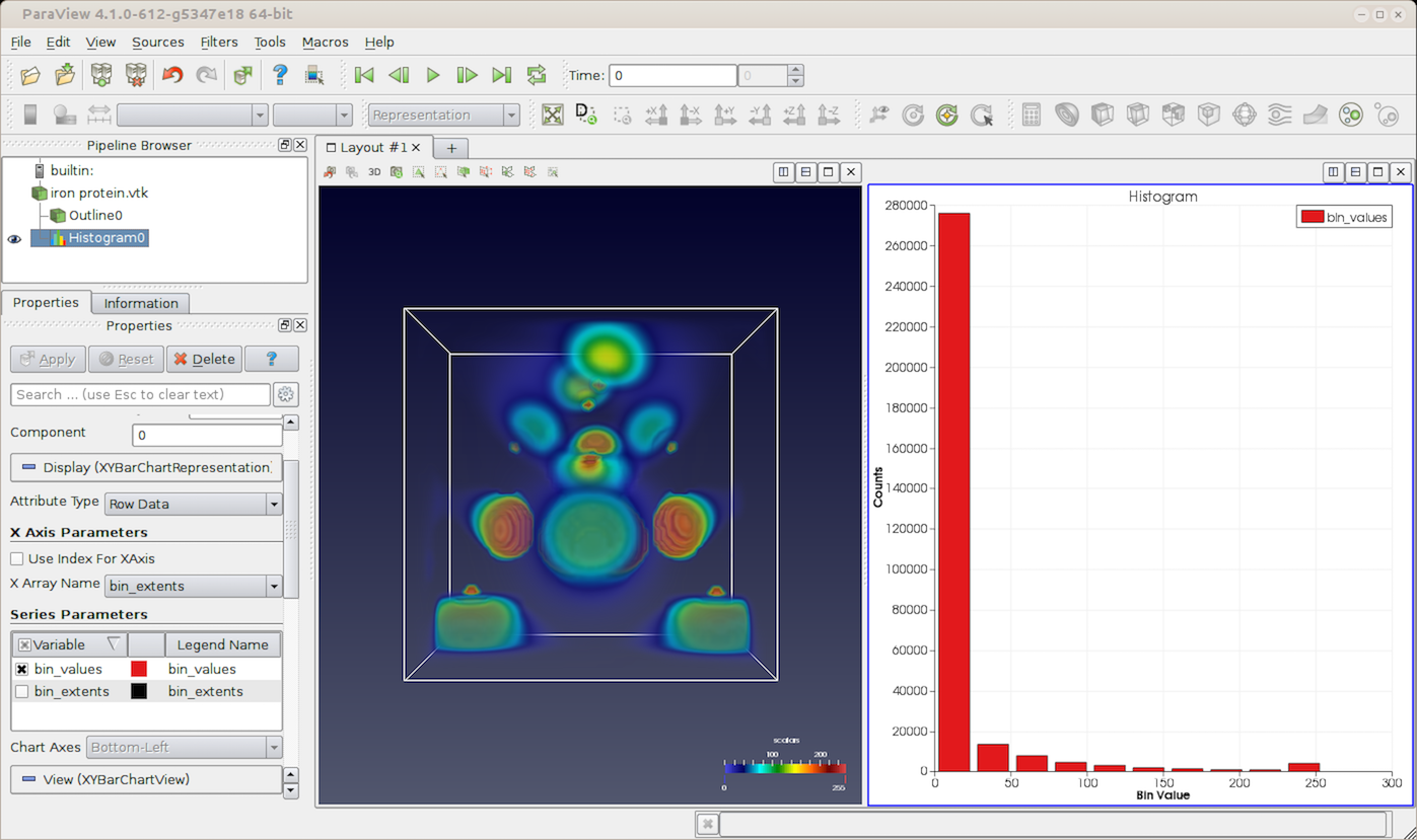

4.6. Bar Chart View
../_images/BarChartViewInParaView.png
Fig. 4.12 paraview using Bar Chart View to plot the histogram for a dataset using the Histogram filter.

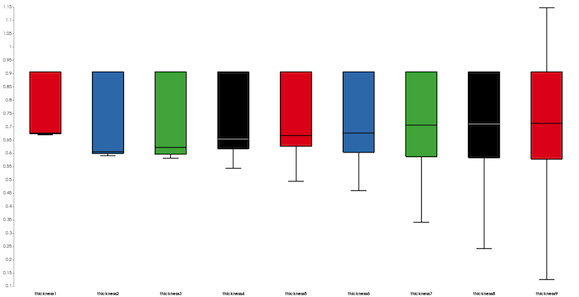

4.7. Box Chart View
../_images/BoxChartViewInParaView.png
Fig. 4.13 paraview using Box Chart View to plot the box chart for a dataset using the Compute Quartiles filter.
Box plot is a standard method for graphically depicting groups of statistical data based on their quartiles. A box plot is represented by a box with the following properties: the bottom of the rectangle corresponds to the first quartile, a horizontal line inside the rectangle indicates the median and the top of the rectangle corresponds to the third quartile. The maximum and minimum values are depicted using vertical lines that extend from the top and the bottom of the rectangle.
In ParaView, the Box Chart View can be used to display such box plots through the Compute Quartiles filter which computes the statistical data needed by the view to draw the box plots.

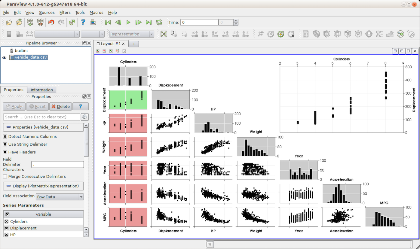

4.8. Plot Matrix View
../_images/PlotMatrixViewInParaView.png
Fig. 4.14 paraview using Plot Matrix View to generate a scatter plot matrix to understand correlations between pairs of variables.
Plot Matrix View is a chart view that renders a scatter plot matrix. It allows you to spot patterns in the small scatter plots, change focus to those plots of interest, and perform basic selection. The principle is that, for all selected arrays or series to be plotted, the view generates a scatter plot for each pair. You can activate a particular scatter plot, in which case the active plot is re-drawn at a bigger scale to make it easier to inspect. Additionally, the view shows a histogram for each plotted variable or series.
The view properties allow you to set colors to use for active plot, histograms, etc., while the display properties allow you to pick which series are plotted.
4.8.1. Interactions
You can click on any of the plots (except the histograms) in the matrix to make it active. Once actived, the active plot will show that plot. You can then interact with the active plot exactly like Line Chart View or Bar Chart View for panning and zoom.
4.8.2. View properties
View properties on this view allow you to pick styling parameters for the rendering ranging from title ( Chart Title ) to axis colors ( Active Plot Axis Color , Active Plot Grid Color ). You can also control the visibility of the histrogram plots, the active plot, the axes labels, the grids, and so on.
4.8.3. Display properties
Similar to Line Chart View , you select the Attribute Type and then the arrays to plot. Since, in a scatter plot matrix, the order in which the selected series are rendered can make it easier to understand correlations, you can change the order by clicking and dragging the rows in the Series Parameters table.

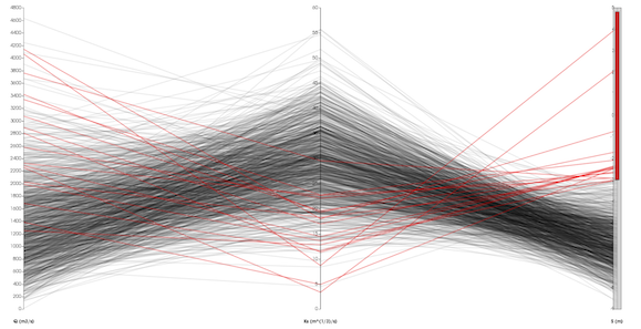

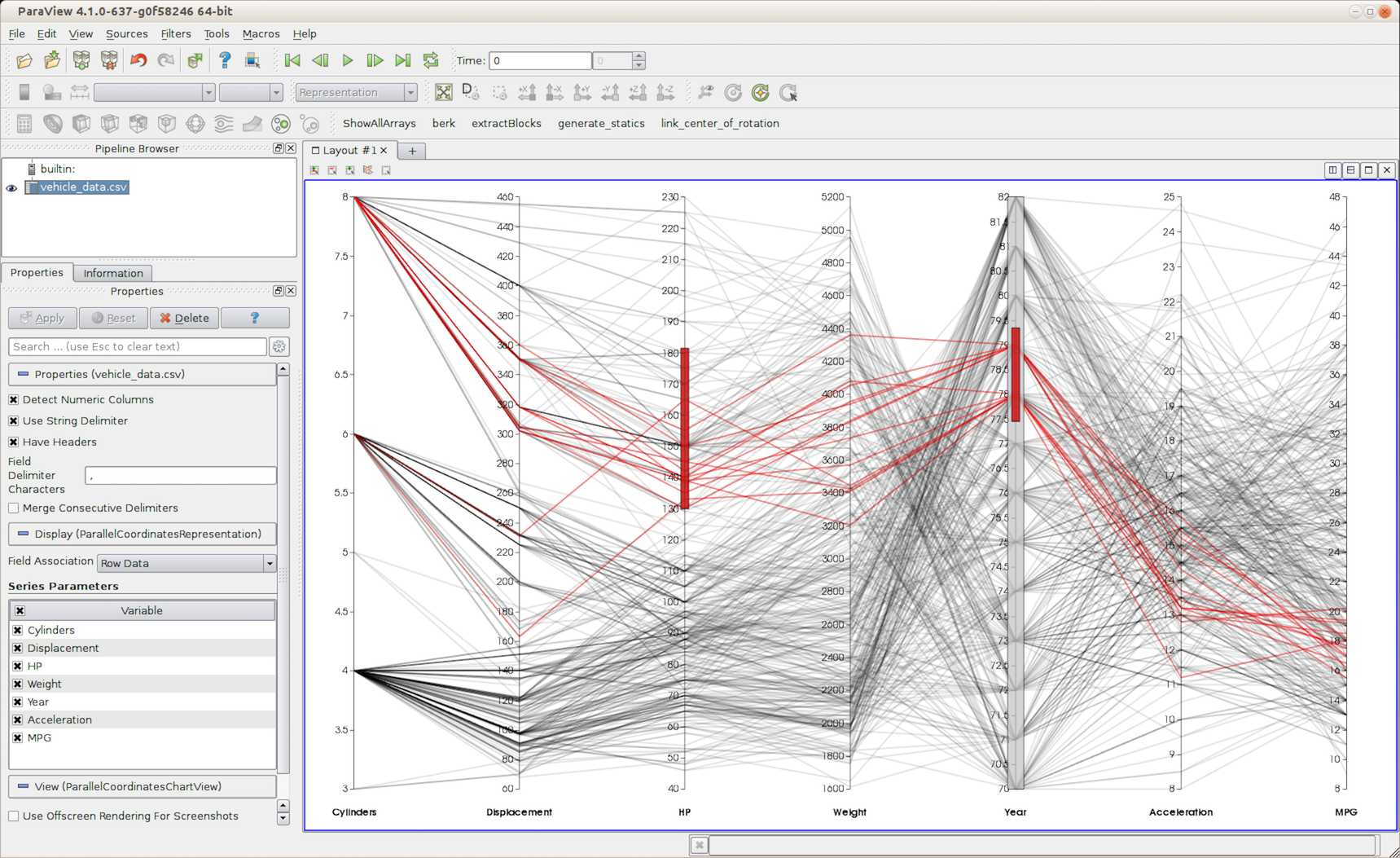

4.9. Parallel Coordinates View
../_images/ParallelCoordinatesViewInParaView.png
Fig. 4.15 paraview using Parallel Coordinates View to plot correlations between columns in a table.
Like Plot Matrix View , Parallel Coordinates View is also used to visualize correlations between data arrays.
One of the main features of this view is the ability to select specific data in order to analyse the factors influencing the data. e.g., with a table of three variables, one being the “output” variable the other two being the potential factor influencing the first, selecting only the output will enable you to see if none, one, or both of the factors are actually influencing the output.
../_images/ParallelCoordinatesViewInParaViewSelection.png
Fig. 4.16 High “S” data point are influenced more by low “Ks” than high “Q”

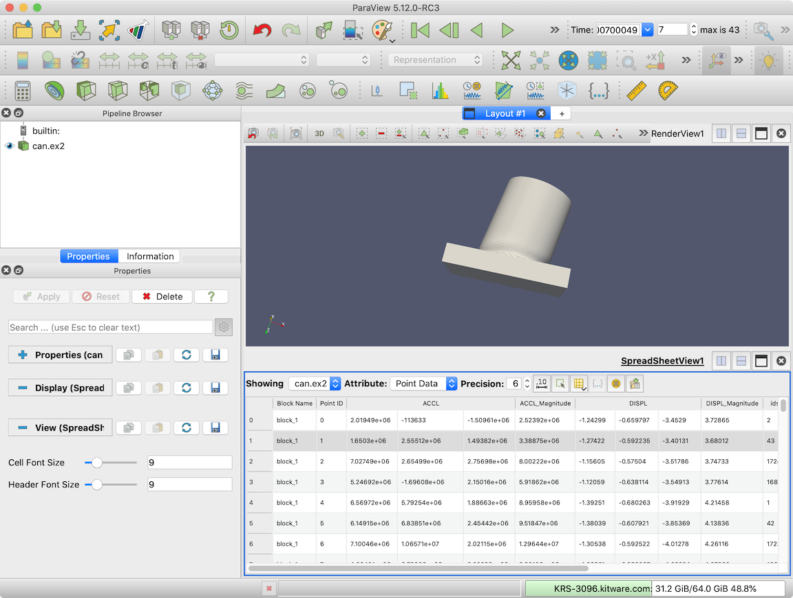

4.10. Spreadsheet View
../_images/SpreadSheetViewInParaView.png
Fig. 4.17 paraview using SpreadSheet View to plot raw data values for the can.ex2 dataset.
SpreadSheet View is used to inspect raw data values in a tabular form. Unlike most other views, this view is primarily intended to be used in the paraview user interface and, hence, is not available in pvpython.
To use this view, simply create this view and show the dataset produced by any pipeline module in it by using the Pipeline Browser . SpreadSheet View can only show one dataset at a time. Therefore, showing a new dataset will automatically hide the previously shown dataset.
The view’s toolbar provides quick access to several of this view’s capabilities. Use the Showing widget on the view toolbar to view as well as to change the dataset being shown. The Attribute field allows you to pick which types of elements to show, e.g., Cell Data , Point Data , Field Data , etc. Precision can be utilized to change the precision used when displaying floating point numbers. The pqRectilinearGrid button enables you to select columns to show. Click on the button to get a popup menu in which you check/uncheck the columns to show/hide. If showing Cell Data , the pqProgrammableFilter button, when checked, enables you to see the point ids that form each of the cells.
Section 6.1 discusses how selections can be made in views to select elements of interest. Use the pqSelectChart button to make the view show only selected elements. Now, as you make selections in other views, this SpreadSheet View will update to only show the values of the selected elements (as long as the dataset selected in are indeed being shown in the view).

4.11. Slice View
../_images/SliceViewInParaView.png
Fig. 4.18 Slice View can be used to show orthogonal slices from datasets.
Slice View is special type of Render View that can be used to view orthogonal slices from any dataset. Any dataset shown in the view will be sliced in axis-aligned slices based on the locations specified on the view. The slice locations along the three orthogonal axis planes can be specified by using the frame decoration around the view window.
4.11.1. Interactions
Since this view is a type of Render View , the camera interactions are same as that of Render View . Additionally, you can interact with the frame decoration to manipulate slice locations along the three axis planes.
  • Double-click the left mouse button in the region between the axis border and the view to add a new slice.
  • You can click-and-drag a marker to move the slice location.
  • To remove a slice, double-click with the left mouse button on the marker corresponding to that slice.
  • To toggle visibility of the slice, you can right-click on the marker.

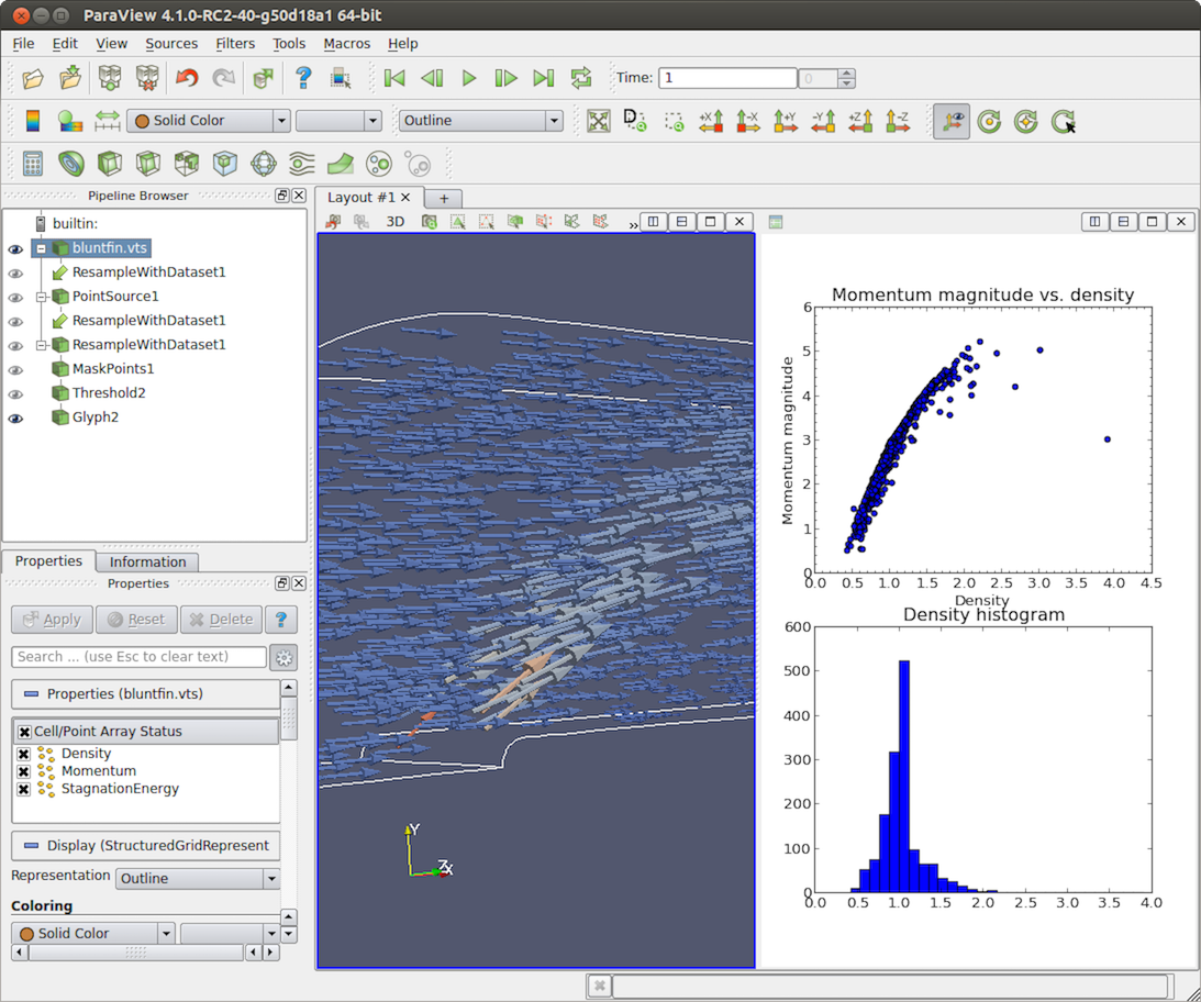

../_images/PythonViewInParaView.png
Fig. 4.19 paraview using Python View with matplotlib to display a scatterplot of momentum magnitude versus density (upper right) and a histogram of density (lower right) in the bluntfin.vts dataset.
Here’s an example of this function that was used to generate the image in Fig. 4.19:
def setup_data(view):
  # Iterate over visible data objects
  for i in range(view.GetNumberOfVisibleDataObjects()):
    # You need to use GetVisibleDataObjectForSetup(i)
    # in setup_data to access the data object.
    dataObject = view.GetVisibleDataObjectForSetup(i)
    # The data object has the same data type and structure
    # as the data object that sits on the server. You can
    # query the size of the data, for instance, or do anything
    # else you can do through the Python wrapping.
    print('Memory size: {0} kilobytes'.format(dataObject.GetActualMemorySize()))
    # Clean up from previous calls here. We want to unset
    # any of the arrays requested in previous calls to this function.
    view.DisableAllAttributeArrays()
    # By default, no arrays will be passed to the client.
    # You need to explicitly request the arrays you want.
    # Here, we'll request the Density point data array
    view.SetAttributeArrayStatus(i, vtkDataObject.POINT, "Density", 1)
    view.SetAttributeArrayStatus(i, vtkDataObject.POINT, "Momentum", 1)
    # Other attribute arrays can be set similarly
    view.SetAttributeArrayStatus(i, vtkDataObject.FIELD, "fieldData", 1)

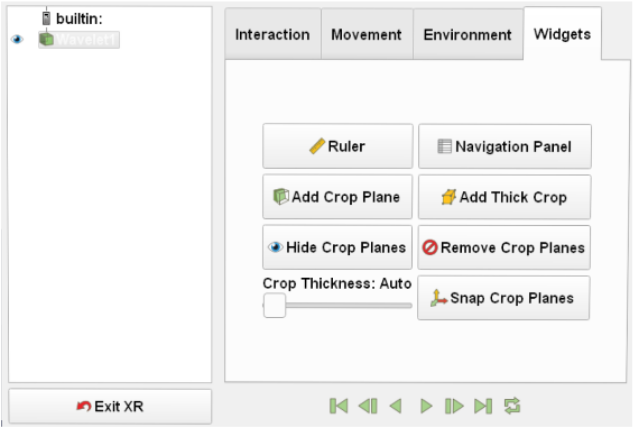

4.14.1.2. XRInterface panel
By default, the XRInterface panel appears on the right upon loading the plugin. To open it manually, search for the corresponding checkbox in the main menu via View > XRInterface.
../_images/XRInterfacePanel.png
Fig. 4.20 XRInterface panel.
Once the XRInterface plugin is loaded and an HMD connected, click on the button Send to XR to start rendering in VR. Other options are available in the plugin panel:
  • Use MultiSamples — This checkbox indicates whether multisampled framebuffers are used. Using multisamples can reduce flickering but currently does not work with volume rendering.
  • Base Station Visibility — This checkbox indicates whether the base stations models are displayed in VR (for devices using base stations).
  • Desired XR Runtime — This drop down list indicates whether to use OpenVR or OpenXR when both are available.
  • Send to XR - This button launches the VR mode using the selected runtime.
  • Attach to Current View — This button allows VR-only elements to appear in the current Render View, such as cropping planes or avatars. This option is mainly useful in Collaboration mode for desktop users when an HMD is not available.
  • Show XR View - This button opens a window showing a stabilized view of what the VR headset is showing, which is useful to produce screenshots or videos.
  • Export Locations as a View — This button exports saved locations as .vtp files in a folder called pv-view. This option is meant to be used for Mineview.
  • Export Locations as Skyboxes — This button exports saved locations as skyboxes in a folder called pv-skybox. This generates six .jpg images (right, left, up, down, back and front) producing a skybox that can then be used outside of VR as well.

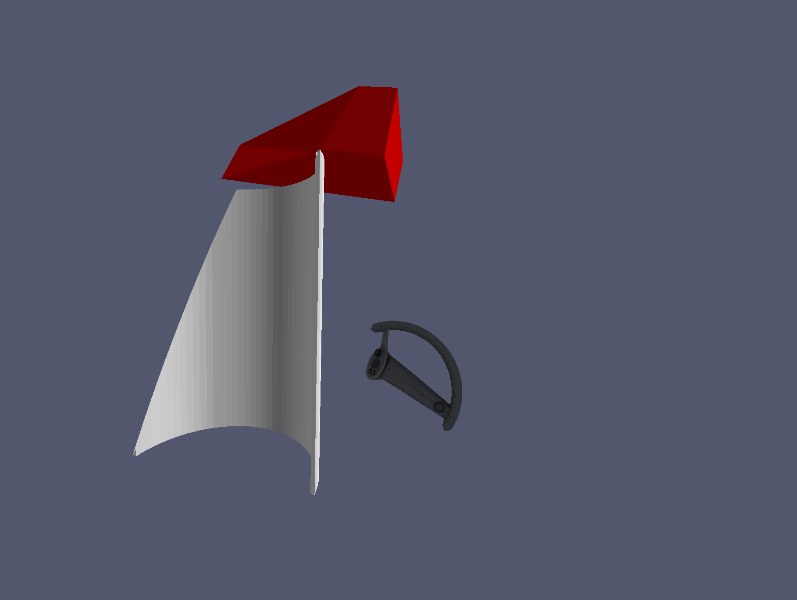

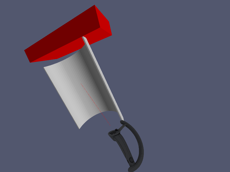

  • Picking — Press the right trigger while pointing at an object to pick it and move it from a distance.
    ../_images/VRPick.png
    Fig. 4.23 Picking action in VR.

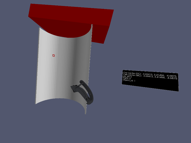

  • Probing — Press the right trigger while pointing at a dataset cell to select it and display information on its position and data values.
    ../_images/VRProbe.png
    Fig. 4.25 Cell probing action in VR.

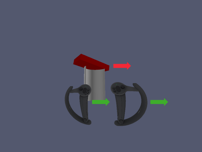

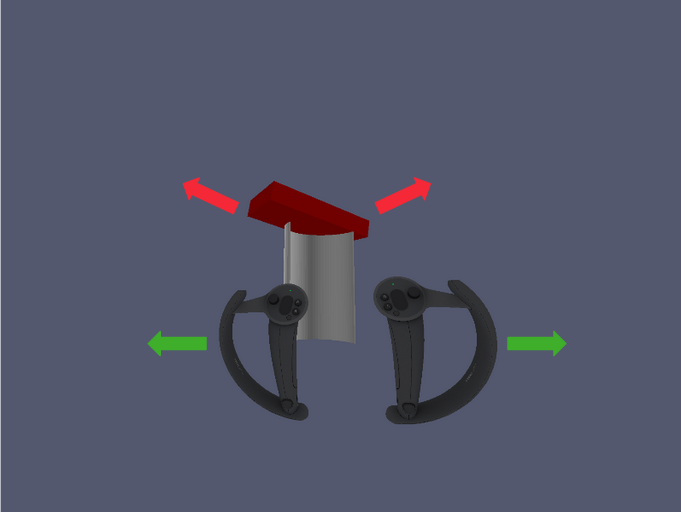

  • Translation — Press both grip buttons, then move the controllers together to translate the scene.
    ../_images/VRTranslate.png
    Fig. 4.26 Translation action in VR. Green and red arrows correspond to movements of the controllers and dataset, respectively.

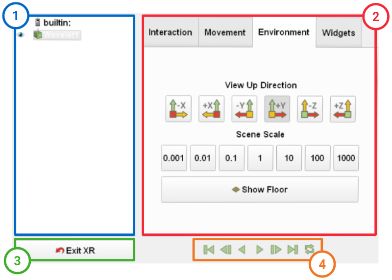

4.14.3. XR menu
In the XR View, pressing the menu button opens a dedicated menu floating in the 3D scene in front of the user.
../_images/XRMenu.png
Fig. 4.29 XR integrated menu.
This menu is composed of the following elements:
  1. Pipeline Browser — This is the same Pipeline Browser present in ParaView. The visibility for each item in the pipeline can be modified by pointing the navigation ray on the eye icon and pressing the right trigger.
  2. Panels — VR options are distributed into 4 panels, that can be displayed by clicking on the corresponding tab:
    • Interaction — This panel contains options related to the interactions with the scene using the controllers (see Section 4.14.3.1).
    • Movement — This panel contains options related to the camera movement and poses (see Section 4.14.3.2).

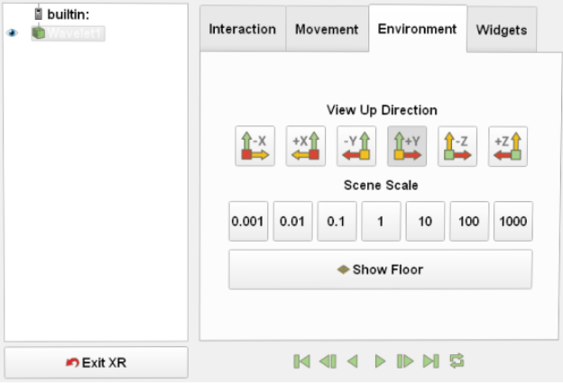

    • Environment — This panel contains global options related to the scene (see Section 4.14.3.3).
    • Widgets — This panel contains options related to VR-specific widgets (see Section 4.14.3.4).
  3. Exit XR — This button closes the current XR View.
  4. Animation Buttons — These buttons are used to navigate timesteps for temporal datasets.

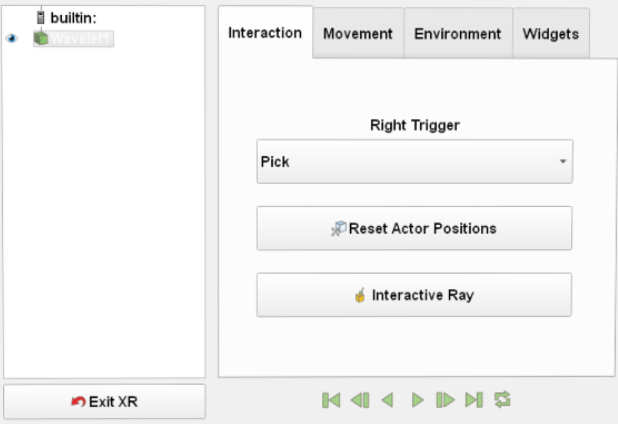

4.14.3.1. Interaction panel
../_images/XRMenuInteraction.png
Fig. 4.30 Interaction panel of the XR integrated menu.
  • Right Trigger — This drop down list indicates which action is mapped to the right trigger outside of the menu, such as picking, probing, etc. See Section 4.14.2.1 for the list of available actions.
  • Reset Actors Positions — This button resets the position of all objects within the scene.
  • Interactive Ray — This checkbox indicates whether the ray changes color when pointing at an object to signal a collision.

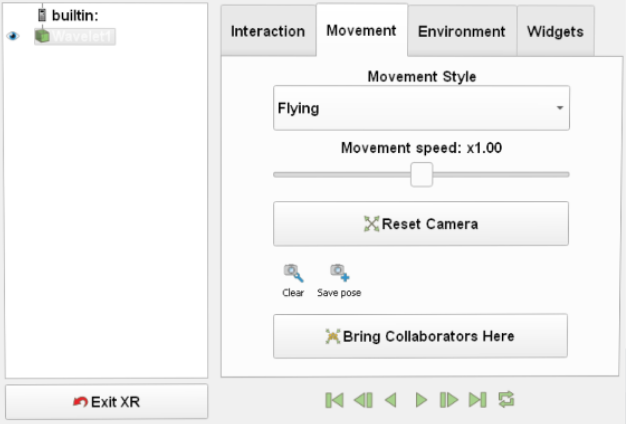

4.14.3.2. Movement Panel
../_images/XRMenuMovement.png
Fig. 4.31 Movement panel of the XR integrated menu.
  • Movement Style — This drop down list indicates which movement style is mapped to the controller joysticks.
    • Flying mode uses only one joystick and movement follows the orientation of the controller itself.
    • Grounded mode uses the left joystick to move horizontally in all directions, while the right joystick controls elevation.
  • Movement Speed — This horizontal slider modifies the movement speed when using the joysticks. A higher multiplier corresponds to a higher speed.
  • Reset Camera — This button scales and places the objects at the center of the physical room.
  • Camera pose buttons:
    • Clear — This button clears all previously saved camera poses.
    • Save pose — This button saves the current pose in the list of saved camera poses. Up to 6 poses can be saved this way. For each saved pose, a dedicated button is added to the right of this button.
  • Bring Collaborators Here — This button moves all collaborators to your current location. Only applicable in Collaboration mode.
4.14.3.3. Environment panel
../_images/XRMenuEnvironment.png
Fig. 4.32 Environment panel of the XR integrated menu.
  • View Up Direction — These buttons set which axis points upwards from the top of the HMD. This is useful when datasets or skyboxes are oriented differently from the default.
  • Scene Scale — These buttons change the scaling factor of the scene. A higher value results in all objects appearing larger.
  • Show Floor — This button allows hiding or showing the floor as a white plane.
4.14.3.4. Widgets panel
../_images/XRMenuWidgets.png
Fig. 4.33 Widgets panel of the XR integrated menu.
  • Distance Widget — This button adds a measuring tool to the scene. Press the right trigger once to place the starting point where the right controller is located, then press a second time with the controller at the desired location to place the second point. Four values are displayed next to the tool: distance and X, Y, Z difference between both points. The tips of the line can be grabbed and moved individually after placing them.
../_images/VRDistanceWidget.png
Fig. 4.34 Distance measurement widget in VR.
  • Navigation Panel — This button allows to display a tooltip above the left controller with information on its spatial position in world coordinates.
../_images/VRNavigationPanel.png
Fig. 4.35 Navigation panel widget in VR.
  • Cropping buttons — The following buttons provide tools to crop data in real time. Cropping planes can be moved by placing the right controller on them and grabbing them with the right trigger. More than one plane can be added to the scene.
    • Add Crop Plane — This button adds a cropping plane to the scene.
    • Add Thick Crop — This button adds a thick cropping plane to the scene.
    • Hide Crop Planes — This button hides all cropping planes in the scene.
    • Remove All Crop Planes — This button removes all cropping planes from the scene.
    • Crop Thickness — This horizontal slider sets the thickness of created thick cropping planes (this parameter does not affect current ones). By default, the value is set to auto, which adjusts the plane thickness according to the current scene scale.
    • Snap Crop Planes — This button allows to choose whether the cropping planes should snap to the coordinates axes.

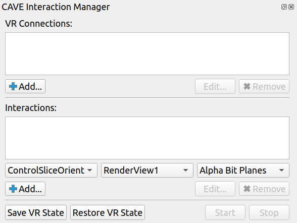

4.15.1.2. CAVE Interaction Manager panel
By default, the CAVE Interaction Manager panel appears on the lower left upon loading the plugin. To open it manually, search for the corresponding checkbox in the main menu via View > CAVE Interaction Manager.
../_images/CAVEDockPanelNoCollab.png
Fig. 4.39 CAVE Interaction Manager panel.
At the highest level, using the plugin is just a matter of configuring VR events and interactions (and likely saving it all to state for easy and quick re-constitution later), and then clicking the “Start” button to start the VR events streaming into your interactor styles.
But as you might guess from looking at the panel above, there are a couple of concepts to understand about CAVE Interactions first: VR Connections and Interactions.

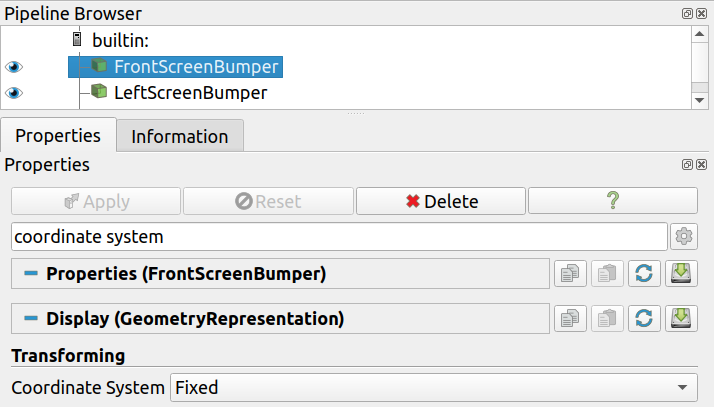

4.15.2.2. Coordinate Systems
There are two main coordinate systems supported in CAVES, termed “Fixed” and “Navigable”. Any pipeline objects can be placed in either coordinate system by toggling advanced properties and/or searching in the properties panel for “coordinate system”.
../_images/RepresentationCoordinateSystem.png
Fig. 4.40 Choosing a coordinate system for representations.
Any pipeline objects placed in the Fixed coordinate system will not move as a result of navigation, while objects placed in the Navigable coordinate system will be transformed by the navigation matrix.
For example, let’s say you wish to place two “screen bumpers” in your scene to mark where your physical displays are located. This could help you avoid accidentally walking into the screens while immersed in your data inside your CAVE.
To accomplish this, you could create two “Box” sources, and use the screen coordinates from your .pvx file to compute the Center and X/Y/Z Length properties of these boxes so that they share the same length as the front and side walls, but have small, fixed width and depth (so they don’t obscure too much of the data you want to see).
Once these are sized and positioned to your satisfaction, you would set their coordinate system to Fixed. Later, when loading your data, you don’t have to do anything special, as the default coordinate system is Navigable, which is likely what you want.
Now, when you call the SetNavigationMatrix in your interactor style proxies, the screen bumpers will remain fixed in place, adjacent to your front and side walls, while you, for example, fly through the rest of your data.

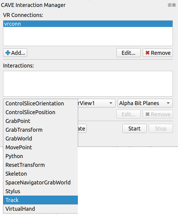

4.15.2.5. Using Interactions
The CAVEInteraction plugin defines a set of interactor styles that can be used out of the box, each of which follows the guidelines above. These built-in styles are available to select from the left-most combo box in the Interactions section of the panel:
../_images/CAVEInteractions.png
Fig. 4.42 Creating an interaction.
Once you have selected an interactor style from the list, you can then select the proxy and property upon which it should act, using the remaining two combo boxes to the right. If the interactor style you chose overrides the GetControlledPropertySize() method, choosing a proxy from the center combo will constrain the properties in the right-most combo so that only the proxy’s properties of that length are shown. Otherwise all of the proxy’s properties are shown in the right-most combo. Once you have set all three the way you want, click the “Add” button. This will bring up a dialog allowing you to define the mapping from your pool of defined events to the “Roles” defined by the interactor style:
../_images/CAVEAddInteraction.png
Fig. 4.43 Configuring the role bindings.
The image above shows what the dialog looks like when the interactor style has only defined one named tracker role, “Tracker”. As you can see, the combo box was automatically filled with one of the events of type “tracker” defined earlier in the VR Connections section of the panel. Clicking “Ok” on the dialog accepts the chosen mapping of event to named role.

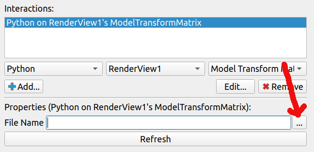

4.15.2.6. Custom Python Interactors
The “Python” interactor style is a recent addition to the built-in collection which gives you complete freedom and power to define your own interactions in Python.
To use this type of interactor style, simply select “Python” in the left-most combo box in the Interactions section of the panel. When you do this, you can just ignore the other two drop-downs, as your Python code will have the ability to update any number of proxies and properties. Once you click the “Add” button and your “Python” interactor style appears in the list, select it, and its “File Name” property editor will appear in the UI, allowing you to select the Python file to use:
../_images/PythonInteractorSelectFile.png
Fig. 4.44 Select Python interactor file.
Any time you change the file, and also any time you click the “Refresh” button in the “File Name” property editor, the selected file will be re-read, and the “Add VR Interaction” dialog will reappear, allowing you to update the event/role bindings.

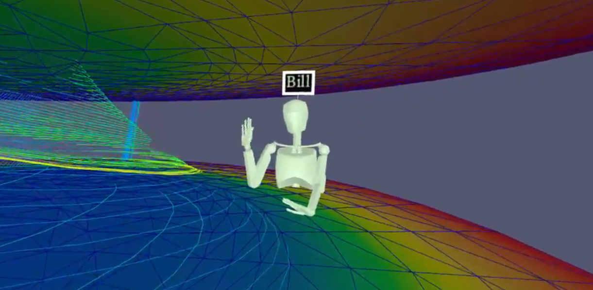

When collaborating with others, you will see an animated avatar representing each connected user, and each avatar will be a unique color (chosen at randrom from a small set of neutral colors) and have a billboard with their name hovering above their head.
../_images/HelloCollaborator.png
Fig. 4.45 A collaborator waving hello.

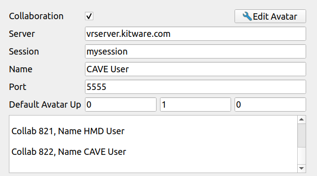

When collaboration is enabled, the CAVEInteraction plugin panel will include a section dedicated to configuring your connection to the collaboration server.
../_images/CollaborationPanel.png
Fig. 4.46 The collaboration configuration panel.
The first thing to note about the collaboration panel is the checkbox that enables/disables collaboration. In the CAVEInteraction plugin, collaboration is handled by the existing event loop, and as such, you begin and end collaborating using the normal Start and Stop buttons described above (assuming the Collaboration checkbox is checked). This is different from the XRInterface plugin, where you must take separate action to connect to the collaboration server when you are already interacting with your data in XR.
In addition to enabling/disabling collaboration, the panel also allows you specify the hostname (or IP address) and port of the collaboration server, the name of a session to join, and your own name (visible to collaborators on a billboard over your avatars head). Once this information is entered and you click Start, you will be collaborating with all users who connect to the same server/port and specify the same session.
Another property you can configure in the panel is the default avatar up vector. In ParaView the default camera is oriented with the positive Y axis pointing up, the positive X axis pointing to your right, and the positive Z axis pointing out of the screen at you. If your data is oriented in such a way that this orientation makes sense, you can leave the default avatar up vector alone. However, if your data is oriented differently, the default avatar up vector allows you to configure the up direction for new avatars joining your collaboration session.
The collaboration section of the CAVEInteraction plugin panel also contains an area for output messages indicating users who have joined or left the collaboration session.
If you don’t see the collaboration panel and you built ParaView yourself, check your build configuration to make sure it is enabled.
