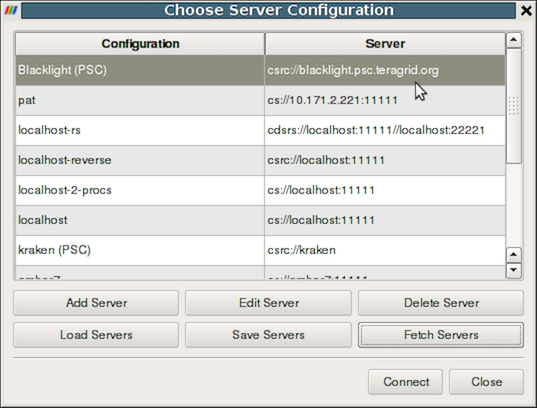

To connect to this server with the paraview client, select File > Connect or click the pqConnect icon in the toolbar to bring up the Choose Server Configuration dialog.
../_images/Server_connect_dialog.png
Fig. 8.12 The Choose Server Configuration dialog is used to connect to a server.
Common Errors
If your server is behind a firewall and you are attempting to connect to it from outside the firewall, the connection may not be established successfully. You may also try reverse connections ( Section 8.4) as a workaround for firewalls. Please consult your network manager if you have network connection problems.
Figure Fig. 8.12 shows the Choose Server Configuration dialog with a number of entries for remote servers. In the figure, a number of servers have already been configured, but when you first open this dialog, this list will be empty. Before you can connect to a remote server, you will need to add an entry to the list by clicking on the Add Server button. When you do, you will see the Edit Server Configuration dialog as in Figure Fig. 8.13.

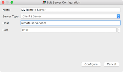

../_images/ParaView_UsersGuide_ConfigureNewServerDialog.png
Fig. 8.13 The Edit Server Configuration dialog is used to configure settings for connecting to remote servers.
You will need to set a name for the connection, the server type, the DNS name of the host on which you just started the server, and the port. The default Server Type is set to Client / Server, which means that the server will be listening for an incoming connection from the client. There are several other options for this setting that we will discuss later.

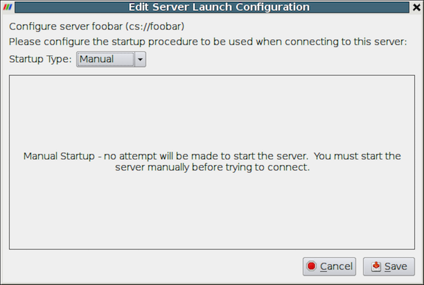

When you are done, click the Configure button. Another dialog, as shown in Fig. 8.14, will appear where you specify how to start the server. Since we started the server manually, we will leave the Startup Type on the default Manual setting. You can optionally set the Startup Type to Command and specify an external shell command to launch a server process.
../_images/ParaView_UsersGuide_ConfigureServerManualDialog.png
Fig. 8.14 Configure the server manually. It must be started outside of ParaView.
When you click the Save button, this particular server configuration will be saved for future use. You can go back and edit the server configuration by selecting the entry in the list of servers and clicking the Edit Server button in the Choose Server Configuration dialog. You can delete it by clicking the Delete button.

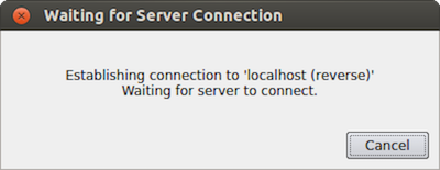

To use a remote connection, two steps must be performed. First, in paraview, a new connection must be configured with the connection type set to reverse. To do this, open the Choose Server Configuration dialog through the File > Connect menu item. Add a new connection, setting the Name to myhost (reverse)'', and select ``Client / Server (reverse connection) for Server Type . Click Configure . In the Edit Server Launch Configuration dialog that comes up, set the Startup Type to Manual . Save the configuration. Next, select this configuration and click Connect . A message window will appear showing that the client is awaiting a connection from the server.
../_images/WaitingForServerConnection.png
Fig. 8.15 Message window showing that the client is awaiting a connection from a server.

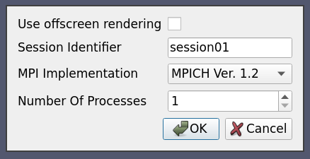

8.5.10. Case Ten: Starting server using custom script with custom user-settable options
This example will illustrate the full capability of server configuration. Suppose we have a custom script “MyServerStarter” that takes in multiple arguments to start the server process. We want the user to be able to set up values for these arguments when he tries to connect to using this configuration. As an example, let’s say MyServerStarter takes the following arguments:
  • --force-offscreen-rendering – to indicate use of offscreen rendering
  • --force-onscreen-rendering – to indicate on-screen rendering (this can be assumed from absence of --force-offscreen-rendering, but we are using it as an example)
  • --session-name=<string> – some string identifying the session
  • --mpitype=<mpich1.2|mpich2|openmpi> – choose between available MPI implementations
  • --num-procs=<num> – number of server processess
  • --server-port – port number passed the pvserver processes
All (except the –server-port) of these must be settable by the user at the connection time. This can be achieved as follows:
<Server name="case10" resource="cs://localhost">
  <CommandStartup>
    <Options>
      <Option name="OFFSCREEN" label="Use offscreen rendering">
        <Boolean true="--use-offscreen" false="--use-onscreen" default="false" />
      </Option>
      <Option name="SESSIONID" label="Session Identifier">
        <String default="session01"/>
      </Option>
      <Option name="MPITYPE" label="MPI Implementation">
        <Enumeration default="mpich1.2">
          <Entry value="mpich1.2" label="MPICH Ver. 1.2" />
          <Entry value="mpich2" label="MPICH Ver 2.0" />
          <Entry value="openmpi" label="Open MPI" />
        </Enumeration>
      </Option>
      <Option name="NUMPROC" label="Number Of Processes">
        <Range type="int" min="1" max="256" step="4" default="1" />
      </Option>
    </Options>
    <Command exec="/path/to/MyServerStarter" delay="5">
      <Arguments>
        <Argument value="--server-port=$PV_SERVER_PORT$" />
        <Argument value="--mpitype=$MPITYPE$" />
        <Argument value="--num-procs=$NUMPROC$" />
        <Argument value="$OFFSCREEN$" />
        <Argument value="--session-name=$SESSIONID$" />
      </Arguments>
    </Command>
  </CommandStartup>
</Server>
Each Option defines a new run-time variable that can be accessed as ${name}$ in the Command section. When the user tries to connect using this configuration, he is shown the following options dialog:
../_images/Server_connection_pvsc_case10.png

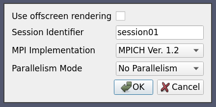

8.5.11. Case Eleven: Case Ten + Switch Statement
This is same as case ten with one change: We no longer allow the user to choose the number of processes. Instead, the number of processes is automatically selected based on the value of the distribution combobox.
<Server name="case11" resource="cs://localhost">
  <CommandStartup>
    <Options>
      </Option>
      </Option>
        </Enumeration>
      </Option>
      <Option name="DISTRIBUTION" label="Distribution Mode">
        <Enumeration default="notDistributed">
          <Entry value="notDistributed" label="Not Distributed" />
          <Entry value="someDistribution" label="Some Distribution" />
          <Entry value="highDistribution" label="Highly Distributed" />
        </Enumeration>
      </Option>
      <Switch name="DISTRIBUTION">
        <Case value="notDistributed">
          <Set name="NUMPROC" value="1" />
        </Case>
        <Case value="someDistribution">
          <Set name="NUMPROC" value="2" />
        </Case>
        <Case value="highDistribution">
          <Set name="NUMPROC" value="10" />
        </Case>
      </Switch>
    </Options>
      <Arguments>
      </Arguments>
    </Command>
  </CommandStartup>
</Server>
../_images/Server_connection_pvsc_case11.png
The Switch statement can only have Case statements as children, while the Case statement can only have Set statements as children. Set statements are not much different from Option except that the value is fixed and the user is not prompted to set that value.

  • The <ManualStartup> tag indicates that the user will manually start the given server prior to connecting.

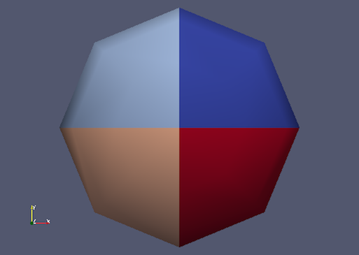

To see how this data is distributed, run pvserver as the command above and connect to it with paraview. Next, create another Sphere source using Source > Sphere. Change the array to color by to vtkProcessId . You will see an image like Figure Fig. 8.16.
../_images/SphereColoredByProcessId.png
Fig. 8.16 Sphere source colored by vtkProcessId array that encodes the processing core on which the sphere data resides. Here, the sphere data is split among the four processing cores invoked by the command mpirun -np 4 pvserver.

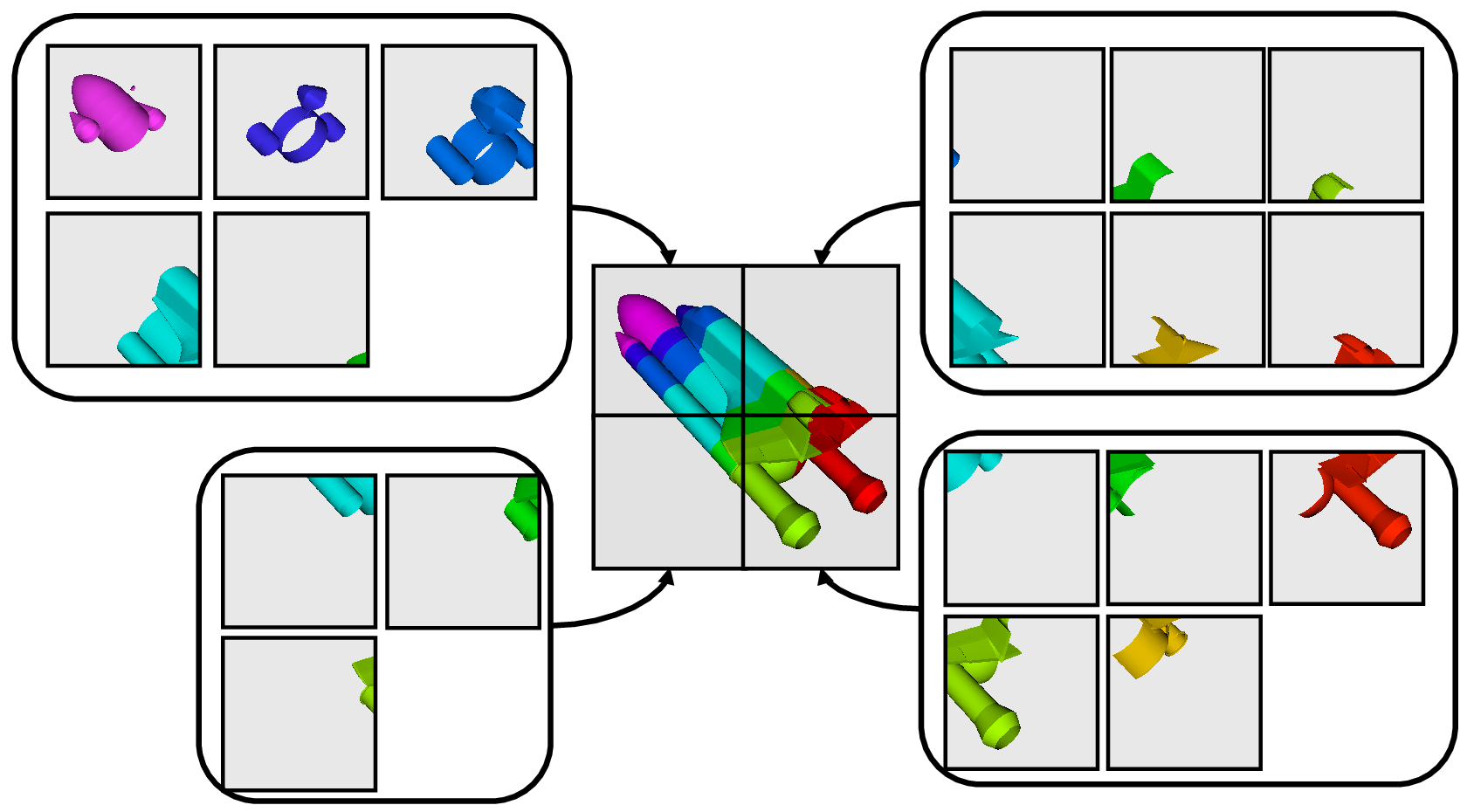

../_images/ParallelRenderingTiles.png
IceT also has the ability to drive tiled displays, which are large, high-resolution displays comprising an array of monitors or projectors. Using a sort-last algorithm on a tiled display is a bit counterintuitive because the number of pixels to composite is so large. However, IceT is designed to take advantage of spatial locality in the data on each process to drastically reduce the amount of compositing necessary. This spatial locality can be enforced by applying the Filters > Alphabetical > D3 filter to your data.
