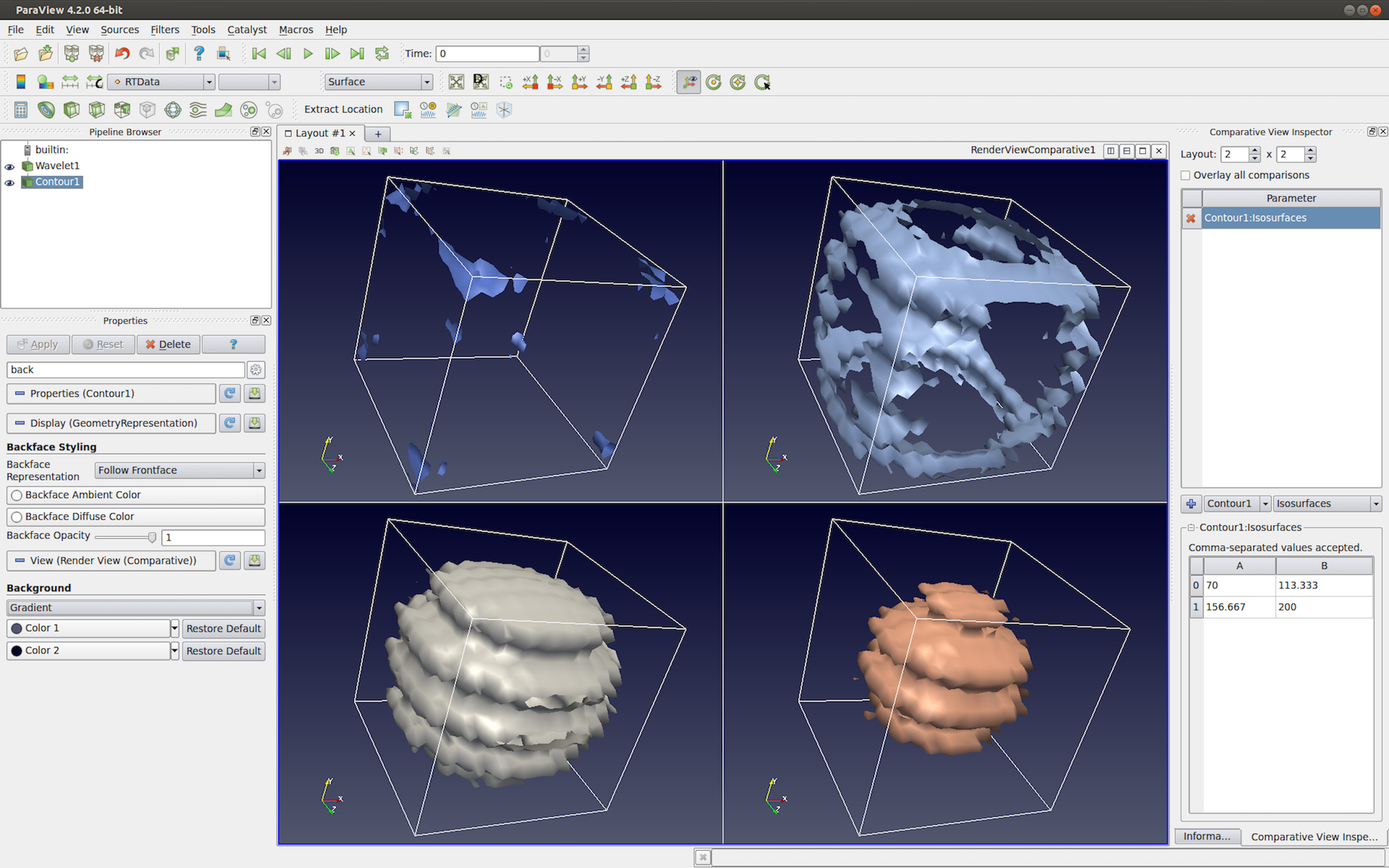

../_images/ComparativeRenderView.png
Fig. 5.30 Render View (Comparative) in paraview showing a parameter study. In this case, we are comparing the visualization generated using different isovalues for the Contour filter. The Comparative View Inspector dockpanel (on the right) is used to configure the parameter study.

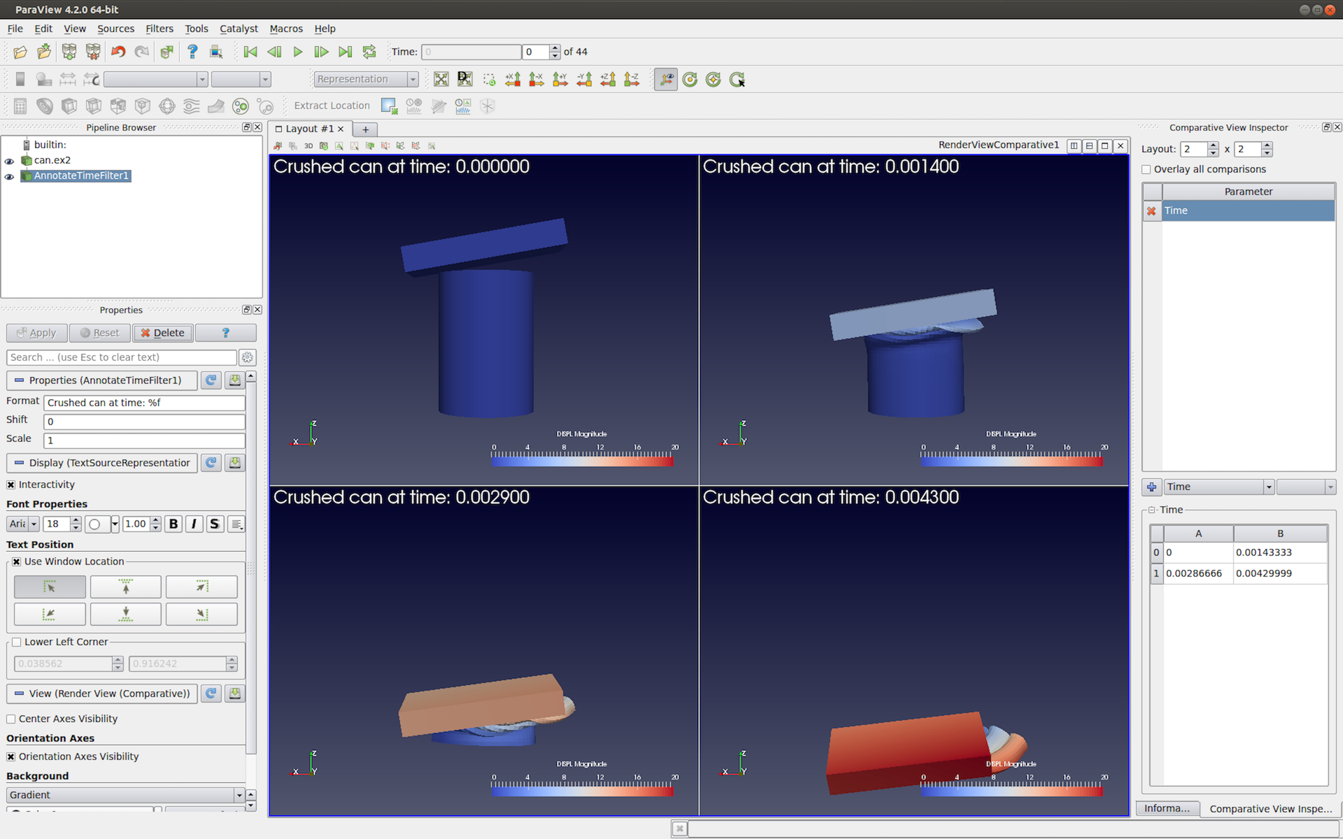

../_images/ComparativeViewWithTime.png
Fig. 5.32 Render View (Comparative) with Annotate Time filter showing the time for each of the views. In this case, the parameter study is varying Time across the views.
To understand how to setup a parameter study, let’s go back to our original example. Our visualization pipeline is simply Wavelet \(\rightarrow\) Contour (assuming default property values), and we are showing the result from the Contour filter in the \(2 \times 2\) Render View (Comparative) with Overlay all comparisons unchecked.
Now, we want to vary the Isosurfaces property value for the visualization in each of the internal views. That’s our parameter to study. Since that’s a property on the Contour filter, we select the Contour filter instance. Then, its property Isosurfaces is in the parameter selection combo-boxes. To add the parameter to the study, you must hit the Plus button.
The parameter Contour1:Isosurfaces will then show up in the Parameter list above the combo-boxes. You can delete this parameter by using the pqDelete button next to the parameter name.

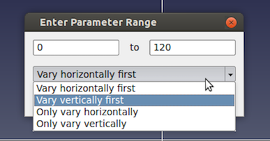

To change the parameter (in our case Isosurfaces ) value, you can double click on the cell in the table and change it one at a time. Also, to make it easier to fill the cells with a range of values, you can click and drag over multiple cells. When you release the mouse, a dialog will prompt you to enter the data value range ( Fig. 5.33). In case you selected a combination of rows and columns, the dialog will also let you select in which direction the parameter is varied using the range specified. You can choose to vary the parameter horizontally first, vertically first, or only along one of the directions while keeping the other constant. This is useful when doing a study with multiple parameters.

Fig. 5.33 Dialog used to select a range of parameter values and control how to vary them in paraview.

You can use the Annotate Time source or filter to show the data time or the view time in each of the internal views. If Time is one of the parameters in your study, the text will reflect the time values for each of the individual views, as expected ( Fig. 5.32)!
