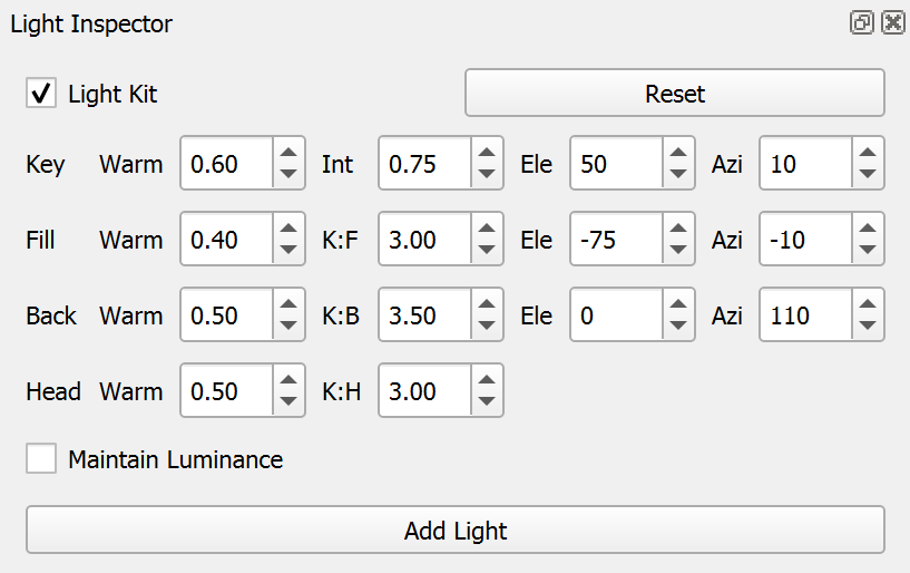

../_images/LightInspectorPanel.png
Fig. 3.17 The Light Inspector panel showing the default Light Kit.

The following parameters can be set in the UI:
  • Light Kit: Checkbox to toggle all kit lights on or off.
  • Reset: Restores all kit lights to their default settings.
  • Maintain Luminance: When checked, intensity is adjusted based on perceived color brightness.
Each light in the kit includes configurable parameters:
  • Warm: Sets the color of the light along a warmth scale from 0 (cold blue) to 1 (warm red). A value of 0.5 is neutral white.
  • Int: The intensity of the key light (0 = off, 1 = full intensity).
  • K:F, K:B, K:H: Ratios for key-to-fill, key-to-back, and key-to-headlight intensities. Higher values result in dimmer secondary lights. Recommended ranges are:
    • K:F: 2-10
    • K:B: 2-10
    • K:H: 2-15
  • Ele (Elevation) and Azi (Azimuth): Define the vertical and horizontal angles of each light relative to the camera’s lookat point, defined in degrees. For example:
    • (Elevation=90, Azimuth=0): directly above the scene.
    • (Elevation=0, Azimuth=0): at the camera (i.e., a headlight).
    • (Elevation=45, Azimuth=-20): above and in front, slightly to the left.
The Light Kit is built on top of the vtkLightKit class. For further details read here.

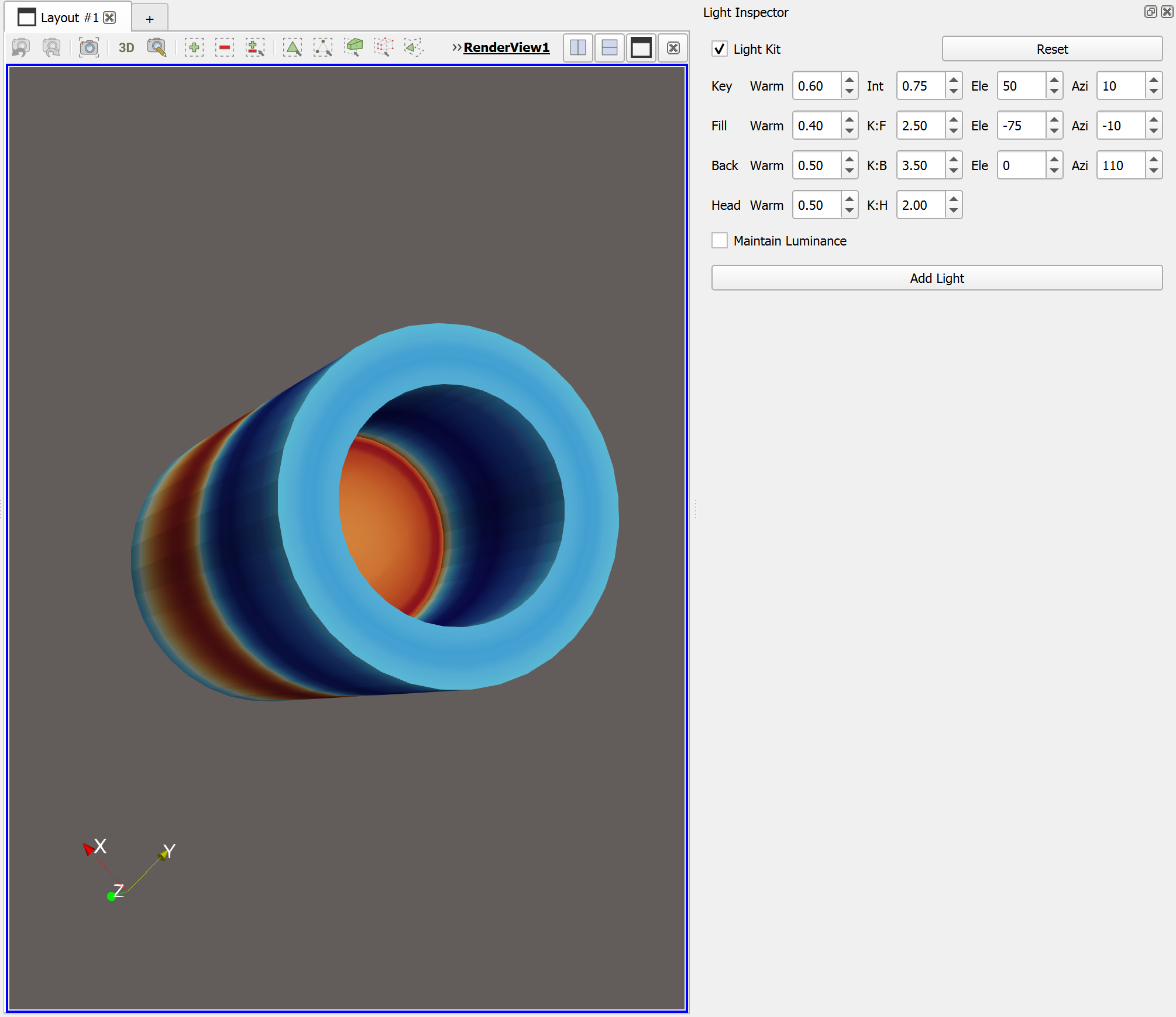

../_images/LightInspectorDiskDefault.png
Fig. 3.18 The rendered dataset, illuminated with the default scene lighting.
The Light Kit is enabled by default, but we can customize its behavior. While the default settings are generally suitable, we’ll explicitly set each option below to demonstrate how the kit can be tuned for different lighting effects:

../_images/LightInspectorDiskWithLightKit.png
Fig. 3.19 The same data, now visualized with the modified Light Kit configuration.
We’ll also add individual custom lights, which behave independently from the Light Kit. We add one positional light to illuminate the middle of the hollow side of the cylinder, and another directional light to brighten the side of the cylinder and increase the overall contrast.
