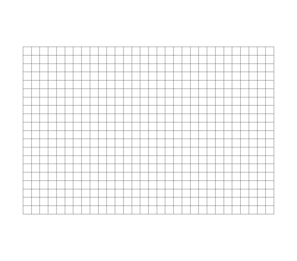

3.1.3. Uniform rectilinear grid (image data)
Fig. 3.4 Example uniform rectilinear grid.
A uniform rectilinear grid, or image data, defines its topology and point coordinates implicitly (Fig. 3.4). To fully define the mesh for an image data, VTK uses the following:
Extents - These define the minimum and maximum indices in each direction. For example, an image data of extents \((0, 9)\), \((0, 19)\), \((0, 29)\) has 10 points in the x-direction, 20 points in the y-direction, and 30 points in the z-direction. The total number of points is \(10 \times 20 \times 30\).
Origin - This is the position of a point defined with indices \((0, 0, 0)\).
Spacing - This is the distance between each point. Spacing for each direction can defined independently.
The coordinate of each point is defined as follows: \(coordinate = origin + index \times spacing\) where \(coordinate\), \(origin\), \(index\), and \(spacing\) are vectors of length 3.
Note that the generic VTK interface for all datasets uses a flat index. The \((i,j,k)\) index can be converted to this flat index as follows: \(idx\_flat = k \times (npts_x \times npts_y) + j \times nptr_x + i\).
A uniform rectilinear grid consists of cells of the same type. This type is determined by the dimensionality of the dataset (based on the extents) and can either be vertex (0D), line (1D), pixel (2D), or voxel (3D).
Due to its regular nature, image data requires less storage than other datasets. Furthermore, many algorithms in VTK have been optimized to take advantage of this property and are more efficient for image data.

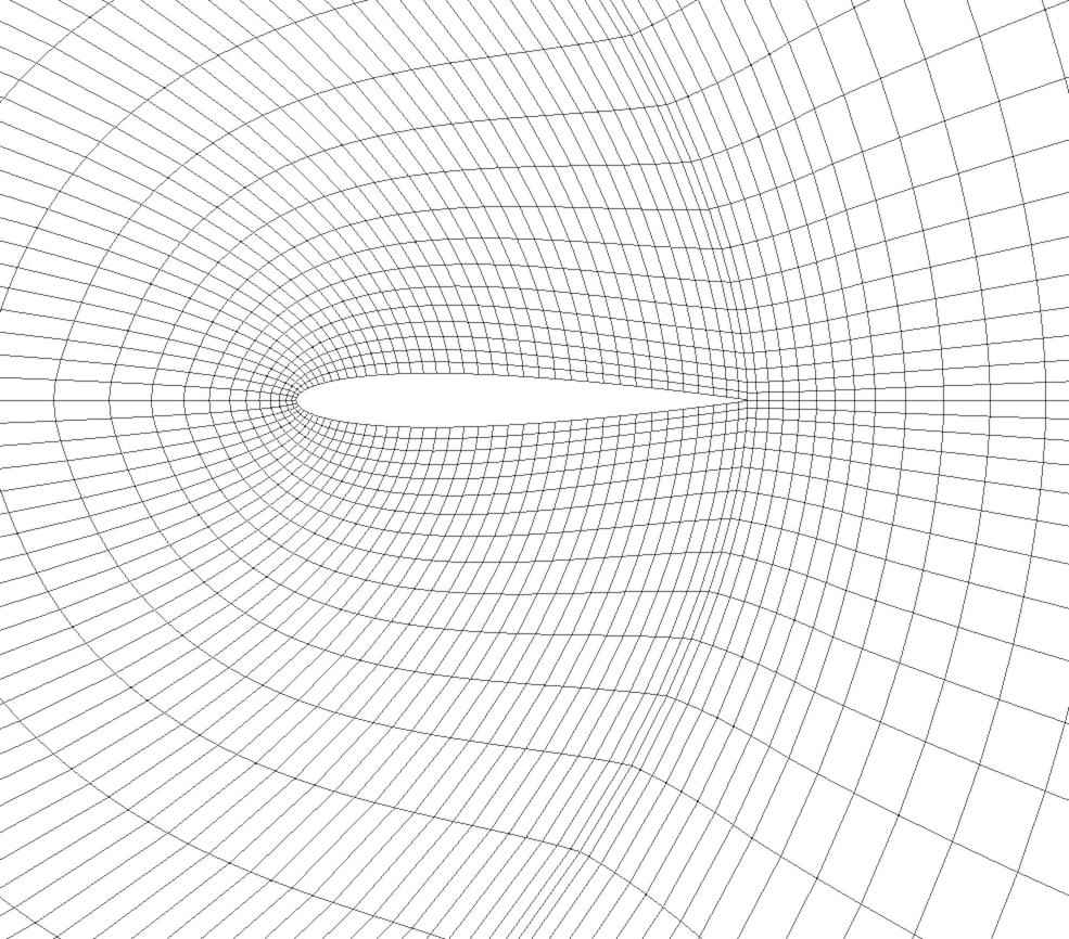

3.1.5. Curvilinear grid (structured grid)
Fig. 3.6 Curvilinear or structured grid.
A curvilinear grid, such as Fig. 3.6, defines its topology implicitly and point coordinates explicitly. To fully define the mesh for a curvilinear grid, VTK uses the following:
Extents - These define the minimum and maximum indices in each direction. For example, a curvilinear grid of extents \((0, 9)\), \((0, 19)\), \((0, 29)\) has \(10 \times 20 \times 30\) points regularly defined over a curvilinear mesh.
An array of point coordinates - This array stores the position of each vertex explicitly.
The coordinate of each point is defined as follows: \(coordinate = coordinate\_array(idx\_flat)\). The \((i,j,k)\) index can be converted to this flat index as follows: \(idx\_flat = k \times (npts_x \times npts_y) + j \times npts_x + i\).
A curvilinear grid consists of cells of the same type. This type is determined by the dimensionality of the dataset (based on the extents) and can either be vertex (0D), line (1D), quad (2D), or hexahedron (3D).

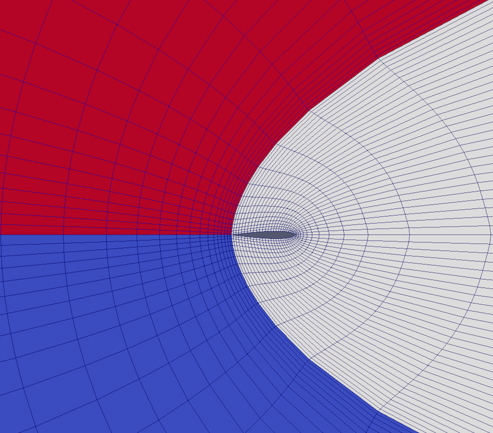

3.1.6. AMR dataset
Fig. 3.7 AMR dataset.
VTK natively supports Berger-Oliger type AMR datasets, as shown in Fig. 3.7. An AMR dataset is essentially a collection of uniform rectilinear grids grouped under increasing refinement ratios (decreasing spacing). VTK’s AMR dataset does not force any constraint on whether and how these grids should overlap. However, it provides support for masking (blanking) sub-regions of the rectilinear grids using an array of bytes. This allows VTK to process overlapping grids with minimal artifacts. VTK can automatically generate the masking arrays for Berger-Oliger compliant meshes.

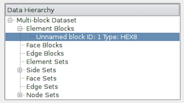

3.1.10. Multiblock dataset
Fig. 3.11 Multiblock dataset.
You can think of a multiblock dataset (Fig. 3.11) as a
tree of datasets where the leaf nodes are simple datasets. All of the
data types described above, except AMR, are simple datasets. Multiblock
datasets are used to group together datasets that are related. The relation
between these datasets is not necessarily defined by ParaView. A multiblock
dataset can represent an assembly of parts or a collection of meshes of
different types from a coupled simulation. Multiblock datasets can be loaded or
created within ParaView using the Group filter. Note that the leaf nodes of a

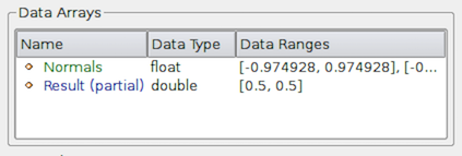

multiblock dataset do not all have to have the same attributes. We call attributes
that are not present on all blocks of a multiblock dataset partial attributes
or partial arrays If you apply a filter that requires an attribute, it will be
applied only to blocks that have that attribute.

you will notice that the Data Arrays table lists an array with the suffix
(partial) (Figure Fig. 3.14).
Such arrays are referred to as partial arrays. Partial arrays
is a term used to refer to arrays that are present on some non-composite
blocks or leaf nodes in a composite dataset, but not all. The (partial)
suffix to indicate partial arrays is also used by paraview in other
places in the UI.
Fig. 3.14 The Data Arrays section on Information panel showing partial arrays. Partial arrays are arrays that present on certain blocks in a composite dataset, but not all.
While summaries over all of the datasets in the composite dataset are useful,
you may also want to look at the data information for individual blocks.
To do so, you can use the Data Hierarchy group, which appears when
summarizing composite datasets. The Data Hierarchy widget shows the
structure or hierarchy of the composite dataset
(Figure Fig. 3.15). The Information panel
switches to showing the summaries for the selected sub-tree.
By default, the root element will be selected. You can now select any block in
the hierarchy to view the summary limited to just that sub-tree.
Fig. 3.15 The Data Hierarchy section on the Information panel showing
the composite data hierarchy. Selecting a particular block or subtree in this
widget will result in the reset of the Information panel showing
summaries for that block or subtree alone.

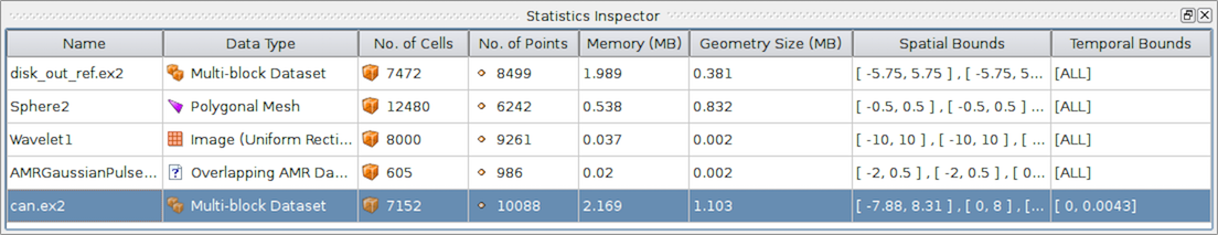

3.2.2. The Statistics Inspector panel
The Information panel shows data information for the active source. If you
need a quick summary of the data produced by all the pipeline modules, you can
use the Statistics Inspector panel. It’s accessible from
Views > Statistics Inspector.
Fig. 3.16 The Statistics Inspector panel in paraview showing summaries for all pipeline modules.
All of the information on this panel is also presented on the Information
panel, except Geometry Size . This corresponds to how much memory is
needed for the transformed dataset used for rendering in the active view. For example, to
render a 3D dataset as a surface in the 3D view, ParaView must extract the
surface mesh as a polydata. Geometry Size represents the memory needed for
this polydata with the same memory-size-related caveats as with the
Information panel.
