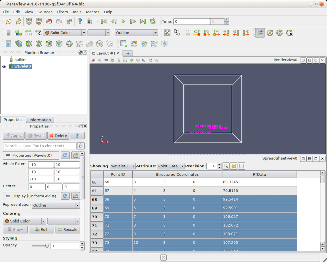

To make this easier, let’s try a quick demo:
Starting with a fresh paraview session, create a sample dataset using the Sources > Alphabetical > Wavelet menu, and then click the Apply button. If you are using paraview with a default setup, that should result in a dataset outline being shown in the default Render View . Next, let’s split the view and create SpreadSheet View . The SpreadSheet View will automatically show the data produced by the Wavelet source. Upon closer inspection of the header in the SpreadSheet View , we see that the view is showing the Point Data or point attributes associated with the dataset. Now we have the same dataset, the data produced by the Wavelet source, shown in two views. Now, highlight a few rows in the SpreadSheet View by clicking on them. As soon as you start selecting rows, the Render View will start highlighting some points in space as tiny magenta specks ( Fig. 6.1). That’s linked selection in action! What is happening is that, as you highlight rows in the SpreadSheet View , you are creating a selection for selecting points (since the view is showing Point Data ) corresponding to the rows. Due to the linking of selections between views, any other view that is showing the dataset (in this case, the Render View ) will also highlight the selected points.
Of course, if you want to select cells instead of points, switch the SpreadSheet View to show cells by flipping the Attribute combo-box to Cell Data and then highlight rows. The Render View will show the selected cells as a wireframe, rather than points.
Conversely, you could have created the selection in the Render View , and the SpreadSheet View will also highlight the selected elements. We will see how to create such selection later in this chapter.

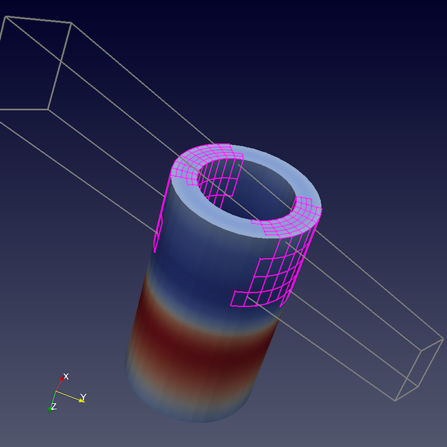

../_images/FrustumCellSelection.png
Fig. 6.2 Result of a frustum cell selection on disk_out_ref.ex2 dataset showing the frustum used to identify selected cells. All cells that fall in that frustum or that intersect it are selected, irrespective of whether they were visible from the view angle when the selection was made.

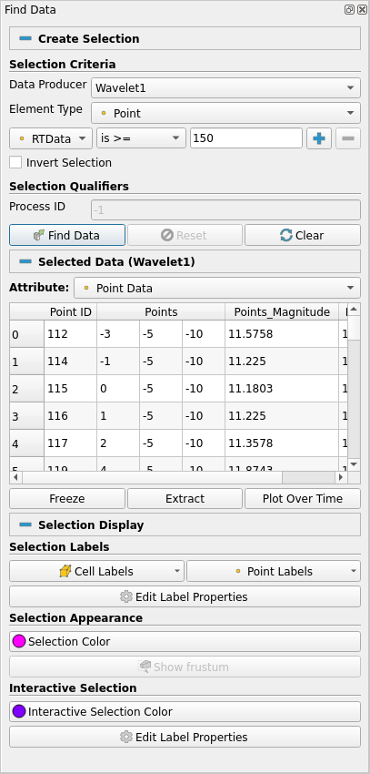

6.3. Creating selections using the Find Data panel
Views provide mechanisms to create selections interactively. Selections in chart views and SpreadSheet View can be used to select elements with certain data properties, rather than spatial locations ( Fig. 6.3). For a richer data-based selection for selecting elements matching certain criteria, you can use the Find Data mechanism in paraview.
The Find Data panel can be accessed from the Edit menu, View menu, or by using the keyboard shortcut V or the pqFindData button on the Main Controls toolbar. The Find Data panel can be split into three sections, reflecting how you would use this dialog. The Create Selection section helps you define the selection criteria. This identifies which elements, cells or points, are to be selected. The Selected Data section shows the results from the most recent selection. They are shown in a tabular view similar to the Spreadsheet view. Finally, the Selection Display section lets you change how the selected elements are displayed in the active view.
../_images/FindDataPanel.png
Fig. 6.4 The Find Data panel can be used to find data elements matching specific conditions. In this example, we are selecting all Points in Wavelet1 dataset where RTData is \(>= 150\).
You can create selections in the Find Data panel using the widgets under the Create Selection section. First, choose the data producer. This is the source or filter from which you want to select elements from. Next choose the element type. If you want to select cells, choose Cell, for points choose Point and so on. The next step is to define the selection criteria. The left-most combo-box is used to select the array of interest. The available options reflect the data array currently available on the dataset. The next combo-box is used to select the operator. Options include the following:
  • is matches a single value
  • is in range matches a range of values specified by min and max
  • is one of matches a list of comma-separated values
  • is >= matches all values greater than or equal to the specified value
  • is <= matches all values lesser than or equal to the specified value
  • is min matches the minimum value for the array for the current time step
  • is max matches the maximum value for the array for the current time step
  • is <= mean matches values lesser than or equal to the mean
  • is >= mean matches values greater than or equal to the mean
  • is mean matches values equal to the mean within the specified tolerance
Based on your selection of the operator, input widgets will be shown next to this combo-box, where you enter the corresponding values. For example, for is between, you enter the min and max values for defining the range in the two text entry widgets.
Multiple selection criteria can be combined together. For example, you want to select all points with Temp >= 100 and Pres <= mean, simply setup two expressions using the Plus button.
Once you are satisfied with the selection criteria, hit the Find Data button. On success, the Current Selection spreadsheet will update to show the selected elements. Use the Attribute combo-box to change which element types are shows in the spreadsheet.
Similar to selecting in views, once you create a selection, any view showing the selected data will also highlight the selected elements, if possible. For example, the Render View will show a colored wireframe marking the selected elements, SpreadSheet View will highlight the rows, and so on. The Selection Display section lets you change how the selection is displayed in the active view. Currently, it is primarily designed for Render View. In the future, however, it could support changing selection attributes for other views as well. The available options allow you select the color to use to show the selected elements, as well as the data attributes to use to label the cells/points. For finer control on the label formatting, color, font, etc., toggle the pqAdvanced button on. That will pop up the Edit Label Properties dialog ( Fig. 6.5).

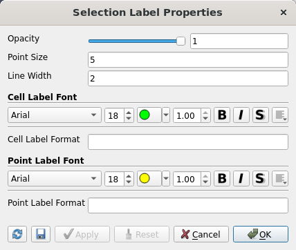

../_images/SelectionLabelPropertiesDialog.png
Fig. 6.5 Selection Label Properties dialog for controlling selection labelling parameters.

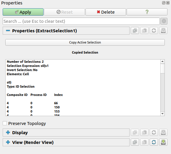

The Extract Selection filter is used to extract the selected elements as a new dataset for further filtering. There are multiple ways of creating this filter. You can use the conventional method for creating filters, i.e., using the Filters menu. When the filter is created, if there is any active selection, the filter will automatically copy that selection for convenience. Another way to extract the active selection is using the Extract button in the Find Data panel ( Fig. 6.4).
The Properties panel shows what defines the selection. You can update the selection by making a new active selection using any of the mechanisms described earlier in this chapter and then clicking on the Copy Active Selection button on the Properties panel for the Extract Selection filter.
By default, the filter is set up to extract the selected elements alone. This filter also supports passing the entire input dataset through by simply marking which elements are selected. For that, check the Preserve Topology check box on the Properties panel.

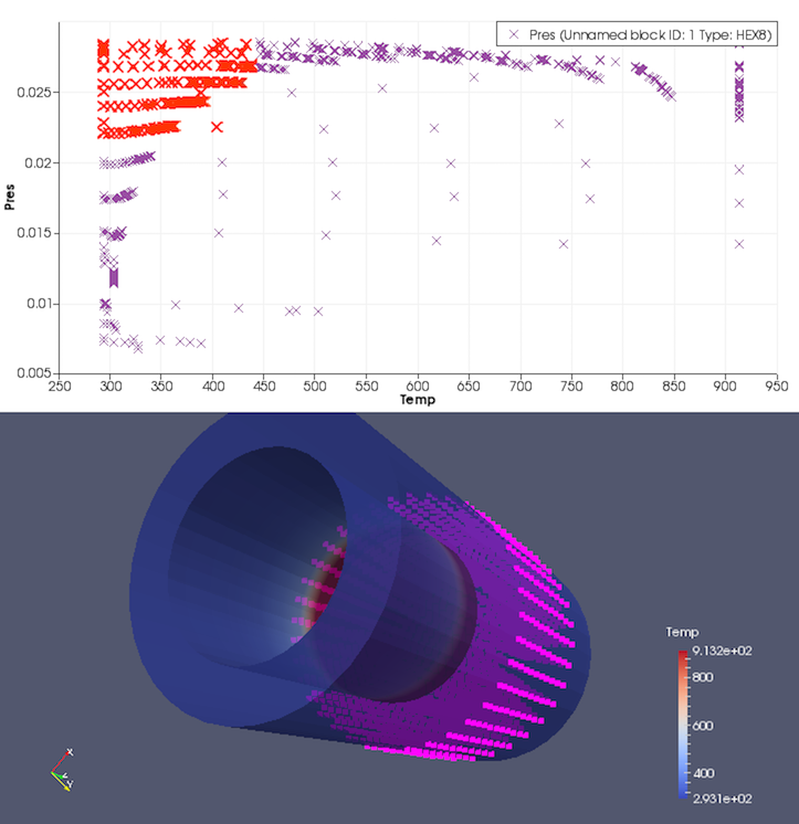

../_images/PlotSelectionOverTime.png
Fig. 6.7 Plot Selection Over Time in action in paraview. The filter provides a convenient way to plot changes in attributes over time for the selected set of cells or points in a temporal dataset.
Plot Selection Over Time is similar to Extract Selection in the sense that it too extracts the selected elements from the input dataset. However, instead of simply extracting the result, the goal here is to plot attributes at the selected elements over time.
Fig. 6.7 shows an example use of this filter. In this case, we wanted to see how the strain (or EQPS) cell attribute changes over time for two specific cells that we selected in the Render View using the view-based selection mechanism. The selected cells are the highlighted elements in the left view. After having selected the cells, we create the Plot Selection Over Time filter using the Filters > Data Analysis menu. (You could also use the pqPlotSelectionOverTime from the Data Analysis toolbar.) Similar to the Extract Selection filter, when this filter is created, it copies the active selection. You can change it afterwards using the Copy Active Selection button on the filter’s Properties panel. On hitting Apply , paraview will show a visualization similar to the one shown here.
Instead of using the view for defining the selection, you could have used the Find Data panel. In that case, instead of being able to plot each element over time, you will be plotting summaries for the selected subset over time. This is essential since the selected subset can have a varying number of elements over time. The summaries include quantities like mininum, maximum, and median of available variables. You can make the filter always produce these statics alone (even when the selection is created by selecting specific elements in a view) by checking the Only Report Selection Statistics property on the Properties panel for the Plot Selection Over Time filter.

../_images/SelectionEditorViewResult.png
Fig. 6.9 The result of combining the selections as shown in Fig. 6.8.
