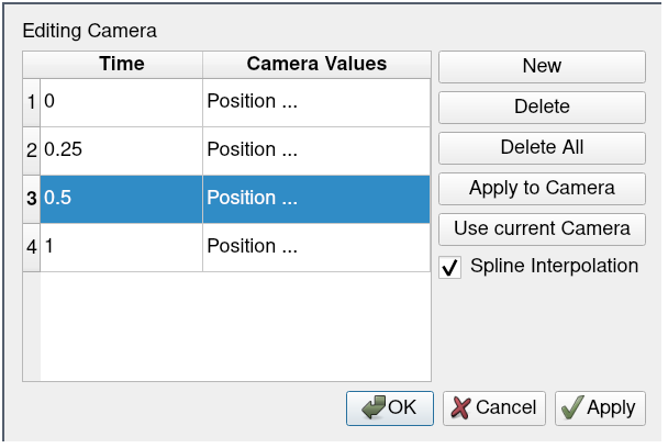

Animation Keyframes dialog. Double-clicking in the camera entry brings up a
dialog like the one in Fig. 7.3.
Fig. 7.3 Editing the camera track.
From the Animation Keyframes dialog, you can press New to create new keyframes.
You can also press Delete or Delete All to delete some or all of the keyframes. Clicking New will
add a new row to the table. In any row, you can click within the Time column to
choose a particular time for the keyframe, and you can click in the right-hand column to
enter values for the parameter. The exact user interface components that let you
set values for the property at the keyframe time vary. When available, you can
change the interpolation between two keyframes by double-clicking on the central
interpolation column.

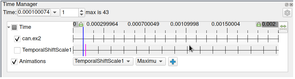

In the figure, the main timeline has 12 ticks. They do not match the times from the data, as expected for a sequence.
Fig. 7.6 Time Manager Snap to timesteps.
In Snap To TimeSteps mode, the number of frames in the animation is
determined by the number of time values in the dataset being animated and thus cannot be changed.
This is the animation mode used by default by ParaView when a dataset with time values is loaded.
Then playing the animation means playing through the time values of the dataset one after the other.
This is enabled when at least one Time track is checked.
In the figure, only can.ex2 is checked so the scene knows only about its timesteps:
the main timeline has same ticks as the can.ex2 track.

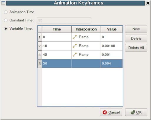

If you double-click in the TimeKeeper – Time track, the Animation Keyframes
dialog, an example of which is shown in Fig. 7.7, appears. In this dialog,
you can make data time progress in three fundamentally different ways. If the
Animation Time radio-button is selected, the data time will be tied to and
scaled with the animation time so that, as the animation progresses, you will see
the data evolve naturally. If you want to ignore the time varying nature of the data,
you can select Constant Time instead. In this case, you choose a
particular time value at which the data will be displayed for the duration of
the animation. Finally, you can select the Variable Time radio-button to have
full control over data time and to control it as you do any other animatable
property in the visualization pipeline. In the example shown in
Fig. 7.7, time is made to progress forward for the
first 15 frames of the animation, backward for the next 30, and forward
for the final 15.
Fig. 7.7 Controlling Data Time with keyframes.

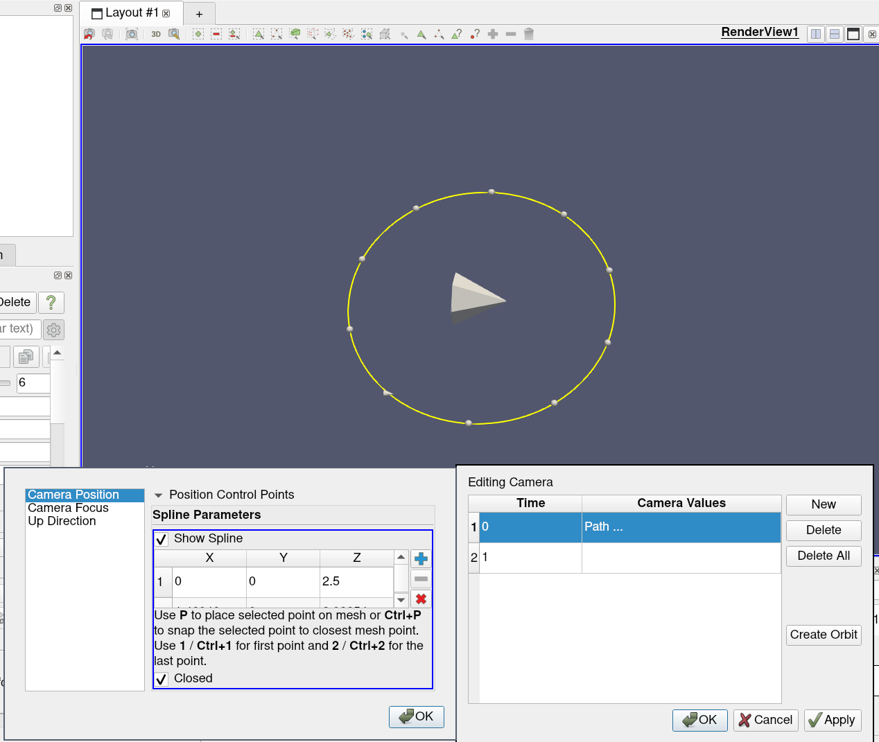

7.4.3. Follow path
In this mode, you get the opportunity to specify the path taken by the camera position and the camera focal point. By default, the path is set up to orbit around the selected objects. You can then edit the keyframe to change the paths. This is the preferred mode if you want to control the global motion more than exact points of view.
Fig. 7.9 shows the dialog for editing these paths for a keyframe. When Camera Position or Camera Focus is selected, a widget is shown in the 3D view that can be used to set the path. Use CTRL + Left Click to insert new control points, and ⇧ + Left Click to remove control points. You can also toggle when the path should be closed or not.
Fig. 7.9 Creating a camera path.

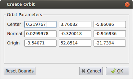

This mode makes it possible to quickly create a camera animation in which the
camera revolves around objects of interest. Clicking on the Orbit button
will pop up a dialog where you can edit the orbit parameters such as the
center of revolution, the normal for the plane of revolution, and the origin (i.e., a
point on the plane where the revolution begins). By default, the Center is the
center of the bounds of the selected objects, the Normal is the current up direction
used by the camera, while the origin is the current camera position.
