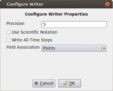

On accepting a filename and file format to use, paraview may show the Configure Writer dialog (Fig. 8.2). This dialog allows you to further customize the writing process. The properties shown in this dialog depend on the selected file format and range from enabling you to Write All Time Steps , to selecting the attributes to write in the output file.
../_images/ConfigureWriterDialogCSV.png
Fig. 8.2 Configure Writer dialog in paraview shown when saving a dataset as a csv file.

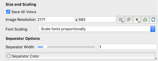

If the active tab has more than one view, then the Save Screenshot Options dialog has a few more options as shown in Fig. 8.4.
../_images/SaveScreenshotOptionsMultiView.png
Fig. 8.4 Extra options in Save Screenshot Options dialog available when the active tab has more than 1 view.
  • Save All Views : Check this to save all the views in the active tab laid out exactly as in the UI. If unchecked, only the active view will be saved.
  • Separator Options : These control the separator drawn between the views in the generated image. You can specify the Separator Width in approximate pixels as well as the Separator Color .

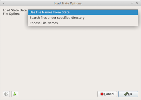

To load a state file, you use the File > Load State… menu. Note that loading a state file will affect the current visualization state.
../_images/LoadStateOptions.png
Fig. 8.7 The Load State Options dialog in paraview showing the options for where to find data files.
If you load a PVSM file this way you will be asked where to search for the data files. There are three available options: Use File Names From State , Search files under specified directory and Choose File Names . If you select Use File Names From State then ParaView will look for the data at the absolute paths saved in the state file. If you select Search files under specified directory then you will see an option to browse for a directory that ParaView will search for the files before looking for them in the absolute path in the state file. This defaults to the location of the state file to make sharing state files between computers easier. If you select Choose File Names then you will be given a list of file names in the state file and can override each one individually.
../_images/LoadStateOptionsDataDirectory.png
Fig. 8.8 The Load State Options dialog in paraview showing the Search files under specified directory option.

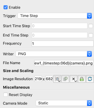

8.5.1. Extractor Properties
../_images/ExtractGeneratorPropertiesPanel.png
Fig. 8.9 Properties of an image extractor for PNG files.
You use the Properties panel view and change extractor properties. The available properties can be grouped into two major groups: first are Trigger properties which are common to all extractors, and the second are the Writer properties which are parameters specific to type of writer the extractor uses.
Trigger properties define when the extractor is activated i.e. under what conditions does the extractor produce extracts. Currently, we support time-based controls. You can select the Start Time Step, End Time Step or the Frequency at which to generate the results. Frequency is the number of timesteps per activation. To write every other timestep, set the Frequency to 2, to write every 3rd timestep, set it to 3, and so on.
Writer properties are specific to the writer. For data extractors, these will be similar to the writer properties shown in the Configure Writer dialog for the writer described in Section Section 8.1. For image extractors, they are similar to the Save Screenshot Options dialog described in Section Section 8.2.1. The Writer properties also lets you set a File Name . This is the file name to use to save the extracts. Since extractors are designed to generate a new extract every time they are activated, the File Name supports patterns that let you make the filename unique per activation. {timestep} or {time} in the filename are replaced by the timestep index and the time value for each activation. You add leading zeros (or other prefixes) to the numbers using a form such as {timestep:06d}. There the timestep will be padded with zeros if the number of digits is less than 6. You should not use absolute paths for specifying the filenames here. We will see how to select prefix to store these extracts under in the next section.
