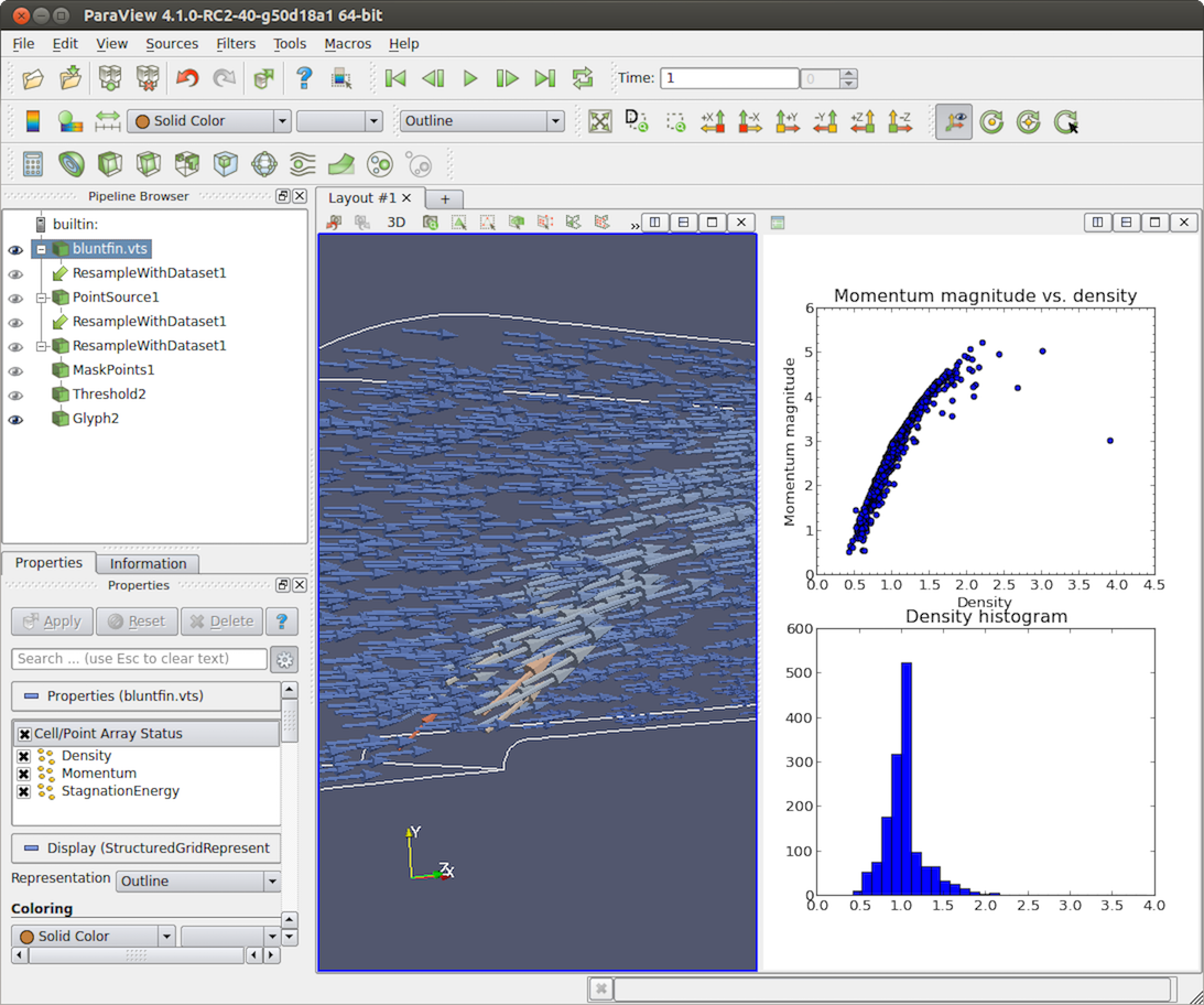

4.1. Multiple views
../_images/MultipleViewsInParaView.png
Fig. 4.1 Using multiple views in paraview to generate different types of visualizations from a dataset.

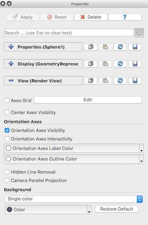

4.4.2.3. View properties
Several of the view properties in Render View control the annotations shown in the view (Fig. 4.3).
../_images/RenderViewPropertiesPanel.png
Fig. 4.3 The Properties panel showing view properties for Render View .
Axes Grid refers to an annotation axis rendered around all datasets in the view (Fig. 4.4). You use the checkbox next to the Edit Axis Grid button to show or hide this annotation. To control the annotation formatting, labels, etc., click on the Edit Axes Grid... button. The Axes Grid is described in Chapter Section 11.
../_images/RenderViewAxesGrid.png
Fig. 4.4 Axes Grid is used to annotate data bounds in Render View .
The Center axes refers to axes rendered in the scene positioned as the center of rotation, i.e., the location is space around which the camera revolves during Rotate camera interaction. Center Axes Visibility controls the visibility of the center axes.
The Orientation axes is the widget shown at the lower-left corner by default, which is used to get a sense for the orientation of the scene. The properties grouped under the Orientation Axes group allow you to toggle the visibility and the interactivity of this widget. When interactivity is enabled, you can click and drag this widget to the location of your choosing in the scene.
You can also change the Background used for this view. You can either set it as a Single color or as a Gradient changing between two colors, or you can select an Image (or texture) to use as the background.
There are two advanced properties you may wish to set: hidden line removal and camera parallel projection. The Hidden Line Removal option can be enabled to hide lines that would be occluded by a solid object when drawing objects in a Wireframe representation. If you want to render your data using parallel projection instead of the default perspective projection you can check the Camera Parallel Projection checkbox.

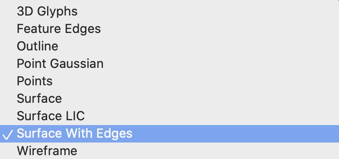

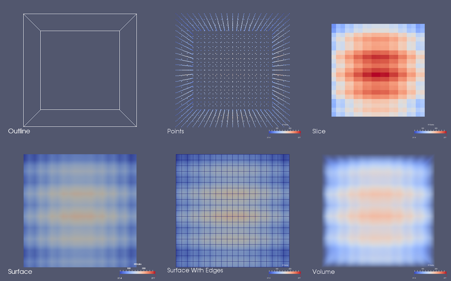

One of the first (and probably the most often used) display properties is Representation . Representation allows you to pick one of the mapping modes. The options available depend on the data type, as well as the plugins loaded. While all display properties are accessible from the advanced view for the Properties panel, certain properties may be shown/hidden from the default view based on the chosen representation type.
../_images/WaveletRepresentations.png
Fig. 4.5 Different renderings generated by rendering data produced by the Wavelet source as outline, points, slice, surface, surface with edges, and volume.
The Outline representation can be used to render an outline for the dataset. This is arguably the fastest way of rendering the dataset since only the bounding box is rendered. Scalar coloring options, i.e., selecting an array with which to color, has no effect on this representation type. You can still, however, change the Solid Color to use as well as the Opacity . To change the color, select Solid Color in the combo-box under Coloring , and then click Edit to pick the color to use. To change the opacity, simply change the Opacity slider. 0 implies total transparency and, hence, invisiblity, while 1 implies totally opacity.

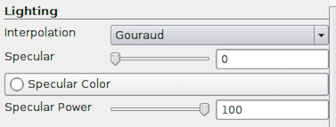

../_images/RenderViewDisplayPropertiesLightingGroup.png
Lighting properties affect the shading for rendered surfaces. Interpolation allows you to pick between Flat and Gouraud shading. Specular , together with Specular Color and Specular Power , affects the shininess of the surface. Set this to a non-zero value to render shiny, metallic surfaces.
Common Errors
Specular highlights can lead to misinterpretation of scalar values when using scalar coloring, since the color shown on the shiny part of the surface will not correspond to any color on the color transfer function. Hence, it is generally advisable to use specular highlights on surfaces colored with a single solid color and not on those using scalar coloring (or pseudocoloring).

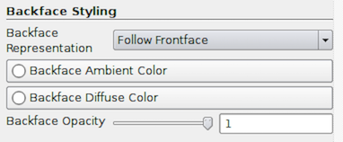

../_images/RenderViewDisplayPropertiesBackfaceStylingGroup.png
Backface Styling provides advanced controls to fine-tune the rendering by controlling front and back faces. A front face is any mesh face facing the camera, while a back face is the one facing away from the camera. By choosing to Cull Frontface or Cull Backface , or by selecting a specific representation type to use for the backface, you can customize your visualizations.

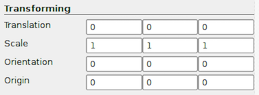

../_images/RenderViewDisplayPropertiesTransformingGroup.png
Transforming properties can be used to transform the rendered data in the scene without affecting the raw data itself. Thus, if you apply filters on the data source, it will indeed be working with the untransformed data. To transform the data itself, you should use the Transform filter.
The Coordinate Shift Scale Method is used to choose how to normalize point coordinates to improve rendering quality. Mesh points are sent to the GPU as single-precision float data which can result in resolution issues due to limited precision. VTK includes a variety of methods to normalize the point coordinates to a better range for single-precision floats prior to sending them to the GPU. Auto Shift Scale is a good setting that should work for most datasets - it recomputes a shift and scale factor according to a heuristic involving dataset size and position relative to the origin. Always Auto Shift Scale recomputes the shift and scale every time. Auto Shift Only only shifts the data - this is useful when data is far away from the origin. Near Focal Plane Shift Scale and Focal Point Shift Scale works based on the current camera near clipping point and viewpoint, respectively. This makes it the most robust setting, especially for very large datasets, but it will renormalize the points occasionally as the camera’s settings change. Renormalizing points requires reuploading the data to the GPU, so there may be a performance cost with these last methods.

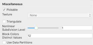

../_images/RenderViewDisplayPropertiesMiscellaneousGroup.png
Several properties are available under the Miscellaneous group. Uncheck the Pickable option if you want the dataset to be ignored when making selections. If the dataset has a texture coordinates array, you can apply a texture to the dataset surface using the Texture combo-box. Choose Load to load a texture or apply a previously loaded texture listed in the combo-box. If your dataset doesn’t have texture coordinates, you can create them by applying one of Texture Map to Cylinder , Texture Map to Sphere , or Texture Map To Plane filters, or using the filters Calculator or Programmable Filter .
The Triangulate option is useful for rendering objects with non-convex polygons. It comes with some additional processing cost for converting polygons to triangles, so it should be used only when necessary.
../_images/NonLinearSubdivision.png
Fig. 4.9 A dataset made of quadratic tetra hedra displayed with 1, 2, and 3 levels of nonlinear subdivision.
The property Use Shader Replacements enables you to customize the shader code VTK uses for rendering by specifying shader replacements with a JSON string. The JSON string can be a single node or an array of nodes with the following properties:

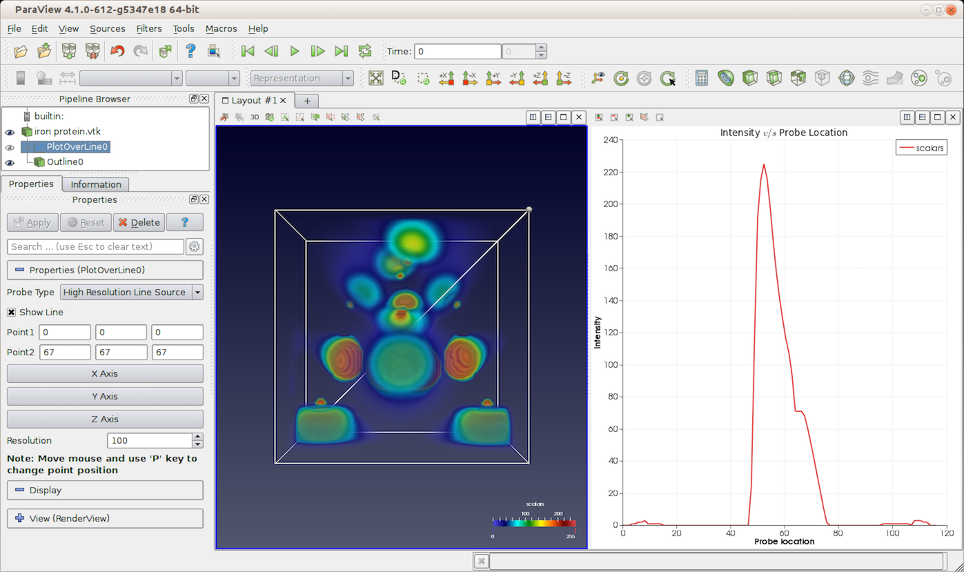

4.5. Line Chart View
../_images/LineChartViewInParaView.png
Fig. 4.10 paraview using Line Chart View to plot data values probed along a line through the dataset using Plot Over Line filter.
Line Chart View can be used to plot data as a line plot representing changes in dependent variables against an independent variable. Using display properties, you can also show scatter plots in this view. This view and other charting views in ParaView follow a similar design, where you pick attribute arrays to plot using display properties, and they are plotted in the view. How those values get plotted depends on the type of the view: Line Chart View draws a line connecting sample points, Bar Chart View renders bars at each sample point, etc.
One of the most common ways of showing a line plot is to apply the Plot Over Line filter to any dataset. This will probe the dataset along the probe line specified. You then plot the sampled values in the Line Chart View . Alternatively, if you have a tabular dataset (i.e. vtkTable ), then you can directly show the data in this view.

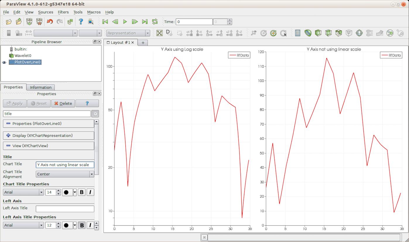

For generating log plots, simply check the corresponding Axis Use Log Scale , e.g., Left Axis Use Log Scale to use log scale for Y-axis (Fig. 4.11). Note that log scale should only be used for an axis with a non-zero positive range, since the log of a number less than or equal to 0 is undefined.
../_images/LineChartViewUsingLogScale.png
Fig. 4.11 Differences between line charts when using log scale for the Y-axis.

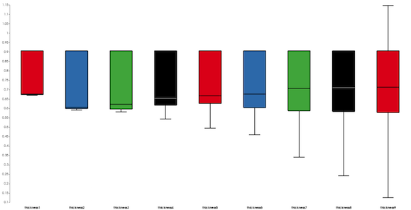

4.7. Box Chart View
../_images/BoxChartViewInParaView.png
Fig. 4.13 paraview using Box Chart View to plot the box chart for a dataset using the Compute Quartiles filter.
Box plot is a standard method for graphically depicting groups of statistical data based on their quartiles. A box plot is represented by a box with the following properties: the bottom of the rectangle corresponds to the first quartile, a horizontal line inside the rectangle indicates the median and the top of the rectangle corresponds to the third quartile. The maximum and minimum values are depicted using vertical lines that extend from the top and the bottom of the rectangle.
In ParaView, the Box Chart View can be used to display such box plots through the Compute Quartiles filter which computes the statistical data needed by the view to draw the box plots.

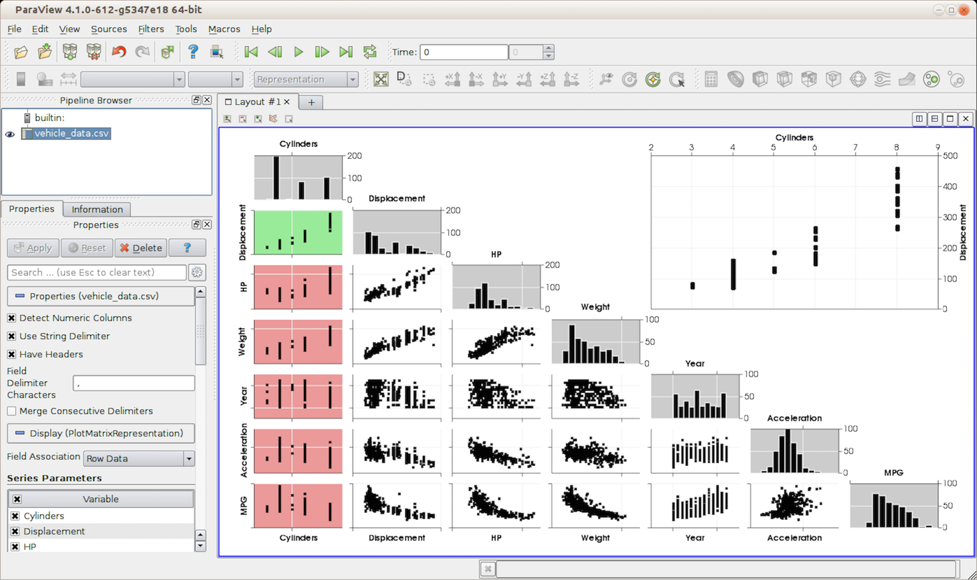

../_images/PlotMatrixViewInParaView.png
Fig. 4.14 paraview using Plot Matrix View to generate a scatter plot matrix to understand correlations between pairs of variables.
Plot Matrix View is a chart view that renders a scatter plot matrix. It allows you to spot patterns in the small scatter plots, change focus to those plots of interest, and perform basic selection. The principle is that, for all selected arrays or series to be plotted, the view generates a scatter plot for each pair. You can activate a particular scatter plot, in which case the active plot is re-drawn at a bigger scale to make it easier to inspect. Additionally, the view shows a histogram for each plotted variable or series.
The view properties allow you to set colors to use for active plot, histograms, etc., while the display properties allow you to pick which series are plotted.

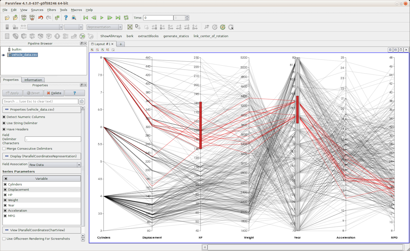

../_images/ParallelCoordinatesViewInParaView.png
Fig. 4.15 paraview using Parallel Coordinates View to plot correlations between columns in a table.
Like Plot Matrix View , Parallel Coordinates View is also used to visualize correlations between data arrays.
One of the main features of this view is the ability to select specific data in order to analyse the factors influencing the data. e.g., with a table of three variables, one being the “output” variable the other two being the potential factor influencing the first, selecting only the output will enable you to see if none, one, or both of the factors are actually influencing the output.

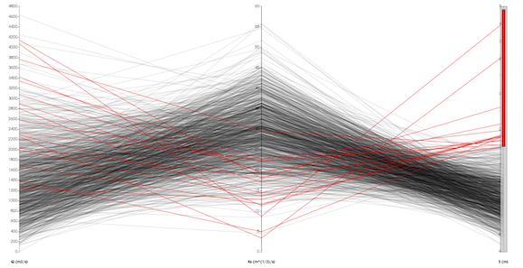

../_images/ParallelCoordinatesViewInParaViewSelection.png
Fig. 4.16 High “S” data point are influenced more by low “Ks” than high “Q”

../_images/PythonViewInParaView.png
Fig. 4.19 paraview using Python View with matplotlib to display a scatterplot of momentum magnitude versus density (upper right) and a histogram of density (lower right) in the bluntfin.vts dataset.
Here’s an example of this function that was used to generate the image in Fig. 4.19:

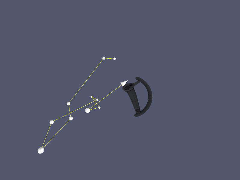

  • Adding points to a source — Press the right trigger to place a point at the tip of the right controller. Only valid when the active source allows placing points, such as a polyline source.
    ../_images/VRPtSource.png
    Fig. 4.21 Adding a point to a polyline source in VR.

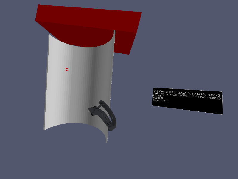

  • Probing — Press the right trigger while pointing at a dataset cell to select it and display information on its position and data values.
    ../_images/VRProbe.png
    Fig. 4.25 Cell probing action in VR.

  • Distance Widget — This button adds a measuring tool to the scene. Press the right trigger once to place the starting point where the right controller is located, then press a second time with the controller at the desired location to place the second point. Four values are displayed next to the tool: distance and X, Y, Z difference between both points. The tips of the line can be grabbed and moved individually after placing them.
../_images/VRDistanceWidget.png
Fig. 4.34 Distance measurement widget in VR.

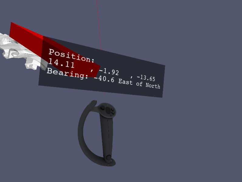

  • Navigation Panel — This button allows to display a tooltip above the left controller with information on its spatial position in world coordinates.
../_images/VRNavigationPanel.png
Fig. 4.35 Navigation panel widget in VR.
