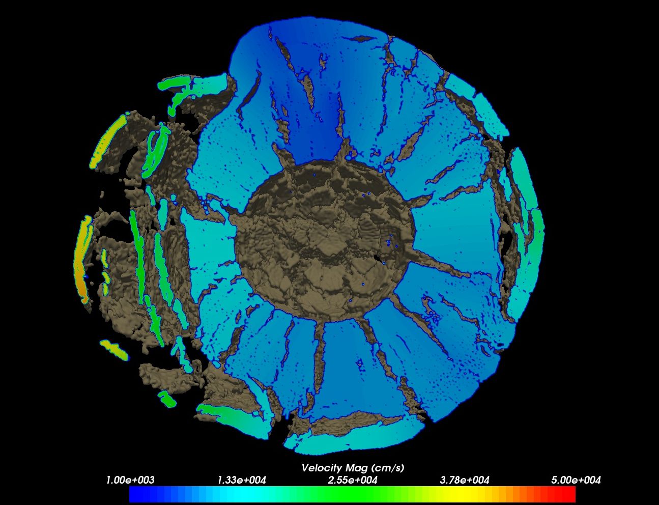

Fig. 4.43 CTH shock physics simulation with over 1 billion cells of a 10 megaton explosion detonated at the center of the Golevka asteroid.

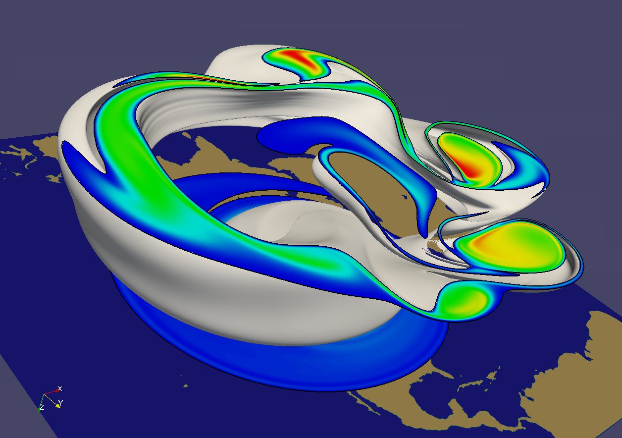

Fig. 4.44 SEAM Climate Modeling simulation with 1 billion cells modeling the breakdown of the polar vortex, a circumpolar jet that traps polar air at high latitudes.

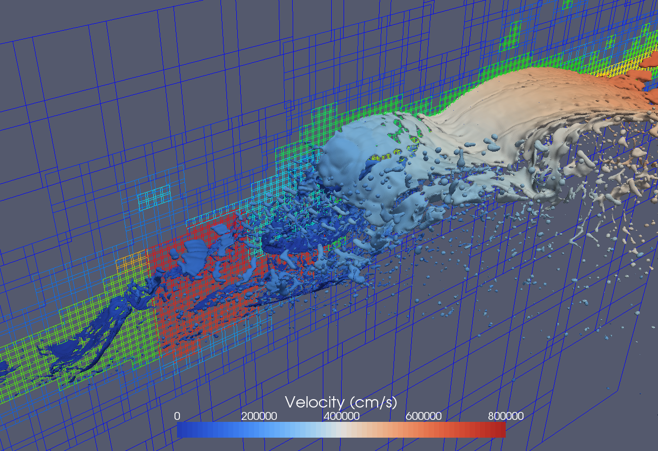

Fig. 4.45 A CTH simulation that generates AMR data. ParaView has been used to visualize CTH simulation AMR data comprising billions of cells, 100’s of thousands of blocks, and eleven levels of hierarchy (not shown).

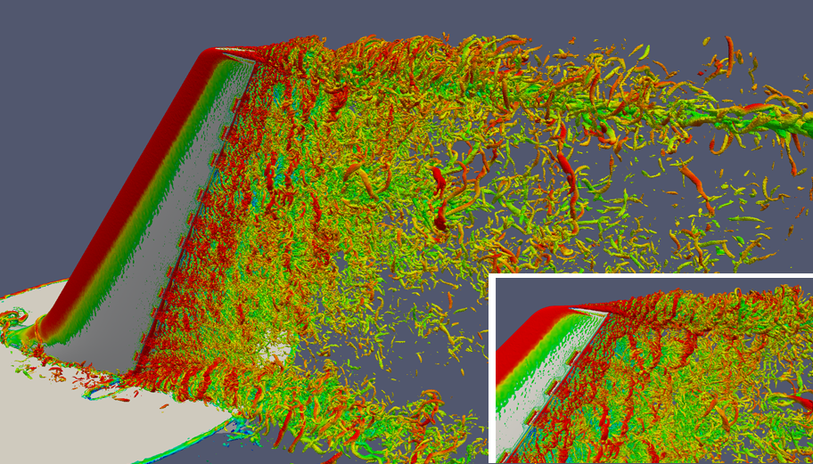

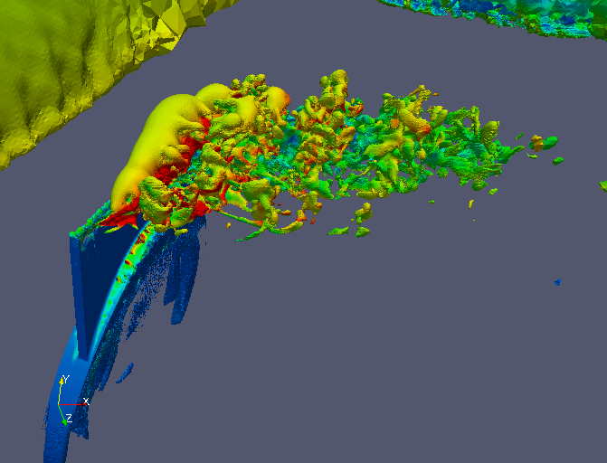

Fig. 4.47 A large scale in-situ PHASTA simulation that generated a 3.3 billion tetrahedral mesh simulating the flow over a full wing where a synthetic jet issues an unsteady crossflow jet (run on 160 thousand MPI processes).
Fig. 4.48 A large scale in-situ PHASTA simulation that generated a 1.3 billion element mesh simulating the wake of a deflected wing flap (run on 256 thousand MPI processes). Images courtesy of Michel Rasquin, Argonne National Laboratory.

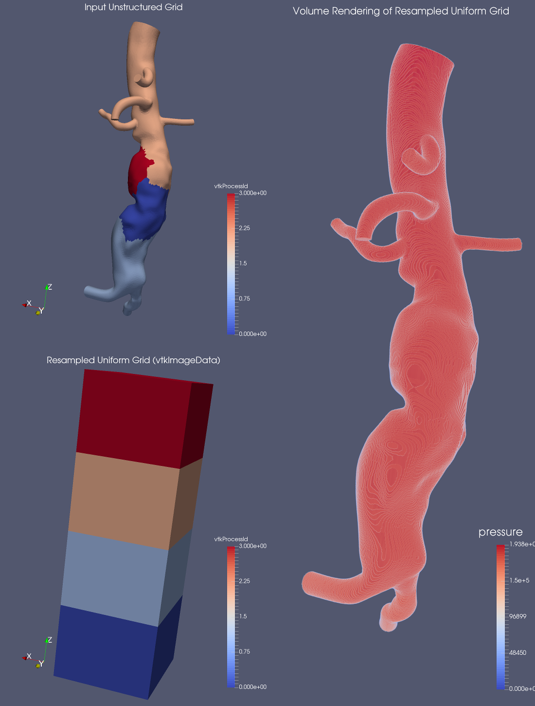

Now let us say we want to perform visualizations on this mesh using three processes. We can divide the cells of the mesh as shown below with the blue, yellow, and pink regions.
Once partitioned, many visualization algorithms will work by simply allowing each process to independently run the algorithm on its local collection of cells. For example, take clipping (which is demonstrated in multiple exercises including Exercise 2.11). Let us say that we define a clipping plane and give that same plane to each of the processes.
Each process can independently clip its cells with this plane. The end result is the same as if we had done the clipping serially. If we were to bring the cells together (which we would never actually do for large data for obvious reasons) we would see that the clipping operation took place correctly.
Many, but not all operations are thus trivially parallizeable. Other operations are straightforward to parallelize if ghost layers as described in Section 4.7.2 are available. Other operations require more extensive data sharing among nodes. In these filters ParaView resorts to MPI to communicate amongst the nodes of the machine.

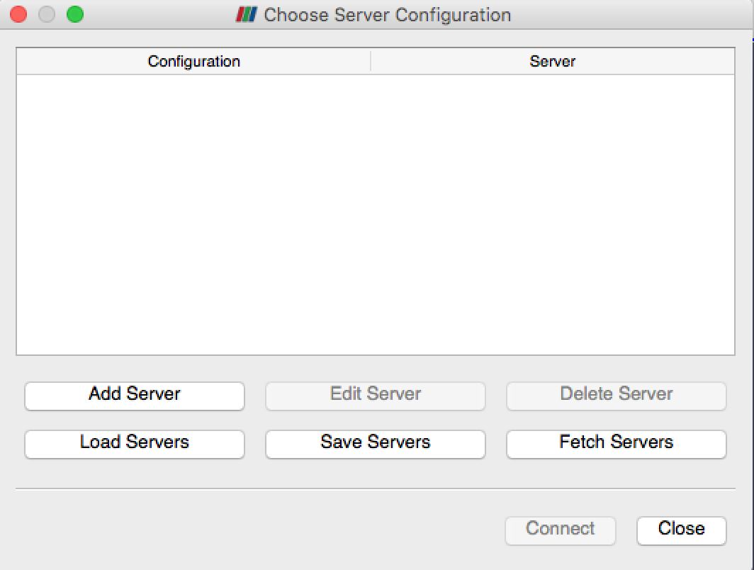

Now start up the ParaView GUI and click the button. This will
bring the Choose Server Configuration dialog box where you can download or
create server connection paths, or connect to predefined paths.
Now click the Add Server button to create a new path, which we will
construct to connect to the waiting pvserver running on your local
machine.

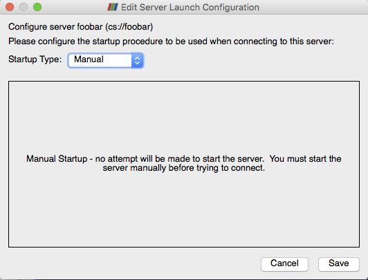

In the Edit Server Configuration Dialog, change the Name of the connection path from “unknown” to “my computer”. In actual use one would enter in a nickname for and the IP address of the remote machine we want to connect to. Now hit the Configure button.
On the resulting Edit Server Launch Configuration dialog, leave the
Startup Type as Manual since we have already started a waiting
pvserver. In actual use one would typically use Command and in the
dialog enter in a script that starts up the server on the remote
machine. Click Save on the dialog to finish defining the connection.
Now that we have defined a connection, it will show up under the Choose
Server Configuration dialog whenever we hit . Click on the name of the
connection, “my computer” in this case, and click Connect to establish
the connection between the GUI and
pvserver.

Exercise 4.3 (Fetching and using Connections)
Once again, click on to bring up the Choose Server Configuration dialog.
This time, hit the Fetch Servers button. This will bring up the Fetch
Server Configurations dialog box populated with a list of server definitions
from the webite. Choose one and click the Import Selected button to download
it into your ParaView preferences. The new connection is now available
just as the connection to “my computer” is.
To use the remote machine, once more click . This time choose the new
machine instead of “my machine” and click Connect. Doing so will bring
up a Connection Options for … dialog box that lets where you enter in
the parameters for your parallel session.
The parameters you will want to set include your username on the remote machine, the number of nodes and processes to reserve and the amount of time you want to reserve them for. Each site may have additional choices that are passed into the launch scripts on the server. Once set, click OK to try to establish a connection.
When you click OK ParaView typically spawns a terminal window (xterm on Mac and Linux, cmd.exe on Windows). Here you will have to enter in your credentials to actually access the remote machine. Once logged on, the script to reserve the nodes automatically runs and in most cases the terminal session has a menu with options for looking at the remote system’s queue. When your job reaches the top of the queue, the ParaView 3D View window will return and you can begin doing remote visualization, this time with the capacity of the remote machine at your fingertips.

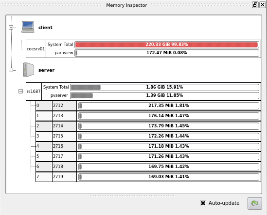

4.7.1. Keeping Track of Memory
When working with very large models, it is important to keep track of memory usage on the computer. One of the most common and frustrating problems encountered with large models is running out of memory. This in turn will lead to thrashing in the virtual memory system or an outright program fault.
Section 4.8.2 and Section 4.8.3 provide suggestions to reduce your memory usage. Even so, it is wise to keep an eye on the memory available in your system. ParaView provides a tool called the memory inspector designed to do just that.
To access the memory inspector, select in the menu bar View → Memory Inspector. The memory inspector provides information for both the client you are running on and any server you might be connected to. It will tell you the total amount of memory used on the system and the amount of memory ParaView is using. For servers containing multiple nodes, information both for the conglomerate job and for each individual node are given. Note that a memory issue in any single node can cause a problem for the entire ParaView job.

4.8.4. Downsamplng
Downsampling is also frequently helpful for very large data. For example, the Extract Subset filter reduce the size of Structured DataSets by simpling taking strided samples along the i, j and k axes.
For unstructured grids the Quadric Clustering filter downsamples unstructured data into a smaller dataset with similar appearance by averaging vertices within cells of a grid. ParaView injects this algorithm into the display pipeline while you interact with the camera as described in the next section.
In some cases though, it can be more effective to work with structured data than unstructured data. In particular structured data volume rendering algorithms are usually much faster. In general structured data representations are very compact, adding very little overhead to the raw data values. Unstructured data types require 12 bytes of memory storage for every vertex and at least 8 bytes of storage to define each cell beyond the normal storage for cell and point aligned values. Structured types use a total of 36 bytes to represent the entire set of vertices and cells in comparison.
Fortunately you can convert from unstructured to structured easily with the Resample To Image filter. When the sizes of the cells in the input do not very widely, and can thus be approximated well by constant sized voxels, this can be very effective. This filter internally makes use of the DIY2 block-parallel communication and computation library to communicate and transfer data among the parallel nodes.
There is a companion filter Resample With DataSet which takes in a source and an input object and resamples values from the source onto the input, which does not have to be a regular grid. This also uses DIY2. This is used to assigning new values onto a particular shaped object.

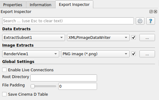

4.10. Catalyst
For small scale data, running the ParaView GUI in serial mode is likely acceptable. For large scale data, interactive parallel visualization is quite useful. For very large scale data, batch mode parallel processing is more effective because of practical concerns like batch system queue wait time before a parallel job is launched and system policies that limit the size and duration of interactive jobs.
For extreme scale visualization even batch mode is beginning to be impractical though as comparatively slow disks limit the size of data that can be saved off by the simulation at runtime. In this domain ParaView’s Catalyst configuration is recommended as an in situ analysis and visualization library.
Catalyst is a visualization framework that packages either portions or the entirety of ParaView’s parallel server framework so that it can be linked into and called from arbitrary simulation codes. Slow IO systems are largely bypassed via an adaptor mechanism whereby the simulation code’s data structures are translated or ideally reused directly by ParaView while still in RAM.
With Catalyst, full resolution simulation products stay in memory instead of being saved to and later loaded back from disk. As the simulation progresses, it periodically calls into ParaView. In this way it is possible to immediately generate smaller derived datasets, images, plots, etc. that would otherwise be generated during post processing after a much longer, human in the loop, delay.

Next let’s use the Export Inspector to declare a set of files that you want Catalyst to produce at run time. As we will see in a moment, the ParaView GUI is able to generate Catalyst scripts by capturing the current state of the visualization constructed in ParaView. However, the state does not include file creation, which is typically done in interactive sessions via File → Save Data or File → Save Screenshot actions.
Since ParaView 5.6, the Export Inspector is the place for defining Catalyst’s data products. Open it by clicking Export Inspector under the Catalyst menu. By default the panel will show up in a new tab near the Properties Panel. Select it, if necessary, to bring it to the front.
The Data Extracts section at the top allows you to attach a writer to the currently active element within the visualization pipeline. Make sure ExtractSubset1 is selected in the Pipeline Browser and then choose XMLPImageDataWriter from the file format pull down to the right of this filter name in Data Extracts. To confirm that you want Catalyst to perform this particular data export at run time, click on the checkbox to the right of the file format.
If you want to change the writer’s default settings, click on the configure button with the … label to the right of the checkbox. In the Save Data Options dialog that pops up, you can control things like the compression level, the frequency at which Catalyst generates files, and the filename. The default filename is composed from the producing filter’s name, the time step and the file format extension. Let’s change it from “ExtractSubset1_%t.pvti” to “smallgrid_%t.pvti”. Here “%t” gets replaced with the iteration number when the simulation runs. Later, when we run the simulation with this script, we will get subsampled results instead of the full grid.
To add rendered images to the simulation run, configure them with the Image Extracts section of the Export Inspector. Just like with data extracts, you configure outputs for the currently active view here. Do so by making sure that “RenderView1” is active and then hit the checkbox to enable png dumps of this view.
To save your visualization session in the form of a Catalyst script, click Catalyst → Export Catalyst Script. Note that all of your choices in the Export Inspector are kept with the rest of the ParaView state, so File → Save State can make it easy to modify your setup after the fact.
Finally quit ParaView and run the simulation again. The files produced will now include png files for screen captures at each time step, and vti files corresponding to the output of the Extract Subset filter at each timestep. Simply repeat the process, adding filters and views for example, to set up any type of data generator for the simulation.
