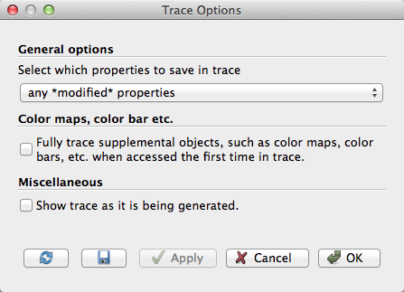

As noted earlier in the exercise, Python tracing has some options that are presented in a dialog box before the tracing starts. The first option selections what properties are saved to the trace. Some properties you explicitly set through the GUI, such as a value entered in a GUI widget. Some properties are set internally by the ParaView application, such as the initial position of a clip plane based on the bounds of the object it is being applied to. Many other properties are left at some default value. You can choose one of the following classes of properties to save:
- all properties
Traces the values of all properties even if they remain at the default. This can be helpful to introspect all possible properties or to ensure a consistent state regardless of the settings for other users. This also yields a very verbose output that can be hard to read.
- any *modified* properties
Ignores any properties that do not change from their defaults. This is a good option for most use cases.
- only *user-modified* properties
Ignores any properties that are not explicitly set by the user. Traces of this nature rely on any internally set properties being reapplied when the script is run.
The next option has to do with supplemental objects that are managed by the ParaView GUI (or client) rather than in the server’s state. Check this box to capture all of the state associated with these objects, which includes color maps, color bars, and other annotation.
Finally, ParaView provides the option to show the trace file as it is being generated. This can be a helpful option to use when learning what Python commands can be used to replicate particular actions in the ParaView GUI.

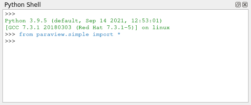

Exercise 3.3 (Creating and Showing a Source)
If you have been following an exercise
in a previous section, now is a good time to reset ParaView. The
easiest way to do this is to select from the toolbar.
If you have not already done so, open the Python shell in the ParaView GUI by selecting View → Python Shell from the menu. You will notice that the following has been added for you already.
from paraview.simple import *
Create and show a Sphere source by typing the following in the Python shell.
sphere = Sphere()
Show()
Render()
ResetCamera()

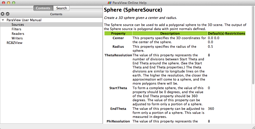

removed. Use dir(variable) or help(variable) to get a list of
all attributes on any variable that you have access to. In most cases,
simply assign values to an object’s attributes in order to change them.

Next, enter the following command into the Python shell to get the current value of the Theta Resolution property of the sphere.
print(sphere.ThetaResolution)
The Python interpreter should respond with the result 8. (Note that

3.6. Online Help
This tutorial, as well as similar instructions in the ParaView book and Wiki, is designed to give the key concepts necessary to understand and create batch Python scripts. The detailed documentation including complete lists of functions, classes, and properties available is maintained by the ParaView build process and provided as online help from within the ParaView application. In this way we can ensure that the documentation is up to date for whatever version of ParaView you are using and that it is easily accessible.
The ParaView Python bindings make use of the help built-in function.
This function takes as an argument any Python object and returns some
documentation on it. For example, typing
help(paraview.simple)
returns a brief description of the module and then a list of all the functions included in the module with a brief synopsis of what each one does. For example
help(Sphere) sphere = Sphere() help(sphere)
will first give help on the Sphere function, then use it to create
an object, and then give help on the object that was returned (including
a list of all the properties for the proxy).
Most of the widgets displayed in the properties panel’s Properties group are automatically generated from the same introspection that builds the Python classes. (There are a small number of exceptions where a custom panel was created for better usability.) Thus, if you see a labeled widget in the properties panel, there is a good chance that there is a corresponding property in the Python object with the same name.
Regardless of whether the GUI contains a custom panel for a pipeline
object, you can still get information about that object’s properties
from the GUI’s online help. As always, bring up the help with the
toolbar button. You can find documentation for all the available
pipeline objects under the Sources, Filters, Readers, and Writers
entries in the help Contents. Each entry gives a list of objects of that
type. Clicking on any one of the objects gives a list of the properties
you can set from within Python.
