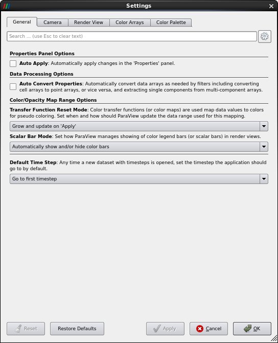

3.2. Customize Settings
paraview allows users to customize settings. The most important ones are
found in Edit → Settings → General. These are:
Auto Apply - Also found as an icon below the Macros menu.
Auto Convert Properties - Automatically call Cell to Point, Point to Cell, or extract components from vectors as needed.
Transfer Function Reset Mode - when to update the minimum and maximum for the Color Legend.
Grow and update on Apply - default. This means only update when told to.
Grow and update every timestep. This means to update the Minimum and/or Maximum only if the current timestep exceeds these numbers. Basically, Add and grow.
Clamp and update every timestep. Set the minimum and maximum every timestep, from the data this timestep. This is not recommended behavior, since it makes comparing frame to frame confusing.
Scalar Bar Mode - just leave this one alone.
Default timestep -
Go to first timestep - default.
Go to last timestep

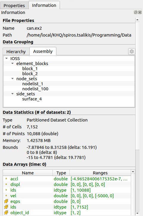

3.3. Information tab
Open can.ex2.
Press Apply.
Open the Information tab.
The first section is the File Properties of the dataset.
The second section is Data Grouping, which tells you what blocks and sets you have in this dataset.
The third section is Data Statistics which tells you:
The number of cells
The number of points
The amount of memory used
The bounds which give the X, Y and Z bounds of the bounding box.
The fourth section is Data Arrays which gives information on each variable, including the min and max. Note that this is for the current timestep only.
The last section is Time which gives a list of all timesteps, with their associated time.

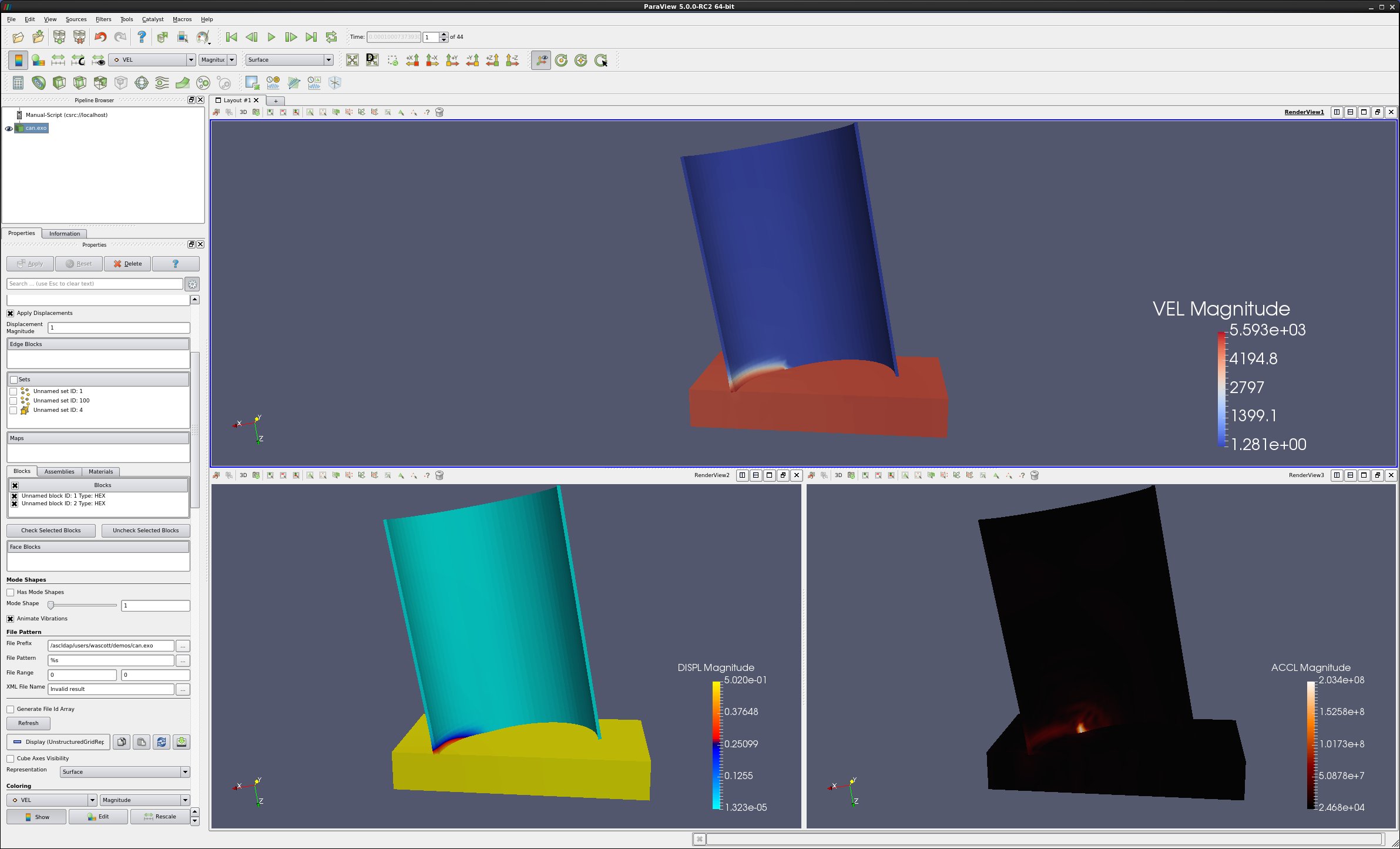

3.5. Split windows
Open can.ex2.
Apply.
Drag the can around with the left mouse button until you can see the can.
Split screen vertical – i.e., one above the other. This is the little box with the horizontal line.
Select 3D View.
Turn the eyeball on for can, in the Pipeline Browser.
Select 3D View.
This last command was a mistake. Lets undo it. Undo, Undo.
We undid one too many commands. Lets redo it. Redo.
Select the bottom viewport.
Split screen horizontal – i.e., one next to the other. This is the little box with the vertical line.
Select 3D View.
Now lets link the cameras.
Right click on the upper window.
Click on Link Camera.
Click on the lower right window.
Do the same between the two bottom windows.
Click in the lower left window, set Coloring to DISPL.
Turn on Color Legend Visibility.
Click in the lower right window, set Coloring to ACCL.
Click in the upper window, set Coloring to VEL.
Go to the last frame.
Click on Rescale to Data Range.
Go to the first frame.
Play.

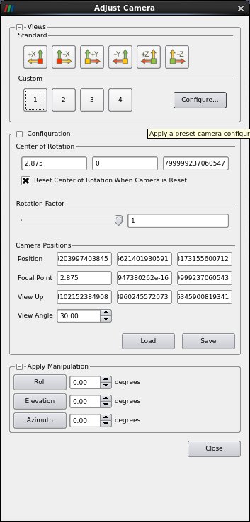

3.13. Move the camera
ParaView allows the user to change and store the position of the camera.
Such controls as Roll, Elevation and Azimuth are available.
The Adjust Camera icon is on the left side of the row
of icons at the top left of the 3d window.
The Adjust Camera dialog box looks like this:
Useful controls that I often use (in order) are as follows:
Custom Configure - Save up to 4 camera positions.
Azimuth - rotate around the vertical axis. Be sure to hit the button after entering a number.
Elevation - rotate around the horizontal axis in the plane of the screen.
Roll - rotate around the axis coming out of the screen.
View angle - basically a zoom in.
Camera position - where the camera is.
Focal point - where the camera is looking.
You can always recenter the object using the Reset icon. First, however, be sure to change View angle back to 30.
