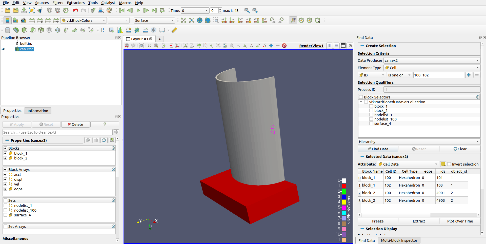

We will select an ID.
Set Data Producer to can.ex2.
Set Element Type to Cells.
Change pulldown to ID. Leave as is. Enter 100.
Only select block_1
Find Data
We will select two IDs.
Find Cells from can.ex2
Change pulldown to ID. Change to is one of. Enter 100, 102.
Find Data

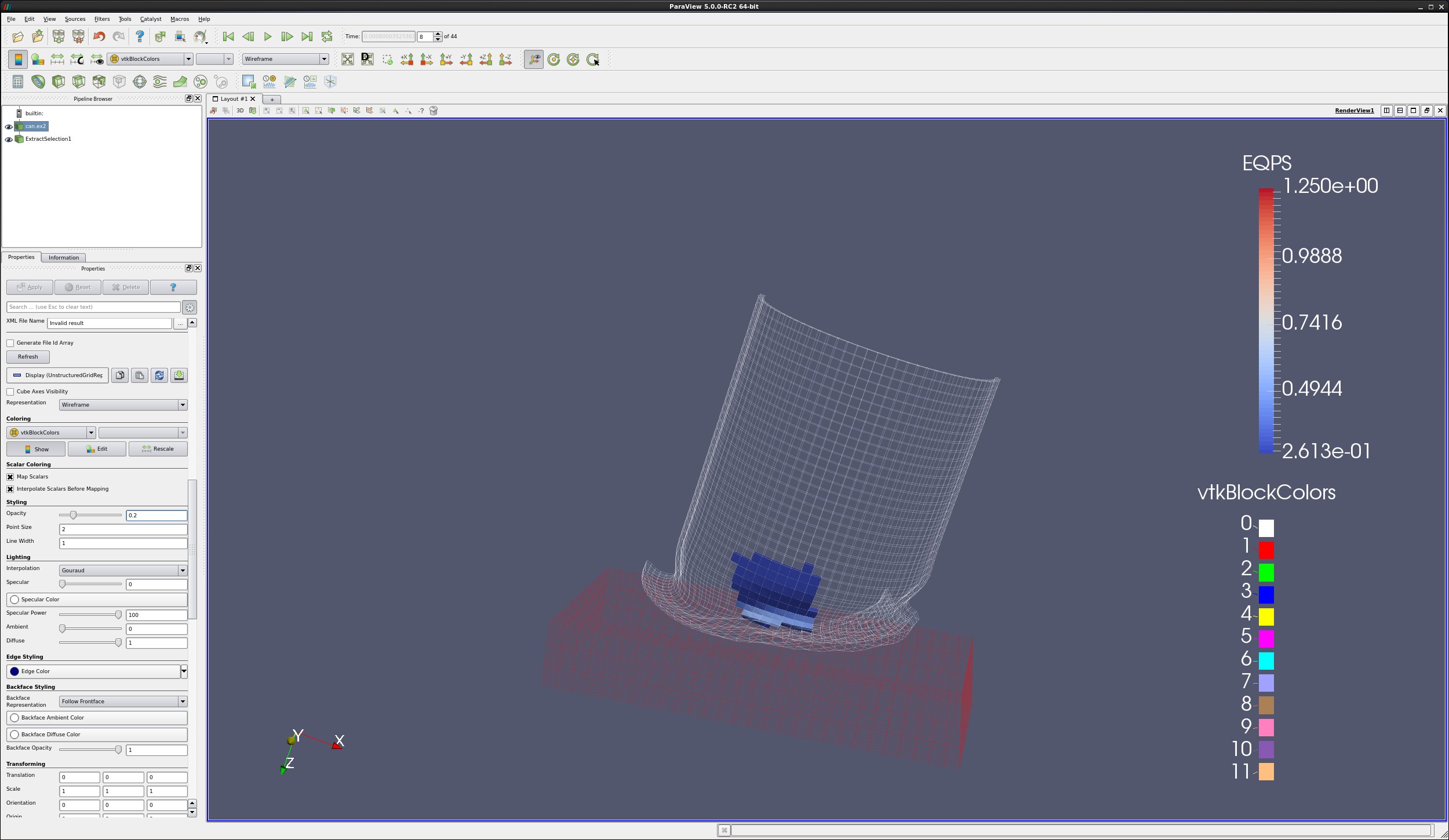

We can also display cell or point data on the 3d view. This is done with Cell Labels and Point Labels.
Open the Cell Labels pulldown, and select EQPS.

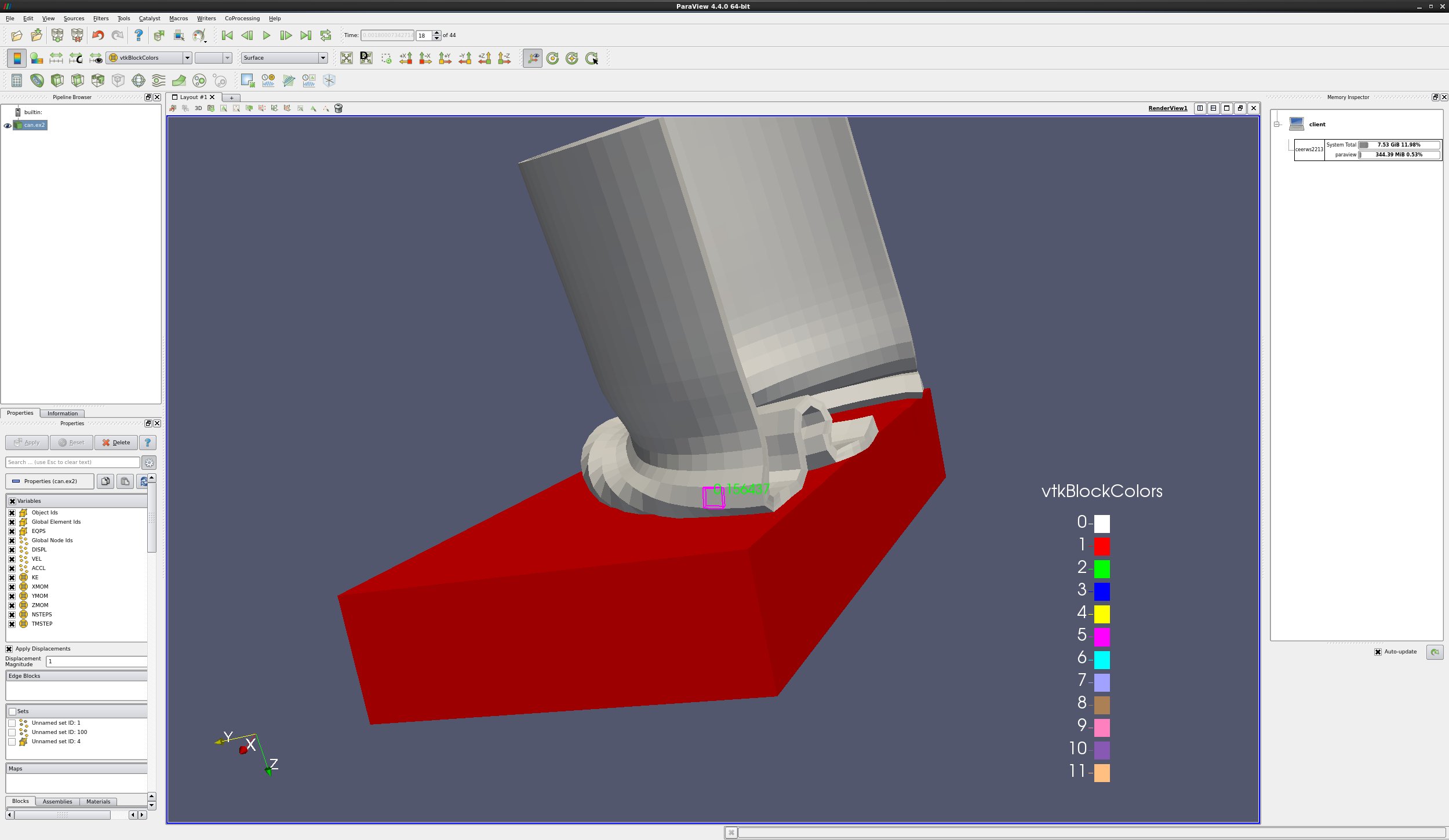

Select Cells On. Select one or more cells on the surface of your object. Either a single click or rubber band select works. Shortcut - s.
Select Points On. Select one or more points on the surface of your object. Either a single click or rubber band select works. Within a tolerance, the nearest point will be selected. Shortcut - d.
Select Cells Through. Select cells through your dataset. This is known as a Frustum select. Shortcut - f.
Select Points Through. Select points through your dataset. This is also known as a Frustum select. Shortcut - g.
Select Cells With Polygon. Select cells on the surface of your dataset by drawing a polygon. No shortcut.
Select Points With Polygon. Select points on the surface of your dataset by drawing a polygon. No shortcut.
Select Block. Select one or more blocks. Either click or rubber band select works. Shortcut - b.

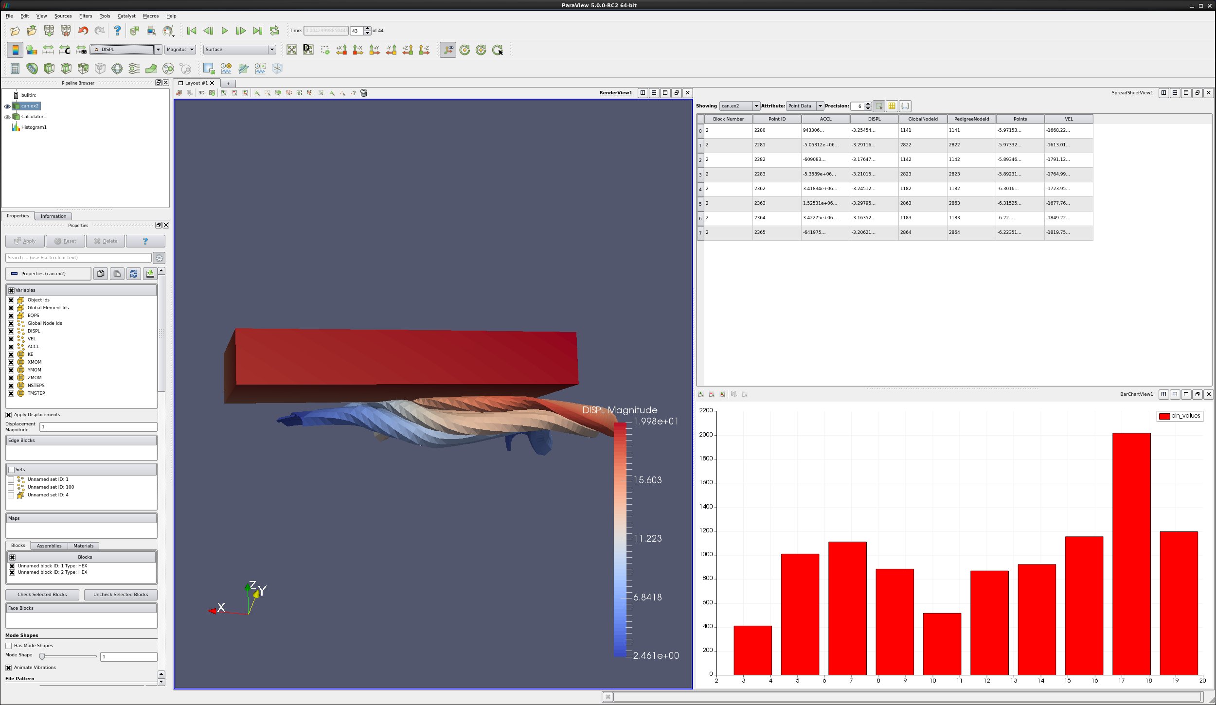

Open can.ex2.
Apply.
Highlight the can window, and Select Cells On on the can.
Split Horizontal.
Split Vertical.
In the upper right window, select Spreadsheet View.
Select the Show Only Selected Elements check box (next to Precision).
Note that the Spreadsheet can now be sorted - including in parallel.
Select a different cell on the can.
Highlight the lower right window.
We want magnitude of the DISPL vector.
Select Filters → Common → Calculator.
Set Expression to mag(DISPL). Result Array Name → MagDispl.
Apply.
Filters → Data Analysis → Histogram.
Apply.
Close the 3d RenderView
Change Select Input Array to MagDispl.
Apply.
Animate forward in time one step at a time.
Play.
If desired, freeze the X and Y axis in the Properties tab using Axis Use Custom Range.

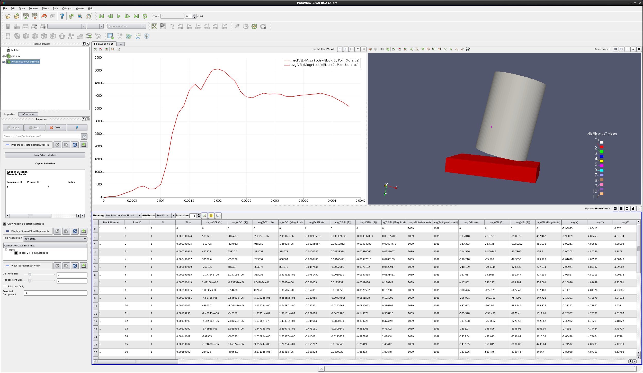

On the toolbar, click the Select Points On icon. This will allow you to manually select a point on your dataset.
Select a point on your dataset.
Filters → Data Analysis → Plot Selection Over Time.
Apply.
Split Vertical, Spreadsheet View, and with the Spreadsheet View highlighted, turn on the eyeball in front of the Plot Selection Over Time filter.
