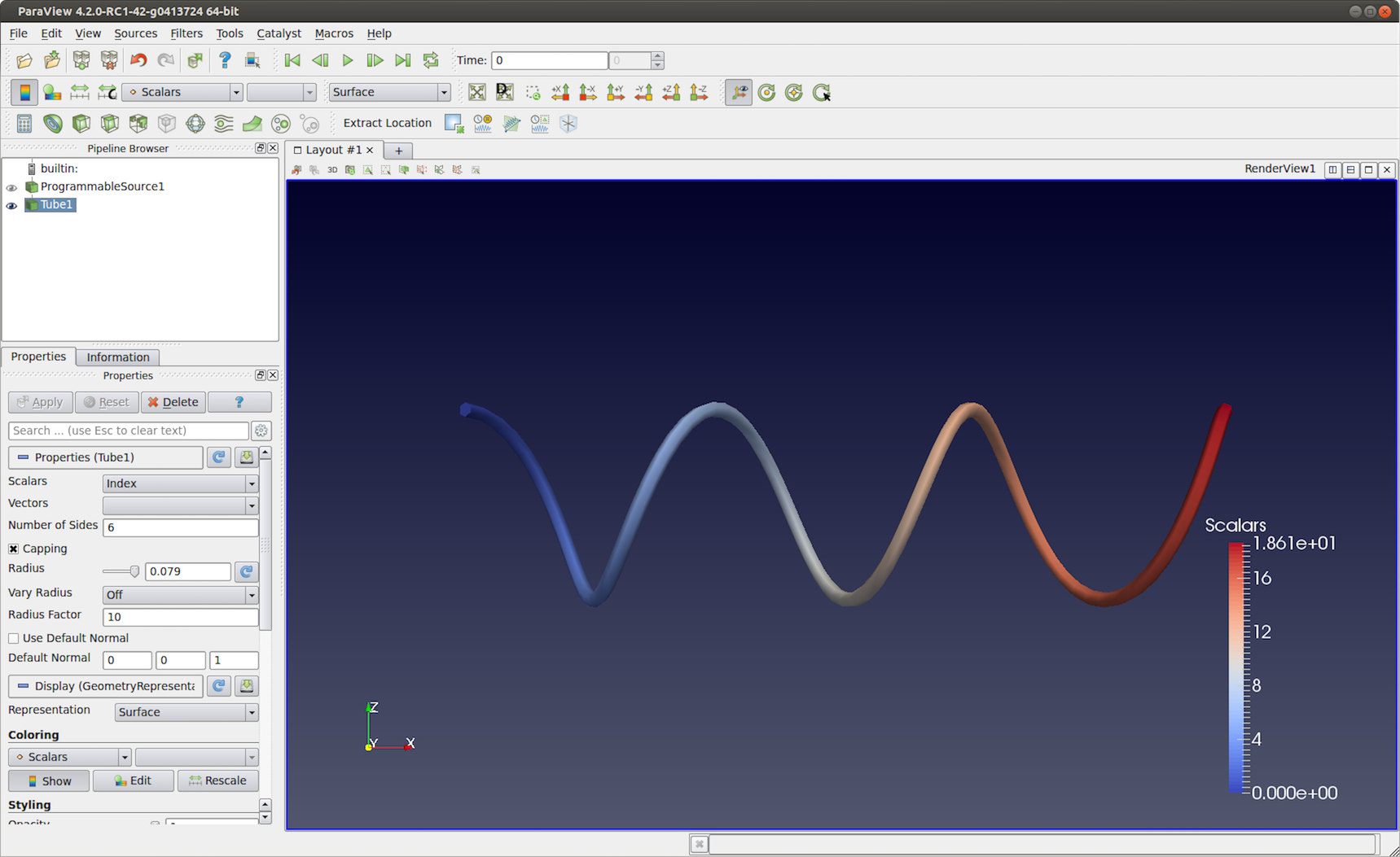

5.2.5. Helix source
Here is another polydata source example. This time, we generate the data programmatically.
# Code for 'Script'
#This script generates a helix curve.
#This is intended as the script of a 'Programmable Source'
import math
import numpy as np
from vtk.numpy_interface import algorithms as algs
from vtk.numpy_interface import dataset_adapter as dsa
numPts = 80 # Points along Helix
length = 8.0 # Length of Helix

Fig. 5.32 Programmable Source output generated using the script in
Section 5.2.5. This visualization uses Tube
filter to make the output polyline more prominent.
