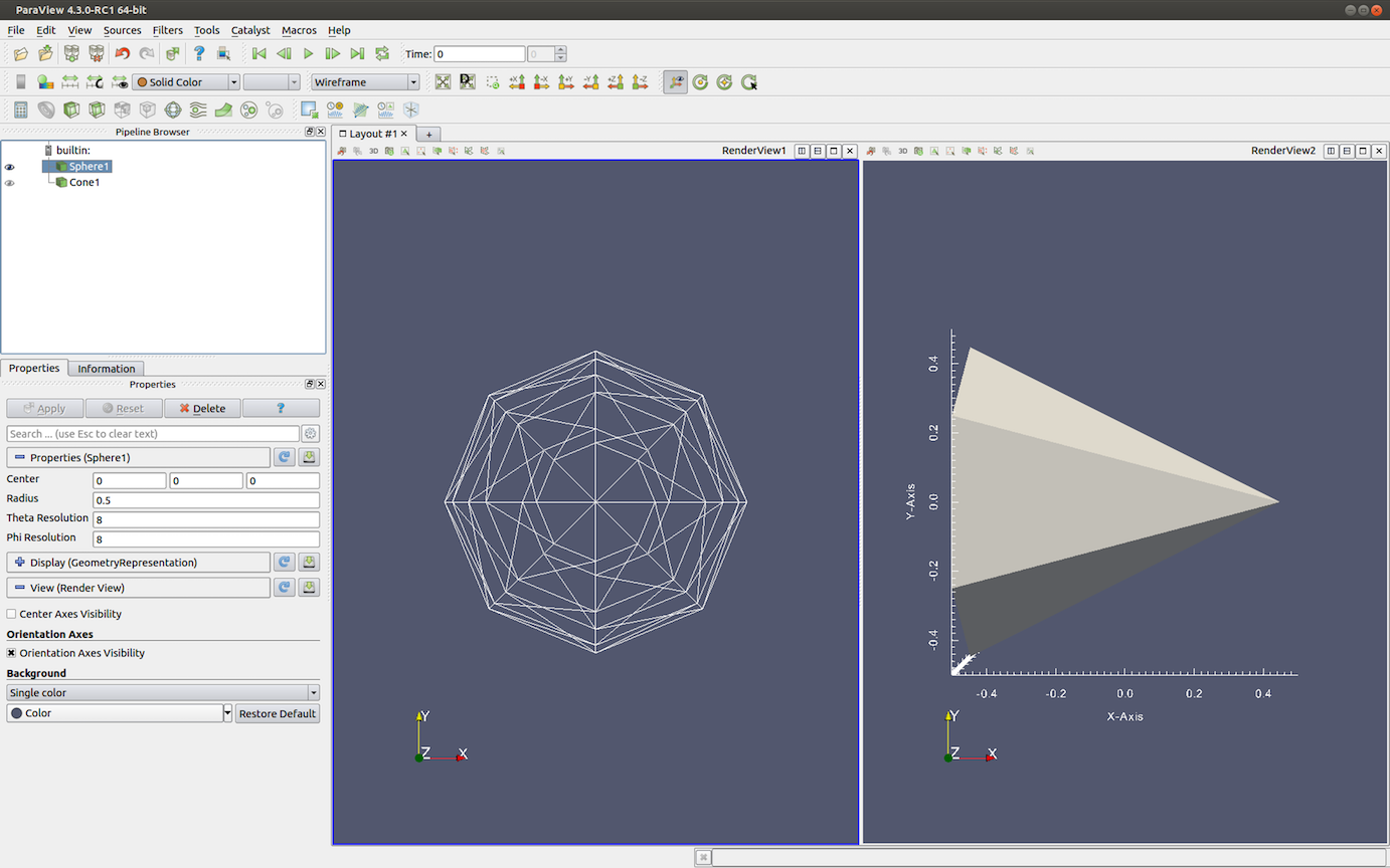

Let’s start paraview and split the active view to create two Render View
instances side by side. You may want to start paraview with the -dr
command line argument to stop any of your current settings from interfering
with this demo. Next, show Sphere as Wireframe in the view
on the left, and show Cone as Surface in the view on the right.
Also, turn on Cube Axis for Cone . You will see something like
Fig. 12.4 (top).
Fig. 12.4 The effect of loading the Print color palette as
the active palette. The top is the original visualization and the bottom shows the
result after loading the Print palette.
Now let’s say you want to generate an image for printing. Typically, for
printing, you’d want the background color to be white, while the wireframes and
annotations to be colored black. To do that, one way is to go change each of the
colors for each each of the views, displays and cube-axes. You can imagine how
tedious that will get especially with larger pipelines. Alternatively, using the
Settings dialog, change the active color palette to Print as shown in
Fig. 12.3 and then click OK or Apply .
The visualization will immediately change to something like
Fig. 12.4 (bottom).

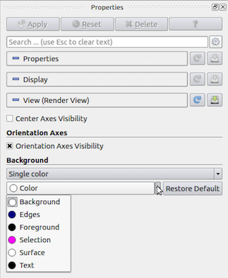

Essentially, ParaView allows you to link any color property to one of
the color categories. When the color palette is changed, any color property
linked to a palette category will also be automatically updated to match the category color.
Fig. 12.5 shows how to link a color
property to a color palette category in the Properties panel. Use the tiny
drop-down menu marker to make the menu pop up that shows the color palette categories.
Select any one of them to link that property with the category. The link is
automatically severed if you manually change the color by simply clicking on the
button.
Fig. 12.5 Popup menu allows you to link a color property to a color palette
category in the Properties panel.}
