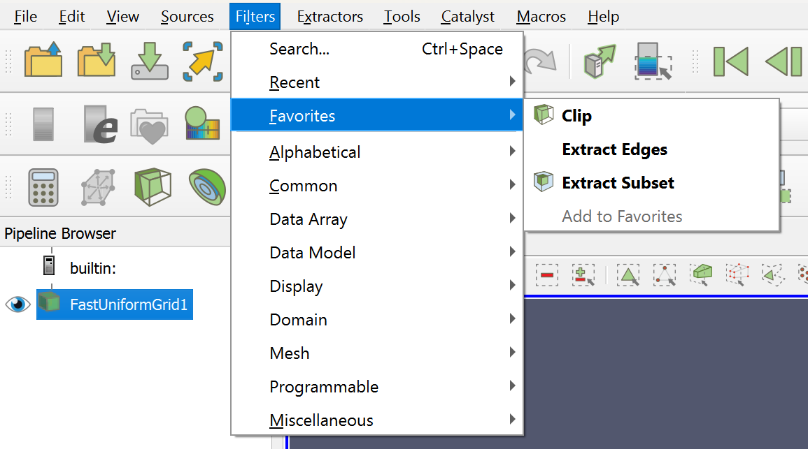

6.2. Creating filters in paraview
All available filters in paraview are listed under the Filters menu. These are organized in various categories. To create a filter to transform the data produced by a source or a reader, you select the source in the Pipeline Browser to make it active, and then click on the corresponding menu item in the Filters menu. If a menu item is disabled, it implies that the active source does not produce data that can be transformed by this filter.

Did you know?
While the Filters menu is a handy way to create new filters, with the long list of filters available in ParaView, manually finding a particular filter in this menu can be very challenging. To make it easier, ParaView incorporates a quick launch mechanism. When you want to create a new filter (or a source), simply type CTRL + Space or Alt + Space. This will pop up the quick-launch dialog. Now, start typing the name of the filter you want. As you type, the dialog will update to show the filters and sources that match the typed text. You can use the arrow keys to navigate and use the Enter key to create the selected filter (or source). Press while pressing Enter to quickly apply the filter on creation, equivalent to creating the filter and then clicking the Apply button. Note that filters may be disabled, as was the case in the Filters menu but by default the selected item will be the first enabled filter. You can use Esc to clear the text you have typed so far. Hit the Esc a second time, and the dialog will close without creating any new filter.

6.11. Favorites and custom categories
To streamline your workflow, you can customize how filters are organized and accessed in ParaView. You can pin filters you use more frequently for quick access under the Filters > Favorites menu. Favorited filters are highlighted in the other filter submenus on supported platforms, and are saved in user settings so they can be used in subsequent sessions.
../_images/FavoriteFilters.png
Fig. 6.30 The Favorites category under the Filters menu, showing the list of favorited filters.
