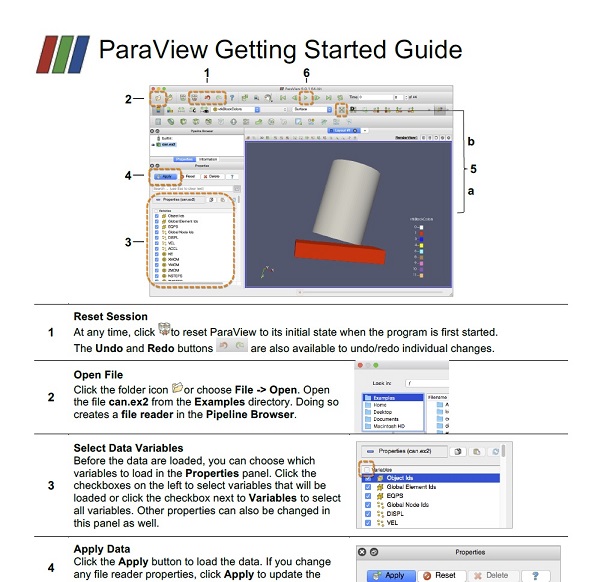

1.2.3. Getting Started Guide
  • The Getting Started Guide is a two page mini tutorial that shows fundamental ParaView usage.

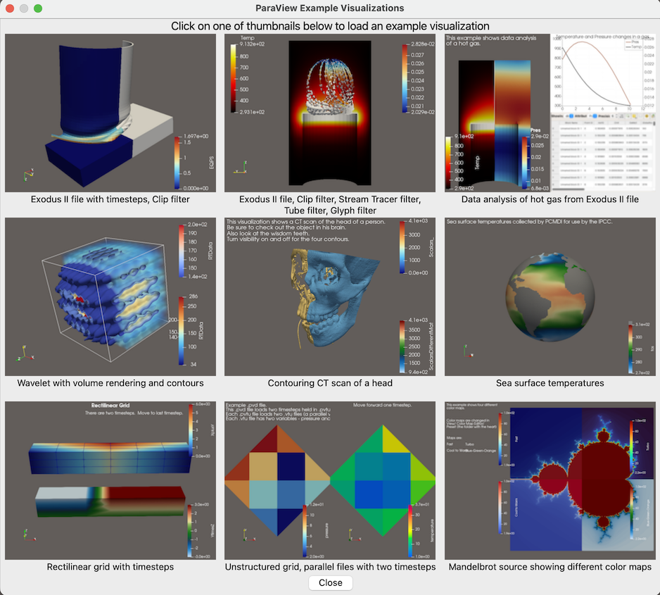

  • Example Visualizations provide six finished visualizations. You can then play around with a ParaView pipeline.
../../_images/Beginning_paraview_ExampleVisualizations.png

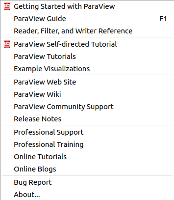

1.2.4. Help Menu
  • The Help menu looks like this. Step through each menu option, then close the Help menu.
../../_images/HelpMenu.png

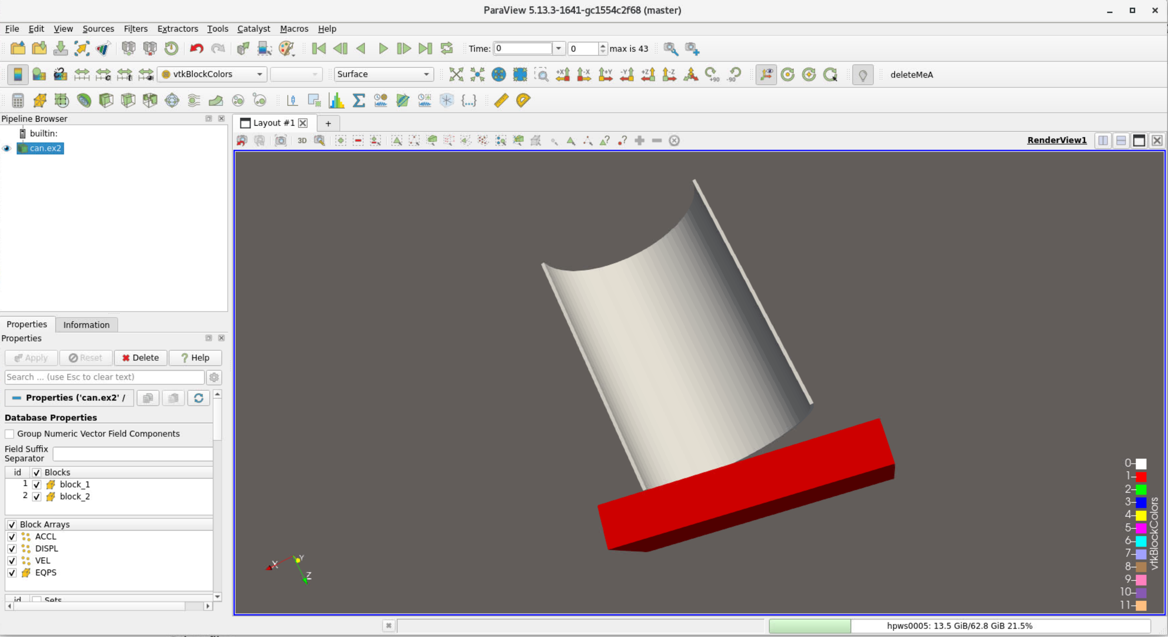

  • The screen should now look like this. (The square will show up as red, since ParaView defaults to coloring by block, and the block we are seeing is red.) You are looking at the bottom of the plate that the can is sitting on.

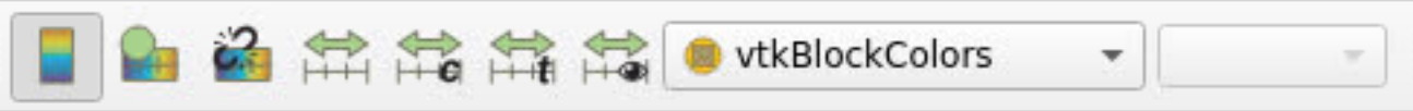

  • Notice that the can dataset is being painted in two colors. We are currently painting by Block.

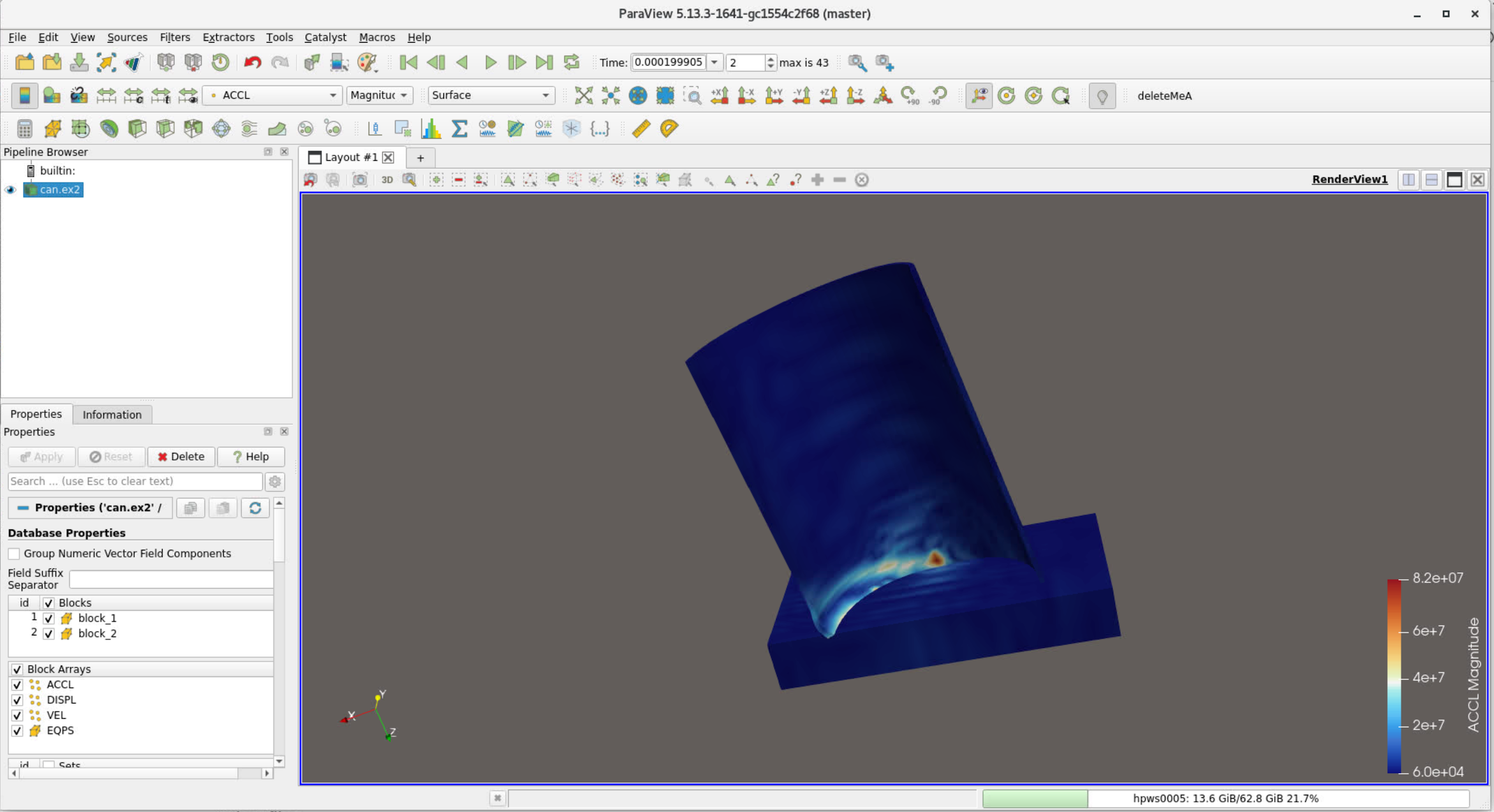

  • Change the variable used for color. Change this from Solid Color. to Acceleration (Point ACCL). (This is found just below the Sources menu.) Everything should go blue.
../../_images/Beginning_paraview_3.png
  • Animate the can one frame forward using the Next Frame controls. Right above the window of the can are animation controls. Click the right arrow with a bar to its left once. The plate turns red. Next to that is the Play button. The leftmost control is First Frame. It has a matching Last Frame.

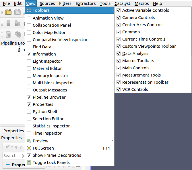

1.2.6. Getting back GUI components
  • If you accidentally close the Properties tab, the Information tab or the Pipeline Browser tab, open them again from the View menu.
  • If you accidentally undock one of the tabs, just drag it back into place, wait for a gray shadow to appear, and drop it into place.
