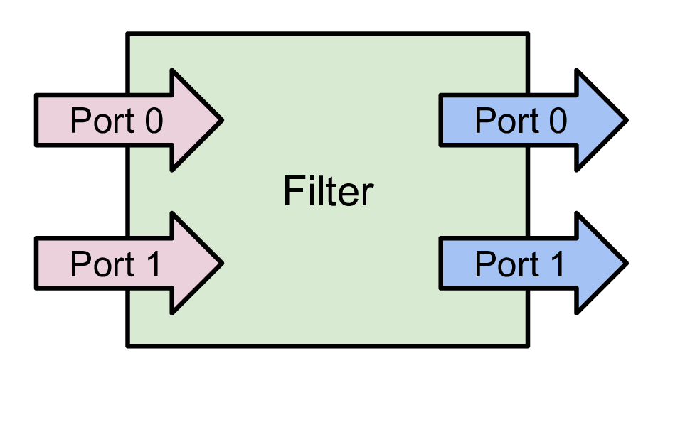

../_images/UnderstandingFilters.png
Fig. 5.1 A filter is a pipeline module with inputs and outputs. Data enters a filter through the inputs. The filter transforms the data and produces the resulting data on its outputs. A filter can have one or more input and output ports. Each input port can optionally accept multiple input connections.
An input port itself can optionally accept multiple input connections, e.g., the Append Datasets filter, which appends multiple datasets to create a single dataset only has one input port (named Input ). However, that port can accept multiple connections for each of the datasets to be appended . Filters define whether a particular input port can accept one or many input connections.
Similar to readers, the properties on the filter allow you to control the filtering algorithm. The properties available depend on the filter itself.

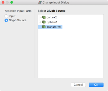

5.2.2. Multiple input ports
Most filters have just one input port. Hence, as soon as you click on the filter name in the Filters menu, it will create a new filter instance and that will show up in the Pipeline Browser . Certain filters, such as Resample With Dataset , have multiple inputs that must be set up before the filter can be created. In such a case, when you click on the filter name, the Change Input Dialog will pop up, as seen in Fig. 5.3. This dialog allows you to select the pipeline modules to be connected to each of the input ports. The active source(s) is connected by default to the first input port. You are free to change those as well.
../_images/ChangeInputDialog.png
Fig. 5.3 The Change Input Dialog is shown to allow you to pick inputs for each of the input ports for a filter with multiple input ports. To use this dialog, first select the Input Port you want to edit on the left side, and select the pipeline module(s) that are to be connected to this input port. Repeat the step for the other input port(s). If an input port can accept multiple input connections, you can select multiple modules, just like in the Pipeline Browser .

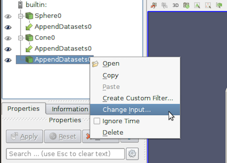

5.2.3. Changing input connections
paraview allows you to change the inputs to a filter after the filter has been created. To change inputs to a filter, right-click on the filter in the Pipeline Browser to get the context menu, and then select Change Input... . This will pop up the same Change Input Dialog as when creating a filter with multiple input ports. You can use this dialog to set new inputs for this filter.
../_images/ChangeInputContextMenu.png
Fig. 5.4 The context menu in the Pipeline Browser showing the option to change inputs for a filter.

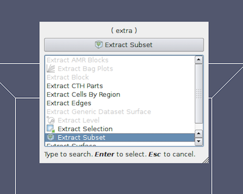

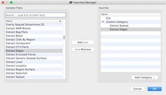

Did you know?
While the Filters menu is a handy way to create new filters, with the long list of filters available in ParaView, manually finding a particular filter in this menu can be very challenging. To make it easier, ParaView incorporates a quick launch mechanism. When you want to create a new filter (or a source), simply type CTRL + Space or Alt + Space. This will pop up the quick-launch dialog. Now, start typing the name of the filter you want. As you type, the dialog will update to show the filters and sources that match the typed text. You can use the arrow keys to navigate and use the Enter key to create the selected filter (or source). Press ⇧ while pressing Enter to quickly apply the filter on creation, equivalent to creating the filter and then clicking the Apply button. Note that filters may be disabled, as was the case in the Filters menu but by default the selected item will be the first enabled filter. You can use Esc to clear the text you have typed so far. Hit the Esc a second time, and the dialog will close without creating any new filter.
../_images/QuickLaunchDialog.png

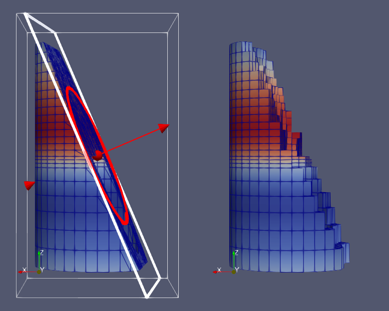

5.6.1.1. Clip in paraview
../_images/CrinkleClipComparison.png
Fig. 5.5 Comparison between results produced by the Clip filter with Crinkle Clip unchecked (left) and checked (right) when clipping with an implicit plane. The image on the left also shows the 3D widget used to interactivly place the implicit plane for the clipping operation.

The Inside Out option can be used to invert the behavior of this filter. Basically, it flips the notion of what is considered inside and outside of the given clipping space.
Check Crinkle Clip if you don’t want this filter to truly clip cells on the boundary, but want to preserve the input cell structure and to pass the entire cell on through the boundary (Fig. 5.5). This option is not available when clipping by Scalar .

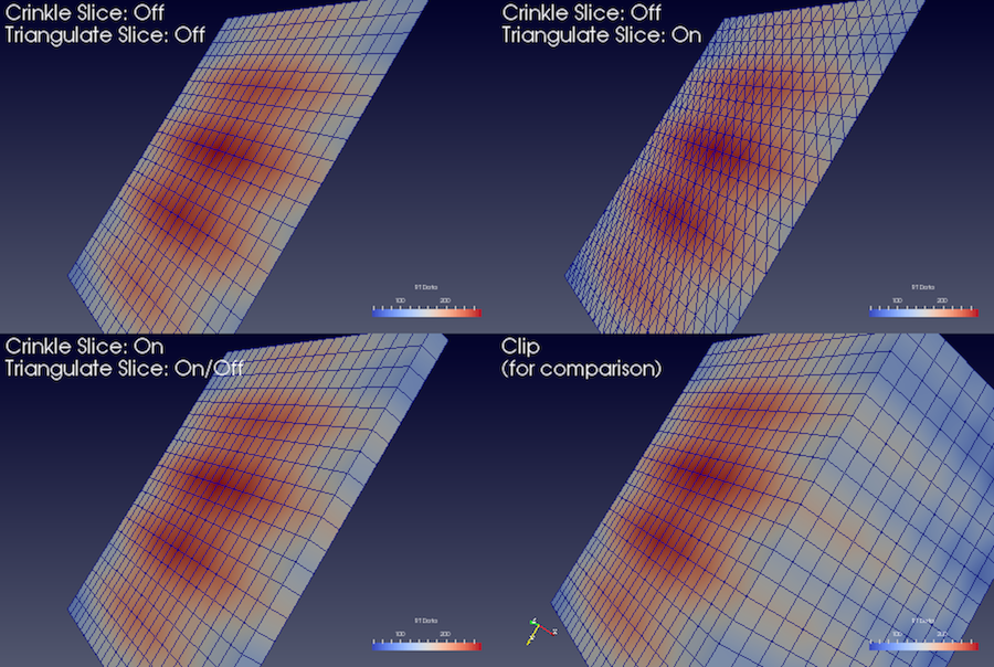

5.6.2. Slice
../_images/SliceComparisons.png
Fig. 5.7 Comparison between results produced by the Slice filter when slicing image data with an implicit plane with different options. The lower-left image shows the output produced by the Clip filter when clipping with the same implicit function, for contrast.
The Slice filter slices through the input dataset with an implicit function such as a plane, a sphere, or a box. Since this filter returns data elements along the implicit function boundary, this is a dimensionality reducing filter (except when crinkle slicing is enabled), i.e., if the input dataset has 3D elements like tetrahedrons or hexahedrons, the output will have 2D elements, line triangles, and quads, if any. While slicing through a dataset with 2D elements, the result will be lines.
The properties available on this filter, as well as the way of setting this filter up, is very similar to the Clip filter with a few notable differences. What remains similar is the set up of the implicit function – you have similar choices: Plane , Box , Sphere , and Cylinder , as well as the option to toggle Crinkle slice (i.e., to avoid cutting through cells, pass complete cells from the input dataset that intersects the implicit function).
What is different includes the lack of slicing by Scalar (for that, you can use the Contour filter) and a new option, Triangulate the slice . Fig. 5.7 shows the difference in the generated meshes when various slice properties are changed.
The Slice filter is more versatile than the Slice representation. First, the Slice representation is available for image datasets only, whereas the Slice filter can be used on any type of 3D dataset. Second, the representation extracts a subset of the image consisting of a 2D slice oriented in the XY, YZ, or XZ planes at the image voxel locations while the plane used by the filter can be placed arbitrarily. Third, since the Slice representation always shows a flat object and lighting may interfere with interpretation of data values on the slice, lighting is not applied to the Slice representation. Lighting is applied, however, to results from the Slice filter. Lastly, the Slice representation may be faster than the filter to update and scrub through different slices because it does not need to compute the intersection of a plane with cells in the dataset.
In paraview, this filter can be created using the pqSlice button on the Common filters toolbar, besides the Filters menu.

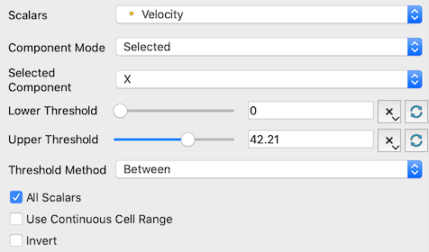

The Threshold filter extracts cells of the input dataset with scalar values lying within the specified range, depending on the selected threshold method. This filter operates on either point-centered or cell-centered data. Any type of dataset can be used as input. The filter produces an unstructured grid output.
When thresholding with cell data, all cells that have scalars within the specified range will be passed through the filter. When thresholding with point data, cells with all points with scalar values within the range are passed through if All Scalars is checked; otherwise, cells with any point that passes the thresholding criteria are passed through.
5.6.4.1. Threshold in paraview
../_images/ThresholdPanel.png
Fig. 5.10 The Properties panel for the Threshold filter.
This filter is represented as pqThreshold on the Common filters toolbar. After selecting the Scalars with which to threshold from the combo-box, the Lower Threshold and Upper Threshold values can be modified to specify the range. If the range shown by the sliders is not sufficient, it is also possible to manually type the values in the input boxes. The values are deliberately not clamped to the current data range.
The threshold method can also be selected using the Threshold Method combo box:
  • Between: Extracts cells with scalar values between the Lower Threshold and Upper Threshold.
  • Below Lower Threshold: Extracts cells with scalar values smaller than the Lower Threshold.
  • Above Upper Threshold: Extracts cells with scalar values larger than the Upper Threshold.
If the Scalars property is set to a vector array, the Component Mode property can be used to choose whether “All” components must pass the threshold test, “Any” component needs to pass the threshold test, or if a “Selected” component needs to pass the threshold test. If Component Mode is “Selected”, the Selected Component property designates which vector component needs to pass the threshold test. Other components are not tested.

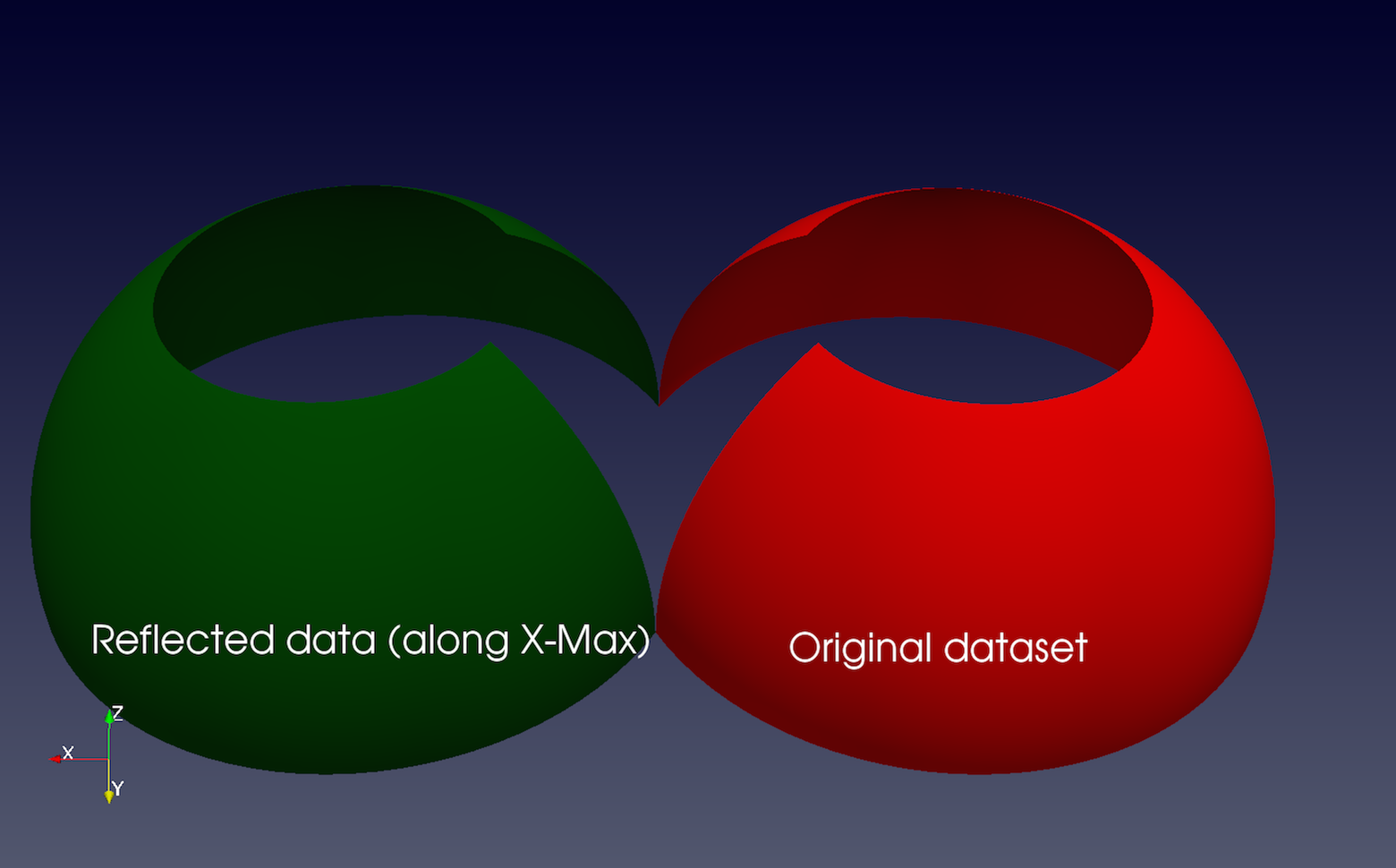

5.7.4. Reflect
../_images/ReflectFilter.png
Fig. 5.12 The Reflect filter can be used to reflect a dataset along a specific axis plane.
Reflect can be used to reflect any dataset across an axis plane. You can pick the axis plane to be one of the planes formed by the bounding box of the dataset. For that, set Plane as X Min , X Max , Y Min , Y Max , Z Min , or Z Max . To reflect across an arbitrary axis plane, select X , Y , or Z for the Plane property, and then set the Center to the plane offset from the origin.
This filter reflects the input dataset and produces an unstructured grid (Section 3.1.7). Thus, the same caveats for Clip and Threshold filter apply here when dealing with structured datasets.

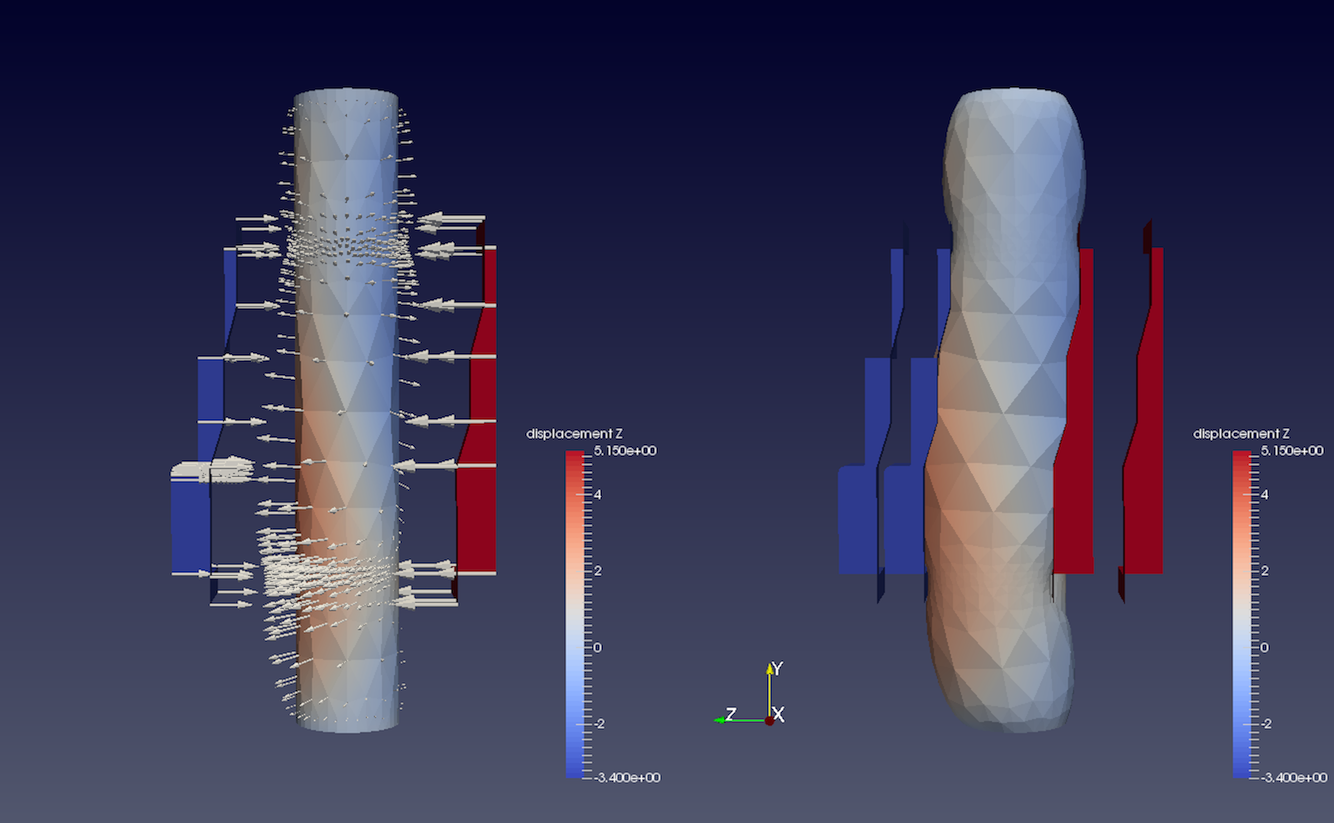

5.7.5. Warp By Vector
../_images/WarpByVector.png
Fig. 5.13 The Warp By Vector filter can be used to displace points in original data shown on the left, using the displacement vectors (indicated by arrow glyphs Section 5.8.1) to produce the result shown on the right.
Warp By Vector can be used to displace point coordinates in an input mesh using vectors in the dataset itself. You select the vectors to use utilizing the Vectors property on the Properties panel. Scale Factor can be used to scale the displacement applied.

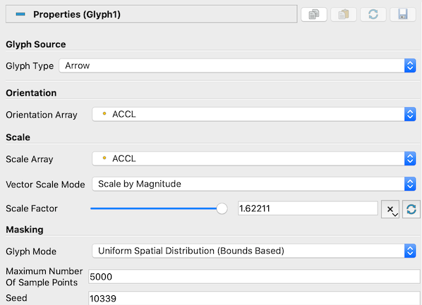

If the Scale Array is set to a vector array, the Vector Scale Mode property is available to select which properties of the vector should be used to transform each glyph. If Scale by Magnitude is chosen, then the glyph at a point will be scaled by the magnitude of the vector at that point. If Scale by Components is chosen, glyphs will be scaled separately in each dimension by the vector component in that dimension.
../_images/GlyphPropertiesPanel.png
Fig. 5.14 The Properties panel for the Glyph filter.
The Scale Factor is used to apply a constant scaling to all the glyphs, independent of the Scale Array and Vector Scale Mode properties. Choosing a good scale factor depends on several things including the bounds on the input dataset, the Scale Array and Vector Scale Mode selected, and the range for the array selected as the Scale Array . You can use the pqReset button next to the Scale Factor widget to have paraview pick a usually reasonable scale factor value based on the current dataset and scaling properties.

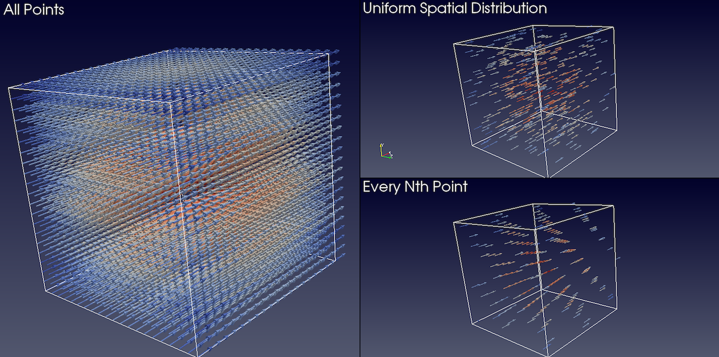

The Masking properties control which points from the input dataset get glyphed. The Glyph Mode controls how points are selected to be glyphs (Fig. 5.15). The available options are as follows:
  • All Points : This selects all points in the input dataset for glyphing. Use this mode with caution and only when the input dataset has relatively few points. Since all points in the input dataset are glyphed, this can not only cause visual clutter, but also clog up memory and take a long to time to generate and render the glyphs.
  • Every Nth Points : This elects every \(n^{th}\) point in the input dataset for glyphing, where \(n\) can be specified using Stride . Setting Stride to 1 will have the same effect as All Points .
  • Uniform Spatial Distribution (Bounds Based) : This selects a random set of points. The algorithm works by first computing up to Maximum Number of Sample Points in the space defined by the bounding box of the input dataset. Then, points in the input dataset that are close to the point in this set of sample points are glyphed. The Seed is used to seed the random number generator used to generate the sample points. This ensures that the random sample points are reproducible and consistent.
  • Uniform Spatial Distribution (Surface Sampling) : Selects a random set of points from the outer bounding surface of the input dataset. An inverse transform sampler is used to find a 2D cell on the surface to sample and a point is uniformly sampled from that cell.
  • Uniform Spatial Distribution (Volume Sampling) : Similar to the surface sampling mode described above, but the inverse transform sampler is used to find a 3D cell from which a random point is uniformly sampled
../_images/GlyphModesComparison.png
Fig. 5.15 Comparison between various Glyph Mode s when applied to the same dataset generated by the Wavelet source.

Glyph With Custom Source is the same as Glyph , except that instead of a limited set of Glyph Type , you can select any data source producing a polygonal dataset (Section 3.1.8) available in the Pipeline Browser . To use this filter, select the data source you wish to glyph in the Pipeline Browser and attach this filter to it. You will be presented a dialog where you can set the Input (which defaults to the source you selected) and the Glyph Source .
../_images/GlyphWithCustomSourceInputDialog.png
Fig. 5.16 Setting the Input and Glyph Source in the Glyph With Custom Source filter.

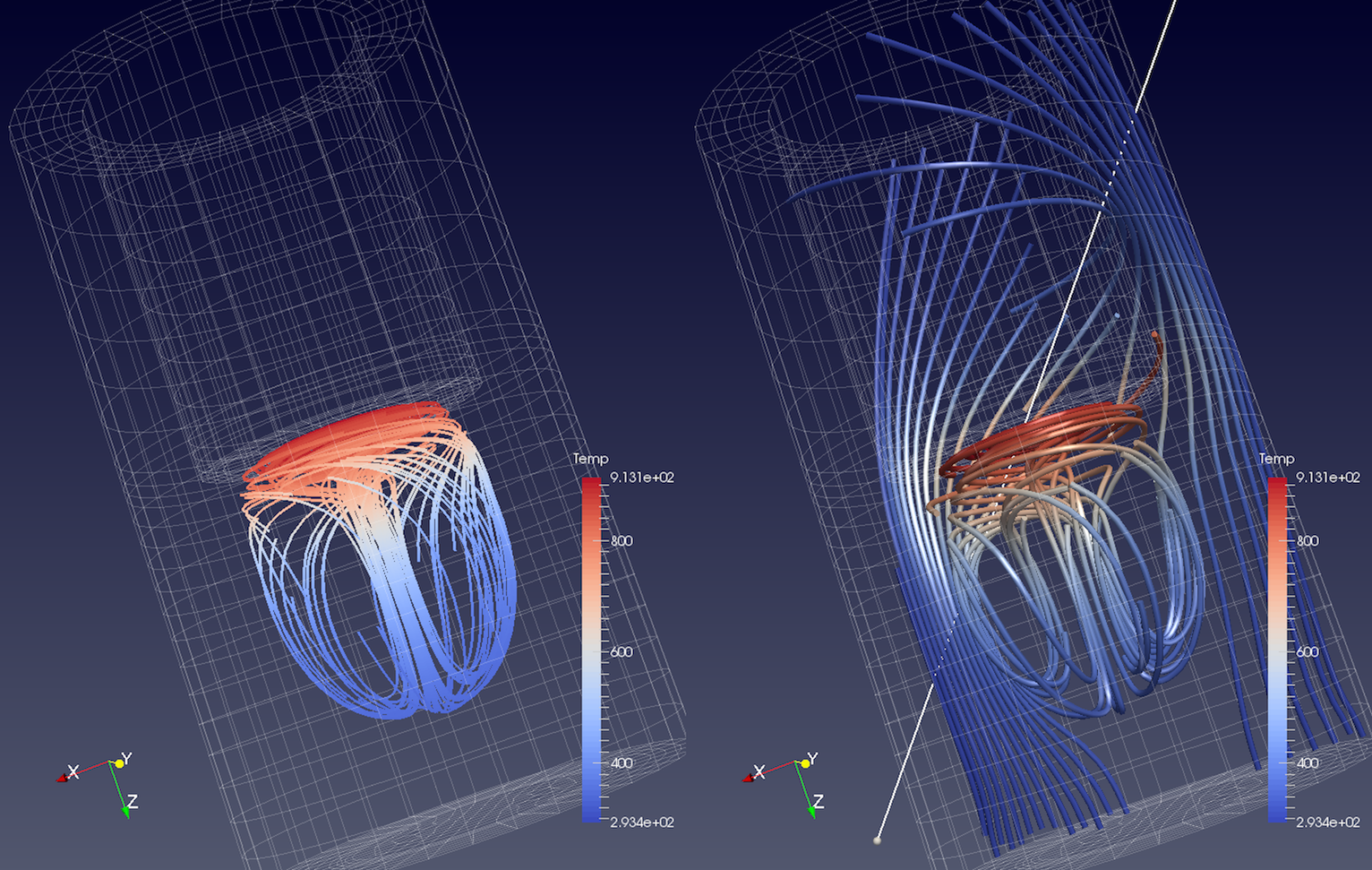

5.8.3. Stream Tracer
../_images/StreamlinesInParaView.png
Fig. 5.17 Streamlines generated from the disk_out_ref.ex2 dataset using the Point Source (left) and the High Resolution Line Source (right). On the left, we also added the Tube filter to the output of the Stream Tracer filter to generate 3D tubes rather than 1D polygonal lines, which can be hard to visualize due to lack of shading.
The Stream Tracer filter is used to generate streamlines for vector fields. In visualization, streamlines refer to curves that are instanteneously tangential to the the vector field in the dataset. They provide an indication of the direction in which the particles in the dataset would travel at that instant in time. The algorithm works by taking a set of points, known as seed points, in the dataset and then integrating the streamlines starting at these seed points.
In paraview, you can create this filter using the Filters menu, as well as the pqStreamTracer button on the Common filters toolbar. To use this filter, you first select the attribute array to use as the Vectors for generating the streamline. Integration Parameters let you fine tune the streamline integration by specifying the direction to integrate, Integration Direction , as well as the type of integration algorithm to use, Integrator Type . Advanced integration parameters are available in the advanced view of the Properties panel that let you further tune the integration, including specifying the step size and others. You use the Maximum Streamline Length to limit the maximum length for the streamline – the longer the length, the longer the generated streamlines.

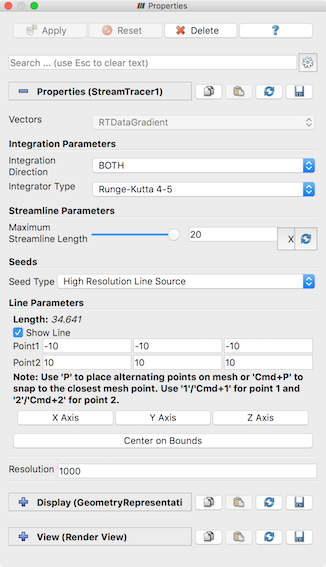

../_images/StreamlinesPropertiesPanel.png
Fig. 5.18 The Properties panel showing the default properties for the Stream Tracer filter.
Seeds group lets you set how the seed points for generating the streamlines are produced. You have two options: Point Source , which produces a point clound around the user-specified Point based on the parameters specified, and High Resolution Line Source , which produces seed points along the user-specified line. You can use the 3D widgets shown in the active Render View to interactively place the center for the point cloud or for defining the line.
Did you know?
The Stream Tracer filter produces a polydata with 1D lines for each of the generated streamlines. Since 1D lines cannot be shaded like surfaces in the Render View , you can get visualizations where it is hard to follow the streamlines. To give the streamlines some 3D structure, you can apply the Tube filter to the output of the streamlines. The properties on the Tube filter let you control the thickness of the tubes. You can also vary the thickness of the tubes based on data array, e.g., the magnitude of the vector field at the sample points in the streamline!
A script using the Stream Tracer filter in paraview typically looks like this:

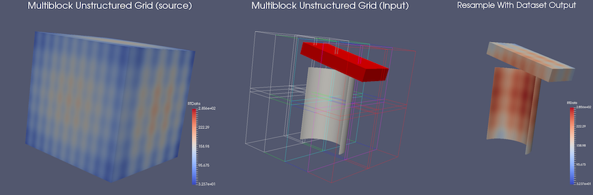

5.8.5. Resample With Dataset
../_images/ResampleWithDataset.png
Fig. 5.20 An example of Resample With Dataset . On the left is a multiblock tetrahedra mesh ( Input ). The middle shows a multiblock unstructured grid ( Source ). The outline of Input is also shown in this view. The result of applying the filter is shown on the right
Resample With Dataset samples the point and cell attributes of one dataset on to the points of another dataset. The two datasets are supplied to the filter using its two input ports: Input , which is the dataset that provides the attributes to resample, and Source , which is the dataset that provides the points to sample at. This filter is available under the Filters menu.

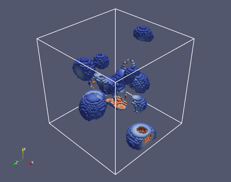

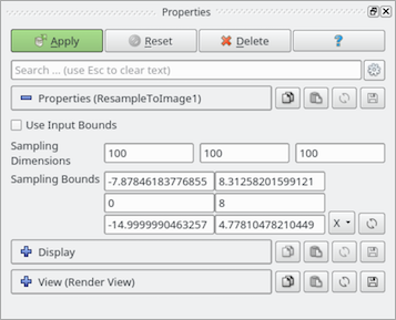

5.8.6. Resample To Image
Resample To Image is a specialization of Resample With Dataset . The filter takes one input and samples its point and cell attributes onto a uniform grid of points. The bounds and extents of the uniform grid can be specified using the properties panel. By default, the bounds are set to the bounds of the input dataset. The output of the filter is an Image dataset.
../_images/ResampleToImageProperties.png
Fig. 5.21 The Properties panel for Resample To Image filter.

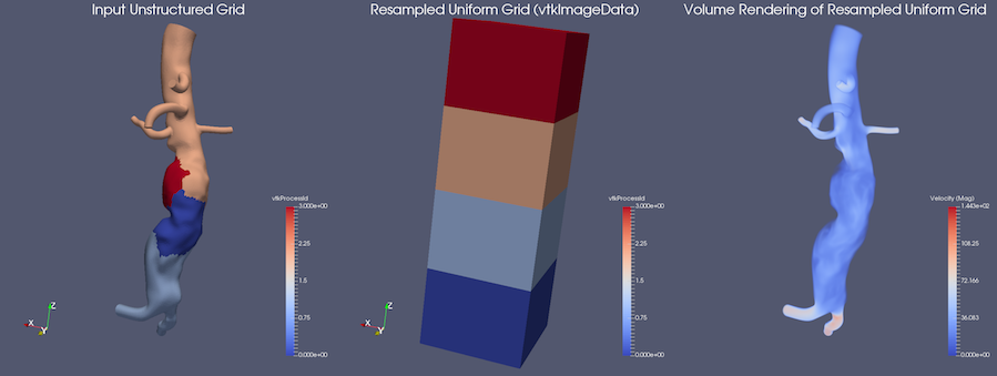

../_images/ResampleToImageExample.png
Fig. 5.22 An example of Resample To Image . The left portion shows the input (unstructured grid), and the middle displays the output image data. On the right is a volume rendering of the resampled data.
Some operations can be performed more efficiently on uniform grid datasets. Volume rendering is one such operation. The Resample to Image filter can be used to convert any dataset to Image data before performing such operations.

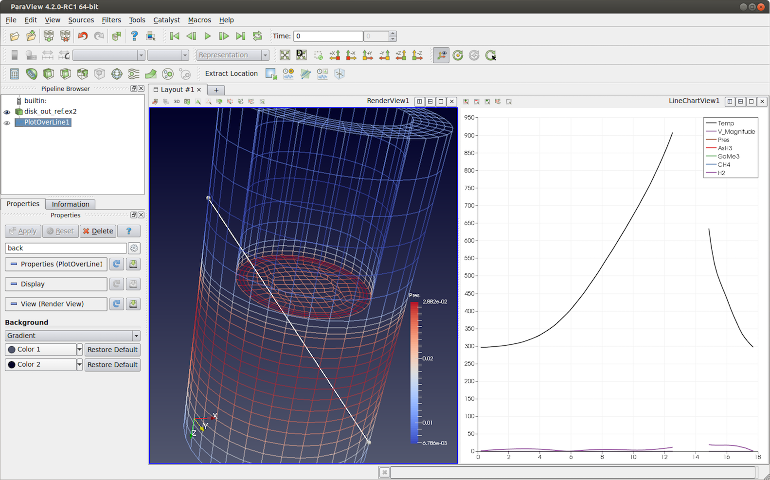

5.8.8. Plot over line
../_images/PlotOverLineInParaView.png
Fig. 5.23 The Plot Over Line filter applied to the disk_out_ref.ex2 dataset to plot values at sampled locations along the line. Gaps in the line correspond to the locations in the input dataset where the line falls outside the dataset.
Plot Over Line will sample the input dataset along the specified line and then plot the results in Line Chart View . Internally, this filter uses the same mechanism as the Probe filter, probing along the points in the line to get the containing cell attributes and interpolated point attributes.
Using the Resolution property on the Properties panel, you can control the number of sample points along the line.

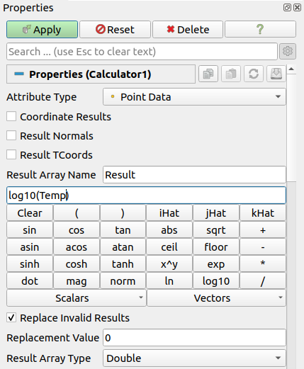

5.9.1. Calculator
The Calculator filter computes a new data array or new point coordinates as a function of existing input arrays. If point-centered arrays are used in the computation of a new data array, the resulting array will also be point-centered. Similarly, computations using cell-centered arrays will produce a new cell-centered array. If the function is computing point coordinates (requested by checking the Coordinate Results property on the Properties panel) , the result of the function must be a three-component vector. The Calculator interface operates similarly to a scientific calculator. In creating the function to evaluate, the standard order of operations applies. Each of the calculator functions is described below. Unless otherwise noted, enclose the operand in parentheses using the ( and ) buttons.

The Scalars menu lists the names of the scalar arrays and the components of the vector arrays of either the point-centered or cell-centered data. The Vectors menu lists the names of the point-centered or cell-centered vector arrays. The function will be computed for each point (or cell) using the scalar or vector value of the array at that point (or cell). The filter operates on any type of dataset, but the input dataset must have at least one scalar or vector array. The arrays can be either point-centered or cell-centered. The Calculator filter’s output is of the same dataset type as the input.
Did you know?
It used to be a common use-case for the Calculator filter to convert three input scalars into a vector array. For that, the Function would look something like: \(scalar_x * iHat + scalar_y * jHat + scalar_z * kHat\).
Now, the Merge Vector Components filter provides a simpler way to do this by simply selecting the three scalars to combine into a vector array.
../_images/CalculatorInParaView.png
Fig. 5.24 The Properties panel for the Calculator filter showing the advanced properties.
The Properties panel provides access to several options for this filter. Checking Coordinate Results , Result Normals , or Result TCoords will set the computed array as the point coordinates, normals, or texture coordinates, respectively. Result Array Name is used to specify a name for the computed array. The default is Result.
Sometimes, the expression can yield invalid values. To replace all invalid values with a specific value, check the Replace Invalid Results checkbox and then enter the value to use to replace invalid values using the Replacement Value . The output array data type is set with the Result Array Type property.
To ease the reuse of expressions, three helper buttons are also present to load an expression, save the current one and inspect the list of already saved expressions from the Expression Manager.

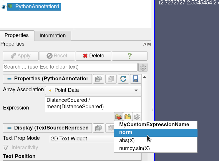

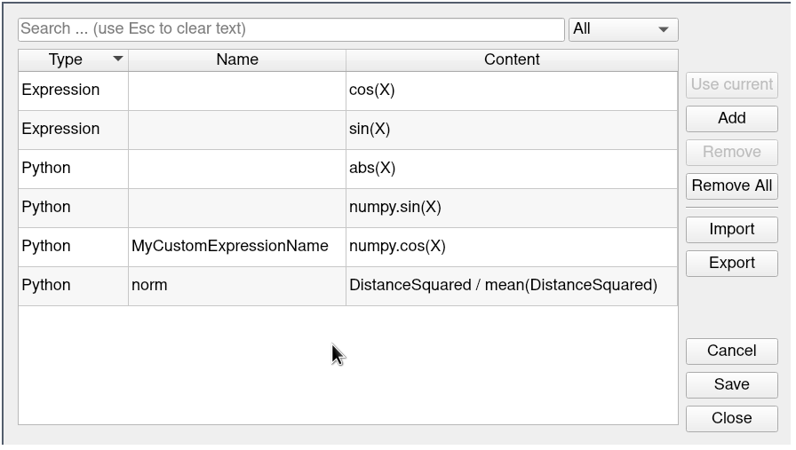

5.9.2. Expression Manager
ParaView provides an Expression Manager to ease the expression property configuration by storing expressions, and giving quick access to them. Each expression can be named and has an associated group so it is easy to filter Python expressions from others.
This feature comes in two parts:
From the Property Panel, the one-line property text entry is augmented with:
  • a drop down list to access existing expressions
  • a Save Current Expression button
  • a shortcut to the Choose Expression dialog
../_images/FilteringExpressionManager-PropertyIntegration.png
Fig. 5.25 Expression-related buttons in the Properties Panel.
The Choose Expression dialog, also accessible from the Tools > Manage Expressions menu item, is an editable and searchable list of the stored expressions. ParaView keeps track of them through the settings, but they can also be exported to a JSON file for backup and sharing.
../_images/FilteringExpressionManager-Dialog.png
Fig. 5.26 Choose Expression Dialog.

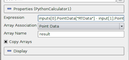

5.9.3. Python calculator
../_images/ParaView_UG_Python_calculator.png
Fig. 5.27 The Properties Panel for Python Calculator.
The Python Calculator is similar to Calculator in that it processes one or more input arrays based on an expression provided by the user to produce a new output array. However, it uses Python (and NumPy) to do the computation. Therefore, it provides more expressive computational capabilities.
Specify whether to Use Multiline Expression, the Expression to use, the Array Association to indicate the array association (Point Data, Cell Data, or Field Data), the name of output array (Array Name), a toggle that controls whether the input arrays are copied to the output (Copy Array), and a Result Array Type to specify the type of output data array to store the calculated results in.
The Python Calculator also integrated the Expression Manager described in Section 5.9.2.

5.9.3.3. Comparing multiple datasets
The Python Calculator can be used to compare multiple datasets, as shown by the following example.
  • Go to the Menu Bar, and select Edit > Reset Session to clear the Pipeline.
  • Select Source > Mandelbrot, and then click Apply, which will set up a default version of the Mandelbrot Set. The data for this set are stored in a \(251 \times 251\) scalar array.
  • Select Source > Mandelbrot again, and then go to the Properties panel and set the Maximum Number of Iterations to 50. Click Apply , which will set up a different version of the Mandelbrot Set, represented by the same size array.
  • Hold the Shift key down and select both of the Mandelbrot entries in the Pipeline Inspector, and then go to the Menu Bar, and select Filter > Python Calculator. The two Mandelbrot entries will now be shown as linked, as inputs, to the Python Calculator .
  • In the Properties panel for the Python Calculator filter, enter the following into the Expression box:
    inputs[1].PointData['Iterations'] - inputs[0].PointData['Iterations']
    This expression specifies the difference between the second and the first Mandelbrot arrays. The result is saved in a new array called results . The prefixes in the names for the array variables, inputs[1] and inputs[0] , refer to the first and second Mandelbrot entries, respectively, in the Pipeline. PointData specifies that the inputs contain point values. The quoted label 'Iterations' is the local name for these arrays. Click Apply to initiate the calculation.

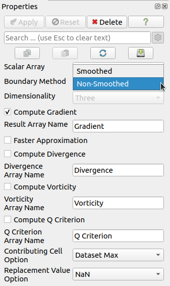

5.9.4. Gradient
The Gradient filter computes the gradient of a cell or point data array for any type of dataset.
For unstructured grids, the gradient for cell data corresponds to the cell derivatives. For point data, the gradient at a given point is computed as the average of the derivatives of the cells to which the point belongs.
For structured grids, the gradient is computed using central differencing, except on the boundary of the dataset where forward and backward differencing is used for the boundary elements.
This filter can optionally compute the divergence, vorticity (also known as the curl), and Q-criterion. A 3-component array is required in order to compute these quantities. By default, only the gradient computation is enabled.
In the case of a uniform rectilinear grid (see Section 3.1.3), a specific implementation which efficiently computes the gradient of point data arrays is also available. This implementation extends the use of central differencing on the boundary elements after duplication of the boundary values. To activate this option, set the Boundary Method property to Smoothed, as shown in Fig. 5.28.
../_images/GradientProperties.png
Fig. 5.28 The Properties Panel for the Gradient filter applied to a uniform structured grid.

5.11. Favorite filters
If you use some filters more than others, you can organize them in the Filters > Favorites menu. This can be done from the context menu in the pipeline or through the Filters > Manage Favorites menu as shown in Fig. 5.29. In this dialog you can create categories and subcategories. It supports drag’n’drop operation to sort and move filters and categories. Moreover, Favorites are highlighted in the other filter submenus on supported platforms. Favorites are saved in user settings so they can be used in other subsequent ParaView sessions.
../_images/FavoritesManager.png
Fig. 5.29 The Favorites Manager dialog. Left: the list of available filters. Right: the favorites, organized into categories.

Another way to peer inside of a volume is to perform a Slice on it. The Slice filter will intersect a volume with a plane and allow you to see the data in the volume where the plane intersects. If you know the relative location of an interesting feature in your large dataset, slicing is a good way to view it.
If you have little a priori knowledge of your data and would like to explore the data without the long memory and processing time for the full dataset, you can use the Extract Subset filter to subsample the data. The subsampled data can be dramatically smaller than the original data and should still be well load balanced. Of course, be aware that you may miss small features if the subsampling steps over them and that once you find a feature you should go back and visualize it with the full dataset.
There are also several features that can pull out a subset of a volume: Clip , Threshold , Extract Selection , and Extract Subset can all extract cells based on some criterion. Be aware, however, that the extracted cells are almost never well balanced; expect some processes to have no cells removed. All of these filters, with the exception of Extract Subset , will convert structured data types to unstructured grids. Therefore, they should not be used unless the extracted cells are of at least an order of magnitude less than the source data.
When possible, replace the use of a filter that extracts 3D data with one that will extract 2D surfaces. For example, if you are interested in a plane through the data, use the Slice filter rather than the Clip filter. If you are interested in knowing the location of a region of cells containing a particular range of values, consider using the Contour filter to generate surfaces at the ends of the range rather than extract all of the cells with the Threshold filter. Be aware that substituting filters can have an effect on downstream filters. For example, running the Histogram filter after Threshold will have an entirely different effect than running it after the roughly equivalent Contour filter.
