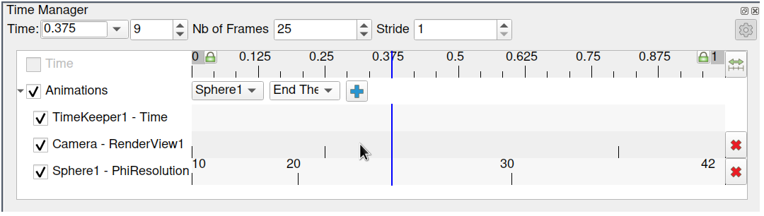

The Time Manager has a header bar that lets you control some properties of the animation itself, as you can see in Fig. 7.4.
../_images/TimeManagerWidgets.png
Fig. 7.4 Time Manager Widgets.
The Time entry-box shows the current animation time, which is the same as shown by a vertical marker in this view. You can change the current animation time by either entering a value in this box, if available, or by dragging the vertical marker. The second entry-box is the timestep index. You can also edit it.
If the scene does not use any pipeline sources to get its list of times (see below), you can also edit Number of frames to set the total number of frames for the scene.
The Stride parameter, available in advanced mode, allows to jump by this number of timesteps when navigating through times.

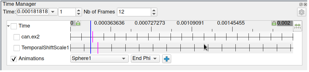

ParaView supports two modes to configure scene times. The time list can either come from the data themself or it can be generated. We call them Snap to Timestep and Sequence respectively.
../_images/TimeManagerSequence.png
Fig. 7.5 Time Manager Sequence.
In Sequence mode, the number of frames is controlled by the No. Frames spinbox. Times are evenly spaced between Start and End time. This is the preferred mode when working with non-temporal data. This is activated when none of the Time tracks are enabled, i.e. the checkbox left to the Time label of first track is disabled.
In the figure, the main timeline has 12 ticks. They do not match the times from the data, as expected for a sequence.

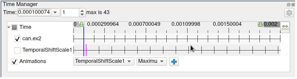

Fig. 7.6 Time Manager Snap to timesteps.
In Snap To TimeSteps mode, the number of frames in the animation is determined by the number of time values in the dataset being animated and thus cannot be changed. This is the animation mode used by default by ParaView when a dataset with time values is loaded. Then playing the animation means playing through the time values of the dataset one after the other. This is enabled when at least one Time track is checked.
In the figure, only can.ex2 is checked so the scene knows only about its timesteps: the main timeline has same ticks as the can.ex2 track.

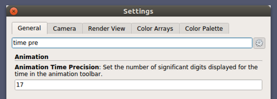

Did you know?
You can change the precision (number of significant digits) displayed by the animation clock by changing the Animation Time Precision value in the Settings under the General tab.
../_images/AnimationTimePrecision.png

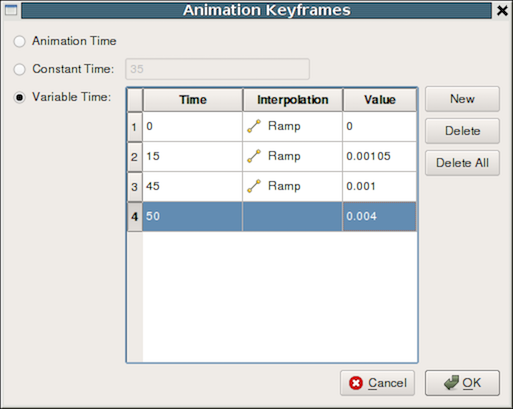

If you double-click in the TimeKeeper – Time track, the Animation Keyframes dialog, an example of which is shown in Fig. 7.7, appears. In this dialog, you can make data time progress in three fundamentally different ways. If the Animation Time radio-button is selected, the data time will be tied to and scaled with the animation time so that, as the animation progresses, you will see the data evolve naturally. If you want to ignore the time varying nature of the data, you can select Constant Time instead. In this case, you choose a particular time value at which the data will be displayed for the duration of the animation. Finally, you can select the Variable Time radio-button to have full control over data time and to control it as you do any other animatable property in the visualization pipeline. In the example shown in Fig. 7.7, time is made to progress forward for the first 15 frames of the animation, backward for the next 30, and forward for the final 15.
../_images/ParaViewUsersGuideAnimationKeyframesTime.png
Fig. 7.7 Controlling Data Time with keyframes.

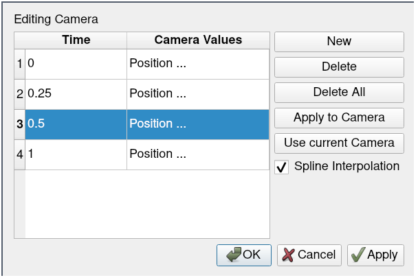

In this mode, you specify camera position, focal point, view angle, and up direction at each keyframe. The animation player interpolates between these specified locations. As with other parameters, to edit the keyframes, double-click on the track. It is also possible to capture the current location as a keyframe by using the Use Current button.
../_images/AnimationCameraInterpolationEditor.png
Fig. 7.8 Setting camera animation parameters.
It can be quite challenging to add enough keyframes correctly to ensure that the animation results in a smooth visualization using this mode. However, it is the preferred mode if you want fine control on a few cameras.

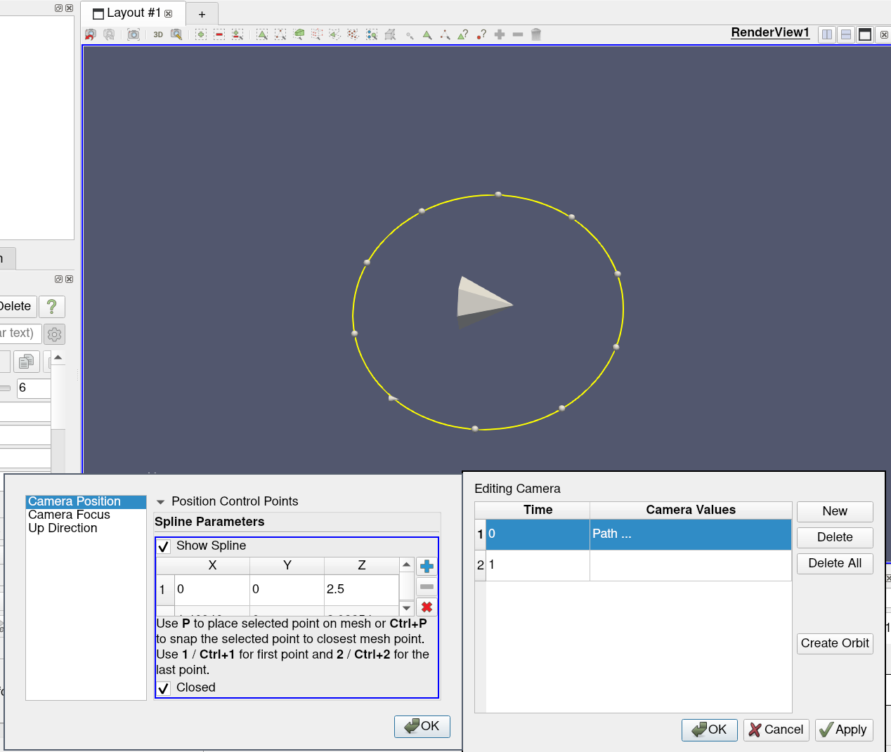

In this mode, you get the opportunity to specify the path taken by the camera position and the camera focal point. By default, the path is set up to orbit around the selected objects. You can then edit the keyframe to change the paths. This is the preferred mode if you want to control the global motion more than exact points of view.
Fig. 7.9 shows the dialog for editing these paths for a keyframe. When Camera Position or Camera Focus is selected, a widget is shown in the 3D view that can be used to set the path. Use CTRL + Left Click to insert new control points, and ⇧ + Left Click to remove control points. You can also toggle when the path should be closed or not.
../_images/AnimationCameraPathEditor.png
Fig. 7.9 Creating a camera path.

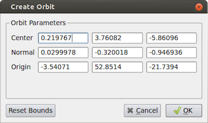

This mode makes it possible to quickly create a camera animation in which the camera revolves around objects of interest. Clicking on the Orbit button will pop up a dialog where you can edit the orbit parameters such as the center of revolution, the normal for the plane of revolution, and the origin (i.e., a point on the plane where the revolution begins). By default, the Center is the center of the bounds of the selected objects, the Normal is the current up direction used by the camera, while the origin is the current camera position.
../_images/ParaViewUsersGuideCameraOrbit.png
Fig. 7.10 Creating a camera orbit.
