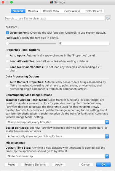

The Settings dialog is split into several tabs. The General tab consolidates most of the miscellaneous settings. The Camera tab enables you to change the mouse interaction mappings for the Render View and similar views. The Render View tab, which we saw earlier in Section 8.12.1 and Section 8.12.4, provides options in regards to rendering in Render View and similar views. The Color Palette tab is used to change the active color palette.
Using this dialog is not much different than the Properties panel. You have the Search box at the top, which allows you to search properties matching the input text ( Section 1.1.2). The pqAdvanced button can be used to toggle between default and advanced modes.
To apply the changes made to any of the settings, use the Apply or OK buttons. OK will apply the changes and close the dialog, while Cancel will reject any changes made and close the dialog. Any changes made to the options in this dialog are persistent across sessions. That is, the next time you launch paraview, you’ll still be using the same settings chosen earlier. To revert to the default, use the Restore Defaults button. You can also manually edit the setting file as in Section 14.3.1. Furthermore, site maintainers can provide site-wide defaults for these, as is explained in Section 14.4.
Next, we will see some of the important options available. Those that are only available in the advanced mode are indicated as such using the pqAdvanced icon. You will either need to toggle on the advanced options with the pqAdvanced button or search for the option using the Search box.

  • General Options
    • Show Welcome Dialog : Uncheck this to not show the welcome screen at application startup. You will need to restart paraview to see the effect. pqAdvanced
    • Show Save State On Exit : When this is checked paraview will prompt you to save a state file when you exit the application. pqAdvanced
    • Crash Recovery : When this is checked, paraview will intermittently save a backup state file as you make changes in the visualization pipeline. If paraview crashes for some reason, then when you relaunch paraview, it will provide you with a choice to load the backup state saved before the crash occurred. This is not \(100\%\) reliable, but some users may find it useful to avoid losing their visualization state due to a crash. pqAdvanced
    • Force Single Column Menus : On platforms that support multicolumn menus, ensure all menu items are selectable on low-resolution screens.
  • GUI Font
    • Override Font : When checked, use a custom font size for the user interface. This overrides the system default font size.
    • Font Size : The size of the font to use for UI elements.
  • View Options
    • Default View Type : When paraview starts up, it creates Render View by default. You can use this option to change the type of the view that is created by default, instead of the Render View . You can even pick None if you don’t want to create any view by default. pqAdvanced
  • Properties Panel Options
    • Auto Apply : When checked, the Properties panel will automatically apply any changes you make to the properties without requiring you to click the Apply button. The same setting can also be toggled using the pqAdvanced button in the Main Controls toolbar.
    • Auto Apply Active Only : This limits the auto-applying to the properties on the active source alone. pqAdvanced
    • Properties Panel Mode : This allows you to split the Properties panel into separate panels as described in Section 1.2. pqAdvanced
  • Data Processing Options
    • Auto Convert Properties : Several filters only work on one type of array, e.g., point data arrays or cell data arrays. Before using such filters, you are expected to apply the Point Data To Cell Data or Cell Data To Point Data filters. To avoid having to add these filters explicitly, you can check this checkbox. When checked, ParaView will automatically convert data arrays as needed by filters, including converting cell array to point arrays and vice-versa, as well as extracting a single component from a multi-component array.
  • Color/Opacity Map Range Options
    • Transfer Function Reset Mode : This setting controls the initial settings for how ParaView will reset the ranges for color and opacity maps (or transfer functions). This sets the initial value of the Automatic Rescale Range Mode for newly created color/opacity maps ( Section 4.2.2). This setting can be changed on a per-color map basis after the color map has been created.
    • Scalar Bar Mode : This settings controls how paraview manages showing the color legend (or scalar bar) in Render View and similar views.
  • Default Time Step Whenever a dataset with timesteps is opened, this setting controls how paraview will update the current time shown by the application. You can choose between Leave current time unchanged, if possible, Go to first timestep, and Go to last timestep.
  • Animation
    • Cache Geometry For Animation : This enables caching of geometry when playing animations to attempt to speed up animation playback in a loop. When caching is enabled, data ranges reported by the Information panel and others can be incorrect, since the pipeline may not have updated. pqAdvanced
    • Animation Geometry Cache Limit : When animation caching is enabled, this setting controls how much geometry (in kilobytes) can be cached by any rank. As soon as a rank’s cache size reaches this limit, ParaView will no longer cache the remaining timesteps. pqAdvanced
    • Animation Time Notation : Sets the display notation for the time in the annotation toolbar. Options are Mixed , Scientific , and Fixed .
    • Animation Time Precision : Sets the number of digits displayed in the time in the animation toolbar.
  • Maximum Number of Data Representation Labels When a selection is labeled by data attributes this is the maximum number of labels to use. When the number of points/cells to label is above this value then a subset of this many will be labeled instead. Too many overlapping labels becomes illegible, so this is set to 100 by default.

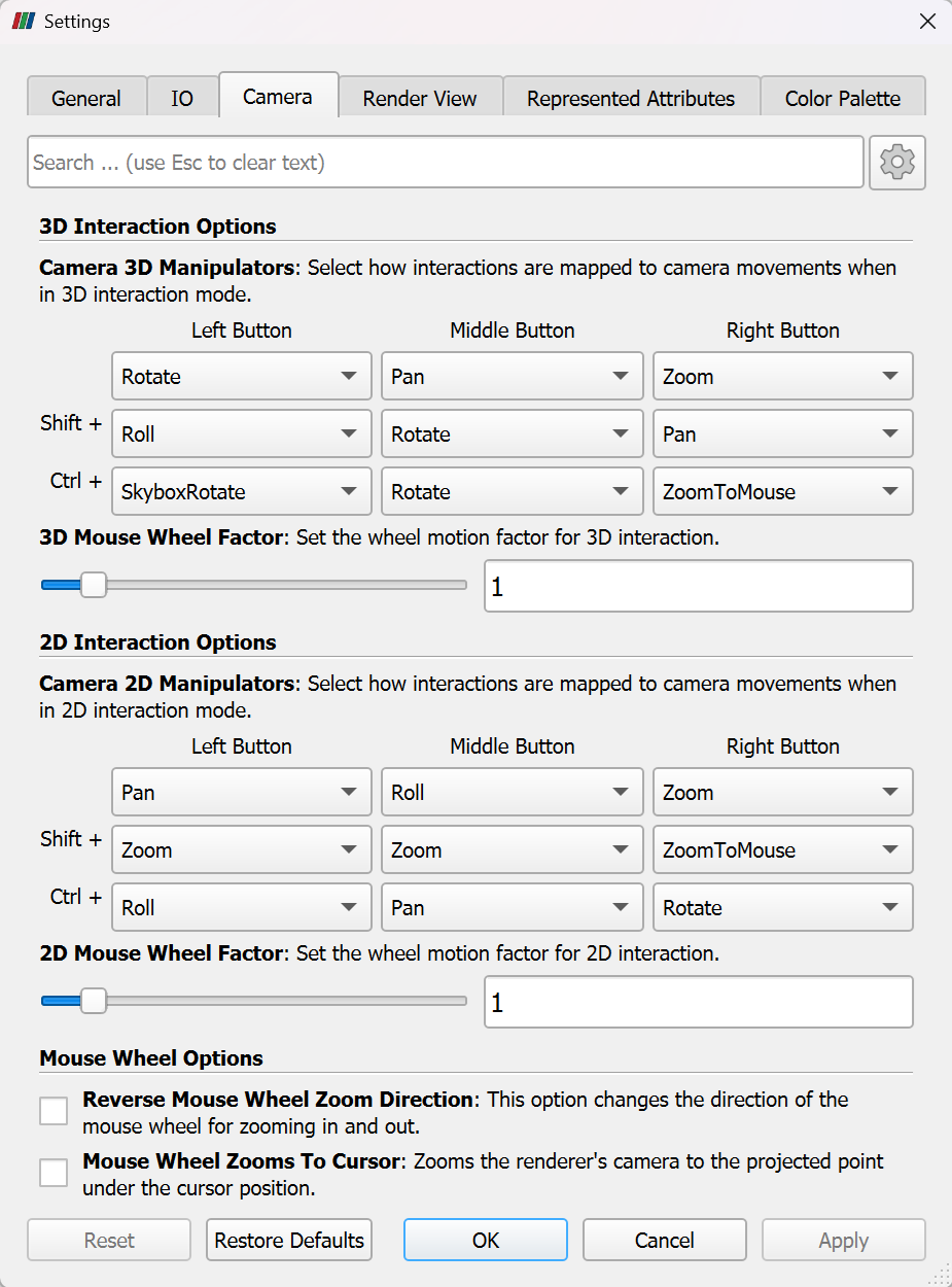

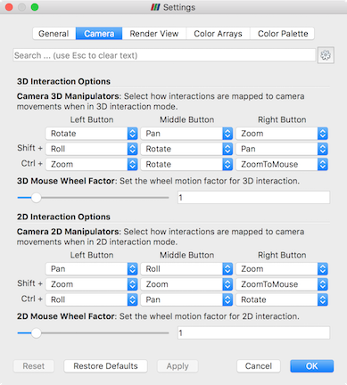

This tab allows you to configure how you interact with 3D and 2D views in ParaView. You can customize the mapping between mouse buttons and keyboard modifiers to camera interaction types, such as Rotate, Pan, Zoom, and others. The mappings are defined separately for 3D and 2D interaction modes. You can reassign these controls by setting them to your desired mouse button (left, middle or right) and modifier combinations (no modifier, (shift), or CTRL/).
The types of camera controls that can be assigned are: Pan, Zoom, Roll, Rotate, Zoom To Mouse, Multi Rotate and Rotate Skybox.
Additionally, you can adjust the 2D and 3D mouse wheel factors, which control the zoom rate of the camera movements in their respective modes. There are also options to reverse the mouse wheel zoom direction, and to enable zooming to the cursor position instead of the center of the view.
Changes made in this dialog persist across sessions. You may reset to the default settings by clicking the Restore Defaults button and then selecting Apply, or restore any settings that were changed but not applied back to their prior state, by clicking the Reset button.

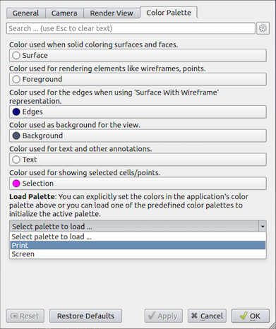

The Color Palette tab ( Fig. 14.3) allows you to change the colors in the active color palette. The tab lists the available color categories Surface , Foreground , Edges , Background , Text , and Selection . You can manually set colors to use for each of these categories or load one of the predefined palettes using the Load Palette option. To understand color palettes , let’s look at an example.

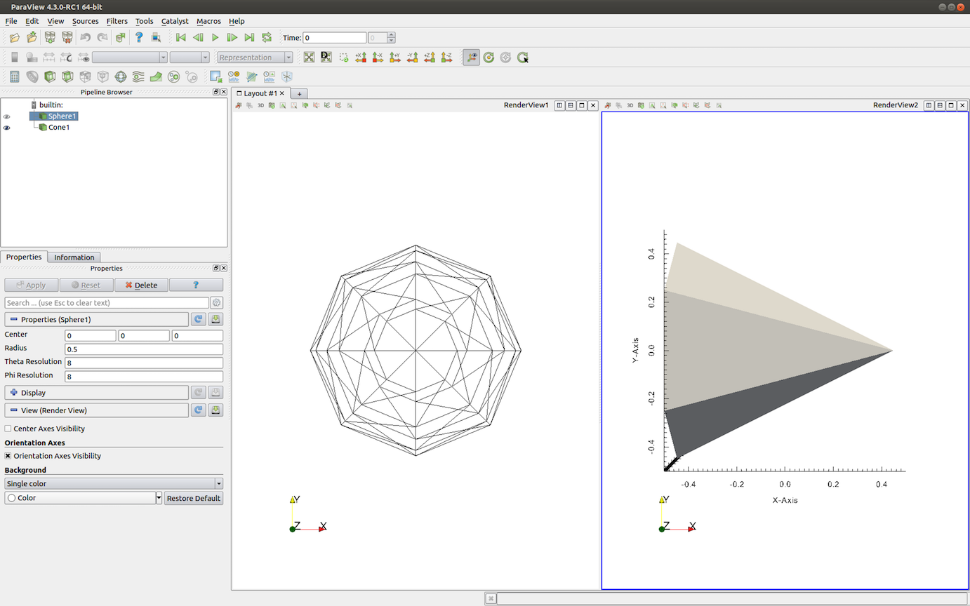

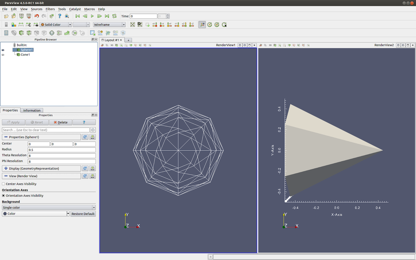

Let’s start paraview and split the active view to create two Render View instances side by side. You may want to start paraview with the -dr command line argument to stop any of your current settings from interfering with this demo. Next, show Sphere as Wireframe in the view on the left, and show Cone as Surface in the view on the right. Also, turn on Cube Axis for Cone . You will see something like Fig. 14.4 (top).
../_images/ColorPaletteDemo1.png
../_images/ColorPaletteDemo2.png
Fig. 14.4 The effect of loading the Print color palette as the active palette. The top is the original visualization and the bottom shows the result after loading the Print palette.
Now let’s say you want to generate an image for printing. Typically, for printing, you’d want the background color to be white, while the wireframes and annotations to be colored black. To do that, one way is to go change each of the colors for each each of the views, displays and cube-axes. You can imagine how tedious that will get especially with larger pipelines. Alternatively, using the Settings dialog, change the active color palette to Print as shown in Fig. 14.3 and then click OK or Apply . The visualization will immediately change to something like Fig. 14.4 (bottom).

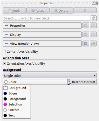

Essentially, ParaView allows you to link any color property to one of the color categories. When the color palette is changed, any color property linked to a palette category will also be automatically updated to match the category color. Fig. 14.5 shows how to link a color property to a color palette category in the Properties panel. Use the tiny drop-down menu marker to make the menu pop up that shows the color palette categories. Select any one of them to link that property with the category. The link is automatically severed if you manually change the color by simply clicking on the button.
../_images/LinkToColorPalette.png
Fig. 14.5 Popup menu allows you to link a color property to a color palette category in the Properties panel.}

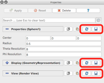

The Properties panel in paraview has three sections, Properties , Display , and View . Each section has two buttons. These buttons are circled in red in Fig. 14.6. The button with the disk icon is used to save the current property values in that section that have been applied with the Apply button. Property values that have been changed but not applied with the Apply button will not be saved as custom default settings.
The button with the circular arrow (or reload icon) is used to restore any custom property settings for the object to ParaView’s application defaults. Once you save the current property settings as defaults, those values will be treated as the defaults from then on until you change them to another value or reset them. The saved defaults are written to a configuration file so that they are available when you close and launch ParaView again.
../_images/SaveRestoreSettingsButtons.png
Fig. 14.6 Buttons for saving and restoring default property values in the Properties panel.
You can undo your changes to the default property values by clicking on the reload button. This will reset the current view property values to paraview’s application defaults. To fully restore paraview’s default values, you need to click the save button again. If you don’t, the restored default values will be applied only to the current object, and new instances of that object will have the custom default values that were saved the last time you clicked the save button.
