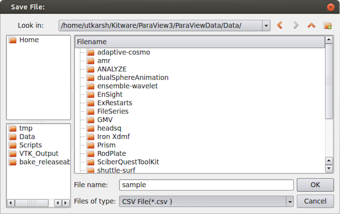

8.1. Saving datasets
You can save the dataset produced by any pipeline module in ParaView, including sources, readers, and filters. To save the dataset in paraview, begin by selecting the pipeline module in the Pipeline Browser to make it the active source. For modules with multiple output ports, select the output port producing the dataset of interest. To save the dataset, use the File > Save Data menu or the pqSave button in the Main Controls toolbar. You can also use the keyboard shortcut CTRL + S (or + S). The Save File dialog (Fig. 8.1) will allow you to select the filename and the file format. The available list of file formats depends on the type of the dataset you are trying to save.
../_images/SaveFileDialog.png
Fig. 8.1 Save File dialog in paraview.

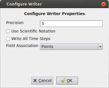

On accepting a filename and file format to use, paraview may show the Configure Writer dialog (Fig. 8.2). This dialog allows you to further customize the writing process. The properties shown in this dialog depend on the selected file format and range from enabling you to Write All Time Steps , to selecting the attributes to write in the output file.
../_images/ConfigureWriterDialogCSV.png
Fig. 8.2 Configure Writer dialog in paraview shown when saving a dataset as a csv file.

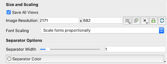

If the active tab has more than one view, then the Save Screenshot Options dialog has a few more options as shown in Fig. 8.4.
../_images/SaveScreenshotOptionsMultiView.png
Fig. 8.4 Extra options in Save Screenshot Options dialog available when the active tab has more than 1 view.
  • Save All Views : Check this to save all the views in the active tab laid out exactly as in the UI. If unchecked, only the active view will be saved.
  • Separator Options : These control the separator drawn between the views in the generated image. You can specify the Separator Width in approximate pixels as well as the Separator Color .

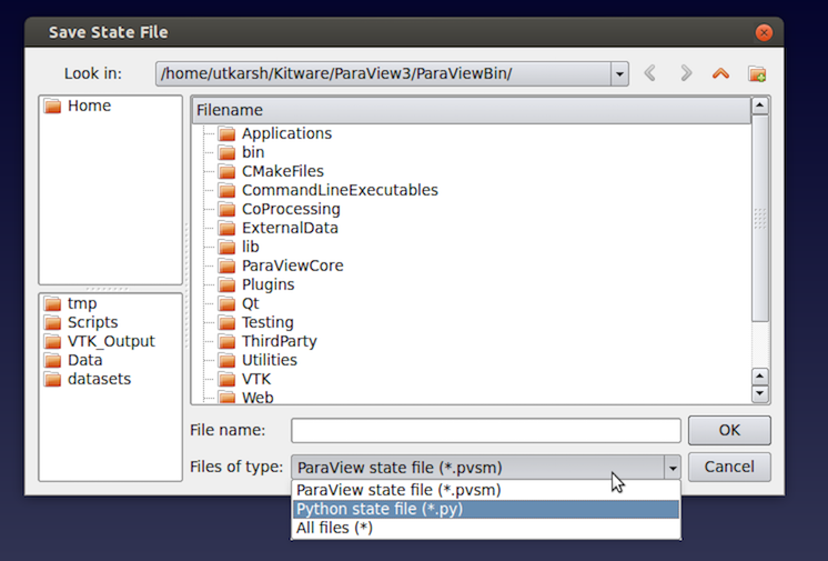

There are two types of state files that you can save in paraview: ParaView state file (*.pvsm) and Python state file (*.py). The PVSM files are XML-based text files that are human and machine readable, although not necessarily human friendly for a novice user. However, if you don’t plan to read and make sense of the state files, PVSM is the most robust and reliable way to save the application state. For those who want to save the state and then modify it manually, using Python state files may be better, as using Python trace simply traces the actions that you perform in the UI as a Python script. Python state files, on the other hand, save the entire current state of the application as a Python script that you can use in paraview or the Python Shell .
8.4.1. Save/load state files in paraview
In paraview, you can save the state using the File > Save State… menu option. Conversely, to load a saved state file, you can use File > Load State….
../_images/SaveStateDialog.png
Fig. 8.6 The Save State File dialog in paraview.
