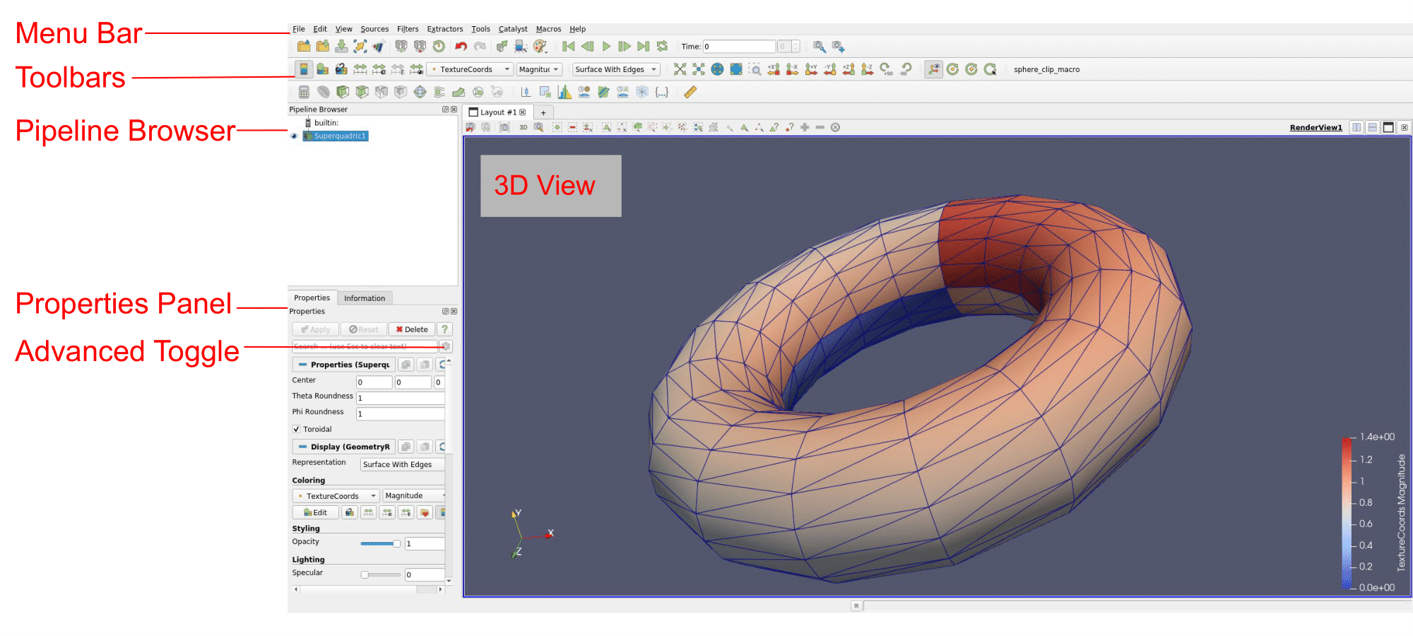

2.1. User Interface
../../_images/UserInterface.png
The ParaView GUI conforms to the platform on which it is running, but on all platforms it behaves basically the same. The layout shown here is the default layout given when ParaView is first started. The GUI comprises the following components.
Menu Bar
As with just about any other program, the menu bar allows you to access the majority of features.
Toolbars
The toolbars provide quick access to the most commonly used features within ParaView.
Pipeline Browser
ParaView manages the reading and filtering of data with a pipeline. The pipeline browser allows you to view the pipeline structure and select pipeline objects. The pipeline browser provides a convenient list of pipeline objects with an indentation style that shows the pipeline structure.
Properties Panel
The properties panel allows you to view and change the parameters of the current pipeline object. On the properties panel is an advanced properties toggle pqAdvanced that shows and hides advanced controls. The properties are by default coupled with an Information tab that shows a basic summary of the data produced by the pipeline object.
3D View
The remainder of the GUI is used to present data so that you may view, interact with, and explore your data. This area is initially populated with a 3D view that will provide a geometric representation of the data.
Note that the GUI layout is highly configurable, so that it is easy to change the look of the window. The toolbars can be moved around and even hidden from view. To toggle the use of a toolbar, use the View → Toolbars submenu. The pipeline browser and properties panel are both dockable windows. This means that these components can be moved around in the GUI, torn off as their own floating windows, or hidden altogether. These two windows are important to the operation of ParaView, so if you hide them and then need them again, you can get them back with the View menu.

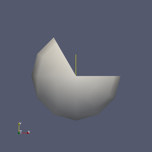

This exercise is a continuation of Exercise 2.1. You will need to finish that exercise before beginning this one.
You can manipulate the cylinder in the 3D view by dragging the mouse over the 3D view. Experiment with dragging different mouse buttons—left, middle, and right—to perform different rotate, pan, and zoom operations. Also try using the buttons in conjunction with the shift and ctrl modifier keys. Additionally you can hold down the x, y, or z key while you drag the mouse to constrain movement along the x, y, or z axis.

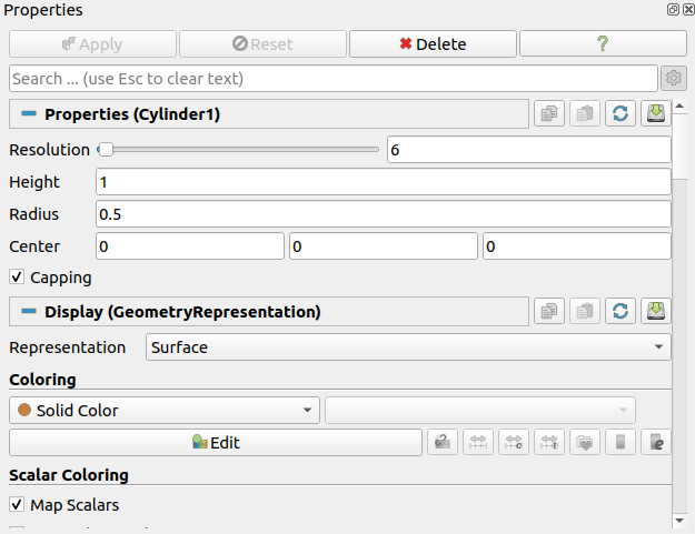

You surely noticed that ParaView creates not a real cylinder but rather an approximation of a cylinder using polygonal facets. The default parameters for the cylinder source provide a very coarse approximation of only six facets. (In fact, this object looks more like a prism than a cylinder.) If we want a better representation of a cylinder, we can create one by increasing the Resolution parameter. The Resolution parameters, like all other parameters for the cylinder object, are located in the properties panel under the Apply button when the cylinder object is selected in the pipeline browser.
../../_images/ResolutionParameter.png
Using either the slider or text edit, increase the resolution to 50 or more. Notice that the Apply button Apply become colored again. This is because changes you make to the object properties are not immediately enacted. The highlighted button is a reminder that the parameters of one or more pipeline objects are “out of sync” with the data that you are viewing. Hitting the Apply button will accept these changes whereas hitting the Reset button Reset will revert the options back to the last time they were applied. Hit the Apply button now. The resolution is changed so that it is virtually indistinguishable from a true cylinder.
If your work has you creating cylinder sources frequently and you find yourself modifying Resolution or other parameters to some value other than the default each time, you can save your preferred default parameters by hitting the save parameters button SaveAsDefaultButton. Once you hit the SaveAsDefaultButton button, ParaView will remember your preferences for objects of that type and use those parameters when you create future objects. Conversely, if you have changed the parameters and want to reset them to the “factory default,” you can click the restore parameters button pqReset. As we will see in future exercises, we can have multiple visualization objects open at once. To copy parameters from one object to another, use the copy pqCopy and paste pqPaste parameters buttons.

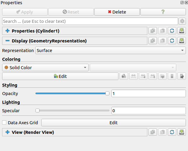

../../_images/DisplayProperties.png
If you scroll down the properties panel, you will notice a set of Display properties. Try these options now by clicking on the Edit pqEditColor button under Coloring to select a new color for the cylinder. (This button is also replicated in the toolbar.) You may notice that you do not need to hit Apply for display properties.

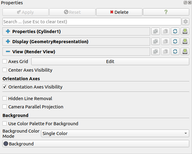

../../_images/RenderViewOptions.png
If you scroll down further yet to the bottom of the properties panel, you will notice a set of View properties. Use the view properties to turn on the Axes Grid.
By default many of the lesser used display properties are hidden. The advanced properties toggle pqAdvanced can be used to show or hide these extra parameters. There is also a search box at the top of the properties panel that can be used to quickly find a property. Try typing specular into this search box now. Under the display properties you should see an option named Specular. This controls the intensity of the specular highlight seen on shiny objects. Set this parameter to 1 to make the cylinder shiny.

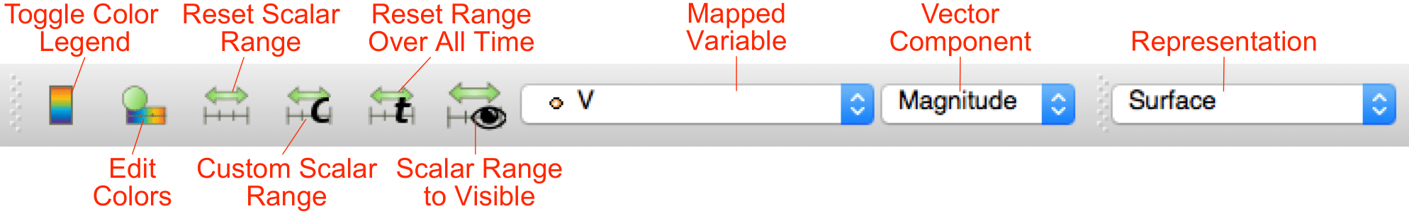

As you would expect, ParaView allows you to control the color of many elements. In many cases the changing the color of one element necessitates the changing of another. For example, if changing the background to a light color, it is important to change text on that background to a dark color. Otherwise the text will be unreadable. To help manage sets of interdependent colors, ParaView supports the idea of color palettes. You can easily change the view’s color palette using the load color palette button pqPalette in the toolbar.
Exercise 2.5 (Changing the Color Palette)
Make sure the orientation axes is shown in the lower left corner. This is toggled with the pqShowOrientationAxes button as described in Exercise 2.2. Note that the orientation axis has the labels “X,” “Y,” and “Z.”
Find the load color palette button pqPalette in the top toolbar. Click that button to get a pull down menu of available palettes. Experiment with different palettes. Observe that both the background color and the labels in the orientation axes change.

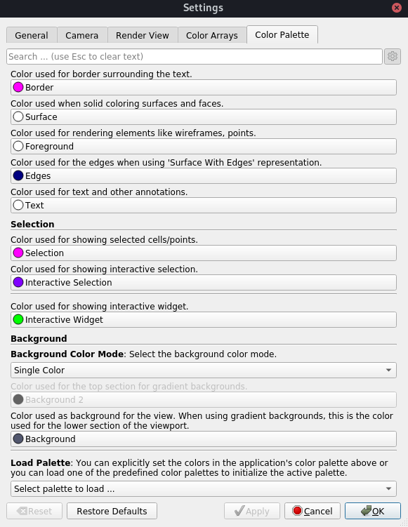

The colors used for the color palettes are part of ParaView’s settings. You can see and set all of these colors in the Edit → Settings (ParaView → Preferences on the Mac) under the Color Palette tab. You can also get to the color palette settings by clicking on the color palette button pqPalette and selecting the Edit Current Palette… button.
../../_images/SettingsColors.png

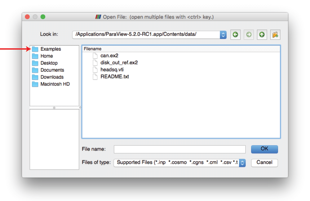

Let us open our first file now. Click the Open toolbar button (or menu item) pqOpen . Note that ParaView uses a custom file browser, which provides several convenience features. On the left side of the file browser dialog are a pair of boxes containing lists of directories, which provide quick access to files in common directories. The top left list contains a list of common data directories on your system. The bottom left list, which is initially empty, is filled with directories from which you have recently loaded files. Double click on the Examples directory listed in the top left box. This is a directory created by the ParaView installation that contains the files we use in this tutorial.
../../_images/ExamplesDirectory.png

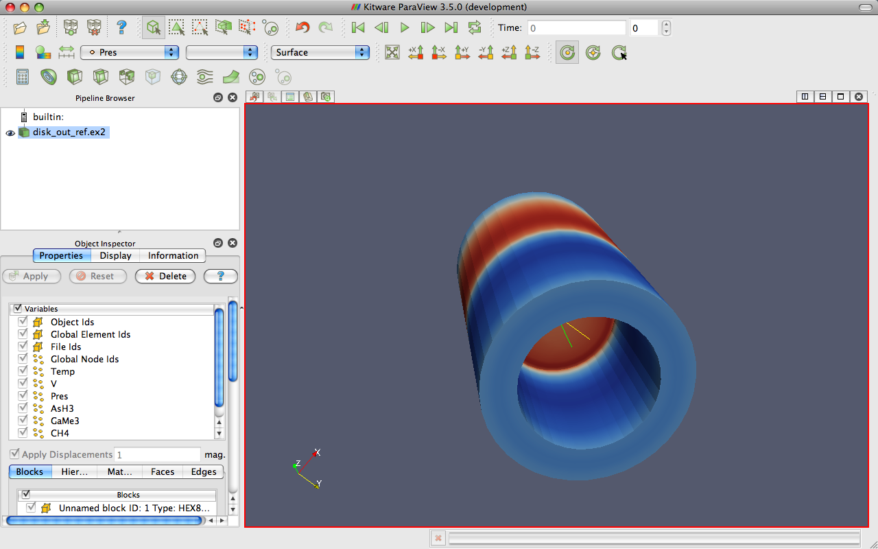

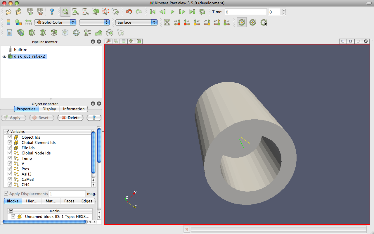

Open the file disk_out_ref.ex2. Note that opening a file is a two step process, so you do not see any data yet. Instead, you see that the properties panel is populated with several options about how we want to read the data.
../../_images/Block_properties_disk_out_ref.png
Click the checkbox in the header of the block arrays list to turn on the loading of all the block arrays. This is a small dataset, so we do not have to worry about loading too much into memory. Once all of the variables are selected, click Apply to load all of the data. When the data are loaded you will see that the geometry looks like a cylinder with a hollowed out portion in one end. These data are the output of a simulation for the flow of air around a heated and spinning disk. The mesh you are seeing is the air around the disk (with the cylinder shape being the boundary of the simulation). The hollow area in the middle is where the heated disk would be were it meshed for the simulation.

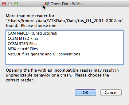

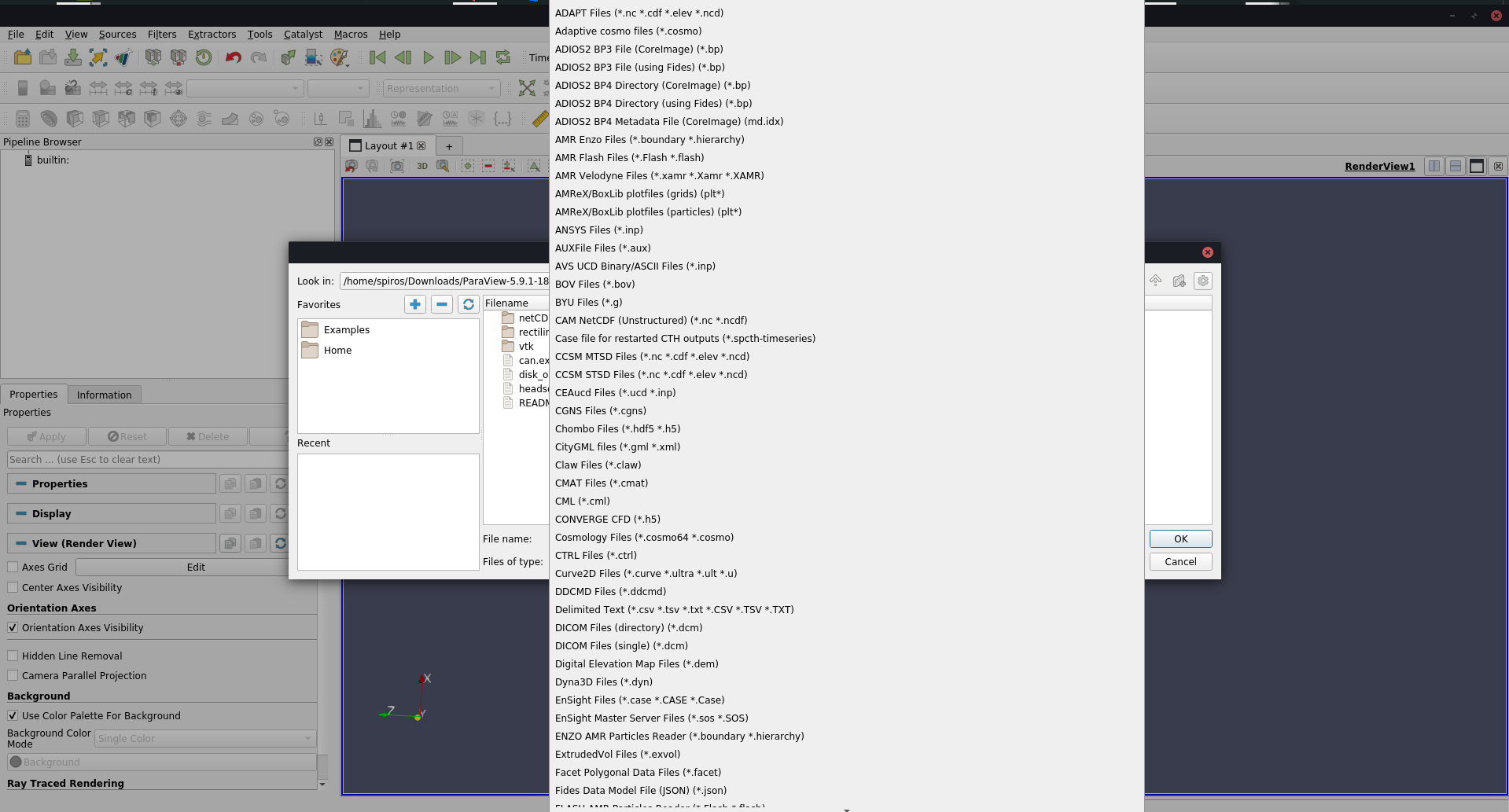

Most of the time ParaView will be able to determine the appropriate method to read your file based on the file extension and underlying data, as was the case in Exercise 2.7. However, with so many file formats supported by ParaView there are some files that cannot be fully determined. In this case, ParaView will present a dialog box asking what type of file is being loaded. The following image is an example from opening a netCDF file, which is a generic file format for which ParaView has many readers for different conventions.
../../_images/ChooseFileType.png

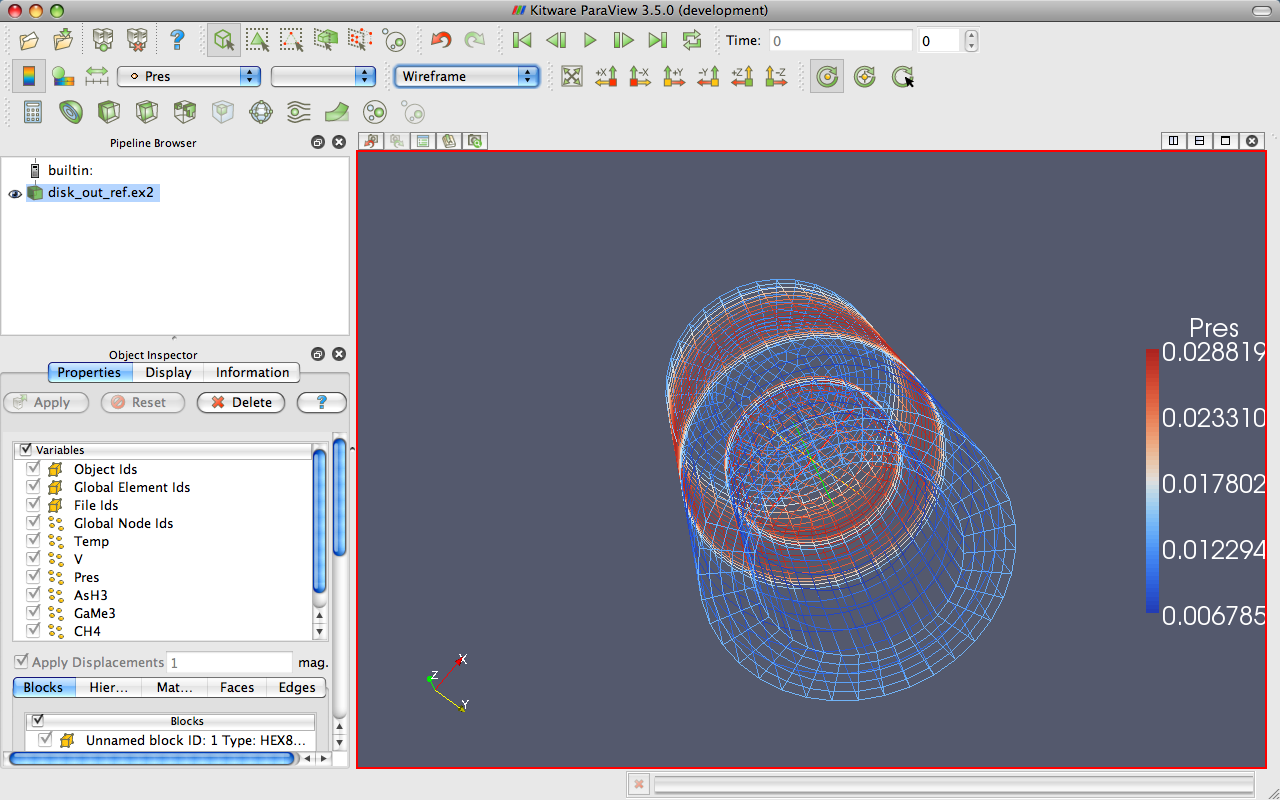

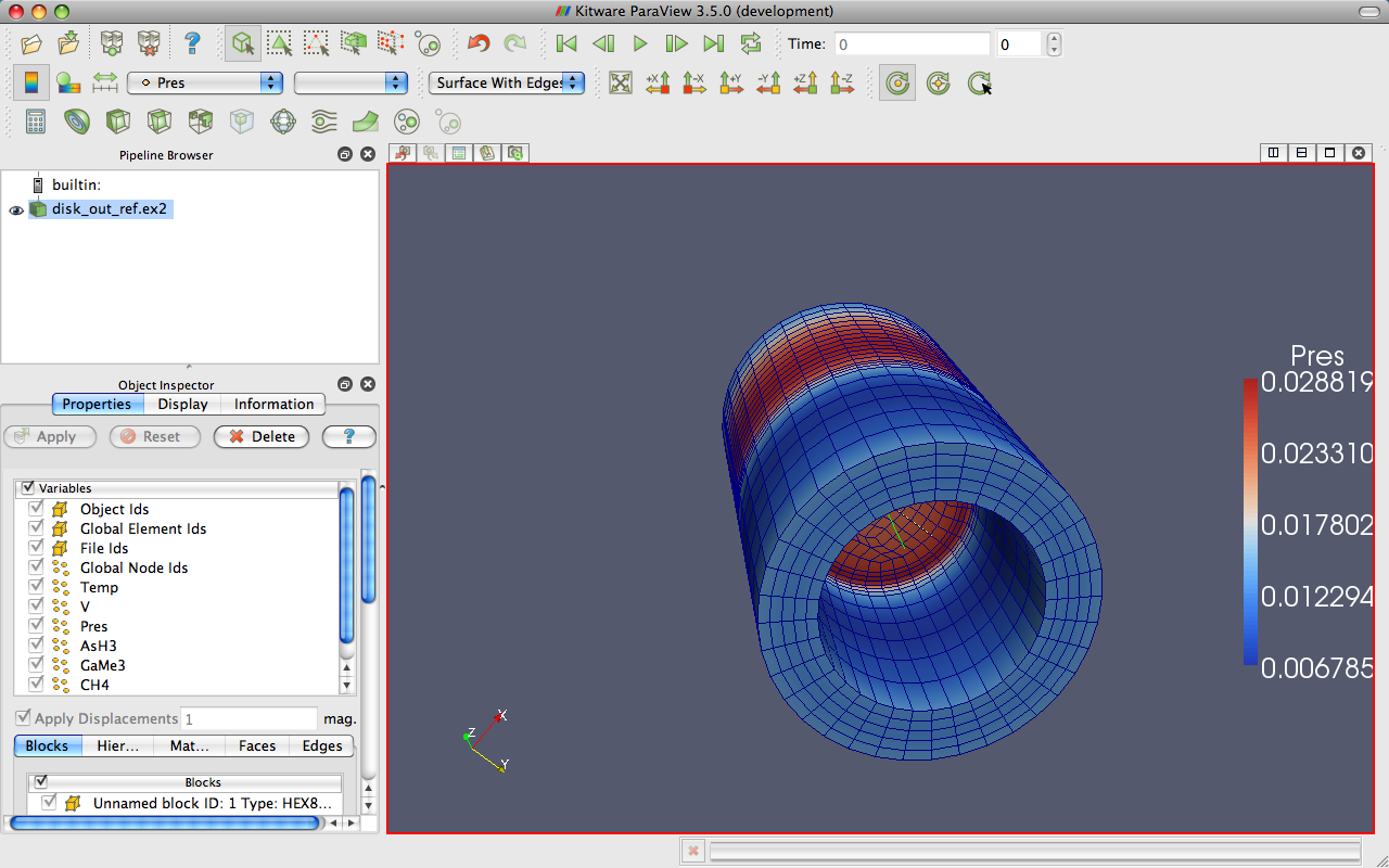

Exercise 2.8 (Representation and Field Coloring)
Play with the data representation a bit. Make sure disk_out_ref.ex2 is selected in the pipeline browser. (If you do not have the data loaded, repeat Exercise 2.7.) Use the variable chooser to color the surface by the pres variable. To see the structure of the mesh, change the representation to Surface With Edges. You can view both the cell structure and the interior of the mesh with the Wireframe representation.

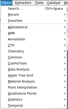

These eleven filters are a small sampling of what is available in ParaView. In the Filters menu are a great many more filters that you can use to process your data. ParaView currently exposes more than one hundred filters, so to make them easier to find the Filters menu is organized into submenus.
../../_images/FiltersMenu.png
These submenus are organized as follows.
Recent
The list of most recently used filters sorted with the most recently used filters on top.
Favorites
The list includes your favorites filters.
Alphabetical
An alphabetical listing of all the filters available. If you are not sure where to find a particular filter, this list is guaranteed to have it. There are also many filters that are not listed anywhere but in this list.
AMR
A set of filters designed specifically for data in an adaptive mesh refinement (AMR) structure.
Annotation
Filters that add annotation (such as text information) to the visualization.
CTH
Filters used to process results from a CTH simulation.
Chemistry
This contains filters for chemistry related datasets.
Common
The most common filters. This is the same list of filters available in the filters toolbar and listed previously.
CosmoTools
This contains filters developed at LANL for cosmology research.
Data Analysis
The filters designed to retrieve quantitative values from the data. These filters compute data on the mesh, extract elements from the mesh, or plot data.
Hyper Tree Grid
This contains filters for hyper-tree grid datasets.
Material Analysis
Filters for processing data from volume fractions of materials.
Point Interpolation
Filters that take an unstructured collection of points in space without cells connecting them and estimate the field interpolation between them.
Quadrature Points
Filters to support simulation data given as integration points that can be used for numerical integration with Gaussian quadrature.
Statistics
This contains filters that provide descriptive statistics of data, primarily in tabular form.
Temporal
Filters that analyze or modify data that changes over time. All filters can work on data that changes over time because they are executed on each time snapshot. However, filters in this category will retrieve the available time extents and examine how data changes over time.

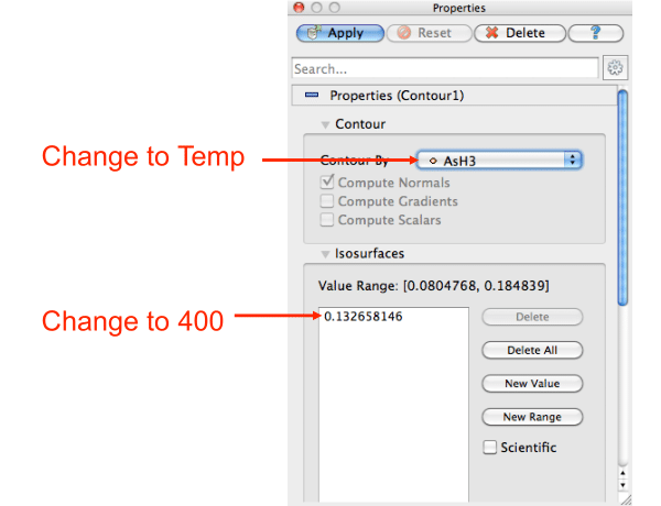

We will use the contour filter to create an isosurface where the temperature is equal to 400 K. First, change the Contour By parameter to the temp variable. Then, change the isosurface value to 400. Finally, hit Apply. You will see the isosurface appear inside of the volume. If disk_out_ref.ex2 was still colored by pressure from Exercise 2.8, then the surface is colored by pressure to match.

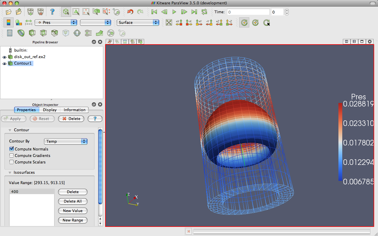

../../_images/ContourResults.png
In the preceding exercise, we applied a filter that processed the data and gave us the results we needed. For most common operations, a single filter operation is sufficient to get the information we need. However, filters are of the same class as readers. That is, the general operations we apply to readers can also be applied to filters. Thus, you can apply one filter to the data that is generated by another filter. These readers and filters connected together form what we call a visualization pipeline. The ability to form visualization pipelines provides a powerful mechanism for customizing the visualization to your needs.

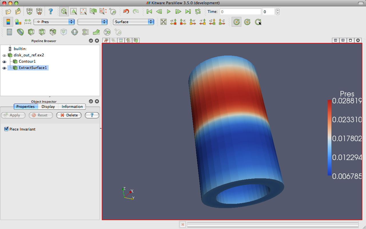

../../_images/CutSurface1.png
When you apply the Extract Surface filter, you will once again see the surface of the mesh. Although it looks like the original mesh, it is different in that this mesh is hollow whereas the original mesh was solid throughout.
If you were showing the results of the contour filter, you cannot see the contour anymore, but do not worry. It is still in there hidden by the surface. If you are showing the contour but you did not see any effect after applying the filter, you may have forgotten step one and applied the filter to the wrong object. If the ExtractSurface1 object is not connected directly to the disk_out_ref.ex2, then this is what went wrong. If so, you can delete the filter and try again.

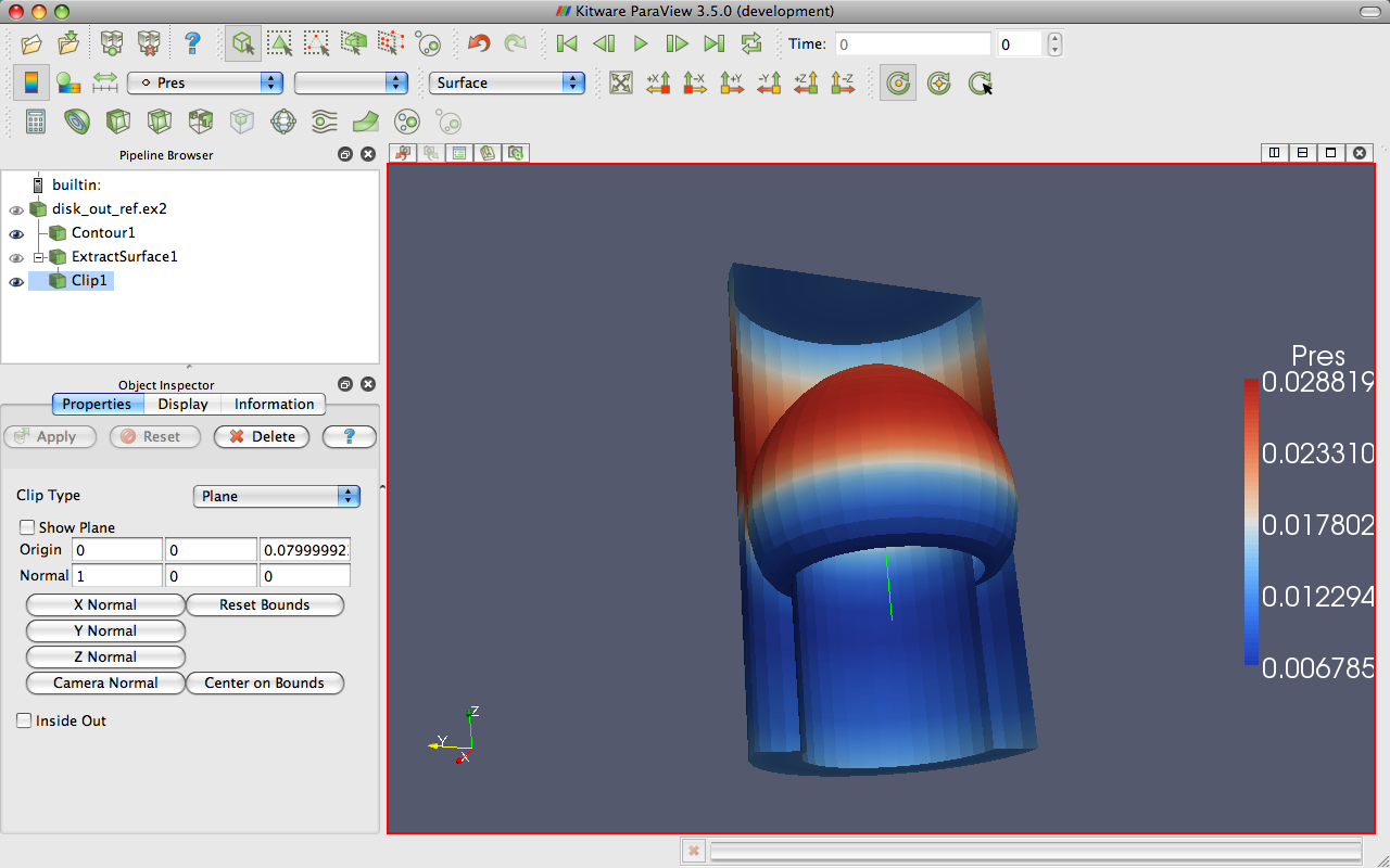

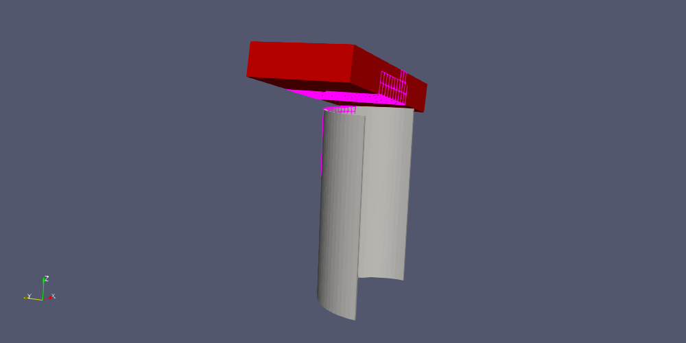

Now we will cut away the external surface to expose the internal structure and isosurface underneath (if you have one).
  1. Verify that ExtractSurface1 is selected in the pipeline browser.
  2. Create a clip filter pqClip from the toolbar or Filters menu.
  3. Uncheck the Show Plane checkbox ShowPlaneCheckbox in the properties panel.
  4. Click the Apply button.
../../_images/CutSurface2.png
If you have a contour, you should now see the isosurface contour within a cutaway of the mesh surface. You will probably have to rotate the mesh to see the contour clearly.

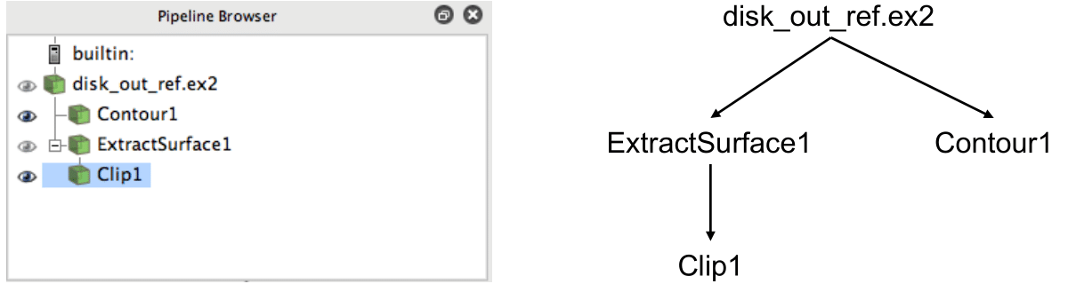

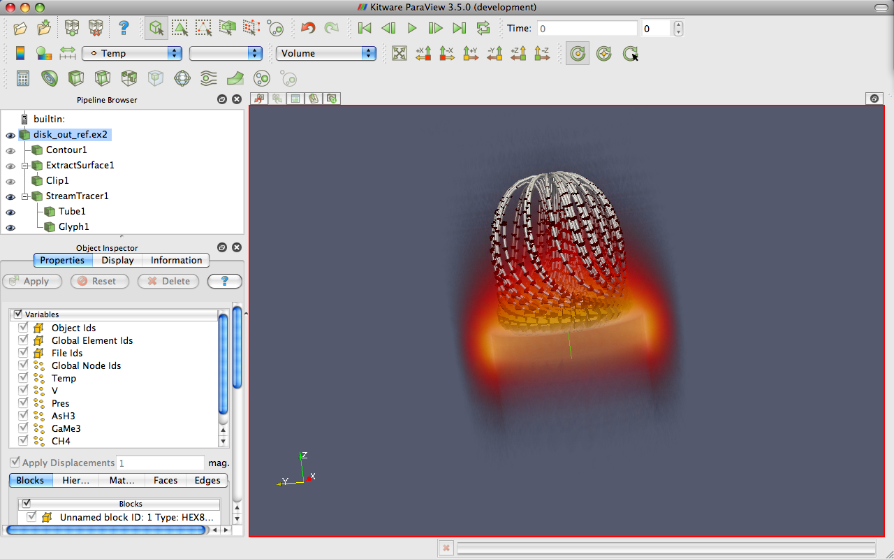

../../_images/PipelineBrowserStructure.png
Now that we have added several filters to our pipeline, let us take a look at the layout of these filters in the pipeline browser. The pipeline browser provides a convenient list of pipeline objects that we have created. This makes it easy to select pipeline objects and change their visibility by clicking on the eyeball icons pqEyeball next to them. But also notice the indentation of the entries in the list and the connecting lines toward the left. These features reveal the connectivity of the pipeline. It shows the same information as the traditional graph layout on the right, but in a much more compact space. The trouble with the traditional layout of pipeline objects is that it takes a lot of space, and even moderately sized pipelines require a significant portion of the GUI to see fully. The pipeline browser, however, is complete and compact.

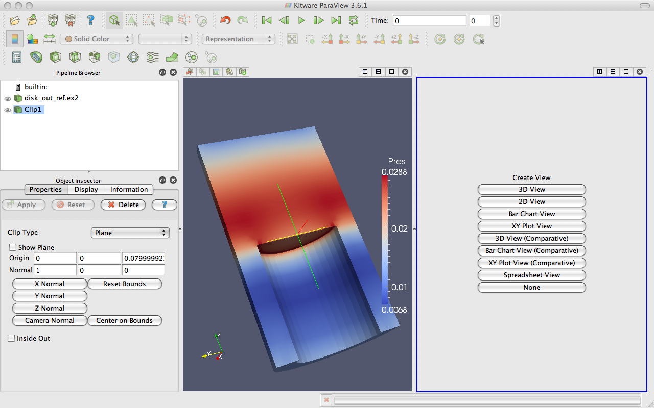

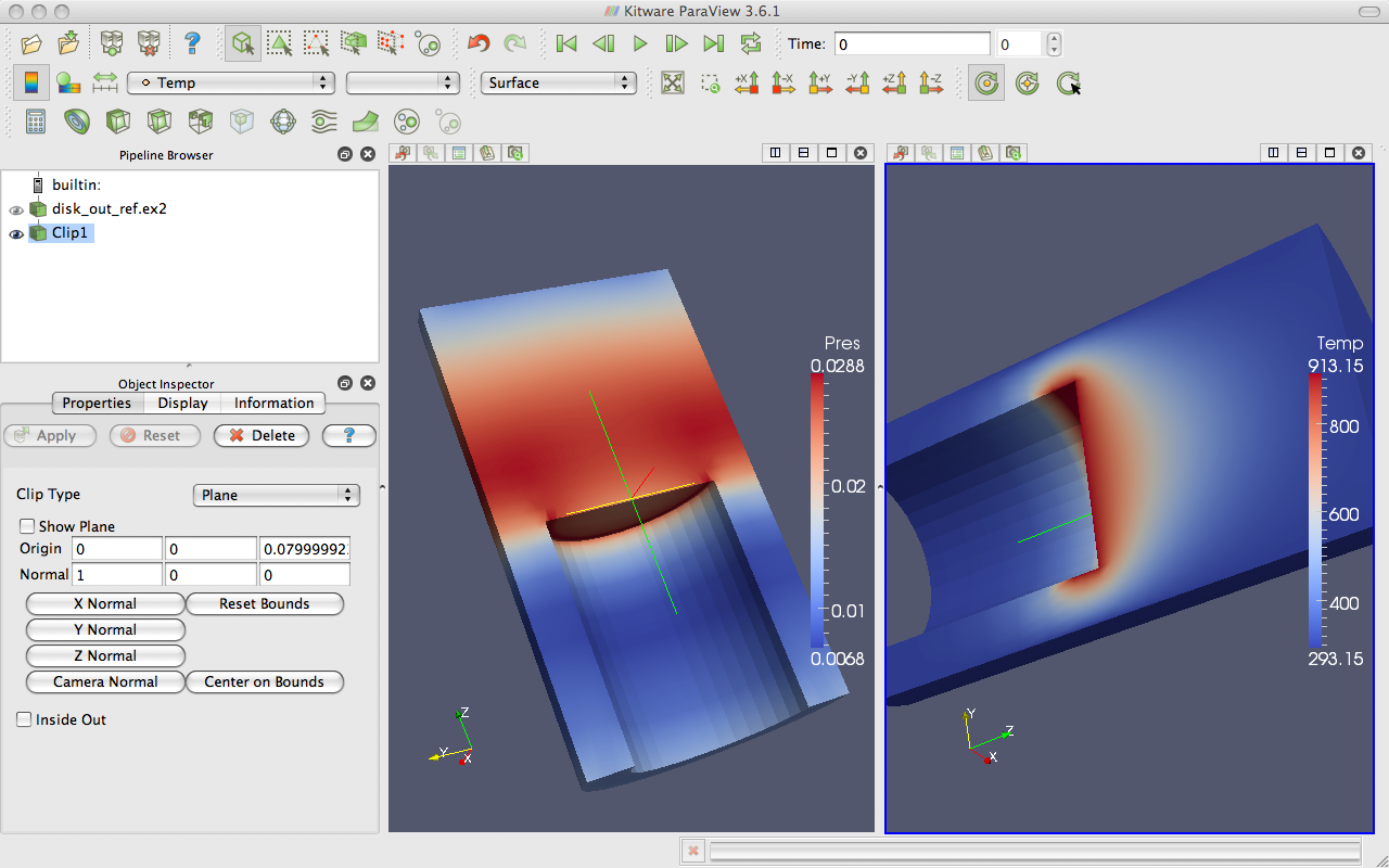

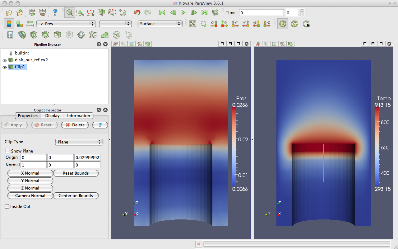

2.7. Multiview

First, we will look at one variable. We need to see the variable through the middle of the mesh, so we are going to clip the mesh in half.
  1. Open the file disk_out_ref.ex2, load all variables, Apply (see Exercise 2.7).
  2. Add the Clip filter pqClip to disk_out_ref.ex2.
  5. Color the surface by pressure by changing the variable chooser (in the toolbar) from vtkBlockColors to pres.
Now we can see the pressure in a plane through the middle of the mesh. We want to compare that to the temperature on the same plane. To do that, we create a new view to build another visualization.
  1. Press the pqSplitHorizontal button.
../../_images/SplitView1.png
The current view is split in half and the right side is blank, ready to be filled with a new visualization. Notice that the view in the right has a blue border around it. This means that it is the active view. Widgets that give information about and controls for a single view, including the pipeline browser and properties panel, follow the active view. In this new view we will visualize the temperature of the mesh.
  1. Make sure the blue border is still around the new, blank view (to the right). You can make any view the active view by simply clicking on it.
  2. Turn on the visibility of the clipped data by clicking the eyeball pqEyeballClosed next to Clip1 in the pipeline browser.
  3. Color the surface by temperature by selecting Clip1 in the pipeline browser and changing the variable chooser (in the toolbar) from Solid Color to temp.
../../_images/SplitView2.png
We now have two views: one showing information about pressure and the other information about temperature. We would like to compare these, but it is difficult to do because the orientations are different. How are we to know how a location in one correlates to a location in the other? We can solve this problem by adding a camera link so that the two views will always be drawn from the same viewpoint. Linking cameras is easy.

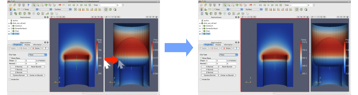

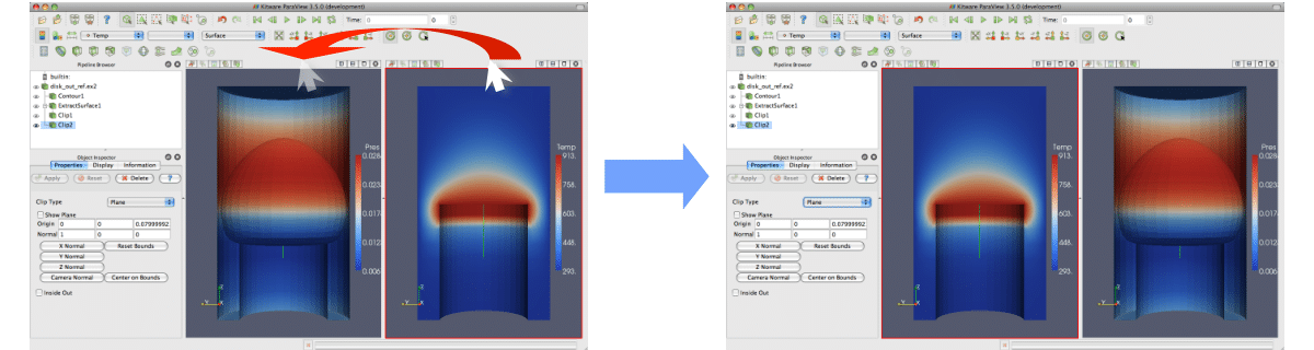

The location of each view is also not fixed. You are also able to swap two views by clicking on one of the view toolbars (somewhere outside of where the buttons are), holding down the mouse button, and dragging onto one of the other view toolbars. This will immediately swap the two views.
../../_images/SwapViews.png
You can also change the size of the views by clicking on the space in between views, holding down the mouse button, and dragging in the direction of either one of the views. The divider will follow the mouse and adjust the size of the views as it moves.

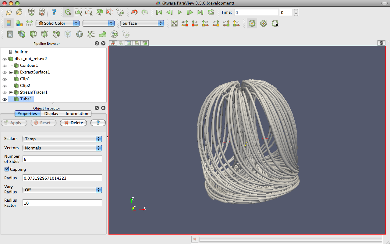

Now we can get a little fancier. We can add glyphs to the streamlines to show the orientation and magnitude.
  1. Select StreamTracer1 in the pipeline browser.
  2. Add the glyph filter pqGlyph to StreamTracer1.
  3. In the properties panel, change the Glyph Type option to Cone.
  4. In the properties panel, change the Orientation Array to v.
  5. In the properties panel, change the Scale Array to v.
  6. Click the reset pqReset button to the right of Scale Factor.
  7. Hit the Apply button.
  8. Color the glyphs with the temp variable.
../../_images/StreamTracer1.png
Now the streamlines are augmented with little pointers. The pointers face in the direction of the velocity, and their size is proportional to the magnitude of the velocity. Try using this new information to answer the following questions.

ParaView’s plotting capabilities provide a mechanism to drill down into your data to allow quantitative analysis. Plots are usually created with filters, and all of the plotting filters can be found in the Data Analysis submenu of Filters. There is also a data analysis toolbar containing the most common data analysis filters, some of which are used to generate plots.
pqQuartiles Compute Quartiles
Computes the quartiles for each field in the dataset and then shows a box chart depicting the quartiles.
pqExtractSelection Extract Selection
Extracts any data selected into its own object. Selections are described in Section 2.14.
pqHistogram Histogram
Allows you to generate the histogram of a data array from a dataset.

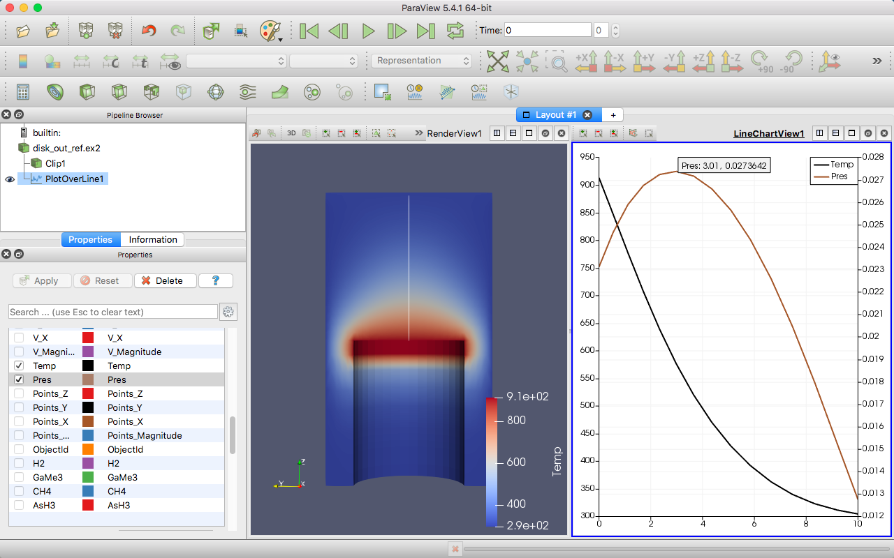

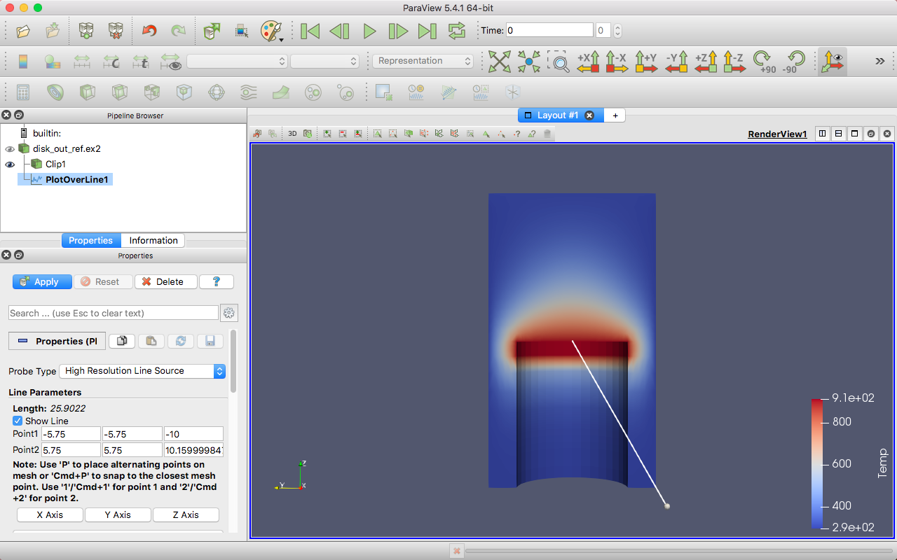

Exercise 2.14 (Plot Over a Line in Space)
We are going to start a fresh visualization, so if you have been following along with the exercises so far, now is a good time to reset ParaView. The easiest way to do this is to select pqResetSession from the toolbar.
  2. Add the Clip filter pqClip to disk_out_ref.ex2, Uncheck the Show Plane ShowPlaneCheckbox and the Invert checkboxes in the properties panel, and click (like in Exercise 2.11). This will make it easier to see and manipulate the line we are plotting over.
  3. Click on disk_out_ref.ex2 in the pipeline browser to make that the active object.

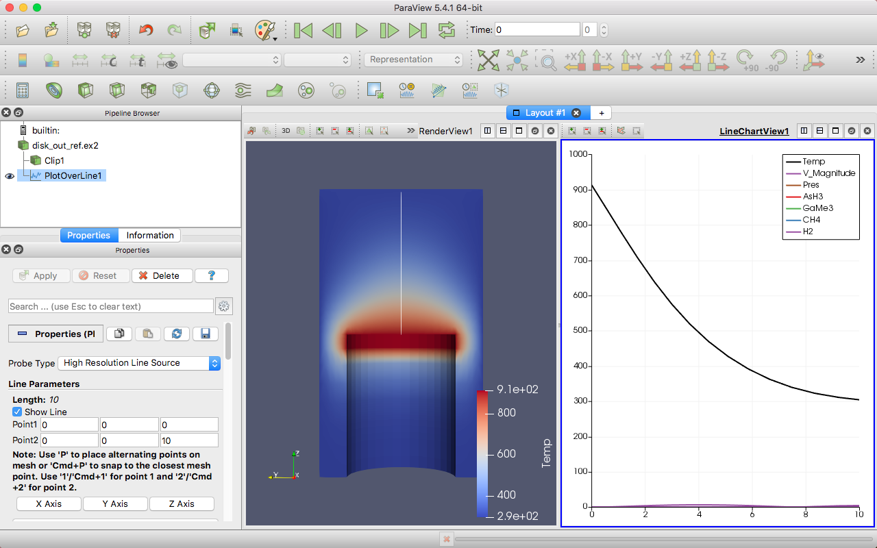

  4. From the toolbars, select the plot over line pqPlotOverLine filter.
../../_images/LinePlot1.png
In the active view you will see a line through your data with a ball at each end. If you move your mouse over either of these balls, you can drag the balls through the 3D view to place them. If you hold down the x, y, or z key while you drag one of these balls, the movement will be constrained to that axis. Notice that each time you move the balls some of the fields in the properties panel also change. You can also place the balls by hovering your mouse over the target location and hitting the 1, 2, or p key. The 1 key will place the first ball at the surface underneath the mouse cursor. The 2 key will likewise place the second ball. The p key will alternate between placing the first and second balls. If you hold down the Ctrl modifier while hitting any of these keys, then the ball will be placed at the nearest point of the underlying mesh rather than directly under the mouse. This was the purpose of adding the clip filter: It allows us to easily add the endpoints to this plane. Note that placing the endpoints in this manner only works when rendering solid surfaces. It will not work with a volume rendered image or transparent surfaces.
This representation is called a 3D widget because it is a GUI component that is manipulated in 3D space. There are many examples of 3D widgets in ParaView. This particular widget, the line widget, allows you to specify a line segment in space. Other widgets allow you to specify points or planes.
  1. Adjust the line so that it goes from the base of the disk straight up to the top of the mesh using the 3D widget manipulators, the p key shortcut, or the properties panel parameters. The plot works best with Point 1 around \((0,0,0)\) and Point 2 around \((0,0,10)\).
  2. Once you have your line satisfactorily located, click the button.
../../_images/LinePlot2.png
There are several interactions you can do with the plot. Roll the mouse wheel up and down to zoom in and out. Drag with the middle button to do a rubber band zoom. Drag with the left button to scroll the plot around. You can also use the reset camera command pqResetCamera to restore the view to the full domain and range of the plot.
Plots, like 3D renderings, are considered views. Both provide a representation for your data; they just do it in different ways. Because plots are views, you interact with them in much the same ways as with a 3D view. If you look in the Display section of the properties panel, you will see many options on the representation for each line of the plot including colors, line styles, vector components, and legend names.
../../_images/PlotDisplayTab.png

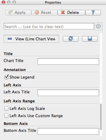

If you scroll down further to the View section of the properties panel, you to change plot-wide options such as labels, legends, and axes ranges.
../../_images/PlotViewOptions.png

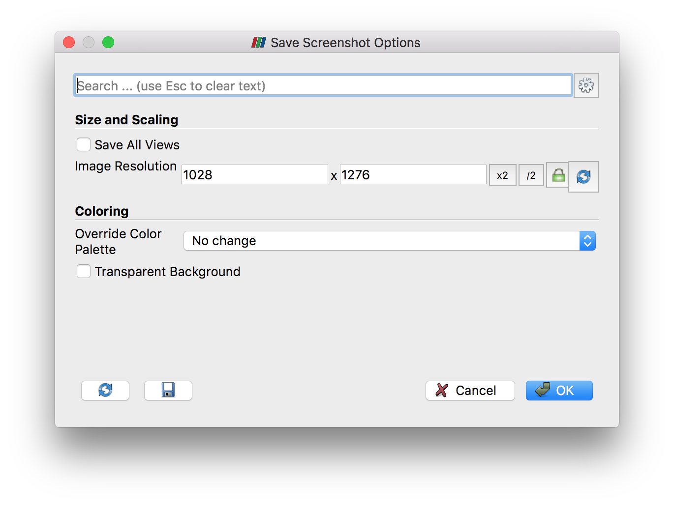

Like any other views, you can capture the plot with the File → pqCaptureScreenshot Save Screenshot. Additionally, if you choose File → Export Scene… you can export a file with vector graphics that will scale properly for paper-quality images. We will discuss these image capture features later in Section 2.13. You can also resize and swap plots in the GUI like you can other views.

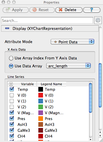

Exercise 2.15 (Plot Series Display Options)
This exercise is a continuation of Exercise 2.14. You will need to finish that exercise before beginning this one.
  1. Choose a place in your GUI that you would like the plot to go and try using the split, delete, resize, and swap view features to move it there.
  2. Make the plot view active, go to the Display section of the properties panel, and turn off all variables except temp and pres.
The temp and pres variables have different units. Putting them on the same scale is not useful. We can still compare them in the same plot by placing each variable on its own scale. The line plot in ParaView allows for a different scale on the left and right axis, and you can scale each variable individually on each axis.
  1. Select the pres variable in the Display options.
  2. Change the Chart Axis to Bottom - Right
../../_images/LinePlot3.png
From this plot we can verify some of the observations we made in Section 2.7. We can see that the temperature is maximal at the plate surface and falls as we move away from the plate, but the pressure goes up and then back down. In addition, we can observe that the maximal pressure (and hence the location where the forces on the air are equalized) is about 3 units away from the disk.

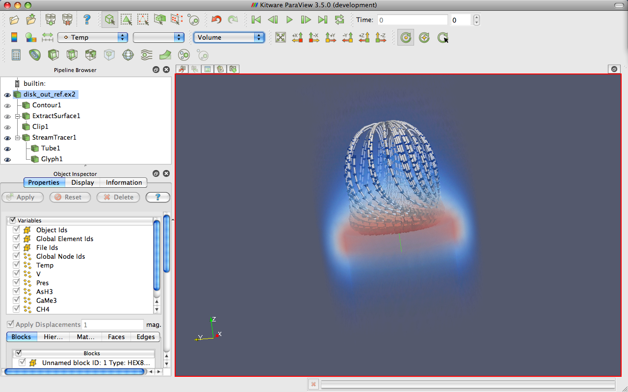

Exercise 2.17 (Combining Volume Rendering and Surface-Based Visualization)
This exercise is a continuation of Exercise 2.16. You will need to finish that exercise before beginning this one.
  1. Add the stream tracer filter pqStreamTracer to disk_out_ref.ex2.
  2. Change the Seed Type parameter in the properties panel to Point Cloud.
  3. Uncheck the Show Sphere checkbox ShowSphereCheckbox in the properties panel under the seed type.
  4. Click the Apply button to accept these parameters.
You should now be seeing the streamlines embedded within the volume rendering. The following additional steps add geometry to make the streamlines easier to see much like in Exercise 2.13. They are optional, so you can skip them if you wish.
  1. Use the quick launch (ctrl+space Win/Linux, alt+space Mac) to apply the Tube filter and hit Apply.
  2. If the streamlines are colored by temp, change that to Solid Color.
  3. Select StreamTracer1 in the pipeline browser.
  4. Add the glyph filter pqGlyph to StreamTracer1.
  5. In the properties panel, change the Glyph Type option to Cone.
  6. In the properties panel, change the Orientation Array to v.
  7. In the properties panel, change the Scale Array to v.
  8. Click the reset pqReset button to the right of Scale Factor.
  9. Hit the Apply button.
  10. Color the glyphs with the temp variable.
../../_images/VolumeRender2.png
The streamlines are now shown in context with the temperature throughout the volume.

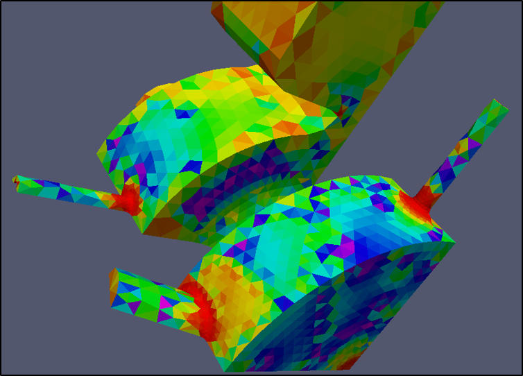

Rainbow colors are certainly a popular choice. However, we recommend that you never use rainbow color maps in your visualizations.
The problem with rainbow colors is that they have numerous perceptual properties that serve to obfuscate the data. Although we will not go into detail into the many perceptual studies that provide evidence that rainbow colors are bad for data display, we provide a brief synopsis of the problems.
The first problem is that the colors do not follow any natural perceived ordering. Some color groups lead to a natural perception of order (with relative brightness being the strongest perceptual cue). The hues of the rainbow, however, have no real ordered meaning in our visual system. Rather, we have to learn an ordering, which can lead to visual confusion. Consider the following two example images. In the left image, the rainbow hues make it difficult to ascertain the relative high and low values that are more clear in the right image.
ColorOrderExample1
ColorOrderExample2
The second problem with the perception of rainbow colors is that the perceptual changes in the colors are not uniform. The colors appear to change faster in the cyan and yellow regions, which can introduce artifacts in those regions that do not exist in the data. The colors appear to change more slowly in the blue, green, and red regions, which creates larger bands of color that hide artifacts in the data. We can see this effect in the following two images of a spatial contrast sensitivity function. The grayscale on the right faithfully reproduces the function. However, the rainbow colors on the left hides the variation in low contrast regions and appears less smooth in the high-contrast regions.
SpatialContrast1
SpatialContrast2
A third problem with the rainbow color map is that it is sensitive to deficiencies in vision. Roughly 5% of the population cannot distinguish between the red and green colors. Viewers with color deficiencies cannot distinguish many colors considered “far apart” in the rainbow color map.
We provide this description of the problems with rainbow colors in the hopes that you do not use these color maps. Despite the well know problems with rainbow colors, they remain a popular choice. Relying on rainbow hues obfuscates data, which circumvents the entire process of data analysis that ParaView provides. Multiple perceptual studies have shown that subjects overestimate the effectiveness of rainbow colors. That is, people think they do better with rainbow colors when in fact they do worse. Don’t fall into this trap.

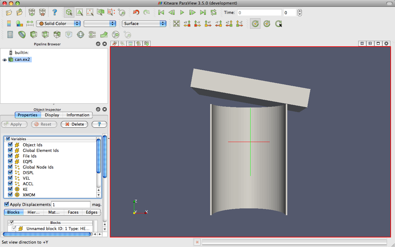

Exercise 2.19 (Loading Temporal Data)

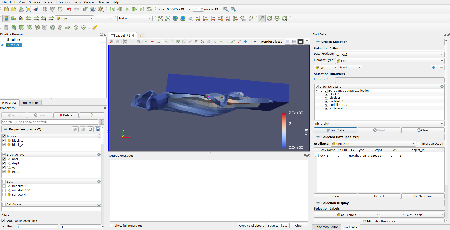

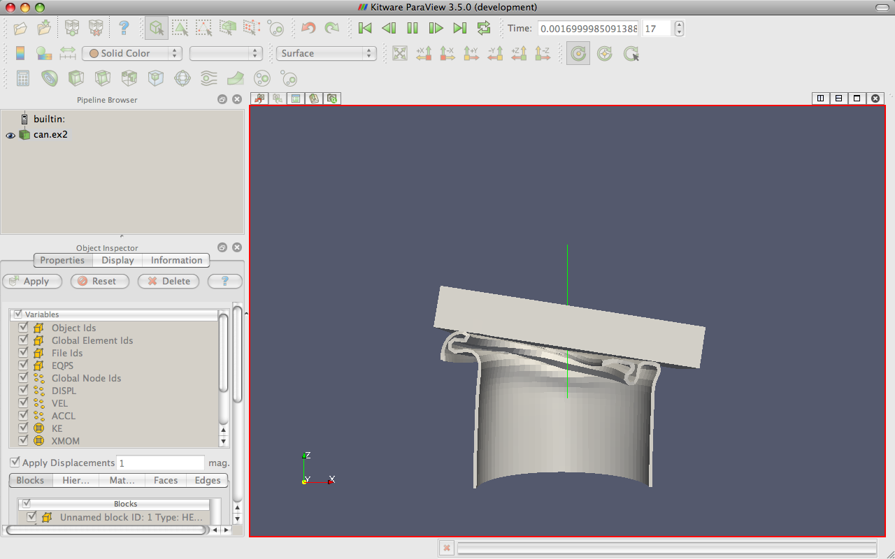

  1. Open the file can.ex2.
    ../../_images/Block_properties_can.png
  2. As before, click the checkbox in the header of the block arrays list to turn on the loading of all the block arrays and hit the Apply button.
  3. Press the pqYPlus button to orient the camera to the mesh.

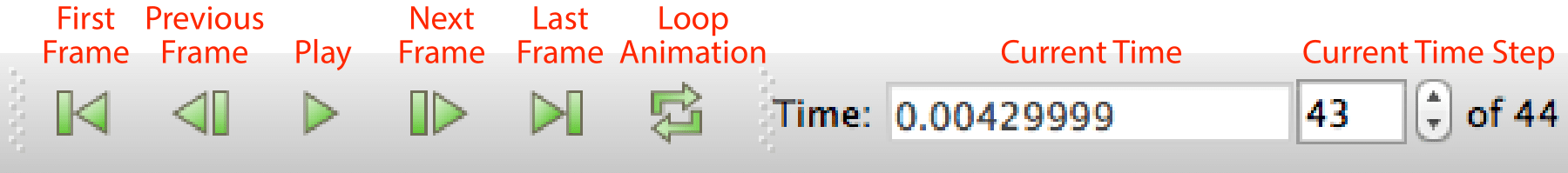

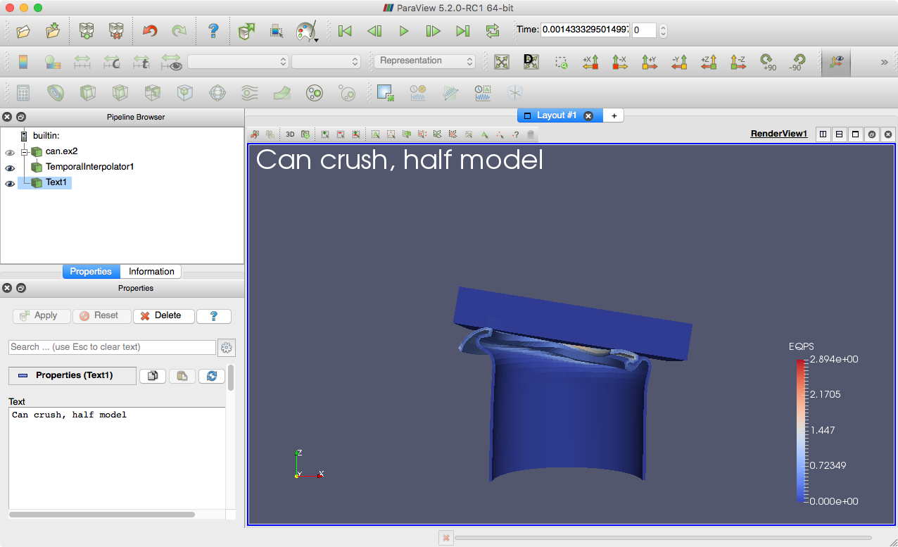

  4. Press the play button pqVcrPlay in the toolbars and watch ParaView animate the mesh to crush the can with the falling brick.
AnimateCan1
AnimateCan2
AnimateCan3
That is really all there is to dealing with data that is defined over time. ParaView has an internal concept of time and automatically links in the time defined by your data. Become familiar with the toolbars that can be used to control time.
../../_images/AnimationToolbar.png
Saving an animation is equally as easy. From the menu, select File → Save Animation. ParaView provides dialogs specifying how you want to save the animation, and then automatically iterates and saves the animation.

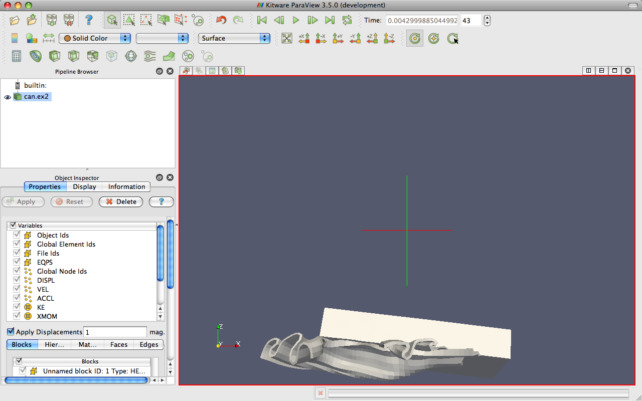

Exercise 2.20 (Temporal Data Pitfall)
The biggest pitfall users run into is that with mapping a set of colors whose range changes over time. To demonstrate this, do the following.
  1. If you are not continuing from Exercise 2.19, open the file can.ex2, load all variables, Apply.
  2. Go to the first time step pqVcrFirst.

  4. Play pqVcrPlay through the animation (or skip to the last time step pqVcrLast).
The coloring is not very useful. To quickly fix the problem:
  1. While at the last time step, click the Rescale to Data Range pqResetRange button.
  2. Play pqVcrPlay the animation again.
The colors are more useful now.

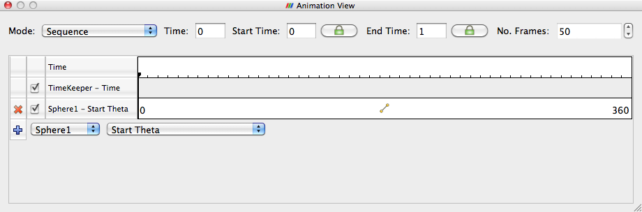

ParaView has many powerful options for controlling time and animation. The majority of these are accessed through the animation view. From the menu, click on View → Animation View.
Notice
This part mention the animation view. This was replaced by the Time Manager. While the interface are quite similar, some differences may exist. Please see the ParaView User’s Guide ‘Animation’ section for more.

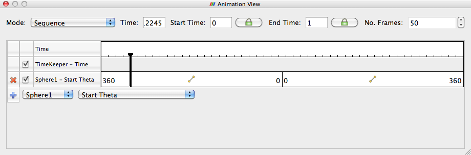

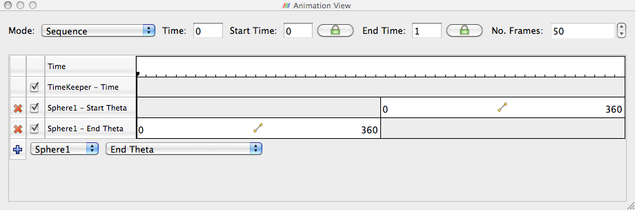

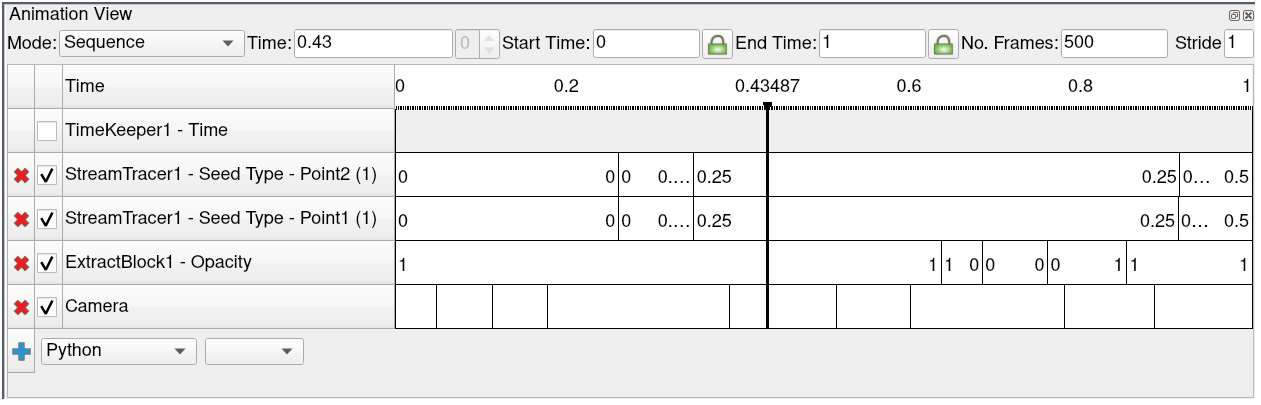

../../_images/AnimationView.png
For now we will examine the controls at the top of the animation view. (We will examine the use of the tracks in the rest of the animation view later in Section 2.15.) The animation mode parameter determines how ParaView will step through time during playback. There are three modes available.
Sequence
Given a start and end time, break the animation into a specified number of frames spaced equally apart.
Real Time
ParaView will play back the animation such that it lasts the specified number of seconds. The actual number of frames created depends on the update time between frames.
Snap To TimeSteps
ParaView will play back exactly those time steps that are defined by your data.
Whenever you load a file that contains time, ParaView will automatically change the animation mode to Snap To TimeSteps. Thus, by default you can load in your data, hit play pqVcrPlay, and see each time step as defined in your data. This is by far the most common use case.
A counter use case can occur when a simulation writes data at variable time intervals. Perhaps you would like the animation to play back relative to the simulation time rather than the time index. No problem. We can switch to one of the other two animation modes. Another use case is the desire to change the playback rate. Perhaps you would like to speed up or slow down the animation. The other two animation modes allow us to do that.

  1. Open the file can.ex2, load all variables, Apply (see Exercise 2.19).
  2. Press the pqYPlus button to orient the camera to the mesh.
  3. Press the play button pqVcrPlay in the toolbars.

2.12. Text Annotation
When using ParaView as a communication tool it is often helpful to annotate the images you create with text. With ParaView it is very easy to create text annotation wherever you want in a 3D view. There is a special text source that simply places some text in the view.
Exercise 2.23 (: Adding Text Annotation)
If you are continuing this exercise after finishing Exercise 2.22,
feel free to simply continue. If you have had to restart ParaView since or your state does not match up well enough, it is also fine to start with a fresh state using pqResetSession.
  1. Use the quick launch (ctrl+space Win/Linux, alt+space Mac) to create the Text source (or from the menu bar Sources → Annotation → Text) and hit Apply.
  2. In the text edit box of the properties panel, type a message.
  3. Hit the Apply button.
../../_images/TextSource2.png

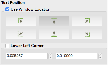

The text you entered appears in the 3D view. If you scroll down to the Display options in the properties panel, you will see six buttons that allow you to quickly place the text in each of the four corners of the view as well as centered at the top and bottom.
../../_images/TextPosition.png
You can place this text at an arbitrary position by clicking the Lower Left Corner checkbox. With the Lower Left Corner option checked, you can use the mouse to drag the text to any position within the view.
Often times you will need to put the current time value into the text annotation. Typing the correct time value can be tedious and error prone with the standard text source and impossible when making an animation. Therefore, there is a special annotate time source that will insert the current animation time into the string.

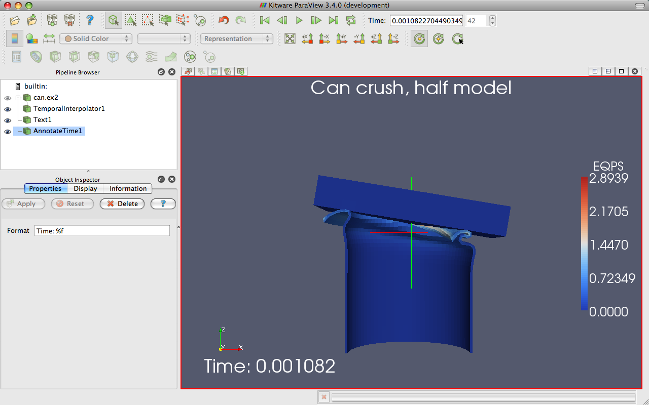

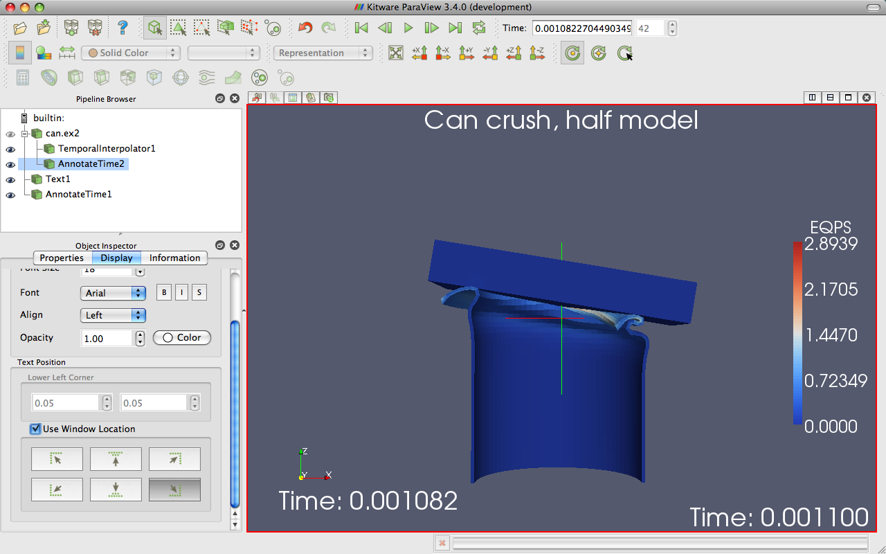

Exercise 2.24 (Adding Time Annotation)
  1. If you do not already have it loaded from a previous exercise, open the file can.ex2, Apply.
  2. Add an Annotate Time source (Sources → Annotate → Annotate Time or use the quick launch: ctrl+space Win/Linux, alt+space Mac). Apply.
  3. Move the annotation around as necessary.
  4. Play pqVcrPlay and observe how the time annotation changes.
../../_images/AnnotateTimeSource.png
There are instances when the current animation time is not the same as the time step read from a data file. Often it is important to know what the time stored in the data file is, and there is a special version of annotate time that acts as a filter.
  1. Select can.ex2 in the pipeline browser.
  2. Use the quick launch (ctrl+space Win/Linux, alt+space Mac) to apply the Annotate Time Filter.
  3. Apply.
  4. Move the annotation around as necessary.
  5. Check the animation mode in the Animation View. If it is set to Snap to TimeSteps, change it to Real Time.
  6. Play pqVcrPlay and observe how the time annotation changes.
../../_images/AnnotateTimeFilter.png

  4. Select File → Save Screenshot pqCaptureScreenshot.
This brings us to the file selection screen. If you pull down the menu Files of type: at the bottom of the dialog box, you will see several file types supported including portable network graphics (PNG), and joint photographic experts group (JPEG).
Select a File name for your file, and place it somewhere you can later find and delete. We usually recommend saving images as PNG files. The lossy compression of JPEG often creates noticeable artifacts in the images generated by ParaView, and the compression of PNG is better than most other raster formats.

After you select a file, you will be presented with a dialog box for more screenshot options.
../../_images/SaveScreenshot1.png
The Save Screenshot Options dialog box includes numerous important controls.
At the top of the dialog box are Size and Scaling options. The Image Resolution options allow you to create an image that is larger (or smaller) than the current size of the 3D view. You can directly enter a resolution or use the x2 and /2 buttons to double or halve the resolution. The pqLock button toggles locking the aspect ratio when selecting an image resolution. The pqReset button restores the resolution to that of the view in the GUI. If you have multiple views open, there is also a Save All Views checkbox that toggles between saving only the active view and saving all views in one image.
The Coloring controls modify how some elements, such as the background, get colored. The Override Color Palette pulldown menu allows a user to use the default color scheme, one with a white color motif for printing, or other defined palettes. These are the same palettes described in Exercise [ex:ChangingTheColorPalette] on page . There is also a Transparent Background checkbox that adds an alpha channel to the written image (in formats that support it).
There are also many advanced options that, as always are accessible via the pqAdvanced button or the search bar.
  1. Press the OK button.

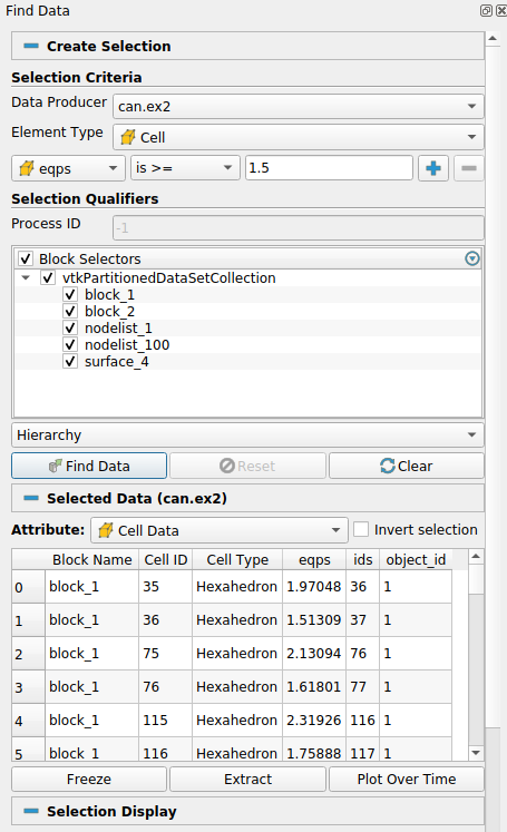

The most direct means to create a selection is via the Find Data pqFindData panel. Launch this dialog from the toolbar or the Edit menu. From this dialog you can enter characteristics of the data that you are searching for. For example, you could look for points whose velocity magnitude is near terminal velocity. Or you could look for cells whose strain exceeds the failure of the material. The following exercise provides a quick example of using the Find Data pqFindData panel box.
Exercise 2.27 (Performing Query-Based Selections)
In this exercise we will find all cells with a large equivalent plastic strain (EQPS).
  2. Go to the last time step pqVcrLast.
  3. Open the find data panel pqFindData .
  4. From the Data Producer combo box, choose can.ex2.
  5. From the Element Type combo box, choose Cell.
  6. In the third row of widgets, choose EQPS from the first combo box, is \(>=\) from the second combo box, and enter 1.5 in the final text box.
  7. Click the Find Data button.
../../_images/FindDataPanel2.png
Observe the spreadsheet below the Find Data button that gets populated with the results of your query. Each row represents a cell and each column represents a field value or property (such as an identifier).
You may also notice that several cells are highlighted in the 3D view of the main ParaView window. These highlights represent the selection that your query created. Close the Find Data panel and note that the selection remains.

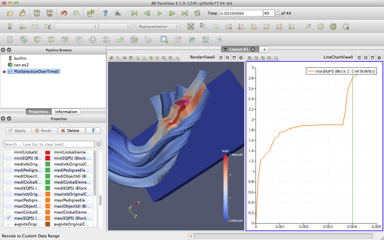

Exercise 2.30 (Plot Over Time)
  1. If you do not already have it loaded from the previous exercise, open the file can.ex2, load all variables, Apply (see Exercise 2.19).
  2. If it is not already visible, show the Find Data pqFindData panel.
  3. Using the controls at the top of the find data panel, create a selection where EQPS is max. Click Find Data.
  4. Click the Plot Selection Over Time button at the bottom of the find data panel to add that filter. This filter is also easily accessible by the pqPlotSelectionOverTime toolbar button in the main ParaView window.
  5. In the properties panel in the main ParaView window, click Apply.
../../_images/PlotSelectionOverTime2.png
Note that the selection you had was automatically added as the selection to use in the Properties panel when the Plot Selection Over Time pqPlotSelectionOverTime filter was created. If you want to change the selection, simply make a new one and click Copy Active Selection in the Properties panel.
Also note that the plot was for the maximum EQPS value at each timestep, which could potentially be from a different cell at every timestep. If the desire is to identify a cell with a maximum value at some timestep and then plot that cell’s value at every timestep, then use the Freeze Selection feature demonstrated in Exercise 2.28.

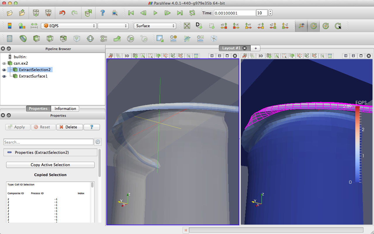

You can also extract a selection in order to view the selected points or cells separately or perform some independent processing on them. This is done through the Extract Selection pqExtractSelection filter.
Exercise 2.31 (Extracting a Selection)
  2. Make a sizable cell selection for example, with Select Cells Through pqFrustumSelectionCell.
  3. Create an Extract Selection pqExtractSelection filter (available on the toolbar and from the find data panel).
  4. Apply.
../../_images/ExtractSelection.png
The object in the view is replaced with the cells that you just selected. (Note that in this image I added a translucent surface and a second view with the original selection to show the extracted cells in relation to the full data.) You can perform computations on the extracted cells by simply adding filters to the extract selection pipeline object.

  3. Use pqFrustumSelectionCell to create a frustum cell selection at the bottom-left part of the can, and press Plus in the Selection Editor to save the created selection. As you can see the saved selection has a name s0, and it’s described as a frustum selection.
  4. Use pqSelectBlock to select the top block of the can and press Plus in the Selection Editor to save the created selection.
  5. On top of the frustum selection that you created previously, use pqSurfaceSelectionCell to create a slightly smaller polygon cell selection, and press Plus in the Selection Editor to save the created selection.
    1. You can click on the previous Frustum selection in the Selection Editor to interactively visualize it.
  6. Open the Find data panel pqFindData, select can.ex2 as the Data Producer, select Cell as the Element Type, and set ID \(>=\) 3600, press Plus in the Find data panel and set ID \(>=\) 3900. Finally, press Plus in the Selection Editor to save the created selection.
  7. The Selection Editor should now have 4 different selections, which can be combined using a boolean expression. Set Expression to \(s1|(s0\) ^ \(s2)|s3\).
../../_images/SelectionEditorPanel.png
  1. Press Activate Combined Selections.
../../_images/SelectionEditorViewResult.png
More information regarding the Selection Editor can be found in Section 6.8 of the User’s Guide.
2.15. Animations
Notice
This part mention the animation view. This was replaced by the time manager. While the interfaces are quite similar, some differences may exist. Please see the ParaView User’s Guide ‘Animation’ section for more.
We have already seen how to animate a dataset with time in it (hit pqVcrPlay ) and other ways to manipulate temporal data in Section 2.11. However, ParaView’s animation capabilities go far beyond that. With ParaView you can animate nearly any property of any pipeline object.

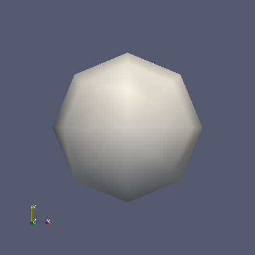

Exercise 2.33 (Animating Properties)
  1. Use the quick launch (ctrl+space Win/Linux, alt+space Mac) to create the Sphere source and Apply it.
  2. If the animation view is not visible, make it so: View → Animation View.
  3. Change the No. Frames option to 50 (10 will go far too quickly).
  4. Find the property selection widgets at the bottom of the animation view and select Sphere1 in the first box and Start Theta in the second box.
../../_images/AddStartThetaTrack.png
Hit the Plus button.
../../_images/BuildAnimation1.png
If you play pqVcrPlay the animation, you will see the sphere open up then eventually wrap around itself and disappear.
AnimateSphere0
AnimateSphere1
AnimateSphere2
AnimateSphere3
What you have done is created a track for the Start Theta property of the Sphere1 object. A track is represented as horizontal bars in the animation view. They hold key frames that specify values for the property at a specific time instance. The value for the property is interpolated between the key frames. When you created a track two key frames were created automatically: a key frame at the start time with the minimal value and a key frame at the end time with the maximal value. The property you set here defines the start range of the sphere.

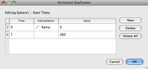

You can modify a track by double clicking on it. That will bring up a dialog box that you can use to add, delete, and modify key frames.
../../_images/AnimationKeyframesDialog.png
We use this feature to create a new key frame in the animation in the next exercise.

You are not limited to animating just one property. You can animate any number of properties you wish. Now we will create an animation that depends on modifying two properties.
Exercise 2.35 (Multiple Animation Tracks)
This exercise is a continuation of Exercise 2.33 and Exercise 2.34. You will need to finish those exercises before beginning this one.
  1. Double-click on the Sphere1 – Start Theta track.
  2. In the Animation Keyframes dialog, Delete the first track (at time step 0).
  3. Click OK.
  4. In the animation view, create a track for the Sphere1 object, End Theta property.
  5. Double-click on the Sphere1 – End Theta track.
  6. Change the time for the second key frame to be 0.5.
../../_images/BuildAnimation3.png
The animation will show the sphere creating and destroying itself, but this time the range front rotates in the same direction. It makes for a very satisfying animation when you loop pqVcrLoop the animation.
In addition to animating properties for pipeline objects, you can animate the camera. ParaView provides methods for animating the camera along curves that you specify. The most common animation is to rotate the camera around an object, always facing the object, and ParaView provides a means to automatically generate such an animation.

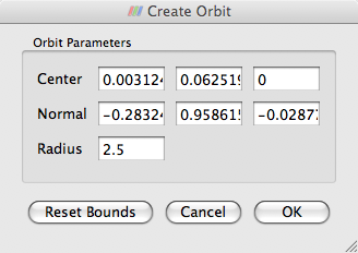

Exercise 2.36 (Camera Orbit Animations)
For this exercise, we will orbit the camera around whatever data you have loaded. If you are continuing from the previous exercise, you are set up. If not, simply load or create some data. To see the effects, it is best to have asymmetry in the geometry you load. can.ex2 is a good dataset to load for this exercise.
  1. Place the camera where you want the orbit to start. The camera will move to the right around the viewpoint.
  2. Make sure the animation view panel is visible (View → Animation View if it is not).
  3. In the property selection widgets, select Camera in the first box and Orbit in the second box.
../../_images/AddCameraOrbit.png
../../_images/CreateOrbitDialog.png
Before the new track is created, you will be presented with a dialog box that specifies the parameters of the orbit. The default values come from the current camera position, which is usually what you want.
  1. Click OK.
  2. Play pqVcrPlay.
The camera will now animate around the object.
Another common camera annotation is to follow an object as it moves through space. Imagine a simulation of a traveling bullet or vehicle. If we hold the camera steady, then the object will quickly move out of view. To help with this situation, ParaView provides a special track that allows the camera to follow the data in the scene.
Exercise 2.37 (Following Data in an Animation)
  3. Make sure the animation view panel is visible (View → Animation View if it is not).
  4. In the property selection widgets, select Camera in the first box and Follow Data in the second box.
  1. Play pqVcrPlay.
Note that instead of the can crushing to the bottom of the view, the animation shows the can lifted up to be continually centered in the image. This is because the camera is following the can down as it is crushed.
