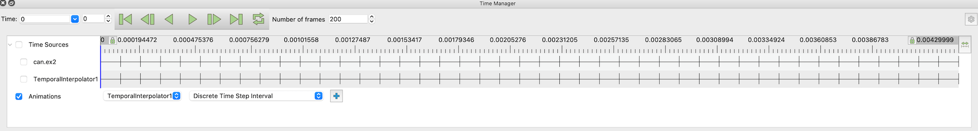

9.3. Temporal Interpolator
Let’s change the mode to Sequence, and the Nunber of Frames to 200.
Filters → Temporal → Temporal Interpolator.
Apply..
In the Time Manager View window, unselect the checkbox in front of the TemporalInterpolator. This turns off reading time from this filter.
Change the number of frames to 200
Play. Notice that the can motion is now smooth.
paraviewis interpolating between frames, and making 200 time steps.Note that this only works with data that has a constant mesh through the whole time sequence. AMR (Adaptive Mesh Refinement) data does not work with the Temporal Interpolator.

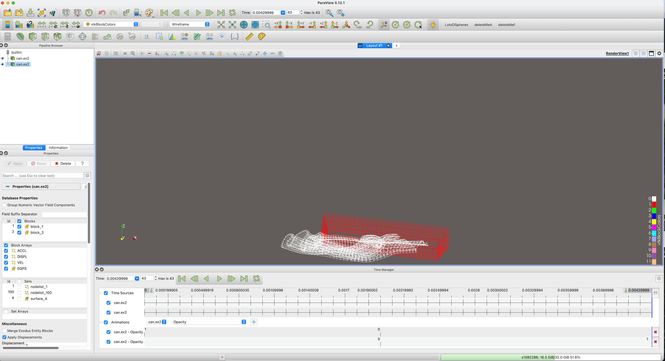

We now want to fade from the first version of the can to the second version of the can. This is done as follows:
On the Time Manager View, on the Animations line, on the upper can.ex2 pulldown menu, select the upper can.ex2.
Right of there, use the pulldown menu to select Opacity.
Click the blue +.
Do the same for the lower can.ex2.
Click on the upper can.ex2 white horizontal bar.
Double click on the upper value, change it to 1.
Double click the lower value, change it to 0.
OK.
Play.
