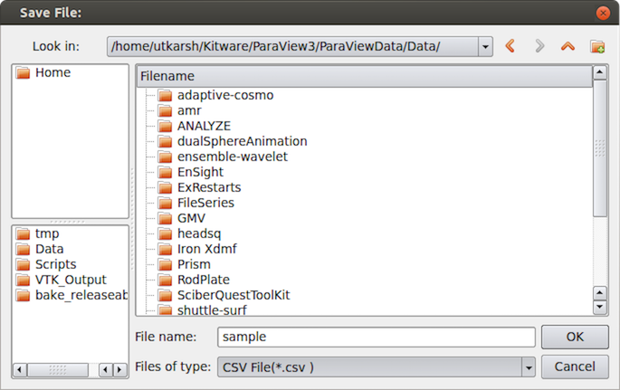

The Save File dialog (Fig. 8.1)
will allow you to select the filename and the file format.
The available list of file formats depends on the type of the dataset you are
trying to save.
Fig. 8.1 Save File dialog in paraview.

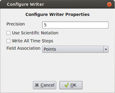

On accepting a filename and file format to use, paraview may show
the Configure Writer dialog (Fig. 8.2).
This dialog allows you to further customize the
writing process. The properties shown in this dialog depend on the selected file
format and range from enabling you to Write All Time Steps , to selecting
the attributes to write in the output file.
Fig. 8.2 Configure Writer dialog in paraview shown when saving a dataset as a csv file.

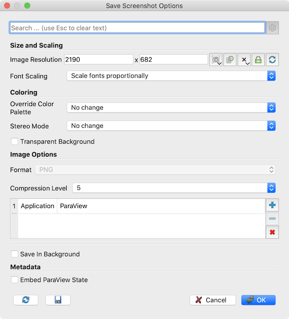

To save the render image from a view in paraview,
use the File > Save Screenshot menu
option. When selected, a file dialog will appear where you can select the file path
and format to which the screenshot should be saved. After selecting the image file, the
Save Screenshot Options dialog (Fig. 8.3) will
be shown. This dialog allows you to select various parameters that controls what
image is saved out and how.
Fig. 8.3 The Save Screenshot Options dialog, which is used to customize saving screenshots in paraview.
If your visualization setup only has one view the active tab, then you’ll be presented with options shown in (Fig. 8.3). The available options are as follows.
Image Resolution: This is the target image resolution in pixels. By default, it is set to the current view dimensions. You can change it as needed. If the resolution larger than the current resolution, then ParaView will use tiling to render the full image in multiple stages. For reliable results, you may want to present the current aspect ratio. You can use Tools > Lock View Size Custom to lock the view size to a suitable aspect ratio.Font Scaling: When a resolution larger than the current resolution is specified, this allows you to control how the fonts are to be scaled. DefaultScale fonts proportionallytries to achieve WYSIWYG as long as the aspect ratio is maintained. This is suitable for saving images targeted for higher DPI (or PPI) display than your screen.Do not scale fontsmay be used to avoid font scaling and keep their size in pixels the same as what is currently on the screen. This is suitable for saving images targeted for a larger display with the same pixel resolution.Override Color Palette: Optionally change the color palette just for saving the screenshot using this drop-down.Stereo Mode: This option lets you save the image using one of the supported stereo modes.Transparent Background: If the file format supports it, you can check this option to save the images with a transparent background rather than the current background color.Format: This shows the file format selected in the file save dialog.
For formats that have different options like compression levels, format-specific
options are presented in the Save Screenshot Options dialog. The PNG format has
a Compression Level option that ranges from 0 (no compression) to 9 (maximum
compression). The JPEG format options are Quality , which ranges from 0 to 100,
and Progressive , which enables saving the file as a progressive JPEG. The TIFF
file format has a Compression option with possible values None , PackBits ,
and Deflate . The BMP file format has no options.

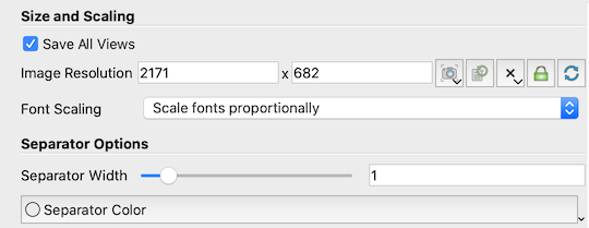

If the active tab has more than one view, then the Save
Screenshot Options dialog has a few more options as shown in
Fig. 8.4.
Fig. 8.4 Extra options in Save Screenshot Options dialog available when the active tab has more than 1 view.
Save All Views: Check this to save all the views in the active tab laid out exactly as in the UI. If unchecked, only the active view will be saved.Separator Options: These control the separator drawn between the views in the generated image. You can specify theSeparator Widthin approximate pixels as well as theSeparator Color.

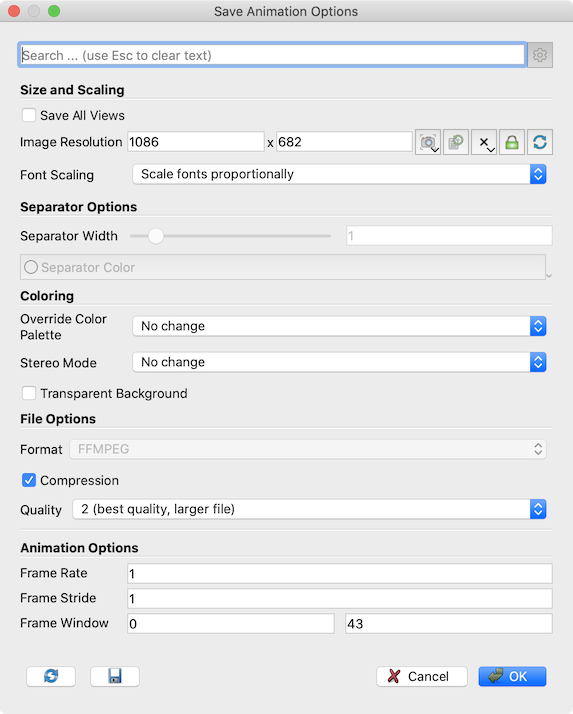

8.3. Saving animation
Fig. 8.5 The Save Animation Options dialog in paraview, which is used to customize saving of animation.
To save an animation as a series of images or a video file, you use the File > Save Animation menu option. This raises a file save dialog where you choose where to save the file and which format to use. The available file formats include AVI (on Windows and Linux), MP4 (on Windows only), and Ogg video formats, as well as image formats such PNG, JPEG, and TIFF. If saving an animation as image frames, ParaView will generate a series of image files sequentially numbered using the frame number as a suffix to the specified filename.
After selecting the file and format, the Save Animation Options
dialog (Fig. 8.5) is displayed. This dialog is nearly a clone of the
Save Screenshot Options dialog (Fig. 8.3), including,
optionally, the extra multiview options from Fig. 8.4,
with additional format-specific compression options and a few animation-specific parameters.
These are as follows:
Frame Rate: When saving the animation as a video file (AVI or Ogg) rather than a series of images, this lets you specify the frame rate for the generated video. It has no effect when saving as a series of images.Frame Stride: Defines how many timesteps to jump forward after recording a screenshot of the current timestep.Frame Window: If you didn’t want to save out the full animation, instead limit to a specific window, you can use this to specify the range of frames to save. If you are generating a animation from a temporal dataset with timesteps, the frame generally corresponds to the timestep number.
To save animations in pvpython, you use SaveAnimation . The arguments to this function are
same as the SaveScreenshot with additional parameters for the animation specific options.
>>> SaveAnimation('animation.avi', GetActiveView(),
FrameWindow = [1, 100],
FrameRate = 1)

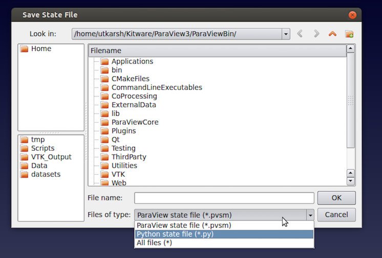

State . In paraview, you can save the
state using the File > Save State… menu option. Conversely, to load a saved
state file, you can use File > Load State….
There are two types of state files that you can save in paraview:
ParaView state file (*.pvsm) and Python state file (*.py). The
PVSM files are XML-based text files that are human and machine readable,
although not necessarily human friendly for a novice user. However, if you don’t
plan to read and make sense of the state files, PVSM is the most robust and
reliable way to save the application state. For those who want to save the state and then
modify it manually, using Python state files may be better, as using
Python trace simply traces the actions that you perform in the UI as a
Python script. Python state files, on the other hand, save the entire current state of the
application as a Python script that you can use in paraview or the
Python Shell .
Fig. 8.6 The Save State File dialog in paraview.

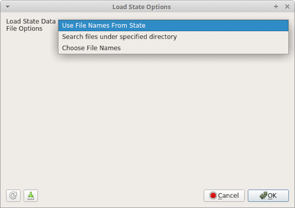

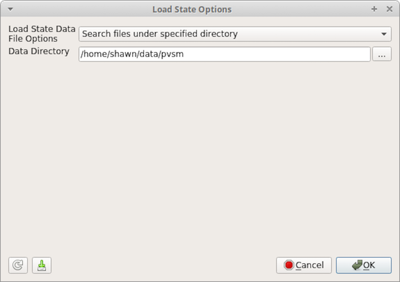

To load a state file, you use the File > Load State… menu. Note that loading a state file will affect the current visualization state.
Fig. 8.7 The Load State Options dialog in paraview showing the options for where to find data files.
If you load a PVSM file this way you will be asked where
to search for the data files. There are three available options: Use File Names From State , Search files under
specified directory and Choose File Names . If you select Use File Names From State then ParaView will
look for the data at the absolute paths saved in the state file. If you select Search files under specified
directory then you will see an option to browse for a directory that ParaView will search for the files before
looking for them in the absolute path in the state file. This defaults to the
location of the state file to make sharing state files between computers easier. If you select
Choose File Names then you will be given a list of file names in the state file and can override
each one individually.

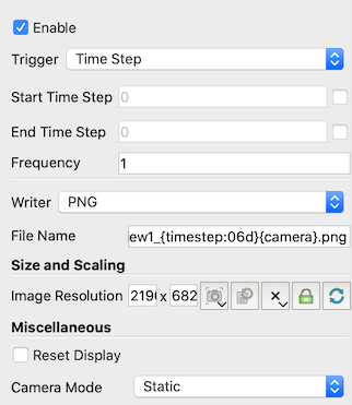

Fig. 8.9 Properties of an image extractor for PNG files.
You use the Properties panel view and change extractor properties.
The available properties can be grouped into two major groups: first are
Trigger properties which are common to all extractors, and the second
are the Writer properties which are parameters specific to type of writer
the extractor uses.
Trigger properties define when the extractor is activated i.e.
under what conditions does the extractor produce extracts. Currently, we
support time-based controls. You can select the Start Time Step,
End Time Step or the Frequency at which to generate the results.
Frequency is the number of timesteps per activation. To write every
other timestep, set the Frequency to 2, to write every 3rd timestep, set it
to 3, and so on.
Writer properties are specific to the writer. For data extractors,
these will be similar to the writer properties shown in the
Configure Writer dialog for the writer described
in Section Section 8.1. For
image extractors, they are similar to the Save Screenshot Options
dialog described in Section Section 8.2.1. The Writer
properties also lets you set a File Name . This is the file name to use to
save the extracts. Since extractors are designed to generate a new
extract every time they are activated, the File Name supports patterns that
let you make the filename unique per activation. {timestep} or {time} in the
filename are replaced by the timestep index and the time value for each
activation. You add leading zeros (or other prefixes) to the numbers using a
form such as {timestep:06d}. There the timestep will be padded with zeros if the
number of digits is less than 6. You should not use absolute paths for
specifying the filenames here. We will see how to select prefix to store these
extracts under in the next section.

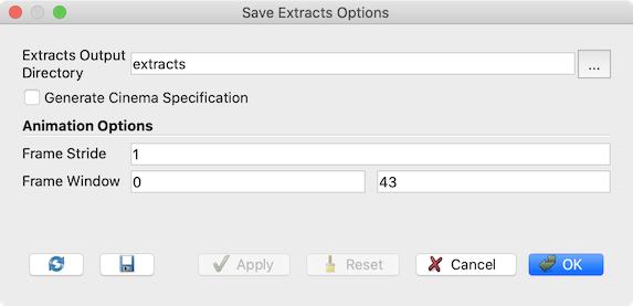

Fig. 8.10 Save Extracts Options dialog shown on File > Save Extracts….
Once the extractors have been setup, you can trigger the saving of
extract using File > Save Extracts…. This will pop up the
Save Extract Options dialog which lets you configure the extract generation.
Extracts Output Directory specifies the root directories under which all extracts are saved.
Check Generate Cinema Specification to generate a data.csv file under the chosen
extracts output directory that summarizes the generated extracts. This can be then used
with viewers provided by
the Cinema Science project to explore the generated extracts. Frame Stride and
Frame Window control the timesteps for which extracts are generated.
Hit Ok and ParaView will animate through all timesteps
(similar to using the VCR Controls), activating extractors based
on their trigger criteria and then generating extracts. On successful
completion you should have files under the chosen root directories.

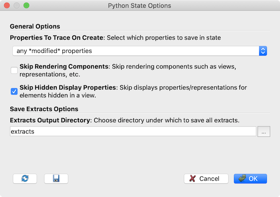

Fig. 8.11 Python State Options dialog shown when saving a Python state file using
File > Save State.
In addition to generating extracts using the GUI, you can use pvpython or pvbatch
to generate extract offline. Thus is especially handy for HPC use-cases; you can
setup your state using an interactive session and once done save out the state and
schedule a non-interactive job for the potentially time-consuming extract generation
stage. To do so, setup your visualization pipeline including the extractors
as normal. Then, instead of using Save Extracts , use
File > Save State… and save out a Python state file.
The Python State Options dialog has a section similar to Save Extracts Options
dialog for choosing Extracts Output Directory and Generate Cinema Specification.
Click Ok to save the Python script. The Python script has a section near
the end of the end as follows:
if __name__ == '__main__':
# generate extracts
SaveExtracts(ExtractsOutputDirectory='extracts')
This is what causes the Python script to save the extracts when the script is executed using
pvbatch or pvpython.
