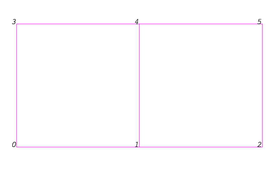

3.1.1. Mesh
Even though the actual data structure used to store the mesh in memory depends on the type of the dataset, some abstractions are common to all types. In general, a mesh consists of vertices (points ) and cells (elements, zones). Cells are used to discretize a region and can have various types such as tetrahedra, hexahedra, etc. Each cell contains a set of vertices. The mapping from cells to vertices is called the connectivity. Note that even though it is possible to define data elements such as faces and edges, VTK does not represent these explicitly. Rather, they are implied by a cell’s type and by its connectivity. One exception to this rule is the arbitrary polyhedron, which explicitly stores its faces. Fig. 3.1 is an example mesh that consists of two cells. The first cell is defined by vertices \((0, 1, 3, 4)\), and the second cell is defined by vertices \((1, 2, 4, 5)\). These cells are neighbors because they share the edge defined by the points \((1, 4)\).
Fig. 3.1 Example of a mesh.
A mesh is fully defined by its topology and the spatial coordinates of its vertices. In VTK, the point coordinates may be implicit, or they may be explicitly defined by a data array of dimensions \((number\_of\_points \times 3)\).

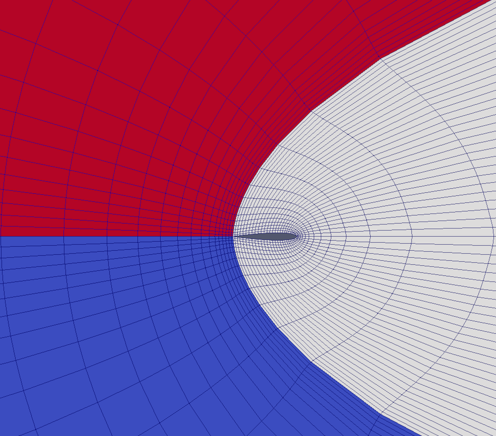

3.1.4. Rectilinear grid
Fig. 3.5 Rectilinear grid.
A rectilinear grid, such as Fig. 3.5, defines its topology implicitly and point coordinates semi-implicitly. To fully define the mesh for a rectilinear grid, VTK uses the following:
Extents - These define the minimum and maximum indices in each direction. For example, a rectilinear grid of extents \((0, 9)\), \((0, 19)\), \((0, 29)\) has 10 points in the x-direction, 20 points in the y-direction, and 30 points in the z-direction. The total number of points is \(10 \times 20 \times 30\).
Three arrays defining coordinates in the x-, y- and z-directions - These arrays are of length \(npts_x\), \(npts_y\), and \(npts_z\). This is a significant savings in memory, as the total memory used by these arrays is \(npts_x+npts_y+npts_z\) rather than \(npts_x \times npts_y \times npts_z\).
The coordinate of each point is defined as follows:
\(coordinate = (coordinate\_array_x(i), coordinate\_array_y(j), coordinate\_array_z(k))\).
Note that the generic VTK interface for all datasets uses a flat index. The \((i,j,k)\) index can be converted to this flat index as follows: \(idx\_flat = k \times (npts_x \times npts_y) + j \times nptr_x + i\).
A rectilinear grid consists of cells of the same type. This type is determined by the dimensionality of the dataset (based on the extents) and can either be vertex (0D), line (1D), pixel (2D), or voxel (3D).

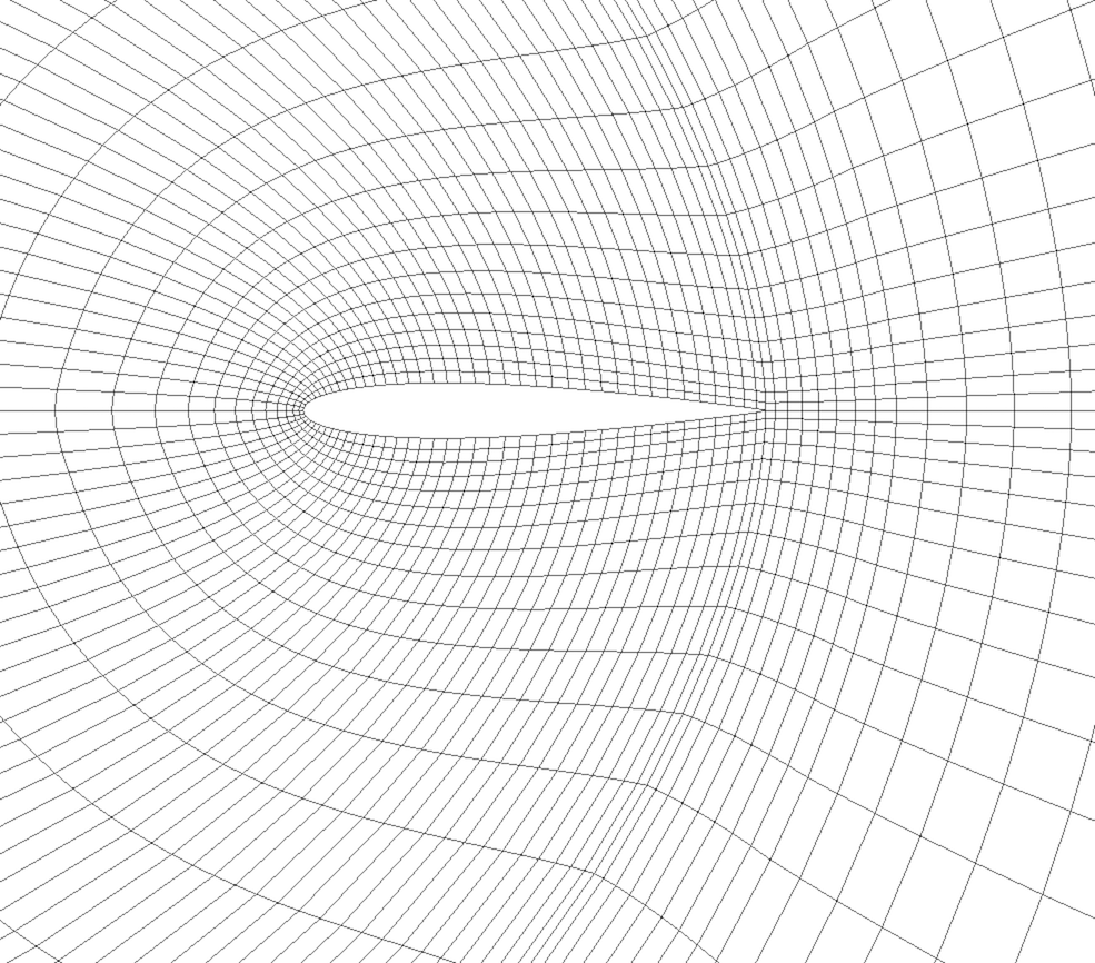

3.1.5. Curvilinear grid (structured grid)
Fig. 3.6 Curvilinear or structured grid.
A curvilinear grid, such as Fig. 3.6, defines its topology implicitly and point coordinates explicitly. To fully define the mesh for a curvilinear grid, VTK uses the following:
Extents - These define the minimum and maximum indices in each direction. For example, a curvilinear grid of extents \((0, 9)\), \((0, 19)\), \((0, 29)\) has \(10 \times 20 \times 30\) points regularly defined over a curvilinear mesh.
An array of point coordinates - This array stores the position of each vertex explicitly.
The coordinate of each point is defined as follows: \(coordinate = coordinate\_array(idx\_flat)\). The \((i,j,k)\) index can be converted to this flat index as follows: \(idx\_flat = k \times (npts_x \times npts_y) + j \times npts_x + i\).
A curvilinear grid consists of cells of the same type. This type is determined by the dimensionality of the dataset (based on the extents) and can either be vertex (0D), line (1D), quad (2D), or hexahedron (3D).

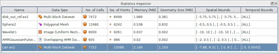

The Information panel and the Statistics Inspector panel can be used
to inspect the characteristics of the data produced by any pipeline module.
3.2.1. The Information panel
The Information panel provides summary information about the data produced by
the active source. By default, this panel is tucked under a tab below the
Properties panel. You can toggle its visibility using View > Information.
Fig. 3.13 The Information panel in paraview showing data summaries for the active source.

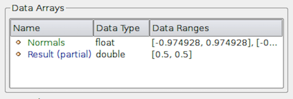

The panel itself is comprised of several groups of information. Groups may be hidden based on the type of pipeline module or the type of data being produced.
The file Properties group is shown for readers with information about the
file that is opened. For a temporal file series, as you step through each
time step, the file name is updated to point to the name of the file in the
series that corresponds to the current time step.
The Statistics group provides a summary of the dataset produced including its

are summaries over all the blocks in the composite dataset. Every so often,
you will notice that the Data Arrays table lists an array with the suffix
(partial) (Figure Fig. 3.14).
Such arrays are referred to as partial arrays. Partial arrays
is a term used to refer to arrays that are present on some non-composite
blocks or leaf nodes in a composite dataset, but not all. The (partial)
suffix to indicate partial arrays is also used by paraview in other
places in the UI.
Fig. 3.14 The Data Arrays section on Information panel showing partial arrays. Partial arrays are arrays that present on certain blocks in a composite dataset, but not all.

3.2.2. The Statistics Inspector panel
The Information panel shows data information for the active source. If you
need a quick summary of the data produced by all the pipeline modules, you can
use the Statistics Inspector panel. It’s accessible from
Views > Statistics Inspector.
Fig. 3.16 The Statistics Inspector panel in paraview showing summaries for all pipeline modules.
All of the information on this panel is also presented on the Information
panel, except Geometry Size . This corresponds to how much memory is
needed for the transformed dataset used for rendering in the active view. For example, to
render a 3D dataset as a surface in the 3D view, ParaView must extract the
surface mesh as a polydata. Geometry Size represents the memory needed for
this polydata with the same memory-size-related caveats as with the
Information panel.
