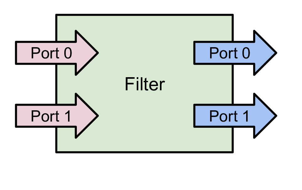

In ParaView, filters are pipeline modules or algorithms that have inputs and
outputs. They take in data on their inputs and produce transformed data or
results on their outputs. A filter can have multiple input and output ports.
The number of input and output ports on a filter is fixed. Each input port accepts

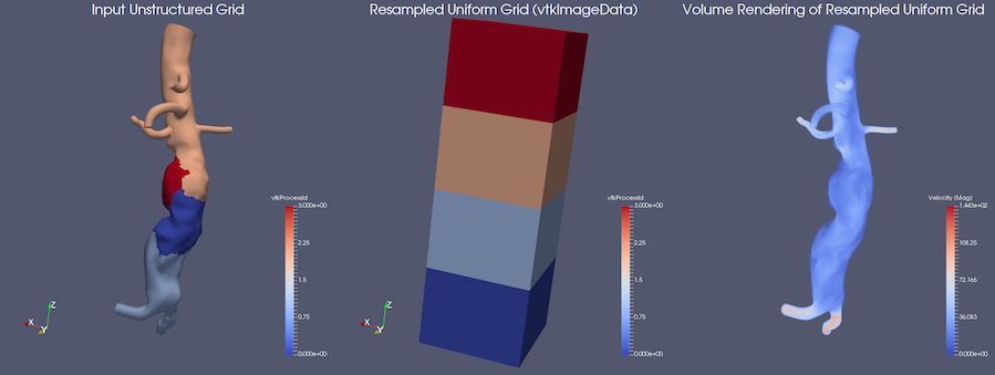

input data for a specific purpose or role within the filter. (E.g., the
Resample With Dataset
filter has two input ports. The one called Input
is the input port through which the dataset providing the attributes to
interpolate is ingested. The other, called Source
, is the input port
through which the dataset used as the mesh on which to re-sample is accepted.)

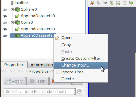

5.2.3. Changing input connections
paraview
allows you to change the inputs to a filter after the
filter has been created. To change inputs to a filter, right-click on the filter
in the Pipeline Browser
to get the context menu, and then select Change
Input...
. This will pop up the same Change Input Dialog
as when creating a
filter with multiple input ports. You can use this dialog to set new inputs
for this filter.

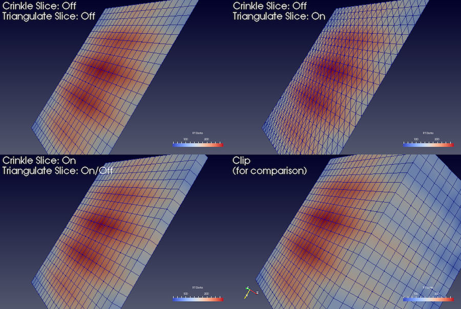

5.6.2. Slice
The Slice
filter slices through the input dataset with an implicit function
such as a plane, a sphere, or a box. Since this filter returns data elements along
the implicit function boundary, this is a dimensionality reducing filter (except
when crinkle slicing is enabled), i.e., if
the input dataset has 3D elements like tetrahedrons or hexahedrons, the output
will have 2D elements, line triangles, and quads, if any. While slicing through a
dataset with 2D elements, the result will be lines.
The properties available on this filter, as well as the way of setting this
filter up, is very similar to the Clip
filter with a few notable
differences. What remains similar is the set up of the implicit function –
you have similar choices: Plane
, Box
, Sphere
, and Cylinder
, as well as the
option to toggle Crinkle slice
(i.e., to avoid cutting through cells,
pass complete cells from the input dataset that intersects the implicit function).
What is different includes the lack of slicing by Scalar
(for that, you
can use the Contour
filter) and a new option, Triangulate the slice
Fig. 5.7
shows the difference in the generated meshes when various slice properties are
changed.

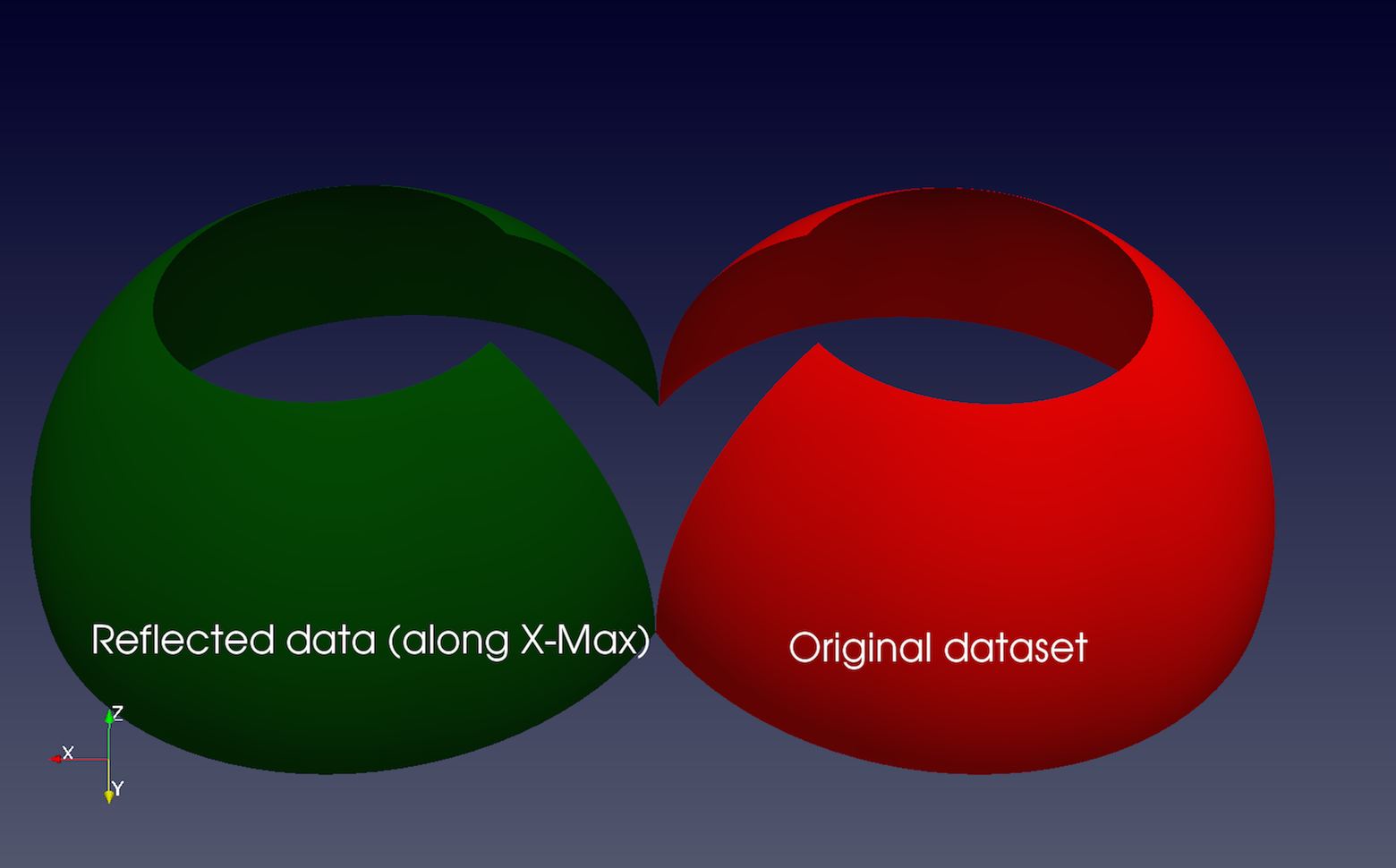

5.7.4. Reflect
Reflect
can be used to reflect any dataset across an axis plane. You can
pick the axis plane to be one of the planes formed by the bounding box of the
dataset. For that, set Plane
as X Min
, X Max
, Y Min
, Y Max
Z Min
, or Z Max
. To reflect across an arbitrary axis plane,
select X
, Y
, or Z
for the Plane
property, and then set the
Center
to the plane offset from the origin.
This filter reflects the input dataset and produces an unstructured grid
(Section 3.1.7). Thus, the same caveats for
Clip
and Threshold
filter apply here when dealing with structured
datasets.

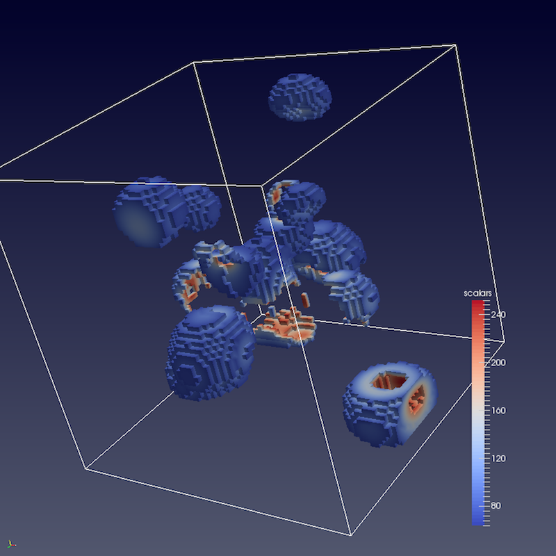

The Masking
properties control which points from the input
dataset get glyphed. The Glyph Mode
controls how points are selected to be
glyphs (Fig. 5.15). The available options are as follows:
All Points
: This selects all points in the input dataset for glyphing. Use this mode with caution and only when the input dataset has relatively few points. Since all points in the input dataset are glyphed, this can not only cause visual clutter, but also clog up memory and take a long to time to generate and render the glyphs.Every Nth Points
: This elects every \(n^{th}\) point in the input dataset for glyphing, where \(n\) can be specified usingStride
. SettingStride
to 1 will have the same effect asAll Points
.Uniform Spatial Distribution
: This selects a random set of points. The algorithm works by first computing up toMaximum Number of Sample Points
in the space defined by the bounding box of the input dataset. Then, points in the input dataset that are close to the point in this set of sample points are glyphed. TheSeed
is used to seed the random number generator used to generate the sample points. This ensures that the random sample points are reproducible and consistent.

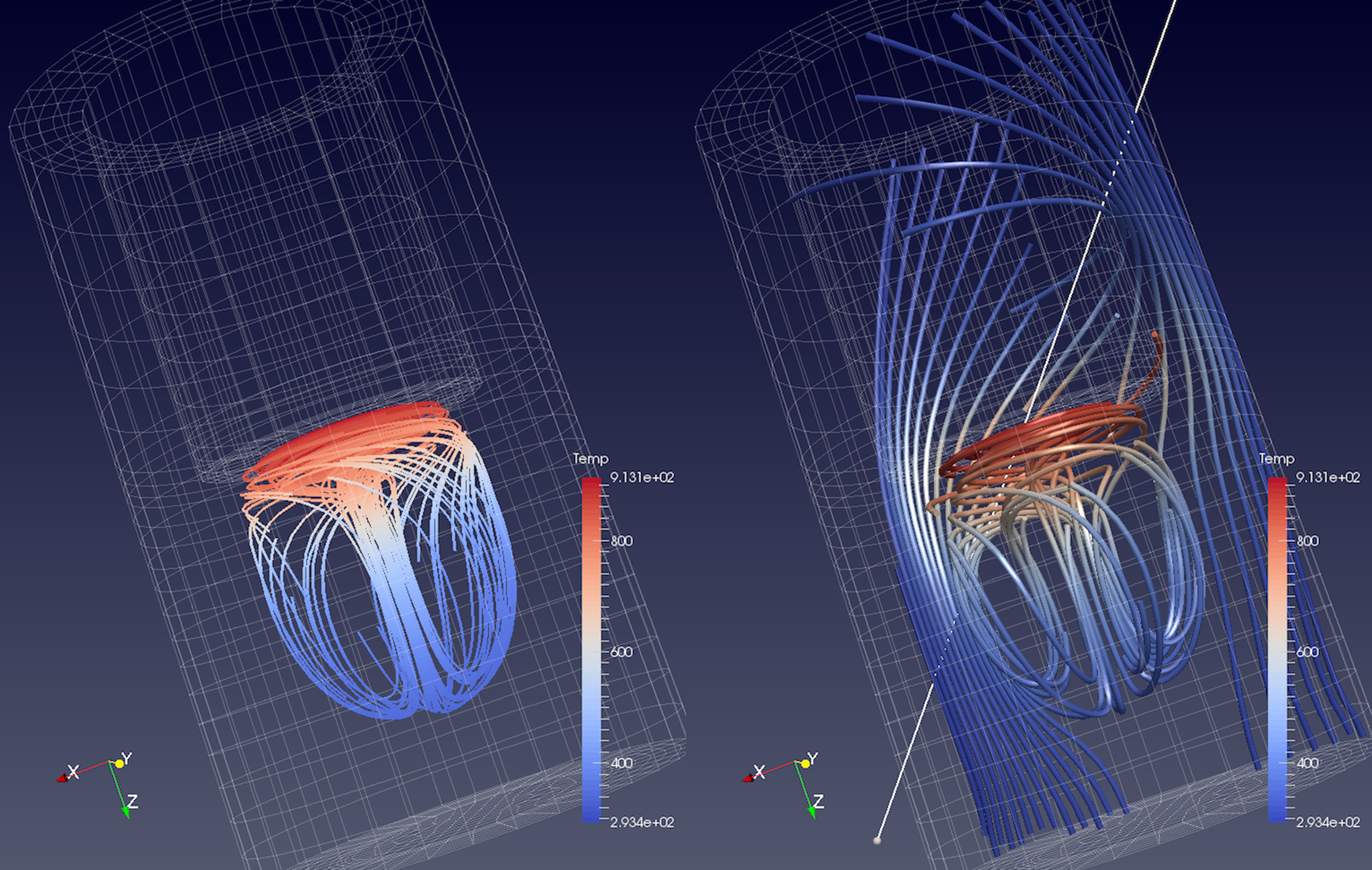

5.8.3. Stream Tracer
The Stream Tracer
filter is used to generate streamlines for vector fields.
In visualization, streamlines refer to curves that are instanteneously
tangential to the the vector field in the dataset. They provide an indication of
the direction in which the particles in the dataset would travel at that instant
in time. The algorithm works by taking a set of points, known as seed
points, in the dataset and then integrating the streamlines starting at these seed
points.
In paraview
, you can create this filter using the Filters
menu, as well as the button on the Common
filters toolbar. To use
this filter, you first select the attribute array to use as the Vectors
for
generating the streamline. Integration Parameters
let you fine tune the
streamline integration by specifying the direction to integrate,
Integration Direction
, as well as the type of integration algorithm to
use, Integrator Type
. Advanced integration parameters are available in the
advanced view of the Properties
panel that let you further tune the
integration, including specifying the step size and others. You use the
Maximum Streamline Length
to limit the maximum length for the streamline –
the longer the length, the longer the generated streamlines.
Seeds
group lets you set how the seed points for generating the streamlines
are produced. You have two options: Point Source
, which produces a point
clound around the user-specified Point
based on the parameters specified,
and High Resolution Line Source
, which produces seed points along the user-specified
line. You can use the 3D widgets shown in the active Render View
to interactively place the center for the point cloud or for defining the line.
Did you know?
The Stream Tracer
filter produces a polydata with 1D lines for each of the
generated streamlines. Since 1D lines cannot be shaded like surfaces in the
Render View
, you can get visualizations where it is hard to follow the
streamlines. To give the streamlines some 3D structure, you can apply the
Tube
filter to the output of the streamlines. The properties on the
Tube
filter let you control the thickness of the tubes. You can also vary
the thickness of the tubes based on data array, e.g., the magnitude of the
vector field at the sample points in the streamline!

5.8.6. Resample To Image
Resample To Image
is a specialization of Resample With Dataset
The filter takes one input and samples its point and cell attributes onto a
uniform grid of points. The bounds and extents of the uniform grid can be
specified using the properties panel. By default, the bounds are set to the
bounds of the input dataset. The output of the filter is an Image dataset.
Some operations can be performed more efficiently on uniform grid datasets.
Volume rendering is one such operation. The Resample to Image
filter can
be used to convert any dataset to Image data before performing such operations.

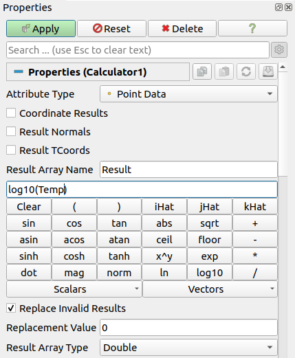

5.9.1. Calculator
The Calculator
filter computes a new data array or new point coordinates as a
function of existing input arrays. If point-centered arrays are used
in the computation of a new data array, the resulting array will also be
point-centered. Similarly, computations using cell-centered arrays will produce
a new cell-centered array. If the function is computing point coordinates
(requested by checking the Coordinate Results
property on the
Properties
panel) , the
result of the function must be a three-component vector. The Calculator
interface operates similarly to a scientific calculator. In creating the
function to evaluate, the standard order of operations applies. Each of the
calculator functions is described below. Unless otherwise noted, enclose the
operand in parentheses using the (
and )
buttons.

The Scalars
menu lists the names of the scalar arrays and the components of
the vector arrays of either the point-centered or
cell-centered data. The Vectors
menu lists the names of the point-centered or
cell-centered vector arrays. The function will be computed for each point (or
cell) using the scalar or vector value of the array at that point (or cell). The
filter operates on any type of dataset, but the input dataset must have at
least one scalar or vector array. The arrays can be either point-centered or
cell-centered. The Calculator
filter’s output is of the same dataset type as
the input.
Did you know?
It used to be a common use-case for the Calculator
filter to convert three input
scalars into a vector array. For that, the Function
would look something like:
\(scalar_x * iHat + scalar_y * jHat + scalar_z * kHat\).
Now, the Merge Vector Components filter provides a simpler way to do this by simply selecting the three scalars to combine into a vector array.
The Properties
panel provides access to several options for this filter.
Checking Coordinate Results
, Result Normals
, or Result TCoords
will set the computed array as the point coordinates, normals, or texture
coordinates, respectively. Result Array Name
is used to specify a name for
the computed array. The default is Result
Sometimes, the expression can yield invalid values. To replace all invalid
values with a specific value, check the Replace Invalid Results
checkbox and
then enter the value to use to replace invalid values using the
Replacement Value
. The output array data type is set with the Result Array Type
property.
To ease the reuse of expressions, three helper buttons are also present to load an expression,
